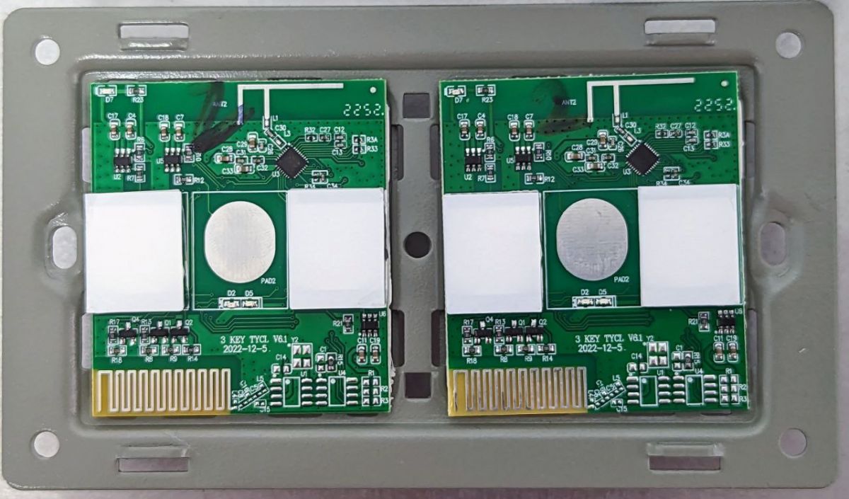

    The switch is actually based on two separate (and identical) modules to support up to 6 gang.

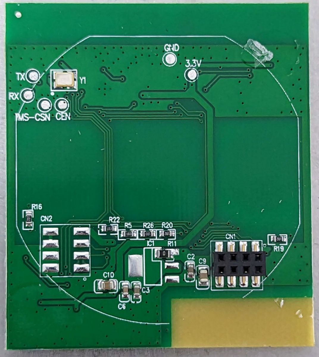

    Chipset is BK7231N, and can be flashed via UART without disconnecting and/or resoldering anything.
    The logic board (containing the BK7231N) is connected to the relays board via an 8-pin socket (and some glue on the corners).
    On the back side of the logic board, there are connection points for 3.3v, GND, TX & RX.
    AVATTO 4/5/6-Gang Wi-Fi Touch Switch: BK7231N Chipset, UART Flashing, Pin Configuration
    Pin configuration for each of the modules:
    PinTypeChannel
    6Btn1
    7Rel1
    8LED1
    14Rel2
    16Btn2
    26LED2
    28WifiLED-

    Thanks! I haven't seen this kind of device yet. What a tricky way to do a double-switch... it must be a strange feeling having to pair it twice.
