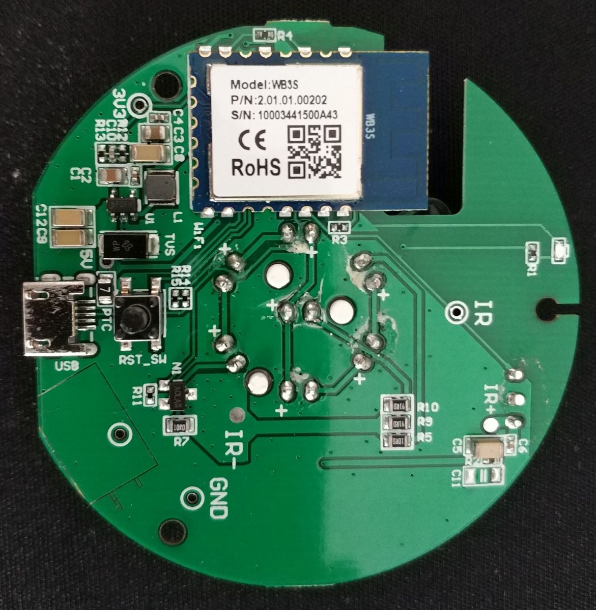

    This is a teardown for the "MOES Smart Wi-Fi Infrared Controller" using a WB3S/BK7321T chip.
    Brand: MOES
    Chip: WB3S (BK7321T)

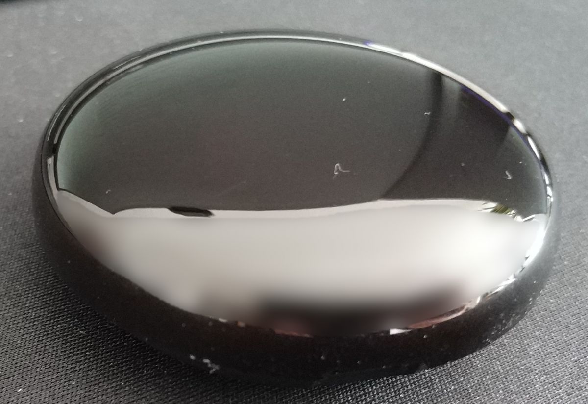

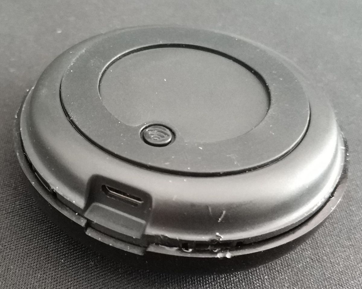

    Device
    Teardown and Flashing Process of MOES Smart Wi-Fi Infrared Controller with WB3S/BK7321T Chip Teardown and Flashing Process of MOES Smart Wi-Fi Infrared Controller with WB3S/BK7321T Chip
    PCB

    Pin Settings
    8IRRecv
    26IRSend
