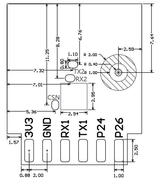

    First, I had to cut the RX and TX traces between the CB2S module and TuyaMCU. I connected RX and TX on the module to TX and RX of my CH340 USB to TTL HW597 Converter. I powered the module with an external USB cable (phone charger wires). I connected 5V(+) wire to the AMS1117 input and (-) to GND. The (-) wire has to also be connected to the HW597's GND. I used a breadboard to make the connections. Using the breadboard makes it simple to disconnect and reconnect power which is part of the programming process.
    To flash the OpenBeken firmware I used hid_download_py. But first, I saved the original firmware for tuya-cloudcutter, so that this fan controller will be programmable OTA (over-the-air) and you will not have to do any wire connections or soldering!
    Terminal window showing the process of flashing OpenBeken firmware on a BK7231N device.
    After flashing the firmware, I soldered wires to reconnect the RX and TX from CB2S to the TuyaMCU. The RF remote control continues to work. Now it's time to do the OpenBeken config.

    Do you have a picture of where you did this on the board? Or could point me to the location. Thx.
    'cut the RX and TX traces between the CB2S module and TuyaMCU'
  • CB2S RX/TX traces and off-board flashing tip
    #4 20231795
    Posts: 14757
    Rate: 12885
    Hey @daveproffer , on this image you can see which traces are RX and TX:
    echojjj wrote:
    QIACHIP Universal WIFI Ceiling Fan Light Remote Control Kit - BK7231N - CB2S
    You can also take a look at CB2S pinout to determine which signals are RX/TX:
    PS: If you don't want to cut the traces, you can desolder whole CB2S with solder wick, then connect just 3.3V power, GND, RX and TX and program it outside of the board (reboot it by disconnecting power and reconnecting while the flashing tool is waiting to 'get bus')
