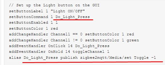

    Outstanding! Thank you this now works exactly as OEM firmware
    I have changed both the Light and Fan Speed selector to OnPress and they both act instantly when FLAG 6 is selected.
    I have chosen to leave Fan ON/OFF as OnClick as the LIGHT and FAN buttons are very close together so having the Light instant but Fan slightly delayed might help to stop accidentally turning the fan on.
    // Display the labels for each channel on the GUI
    setChannelLabel 1 "Light Relay"
    setChannelLabel 2 "Min Fan 1 Relay"
    setChannelLabel 3 "Mid Fan 2 Relay"
    setChannelLabel 4 "Max Fan Relay"
    setChannelType 5 Toggle
    setChannelLabel 5 "Fan ON/OFF"
    setChannelType 10 OffLowMidHigh
    // Hide the raw relay channel buttons from the GUI
    setChannelVisible 1 0
    setChannelVisible 2 0
    setChannelVisible 3 0
    setChannelVisible 4 0
    setChannelVisible 5 0
    // Start the HTTP button driver
    startDriver httpButtons
    // Set up the Light button on the GUI
    setButtonLabel 1 "Light ON/OFF"
    setButtonCommand 1 Do_Light_Press
    setButtonEnabled 1 1
    setButtonColor 1 red
    addChangeHandler Channel1 == 0 setButtonColor 1 red
    addChangeHandler Channel1 != 0 setButtonColor 1 green
    addEventHandler OnPress 14 Do_Light_Press
    alias Do_Light_Press toggleChannel 1
    // Set up the Fan ON/OFF button on the GUI
    setButtonLabel 2 "Fan ON/OFF"
    setButtonCommand 2 Do_Power_Press
    setButtonEnabled 2 1
    setButtonColor 2 red
    addChangeHandler Channel2 == 0 setButtonColor 2 red
    addChangeHandler Channel2 != 0 setButtonColor 2 green
    addEventHandler OnClick 1 Do_Power_Press
    alias Do_Power_Press toggleChannel 5
    // Set up the Fan speed cycle button on the GUI
    setButtonLabel 10 "Next Fan Speed"
    setButtonCommand 10 Do_Cycle_Press_Ext
    setButtonEnabled 10 1
    addEventHandler OnPress 8 Do_Cycle_Press_Ext
    alias Do_Cycle_Press addChannel 10 -1 1 3 1
    alias Do_Cycle_Press_Ext if $CH10!=0 then Do_Cycle_Press
    // Set up change handlers for the fan speed options
    addChangeHandler Channel10 == 0 backlog SetChannel 2 0; SetChannel 3 0; SetChannel 4 0; SetChannel 5 0
    addChangeHandler Channel10 == 1 backlog SetChannel 2 1; SetChannel 3 0; SetChannel 4 0; SetChannel 5 1
    addChangeHandler Channel10 == 2 backlog SetChannel 2 1; SetChannel 3 1; SetChannel 4 0; SetChannel 5 1
    addChangeHandler Channel10 == 3 backlog SetChannel 2 1; SetChannel 3 1; SetChannel 4 1; SetChannel 5 1
    addChangeHandler Channel5 == 0 backlog SetChannel 10 0
    addChangeHandler Channel5 == 1 backlog SetChannel 10 3

    @p.kaczmarek2
    I hope you can help me with this.
    I have this snippet of code in my autoexec.bat to turn on my light
    addEventHandler OnClick 14 Do_Light_Press
    addEventHandler OnHold 14 toggleChannel 1
    alias Do_Light_Press publish zigbee2mqtt/Media/set Toggle -1
    The problem is that the webGUI is not working how I would like and I don't know how to fix it.
    What happens with the code right now is that when I push the "Light ON/OFF" Button the bulb turns off and the GUI button is red. When pushed again it turns the bulb on but the GUI button stays red.
    I can see the error and it has to do with the OnClick and OnHold event handlers. I would like to split these somehow as they both do different things.
    I need to create a dummy button on the GUI that I can link "OnClick 14 Do_Light_Press" or "OnHold 14 toggleChannel 1" to so I can then change the button colour depending on what has been pressed.
    I have looked over the docs and can't find anything that might work so hoping you can help

    I am not sure what are you trying to do. The Do_Light_Press call just does a Zigbee publish. It does not invert the channel 1. It's work as it's scripted. Hmm.
    Maybe you'd rather want to do this:
    alias Do_Light_Press backlog toggleChannel 1; publish zigbee2mqtt/Media/set Toggle -1
    but that does not solve a potential desync between Zigbee device state and button color.
    Also, just to be sure, are you aware that OnClick and OnHold handlers are only for physical button? HTTP panel button will not trigger them.

    wolfieeewolf wrote:
    Interestingly, the HTTP panel button triggers the bulb when clicked, possibly defaulting to that action as it's the first function in the script.
    Why do you think it's defaulting to anything? I can see that you have clearly scripted it to call bulb toggle:
    Screenshot of script code for toggling a light bulb.

    The "Relay ON/OFF" works and turns on/off the relay - Unfortunately, it turns the "Light ON/OFF" HTTP button red/green. It's the same when holding the button on the physical device.
    I'm sure it's just a coding error but I'm not seeing it.
    Here's the code.
    alias Do_Light_Press publish zigbee2mqtt/Bedroom/set Toggle -1
    setButtonLabel 30 "Relay ON/OFF"
    setButtonCommand 30 Do_Relay_Hold
    setButtonEnabled 30 1
    setButtonColor 30 red
    addChangeHandler Channel30 == 0 setButtonColor 30 red
    addChangeHandler Channel30 != 0 setButtonColor 30 green
    addEventHandler OnHold 14 Do_Relay_Hold
    alias Do_Relay_Hold toggleChannel 1
    I think the issue is still that Channel30 is not tied to the right channel to pick up the change. I did change it to Channel1 but it still changes the colours to the wrong buttons.
    I'm not sure there is a fix for this as you can't have two different buttons using the same channel doing two different things.
