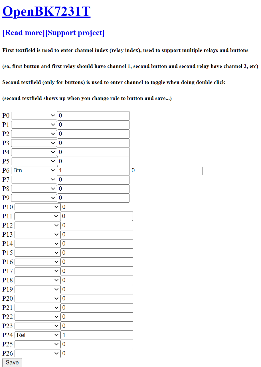

  • OpenBK7231T adds a cross-platform C HTTP mini-server, web pin configurator, and MQTT integration for BK7231T-based WB2S/WB3S modules with Home Assistant control.
  • The design splits Windows-specific networking from reusable HTTP and pin code, so the same configurator and packet parser can run on Windows and on the BK7231T firmware.
  • The server listens on port 80, uses one int as a channel bitmask, and therefore supports up to 32 channels on a 32-bit platform.
  • MQTT callbacks propagate relay/button changes to Home Assistant and accept commands back, and a 4-relay setup uses wildcard topics like wb2s/1/get through wb2s/4/set.
  • The current pin configurator does not save settings to Flash yet, so configuration is still coded and compiled into the firmware.

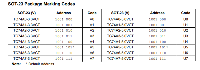

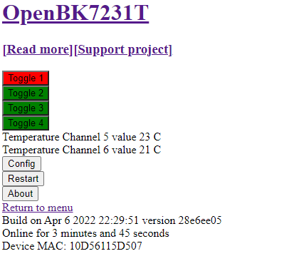

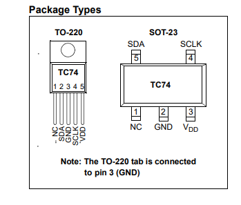

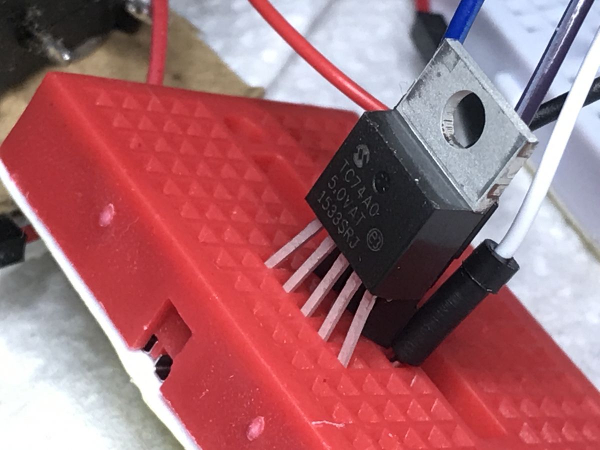

    Today I have commited a scriptable I2C system prototype.
    I2C system will be used to map I2C devices inputs and outputs to our internal OpenBK7231 channels.
    Right now, I have added support for one device - TC74 temperature sensor:
    Connection requirements are simple - solder wires to I2C1 port of WB3S:
    Connect power, ground, SDA and SCL to I2C device.
    Also connect 4.7k pull up resistors on the I2C bus.
    You can use multiple I2C devices, as long as they have different addresses.

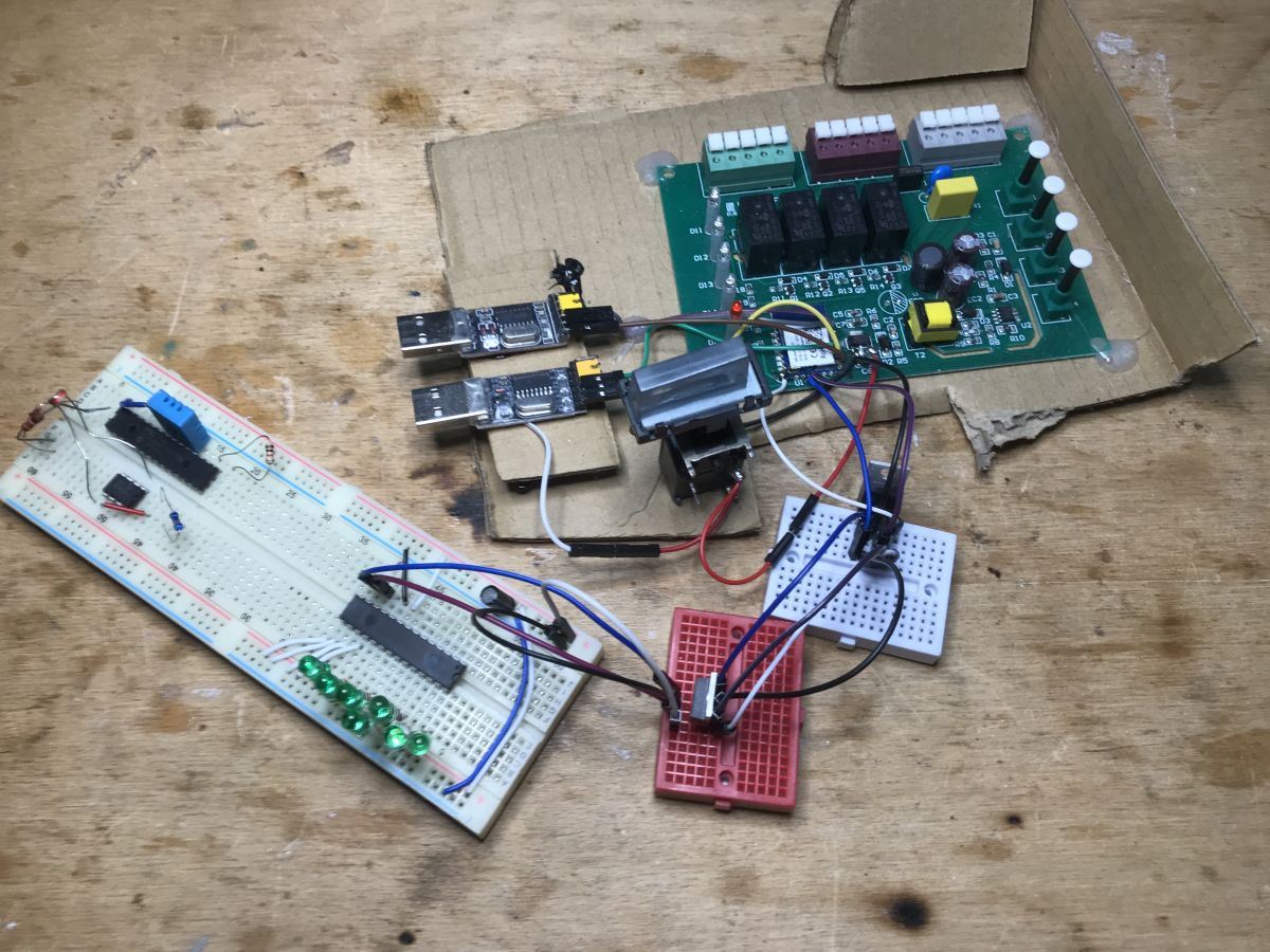

    Here is my setup with two TC74 (A0 and A2 version, two different addresses):
    [BK7231T] My HTTP server, configurator, MQTT support from Home Assistant [BK7231T] My HTTP server, configurator, MQTT support from Home Assistant

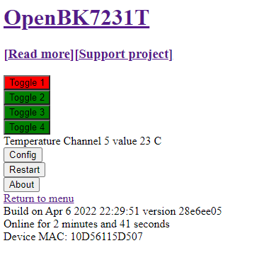

    I2C devices can be added to any BK device. I have used Tuya 4 channels relay controller for this example.
    Relay controller was already configured:
    I2C devices can be added only by commands. They will be most likely saved in LittleFS config file.

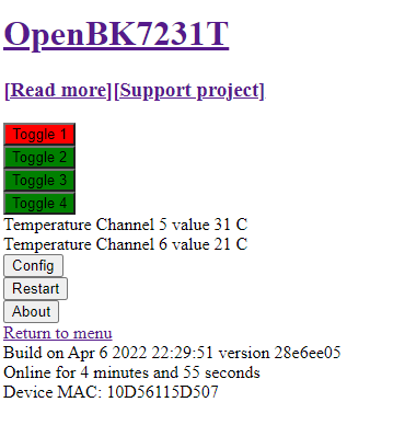

    In order to setup TC74, you must reserve a channel that is not used for relays.
    In this case, channels 5 and latter are not in use.
    So, mark a channel as temperature:
    setChannelType 5 temperature
    Then register I2C TC74 which will save output to channel 5 (0x48 here is I2C device address, I2C1 is the name of hardware I2C bus to use):
    addI2CDevice_TC74 I2C1 0x48 5
    Result:
    Same, for second TC74:
    setChannelType 6 temperature
    addI2CDevice_TC74 I2C1 0x4A 6
    Now, for a test, let's warm up one sensor with soldering iron:
    Both sensors work.
    Now, as you most likely already realize, having temperature values in MQTT automatically allows us to expose them to Home Assistant, just like with any other variables.
    WARNING: This is experimental feature, if you're a beginner and not a developer, please wait few weeks before using it.

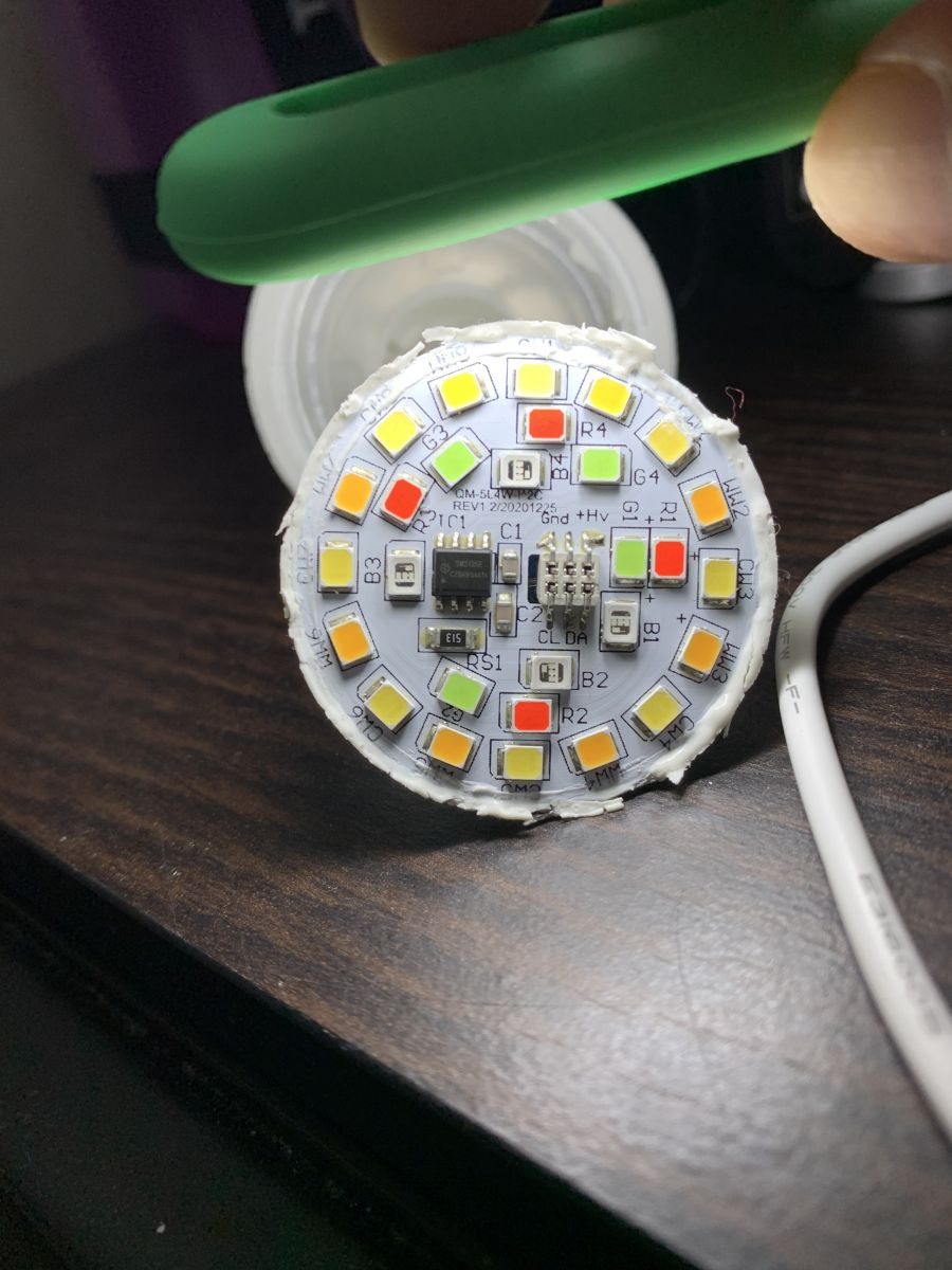

  • SM2135E GU10 bulb may be replaced by PWM version
    #392 19969968
    ferbulous
    Posts: 419
    Help: 8
    Rate: 56
    @p.kaczmarek2

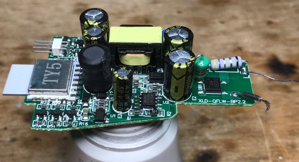

    Great progress with the i2c
    i had this gu10 bulb (bl605) with led driver SM2135E
    Should be the same one from this link
    EWeLink GU10 Wifi Smart Light Bulb 4W LED Spotlight Timer Function 220-240V RGB+CCT Voice Control Work With Alexa Google Home
    https://a.aliexpress.com/_mrzBDIi
    However on the next batch i ordered, the seller sent me with PWM.
    So you might need to verify with the seller first.

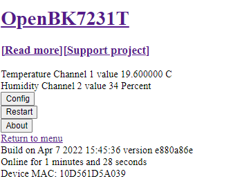

    Here is the script I used for TH06:
    ntp_timeZoneOfs 2
    addRepeatingEvent 10 uartSendHex 55AA0008000007
    setChannelType 1 temperature_div10
    setChannelType 2 humidity
    linkTuyaMCUOutputToChannel 1 1
    linkTuyaMCUOutputToChannel 2 2
    addRepeatingEvent 10 tuyaMcu_sendCurTime
    The 'repeating events' might not be a correct approach, I will be investigating it more soon. I will also need to modify TuyaMCU code to ensure that there is a certain delay between TuyaMCU packets.
    I will prepare a full documentation of comands when they are fully tested.

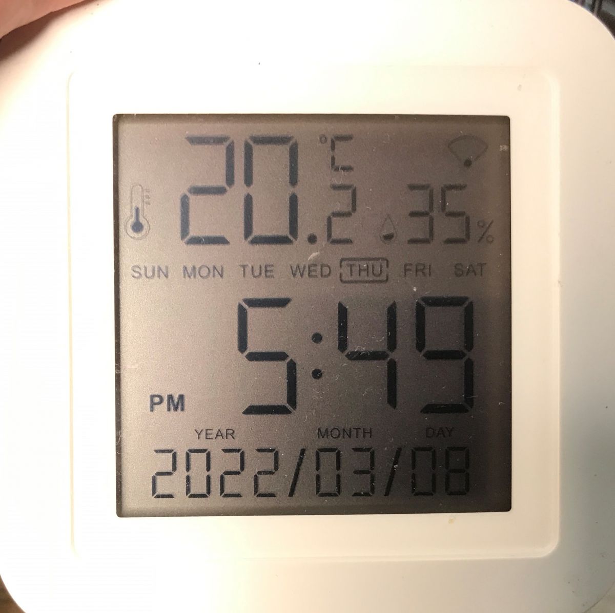

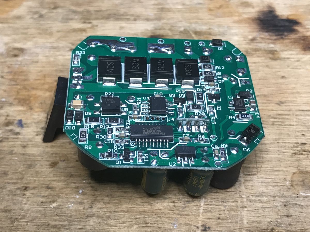

    This is TH06:
    Circuit board with mounted electronic components and a module labeled WB3S.
    Digital clock display showing temperature 23.3°C, humidity 24%, day of the week WEDNESDAY, time 8:08 AM, and date July 15, 2012.
    See measurements on screen and on OpenBK panel:
    (values on photo are slightly different because they change so fast...)
    Channels are automatically sent to MQTT server, so HomeAssistant should be now able to read out TH06 temperature and humidity, altough I might need one more fix for that later.

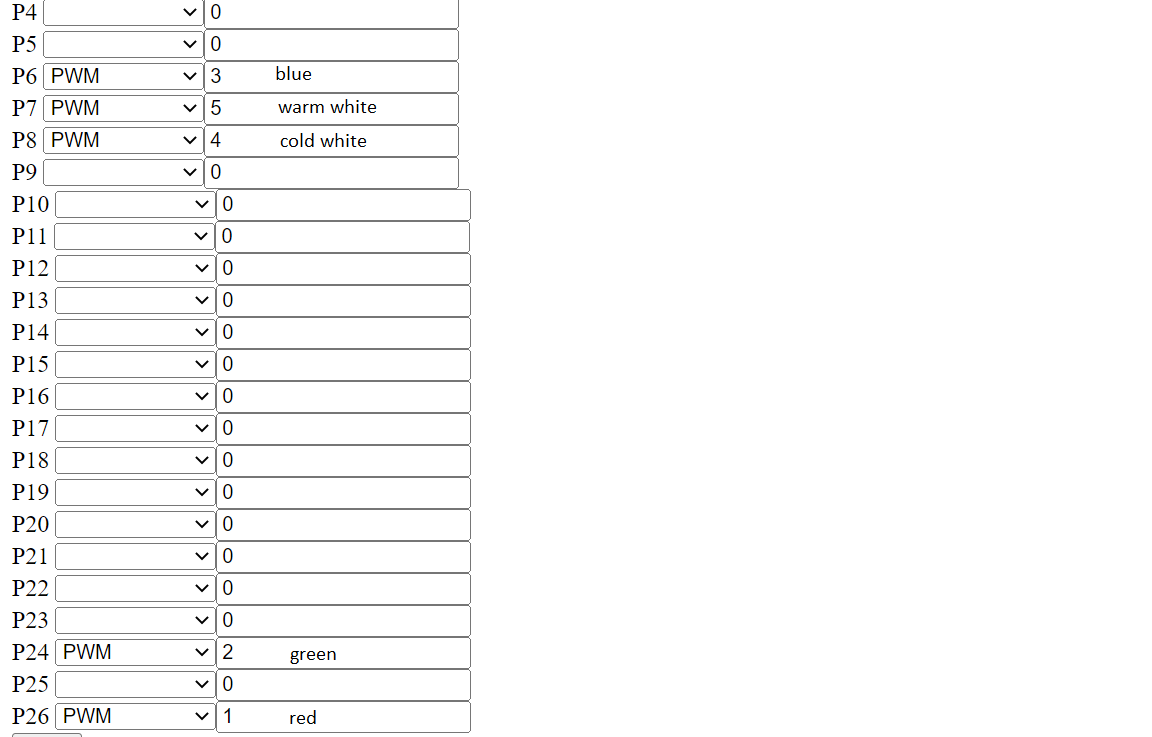

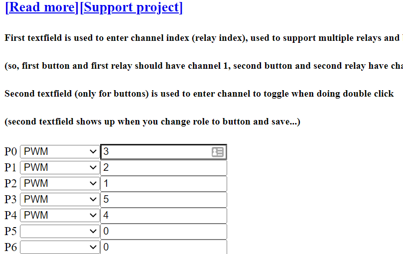

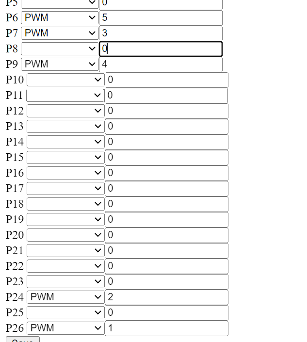

    #394 19971215
    moeter
    If you are interested in further devices using a Beken chip:
    I have a RGBCW led strip controller bought at Action in Germany which uses an BK7231T. It has (obviously) 5 PWM channels, 3 buttons and an IR input. It does not use a tuya module but is a custom PCB with MCU and output circuitry integrated, which leads me to believe they won't change the MCU any time soon.
    RX/TX1 and 2 are exposed by testpoints, I've already checked the pinout:
    pwmc=pwm5=P26
    pwmw=pwm4=p24
    pwmg=pwm2=p08
    pwmr=pwm1=p07
    pwmb=pwm0=p06
    s1[M]=P15
    s3[power]=p14
    s2[[C]=p16
    IR=p9
    For what it is (5m RGBCW strip + controller, remote and power supply) it's quite cheap at 20€.
    Company Name is LSC, model 970752, available here on action dot com as "tama-led-lsc-smart-connect" or "lsc-smart-connect-led-streifen" (sorry, I'm not allowed to post links yet...)

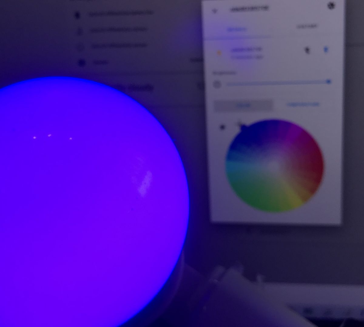

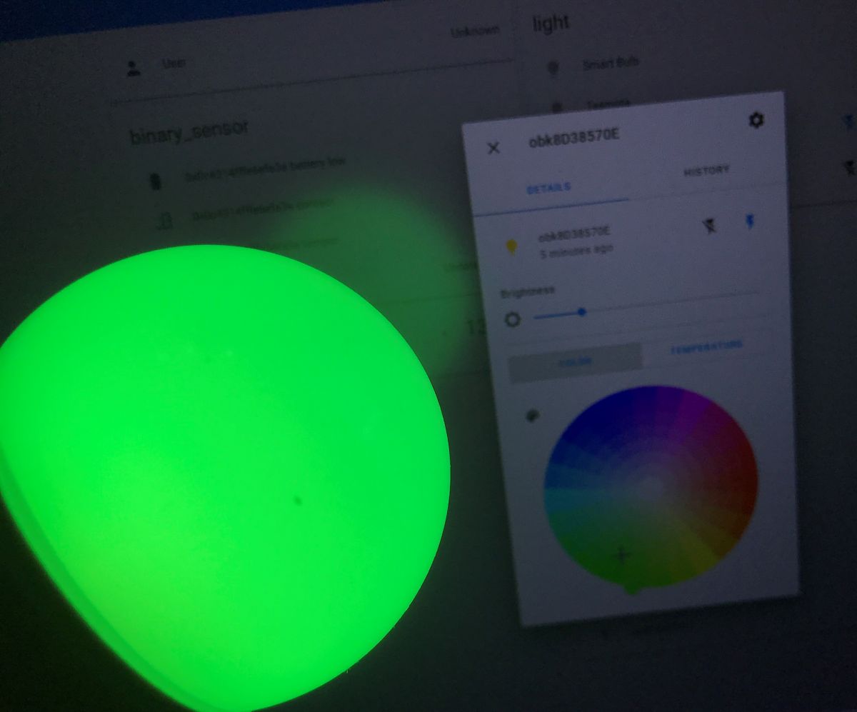

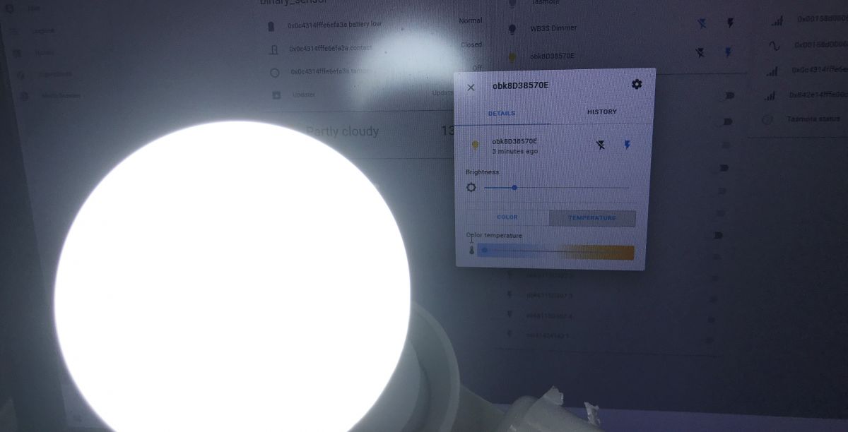

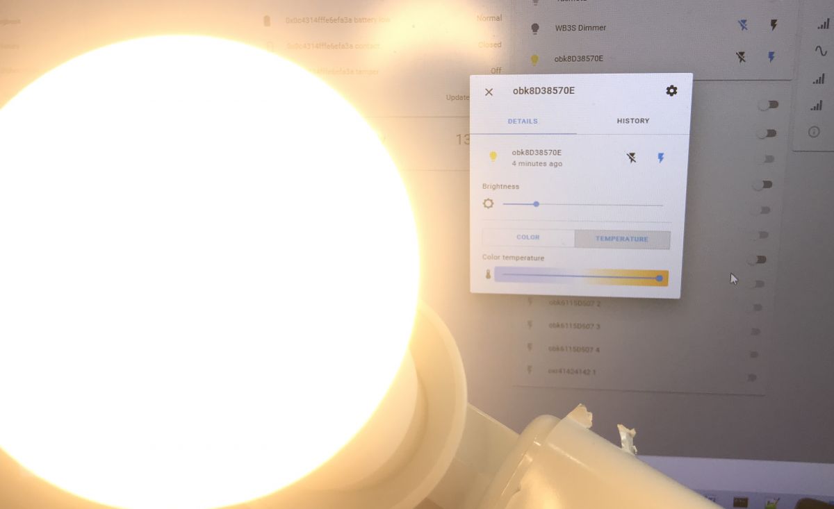

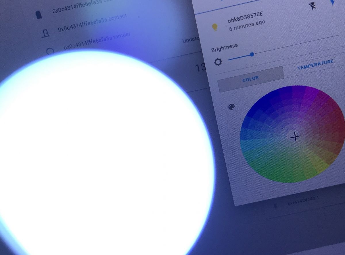

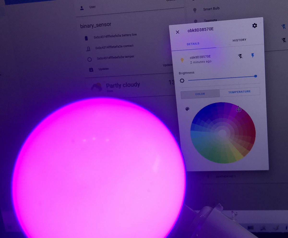

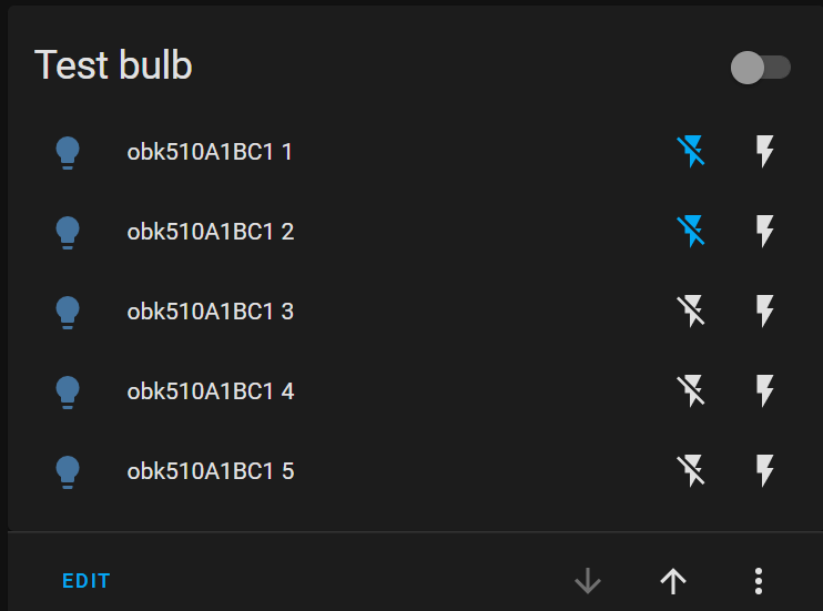

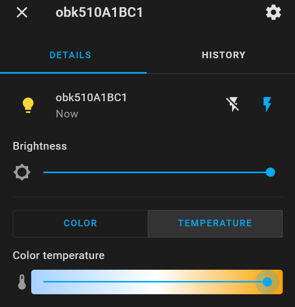

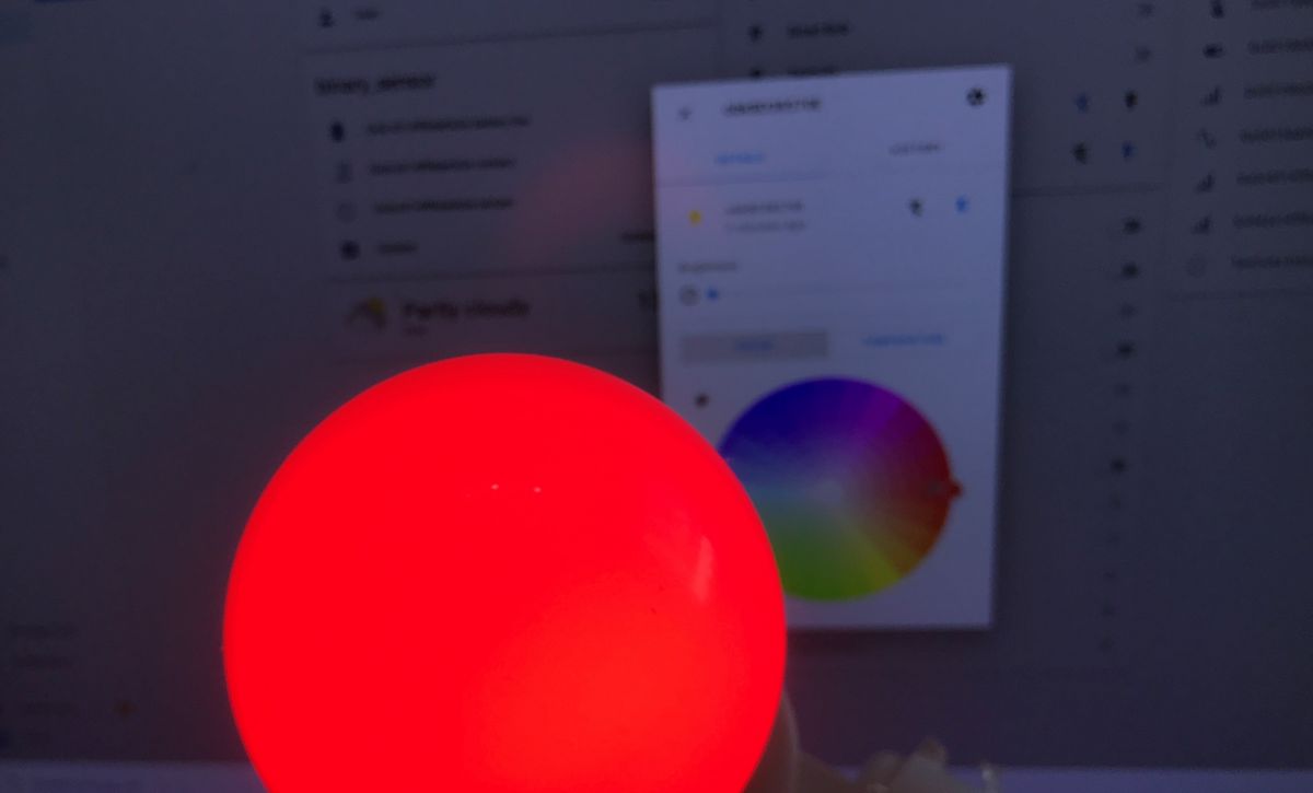

    I have just written a custom driver for RGBCW lighting based on 5 PWMs and tested it on BK7231N, would you like to test it on your device?
    Here is how it looks like in Home Assistant:
    Click here to see hidden options:
    In color mode, you have a color picker. This is RGB only:
    In temperature mode, you get temperature slider:
    See my RGBCW BK7231N LED bulb guide for details here:
    https://www.elektroda.com/rtvforum/topic3880540.html
    (configuration.yaml code for rgb_command_topic, brightness_command_topic, color_temp_command_topic etc included!)

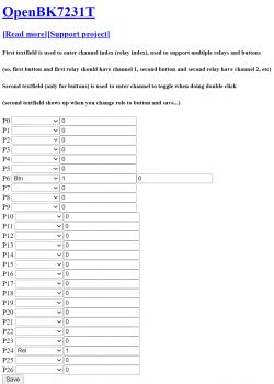

  • 3-way switch uses load sensing for state detection
    #397 19973258

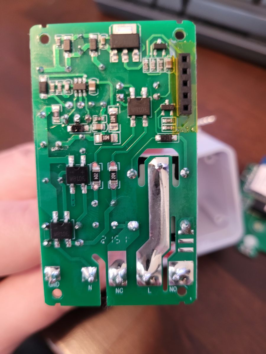

    windex007
    Amazing work on this project! I am super impressed!

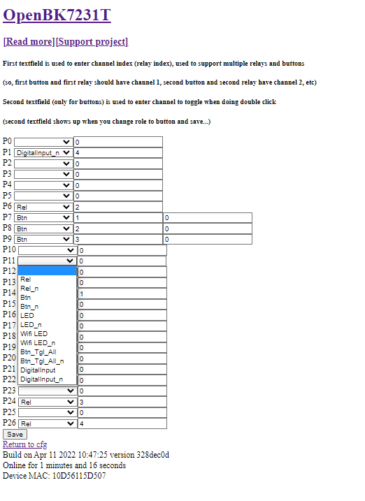

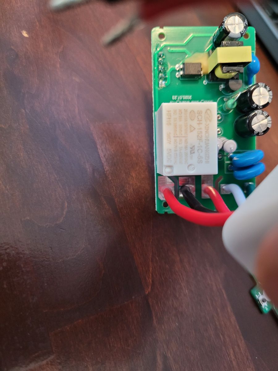

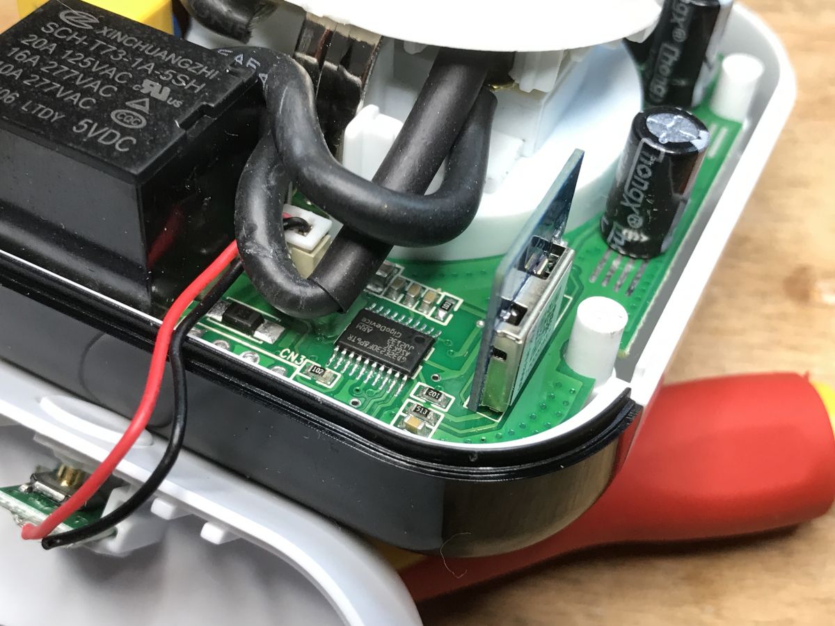

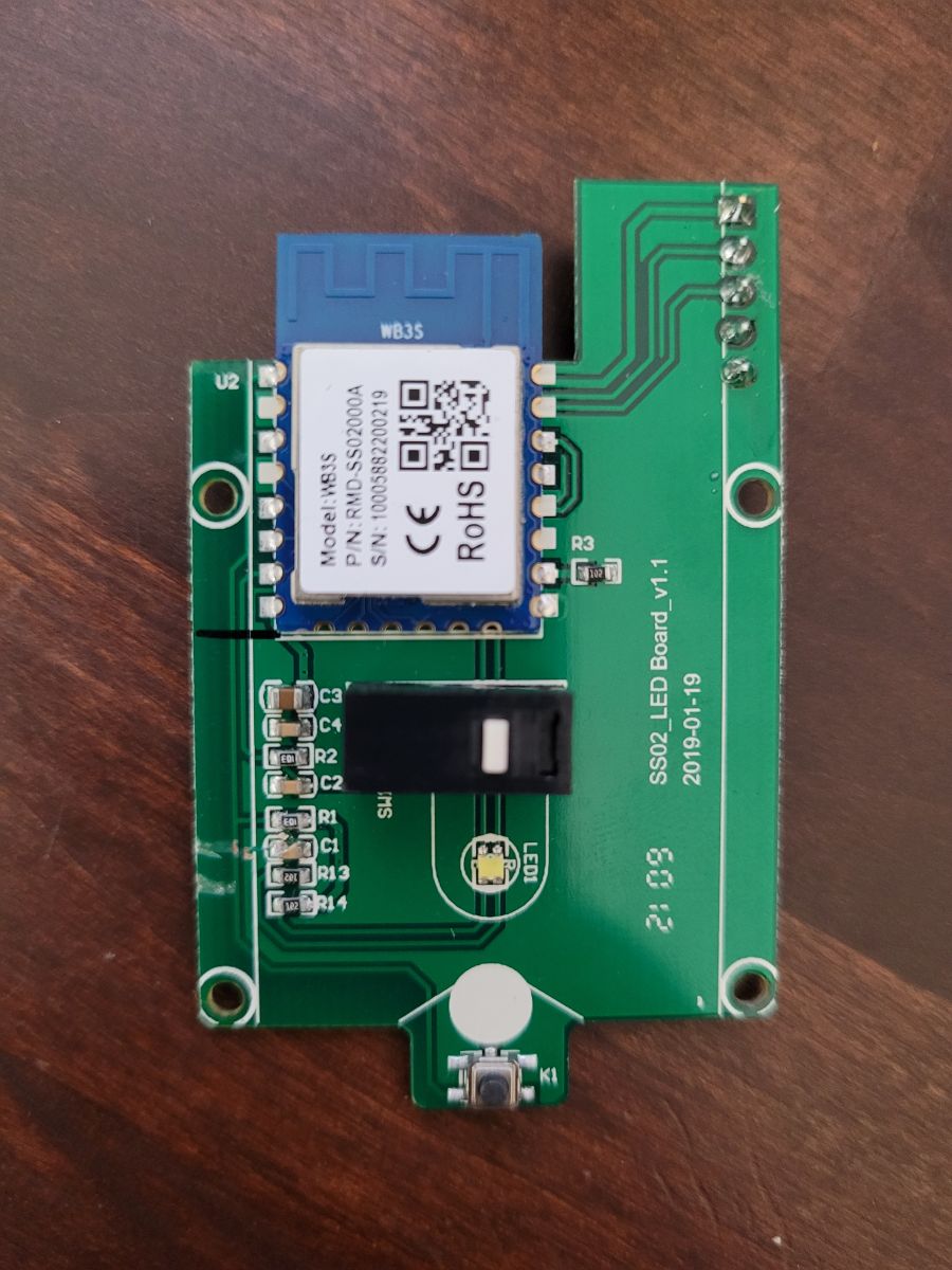

    I bought some smart switches that up until recently were ESP based and I thought I was going to be stuck to the cloud until I found this project!
    Amazon product link is B07V3XB1QG (don't have enough points to be able to post links I guess)
    These are the switches, they're a 3-way switch which is important for what I need them for.
    Cracking them open I see they've got the Tuya WB3S chips in them which are based on the BK7231T. Datasheet here:
    (Actually don't have enough points to post links, look it up yourself I guess lol)
    [BK7231T] My HTTP server, configurator, MQTT support from Home Assistant [BK7231T] My HTTP server, configurator, MQTT support from Home Assistant [BK7231T] My HTTP server, configurator, MQTT support from Home Assistant

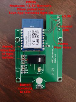

    The guts have 2 parts, a board with the microcontroller on it and then a board with all the High Voltage guts on it. There is a 5 lead interface between the two boards.
    Doing some tests, I was able to determine which of the pins on the interface is driven low/high when you toggle the light in the app with stock firmware. As well, I was able to figure out that one of the pins is attached to some kind of sensor (current?) which detects the actual state of the load (the light). This makes sense since this is a 3 way switch, you can't infer the state of the light by looking at the state of the relay, because if you turn the OTHER switch in the 3-way series on/off, the light will change without the relay in the smart switch changing state. This is why for a 3 way switch, you need to sense the load to know if the light is ACTUALLY on or off.
    Flashing this board was actually really easy. Since the pads are kinda "C" shaped, it was pretty easy to snug some probe leads into the cup shape and just held them there for the flashing. The 5 pin interface has really short pins that I couldn't reliably get into a breadboard so I hooked some test leads to them and that worked fine. All in all, literally no soldering required.
    This is the point where I began to really hit the limit of my knowledge and I'd be interested in some ideas/help.
    I was able to make the switch work using the following configuration:
    I can switch it on, switch it off by physically pressing the switch. Hooking it into home assistant with the following config:
    I was able to toggle the relay on/off using home assistant. SWEET.
    However, the device is reporting its state simply by saying the state of the relay. That works fine IF I only ever use the smart switch, but as soon as I flip the other switch in the 3-way circut, the state that the smart switch reports will be inverted (saying the light's off when it's really on, and on when it's really off).
    What would be ideal is if what the MQTT reported regarding state was ACTUALLY if PWM5 (P26) is being pulled low or not, because for this switch that is the real truth as to if the load (light) is actually on or not.
    Any thoughts on how to achieve this?

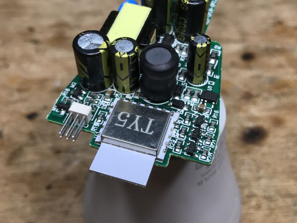

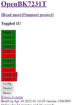

    New I2C update!
    I have added MCP23017 driver.
    MCP23017 is a 16 bit port expander.
    It allows you to connect, for example, 16 relays to single I2C bus.
    With current system, it's possible to map 16 pins of MCP23017 to OpenBeken channels.
    Here is used command:
    backlog setChannelType 5 toggle; setChannelType 6 toggle; setChannelType 7 toggle; setChannelType 8 toggle; setChannelType 9 toggle; setChannelType 10 toggle; setChannelType 11 toggle; addI2CDevice_MCP23017 I2C1 0x27; MCP23017_MapPinToChannel I2C1 0x27 7 5; MCP23017_MapPinToChannel I2C1 0x27 6 6; MCP23017_MapPinToChannel I2C1 0x27 5 7; MCP23017_MapPinToChannel I2C1 0x27 4 8; MCP23017_MapPinToChannel I2C1 0x27 3 9; MCP23017_MapPinToChannel I2C1 0x27 2 10; MCP23017_MapPinToChannel I2C1 0x27 1 11
    Command was used on 4 relays driver. Channels 5, 6, 7 etc are mapped to expander bits.
    Here is how it looks like in UI (I didn't bother adding all 16 channels, just few of them):
    Here are LEDs during test:
    Here is whole setup (ignore TC74 temperature sensors on I2C bus, let's focus on MCP23017):
    Adnotated:
    Now you might ask - why? Why 16 channels? Why MCP23017?
    This is because it allows use to use this module:
    That would be a very cheap and nice hack to get a lot of relays controlled. Also, you can have multiple MCPs on the same I2C bus...
    Welcome to Elektroda. I'll be happy to help you. I haven't used such a device like the one you have. But you basically want to read the digital state (Arduino digitalRead) on given pin to a channel and get it from Home Assistant?
    I can add this functionality for you tomorrow. If that's what you need.
  • Proposes digitalRead pin state reporting to Home Assistant
    #399 19973540
    windex007
    Thank you for the warm welcome and thank you so much for the work you've done so that people like me aren't stuck relying on cloud services for the smart devices we own!
    And yes, if there was a way to do the equivalent of a digitalRead on the pin and get that state information to Home Assistant, I think I'd be able to take it from there!
    Cheers

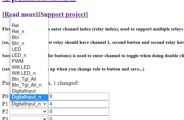

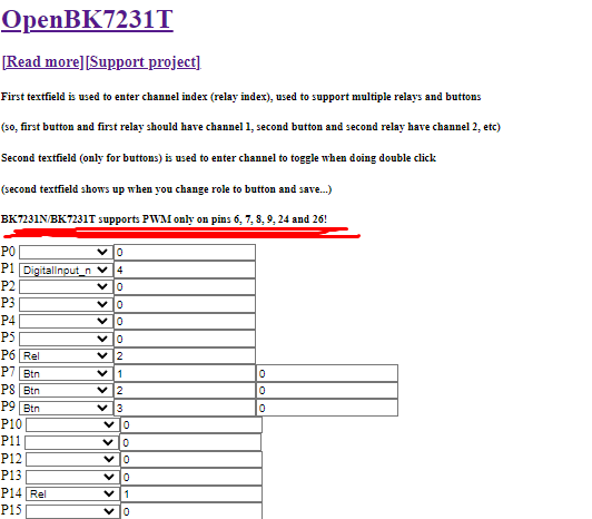

  • Added IOR_DigitalInput support for BK7231T/N and XR809
    #400 19973661
    Posts: 14770
    Rate: 12913

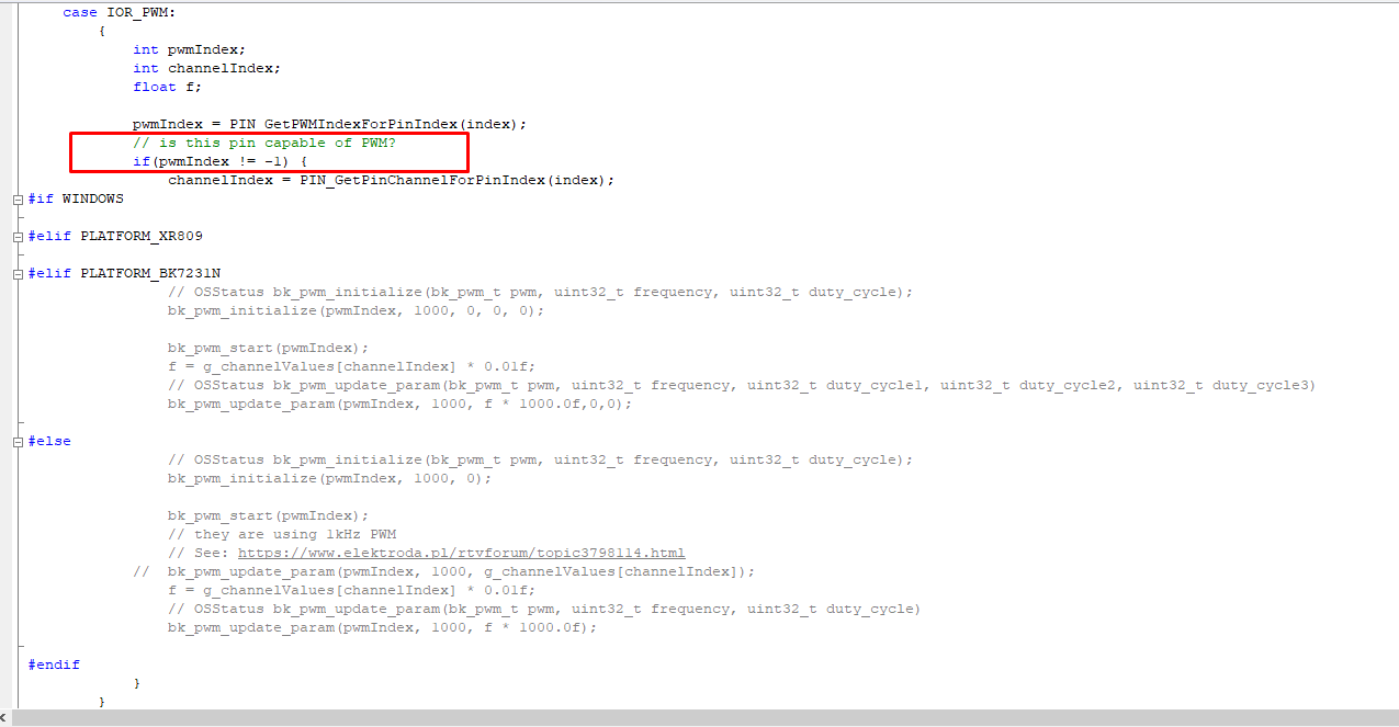

    @windex007 Ok I just added a IOR_DigitalInput and IOR_DigitalInput_n.
    They should work on all 3 platforms -XR809, BK7231N and T.
    They save value to linked channel.
    There is no debouncing whatsover, it's just a digitalread.
    Here is commit:
    https://github.com/openshwprojects/OpenBK7231...mmit/bb8bb26a6d3546b9e1eeef4746fc692ea5e6b428
    Remember to use separate channel to store the read value from DIgital Input, for example, channel 5, and then read it from MQTT by obkBlab/5/get.

  • W600-based TY5 bulb not yet supported
    #402 19973799
    Posts: 14770
    Rate: 12913
    Thanks, that will certainly come in handy for next teardown article.
    I've sent you a PM.

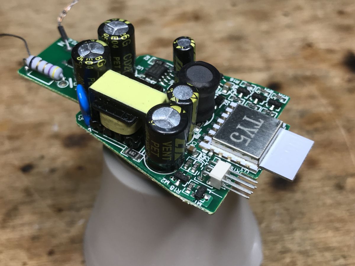

    Today I did another teardown of a smart bulb, but sadly W600 inside. TY5 module. Not supported yet, but maybe someday... it's time to check if manufacturers flash util works!

    @p.kaczmarek2 hi, i just tested tuya-cloudcutter tools to flash openbkt via ota to my led bulb and it was successful
    Only issue I'm facing is now after i configured the gpio pins, the webpage stopped responding.
    When I saved the wifi & mqtt settings, and restarted from gui it was still working fine though.
    But now I'm unable to access the webpage and this one of those tuya devices that makes it hard for solder/desolder job for wb2l inside to do further troubleshooting
    Any ideas why that could happen?
    Update - it's no longer broadcasting Openbkt AP when turned on

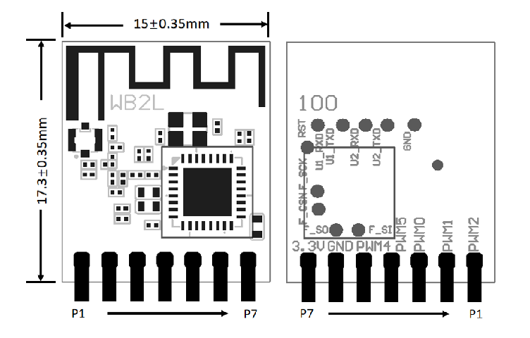

  • PWM role on non-PWM pin crashes BK7231T
    #404 19974059
    Posts: 14770
    Rate: 12913
    N or T version? Oh wait, WB2L, so T
    Are you using the lastest binaries (compiled by yourself or released by me yesterday)?
    https://github.com/openshwprojects/OpenBK7231T_App/releases/tag/1.0.5
    There are multiple things that were fixed during last week, including:
    - N version crashing on startup (but if you repower it and power off several times, it will recreate open ap)
    - both T and N versions crashing if you set PWM role to non-pwm pin
    etc etc
    Also few days ago I realized that OTA on N platform still requires some small bugfix, so you should flash now your T devices and wait a bit with all Ns (unless you can solder wires for update)
    Ok so first of all try to reset OpenBK by powering on, waiting few seconds and powering off, do this several times, this should bring back open access point. Then use OTA (it works on T platform) to update to latest binary.
    EDIT: I think you might have done that:
    It's not that you change the role of UART pin, it's that you're trying to set a PWM role for non-PWM pin and thus bk_pwm_stop gets called with -1 argument.
    I see no security check against that in SDK.
    Try this:
    https://github.com/openshwprojects/OpenBK7231...mmit/28e6ee05c32d717f04950f22f8073fafbecfc98e
    When are you binaries dated? That fix was added "@openshwprojects openshwprojects committed 18 days ago "
  • PWM role on non-PWM pins causes crashes
    #405 19974089
    ferbulous
    Posts: 419
    Help: 8
    Rate: 56
    @p.kaczmarek2
    I flashed 1.0.4 for T
    I will do the ota for 1.0.5 for my next bulb that's still working
    This could be the cause for it
    I configured the PWM for these pins right before it crashes
    Am i doing it right? I'm unsure if i should start with P0 or P1
  • PWM crash caused by assigning non-PWM pins
    #406 19974131
    Posts: 14770
    Rate: 12913
    ferbulous wrote:
    1
    @ferbulous have you consulted the datasheet before setting that and investigated connections on PCB with a contuinity tester?
    Here are the pin numbers which supports PWM channels. On Beken, only pins 6, 7, 8, 9 , 24 and 26 can do PWM.
    Code: C / C++
    Do not confuse indices above with channel indices, they are private pwm indexes of beken, not visible to users.
    I'm sorry, you've set a non-PWM pin to a PWM role and PIN_GetPWMIndexForPinIndex returned -1, and then:
    Code: C / C++
    bk_pwm_initialize and bk_pwm_start got called with -1 which crashes Tuya SDK (the Beken devs didn't bother with adding our of range check).
    The out of range check is now added by me in the code:
    but it wasn't added in 1.0.4. I'm not sure if there is anything I can do more for you right now. Resetting to open AP won't most likely work because pins are set first, no one expected a crash there. I can try to update binaries more often but I think more testing is needed.
    Hmm now you gave me idea, I might also modify the HTTP code to show PWM only for PWM-capable pins... hmm I will do that now.
    Ahhh, and I will remove the manually uploaded binaries that are from over a month ago.
    EDIT: Ok removed:
    https://github.com/openshwprojects/OpenBK7231...mmit/328dec0d3ba9d437c6c8f5dd78aa9f250551d80c
    EDIT2:
    PWM option is no longer shown on PWMs that do not support PWM:
    Also added information:
  • Question about serial recovery and RGB bulb setup

    That means the only way to recover the bulb with crashed openbkt would be to use serial method and flash the firmware again since reset is not possible?
    As for the rgb bulb control, how do i get it to show as single led bulb with color/temperature controls instead of switches?
    light:
      - platform: mqtt
        state_topic: "obk510A1BC1/1/get"
        command_topic: "obk510A1BC1/1/set"
        brightness_command_topic: "obk510A1BC1/1/set"
        on_command_type: "brightness"
        brightness_scale: 99
        qos: 1
        payload_on: 99
        payload_off: 0
        retain: true
        optimistic: true
        availability_topic: "obk510A1BC1/connected"
      - platform: mqtt
        state_topic: "obk510A1BC1/2/get"
        command_topic: "obk510A1BC1/2/set"
        brightness_command_topic: "obk510A1BC1/2/set"
        qos: 1
        payload_on: 99
        payload_off: 0
        retain: true
        optimistic: true
      - platform: mqtt
        state_topic: "obk510A1BC1/3/get"
        command_topic: "obk510A1BC1/3/set"
        brightness_command_topic: "obk510A1BC1/3/set"
        qos: 1
        payload_on: 99
        payload_off: 0
        retain: true
        optimistic: true
      - platform: mqtt
        state_topic: "obk510A1BC1/4/get"
        command_topic: "obk510A1BC1/4/set"
        brightness_command_topic: "obk510A1BC1/4/set"
        qos: 1
        payload_on: 99
        payload_off: 0
        retain: true
        optimistic: true
      - platform: mqtt
        state_topic: "obk510A1BC1/5/get"
        command_topic: "obk510A1BC1/5/set"
        brightness_command_topic: "obk510A1BC1/5/set"
        qos: 1
        payload_on: 99
        payload_off: 0
        retain: true
        optimistic: true
    What kind of bulb do you have, can you post photo?
    RGBCW?
    I have prepared a step by step RGBCW guide and configuration yaml file there:
    https://www.elektroda.com/rtvforum/topic3880540.html#19938487
    configuration details for HA are in post #5.
    Right now automatic config gen doesn't support RGBCW, you have to edit config yourself in text editor.

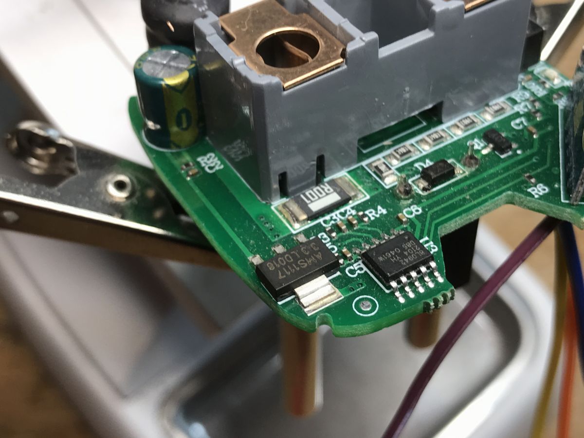

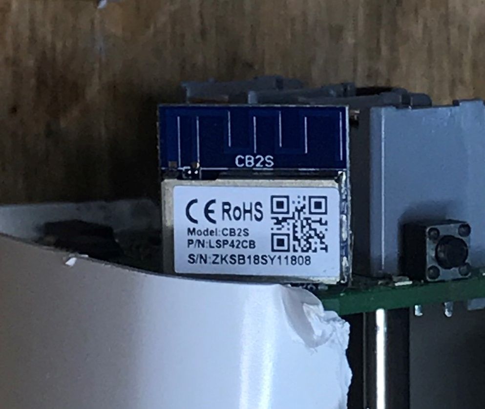

    PS: Support for another peripheral incoming, who can guess which chip I just desoldered?
    CB3S?
  • CB2S plus BL0942 power-metering support incoming
    #410 19974542
    Posts: 14770
    Rate: 12913
    ferbulous wrote:
    @p.kaczmarek2
    I think it's RGCBW as well? It's got red, green, blue, with warm white & cold white
    Do you know if it's 5 PWMs or I2C driver?
    ferbulous wrote:
    I probably could've avoided this if I tested each pin like i usually do
    You could also have avoided it if you read this whole thread and/or used latest self-build version, but now I think I will try to release binaries more often. It's just that I am doing most of development and testing myself and I am never sure if some new change breaks something else or not. @btsimonh helps from time to time but 3 (?) extra test devices is not much.

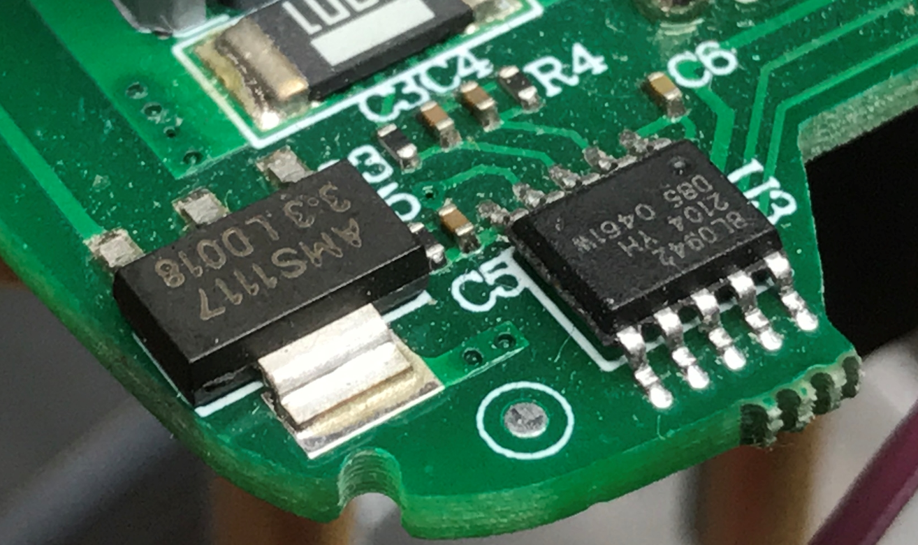

    CB3S?
    CB2S + BL0942, which I plan to support very soon, if everything goes well... that chip has luckily UART interface, should be easy to read out voltage, current and power information.
    First power-metering features in OpenBK!

  • MQTT color and temperature mapping inconsistent

    But it's not consistent or random, like if i change to specific color, doesn't really match the same as in the color pickup
    Same goes for cold & warm sliders

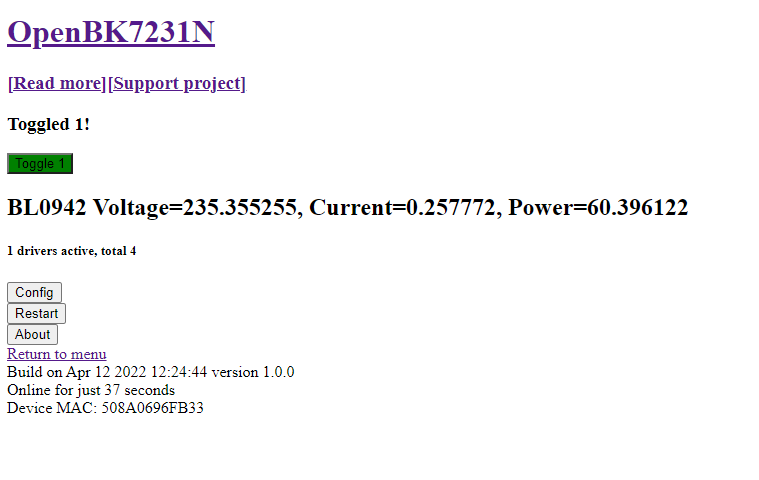

  • BL0942 UART meter and Tasmota-style calibration added
    #414 19975791
    Posts: 14770
    Rate: 12913
    BL0942 energy/voltage/current meter (UART mode) is now working, along with calibration process similiar to one with Tasmota.
    Config:
    Display:
    Calibrating:
    Calibration commands are named as in Tasmota, CurrentSet, VoltageSet, PowerSet.
    I will post detailed guide later. I also need to add a missing MQTT handler for that some Home Assistant can read values.
    I would need to see it. Tell me again, is it a) consistent or b) random? Does 100% red correspond to 100% red?
    There may be a bug, or maybe just my lighting calculations are sloppy and needs to be improved.

  • Home Assistant color tests and brightness sync issue
    #416 19975887
    Posts: 14770
    Rate: 12913
    I took my time today and especially for you I put together back the only Beken smart lightbulb I have. So it's time for some real testing.
    Red:
    Red+Blue:
    Blue:
    Cool white:
    Warm:
    Green:
    All colors at once (RGB, but not CW):
    You can see on the photos when I placed the color choice marker in HA. Can you make the same photos with your bulb and your Home Assistant?
    I will leave my bulb running for a day and see if it resets. I don't know of any way to determine why device restarted.

    @ferbulous test started at 15 , now it's almost 19 and after 4 hours bulb is still OK.
    The only issue I find is the non-refreshed brightness dimmer because HA right now can only send data to bulb and not read. But it will be easy to fix.
  • Brightness dimmer not refreshed because HA is write-only
    #417 19976187
    ferbulous
    Posts: 419
    Help: 8
    Rate: 56
    @p.kaczmarek2 much appreciated
    sorry for late reply, uploading to youtube took forever
    mine was still restarting earlier, just changed to red color and it's still online somehow for the last hour, will check back later on this
    Was gonna point this out, thanks!
  • Diagnostic tests for swapped RGB channels and MQTT publish behavior
    #418 19976219
    Posts: 14770
    Rate: 12913

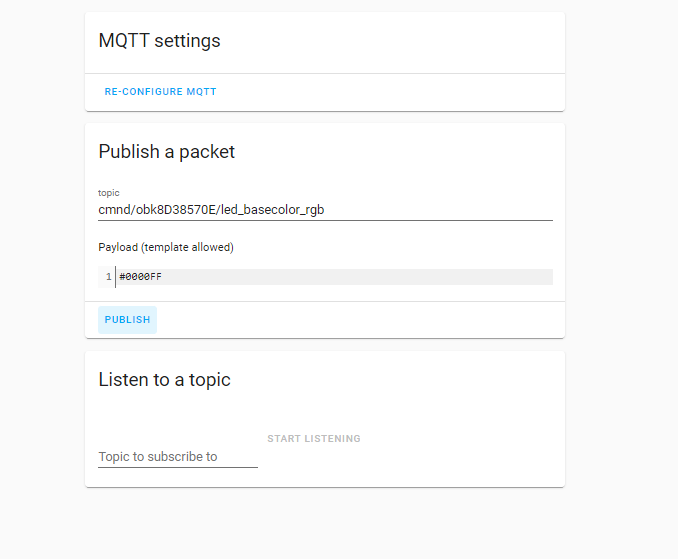

    @ferbulous , this is very strange. It looks like a slowed down response, but I am not sure why.
    I am not sure what to do now. We could try with more debugging. Maybe first test, are you sure that it's not just that channels are swapped (for example, blue swapped with red)? But it doesn't look like that for me.
    Try setting several times 100% red in HA, what is then shown on openbk panel?
    Try setting several times 100% blue in HA, what is then shown on openbk panel?
    Do you know how to use manual "Publish MQTT" in Home assistant? Are you able to simulate a publish send with, for example, R=0x00,G=0xFF,B=0x00 and check how the OpenBK reacts?
    NOTE: it only sets RGB color, the base RGB color, the given color is later multiplied by brightness and also the power value is taken into account (on or off), so don't be confused if you send 00FF00 to bulb and it's still off.
    Also... where can I get such bulb? It is somewhere on banggood or ebay? Or amazon pl? How to find that exact one you have?
    PS: my bulb has different PWMs:
    but I can't see any problem right now.... we both have set R G B C W correctly (1=R, 2=G, 3 =B, 4=C, 5=W)

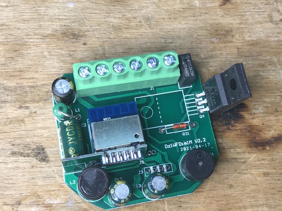

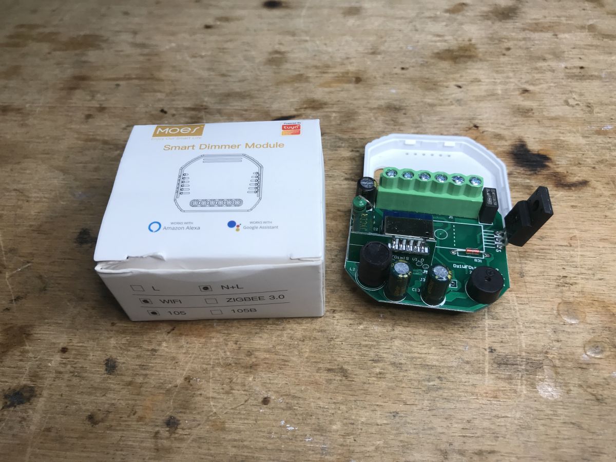

    On a brighter side, I've found another WB2S device, TuyaMCU dimmer:
    WB2S + HT66F3195 ....
