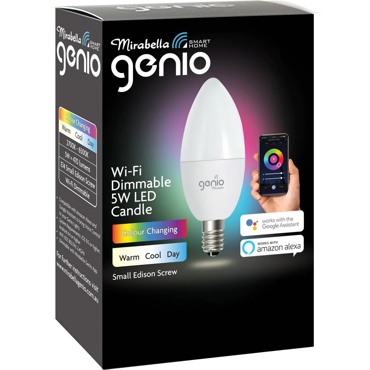

    Guide to Installing BK7231N Mirabella Genio Wi-Fi Dimmable 5W LED Candle, E14 Mount
    ( This is not a teardown, just an installation guide, sorry )
    Part I003987 / GMA-510438-EA
    Mount: E14
    Main module: V1.2.16
    MCU module: V1.2.16
