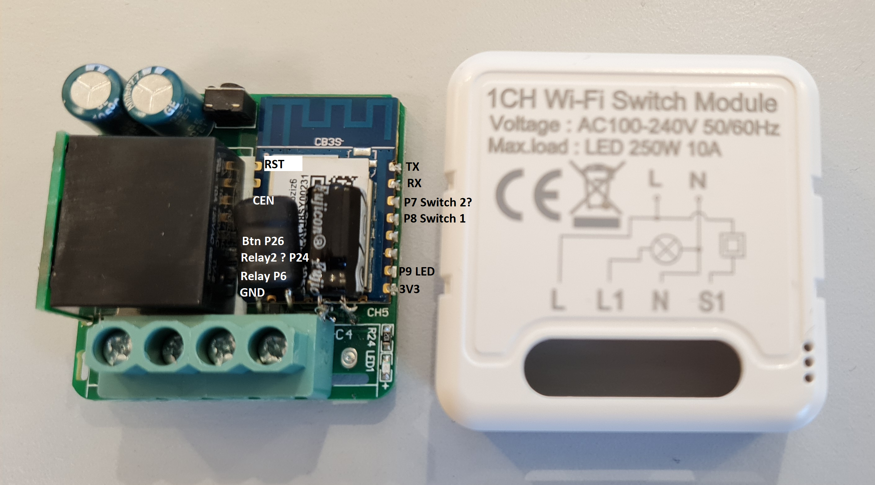

    I found the right pin config etc, but I have a problem with the AC (classic) switch recognition. It works fine while driving the smart switch with 5Volts and then grounding the "AC switch pin (P8)". I can go with "button" or TglOnChnTgl. Works both just fine. But if I power the whole system with AC, the relay just toggles randomly. I kind of think the 0V recognition is too sensitive. It works with the original firmware just fine, no random toggles there.

    so I couldn't succeed with any of these settings and I did further measurements:
    - If AC switch is pressed I read AC(!) 2,4V.
    - If not pressed its 0V AC(!).
    In DC its always 1,3V (no pullup) or always 3V with pullup. No matter switch is pressed or not.
    I have never seen this way of recognizing AC switches before. I think shelly does it the "DC way"?

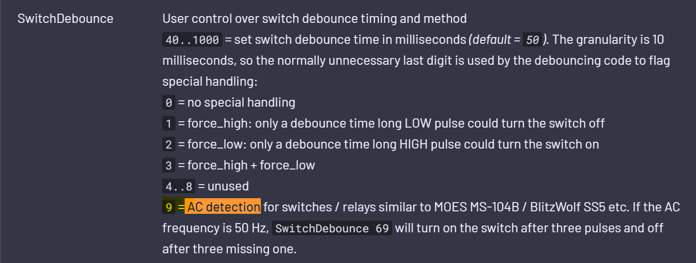

    Edit: Just found this for tasmota - does OpenBK have an equivalent thing?
    OpenBeken CB3S Chip: Random Relay Toggling on 1 Gang Smart Wifi Switch with AC Power
    Edit2: I had the wrong pin for AC Switch recognition. I will correct it in the picture above, its actually P8 ( P7 if you have 2 Gang I assume). So it seems to work with Btn_n just fine (3V AC). Thanks!

    Still, it sounds like the issue is resolved? So the cause of random switching was just a pin configuration error?
  • #5 20489297
    jtauscher87
    Posts: 13
    Yes. With the correct pin it works.
