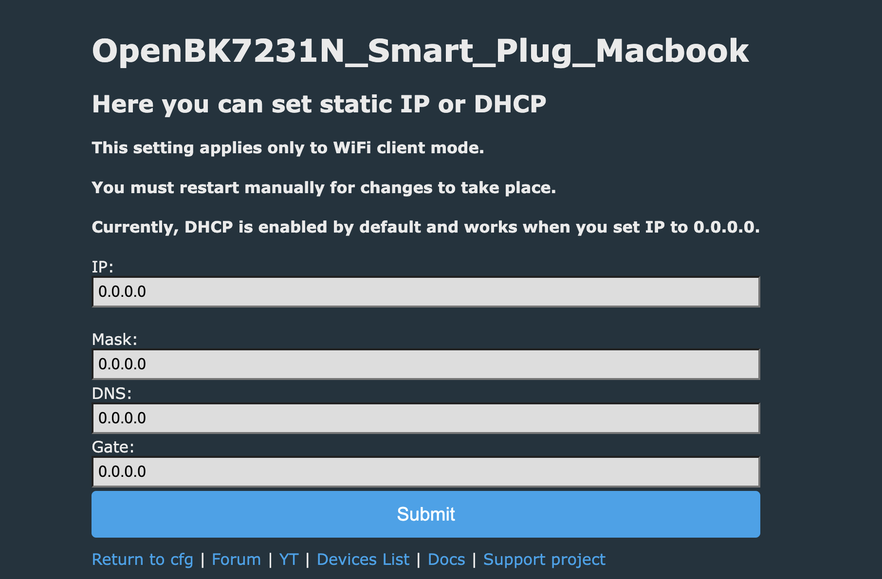

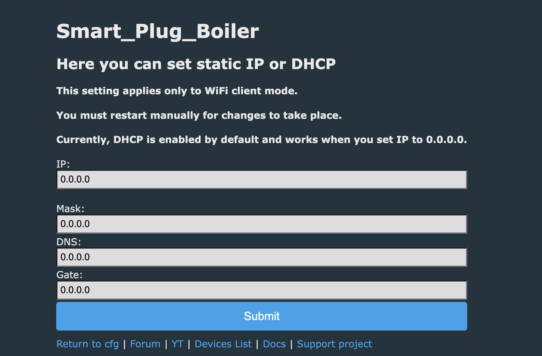

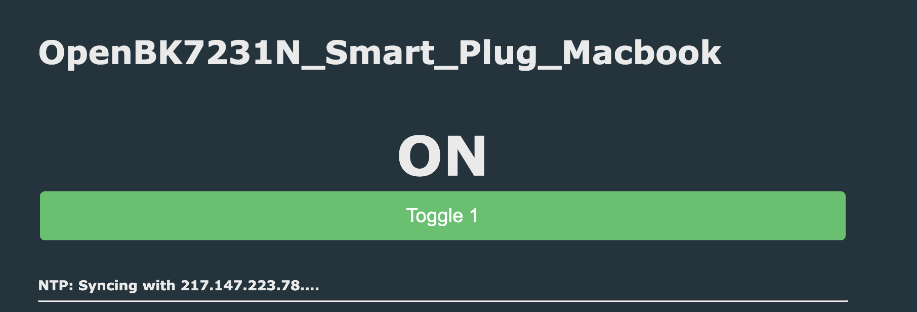

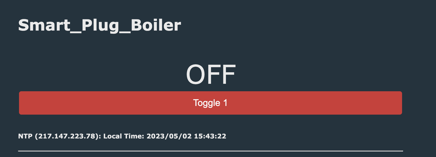

    Hi, I have the same issue, I have two smart switches, and on both, I turned on the NTP driver, but one switch is connected to NTP, another one doesn't
    Here is the result from 1 switch - NTP (): Local Time: 2023/05/02 14:50:07
    here is from 2 switch - NTP: Syncing with 217.147.223.78....
    I tried to change the server to another IP address (91.210.190.13) but the result is the same, it doesn't work.
    Some logs from 2 switch
    Info:MAIN:Started NTP.
    Info:NTP:NTP offset set, wait for next ntp packet to apply changes
    Info:NTP:NTP_CheckForReceive: Error while receiving server's msg

    NTP will retry automatically after 60 seconds. Are you trying to say it fails every time?
  • #9 20563491
    rakalexei
    Posts: 21
    Yes, every time, it never connects. But another switch is connected ok.

    Ok, please remove startDriver NTP from the problematic switch, reboot it, make sure that NTP is not running, wait 60 seconds, and then in console type manually startDriver NTP and tell me if it works for you in that way.
  • #11 20563509
    rakalexei
    Posts: 21
    Yes, it works now. Then I added it back to autoexec.bat and it's working well.
    Thank you very much!
