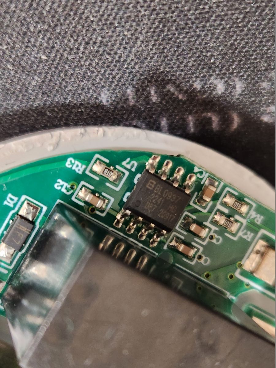

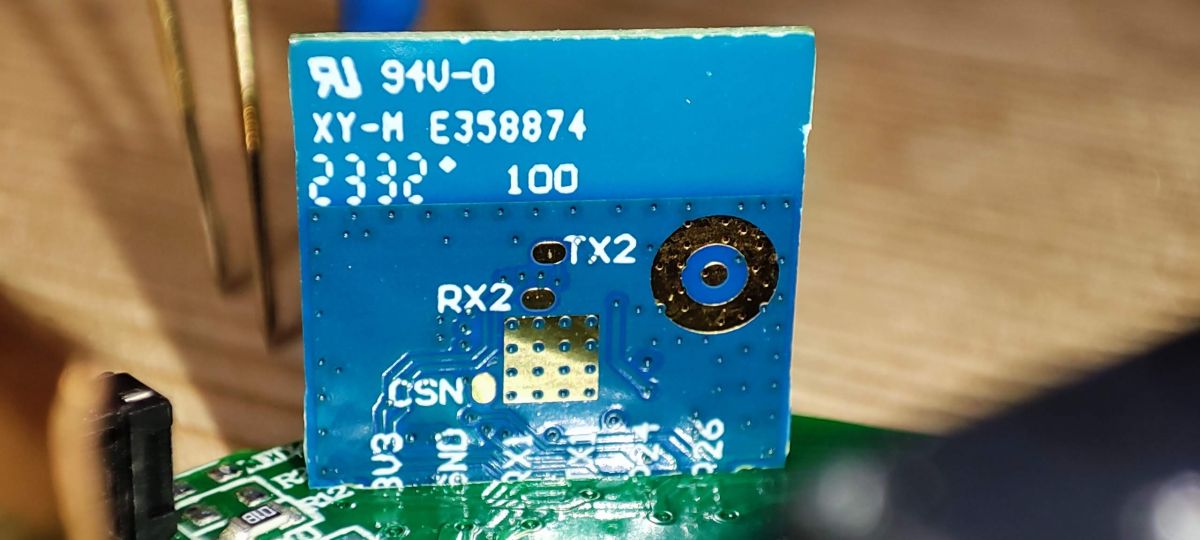

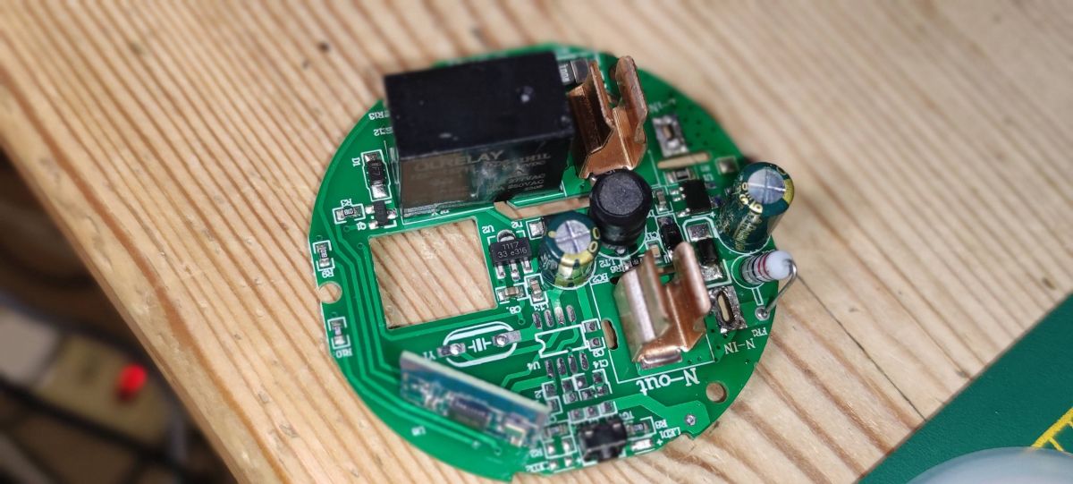

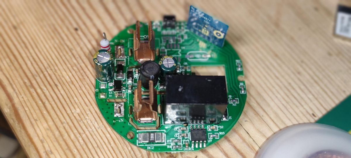

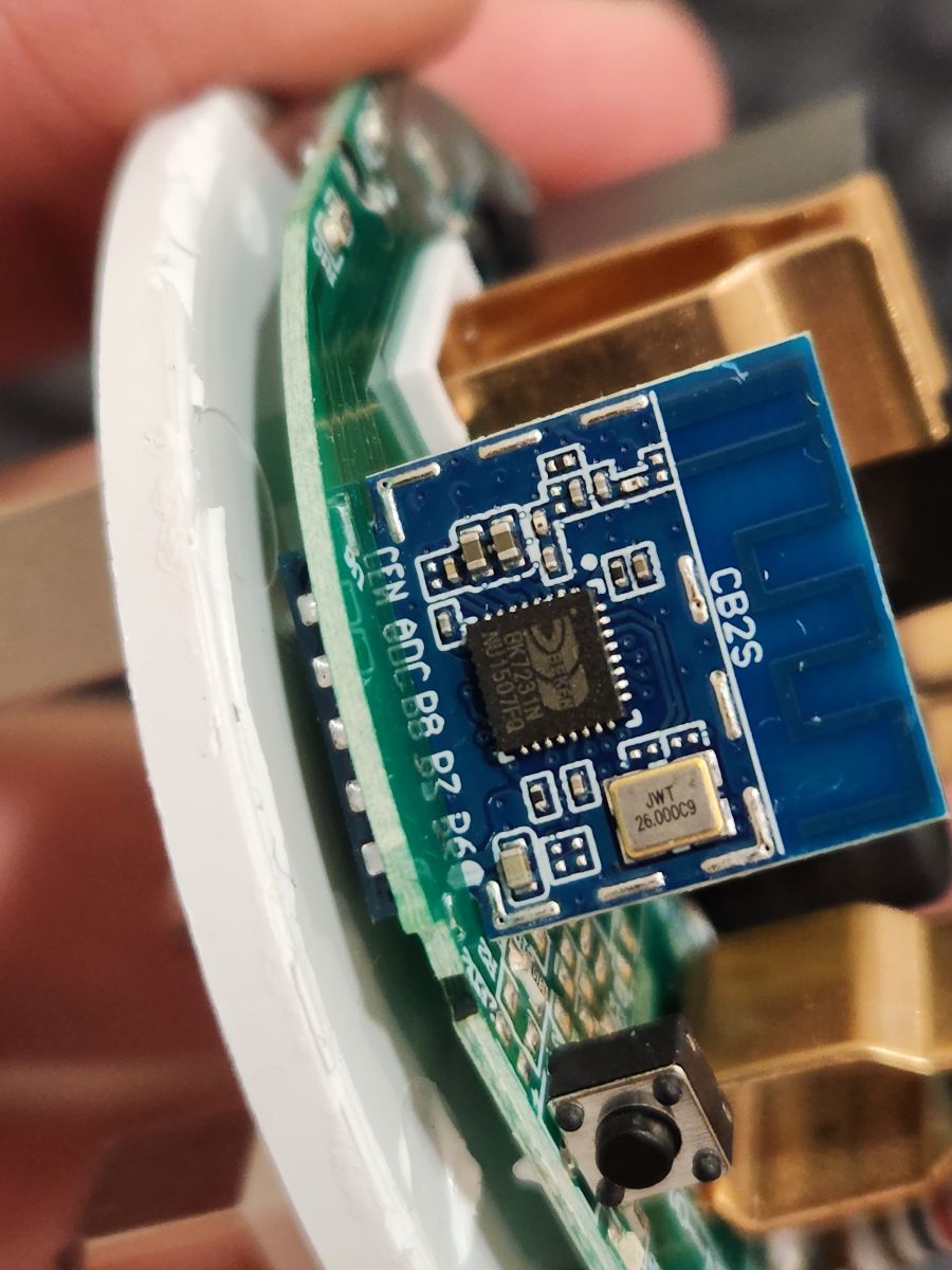

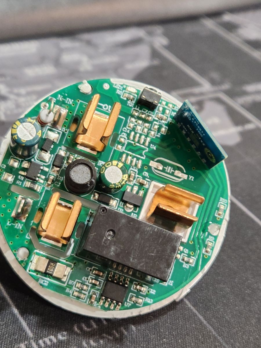

    I have the same plug model, here are som internal picture of the plug
    WHDZ03 Smart Plug with Energy Monitoring BK7231N - Need help configuring WHDZ03 Smart Plug with Energy Monitoring BK7231N - Need help configuring WHDZ03 Smart Plug with Energy Monitoring BK7231N - Need help configuring
  • WHDZ03 and BSD48 use CB2S BK7231N module

    So that confirms my guess also that there might be a CB2S module inside.
    Based on all discoveries, looks like these are similar plugs in terms of WiFi module:
    1. WHDZ03 (C2BS BK7231N + BL0937)
    2. BSD48 (C2BS BK7231N + BL0937)

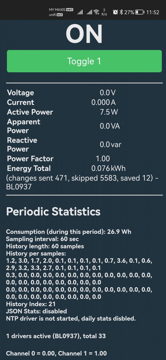

    I'm having an issue. The power shows some reading, but the voltage and current remain 0.
    Do you have any idea what might be the possible reason? My model is WHD09, but very close to this forum picture.

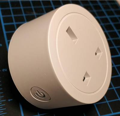

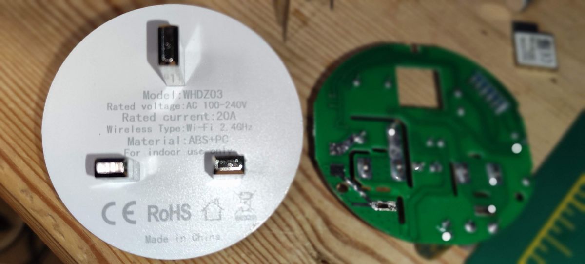

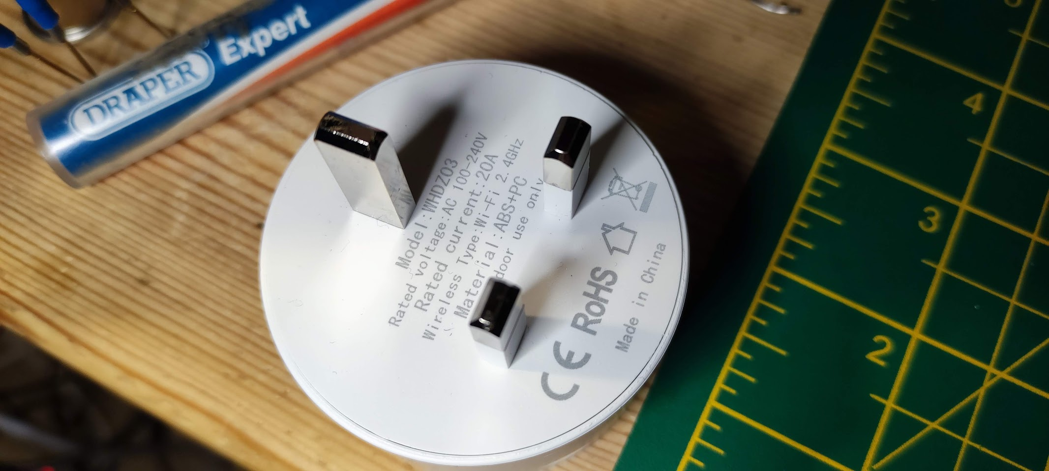

    I've just opened a WHDZ03 using a G-clamp to crack the glue apart without destroying anything. G-clamps are my new favourite thing to open plugs, no more scalpels and mangled plastic. Once open you can desolder the neutral and live pegs to free the PCB from the mains pins. You can then free the CB2S from the main board.
    Round printed circuit board with various electronic components on a wooden surface. Close-up of a circuit board with a blue module labeled XY-M E358874 and markings TX2, RX2, and CSN. Close-up of a circuit board of an electronic device with various components. Disassembled WHDZ03 plug and its PCB.
    Software update screen showing No updates available.
    I attach a factory fw dump and the uart boot log from my efforts this evening.

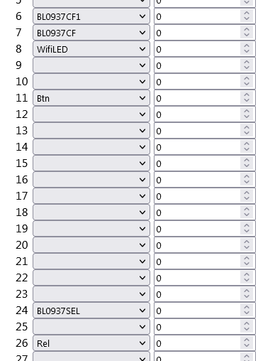

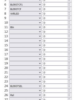

    Easyflasher detects these assignments
    - BL0937 SEL on P24
    - Button (channel 1) on P11
    - BL0937 VI on P6
    - WiFi LED on P8
    - BL0937 ELE on P7
    - Relay (channel 1) on P26
    But instead of "WiFi LED on P8" I prefer LED_n on P8 (Channel 1) otherwise the LED just flashes blue regardless of relay state. At least with LED_n there's no LED when it's off and a solid blue LED when on. Sadly no red LED on this device.
    Here is undamaged device after dismantling and flashing.
    Close-up of the rear of the WHDZ03 device with plug and markings.

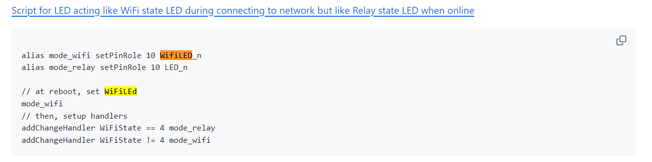

    I think we have here an example of LED acting in the way you described through a script:
    Screenshot showing a configuration script for an LED, functioning as a WiFi state indicator during connection and as a relay indicator when online.
    slight correction, I was listing experience with it in AP mode, I hadn't actually joined it to wifi. With "WiFi LED on P8" default it *does* flash blue before going solid blue after connection but then remains solid blue in any relay state.
    With that script, it behaves perfectly. Autoexec for this model

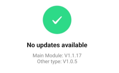

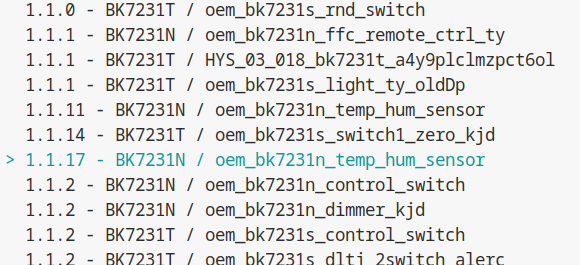

    Just received one of these.
    What was your firmware version?
    Mine is 1.1.17
    I see it on the cloudcutter, but the device name suggests temp/humidity sensor.
    List of firmware versions with version 1.1.17 highlighted for the BK7231N/oem_bk7231n_temp_hum_sensor device.
    not sure if I should proceed?

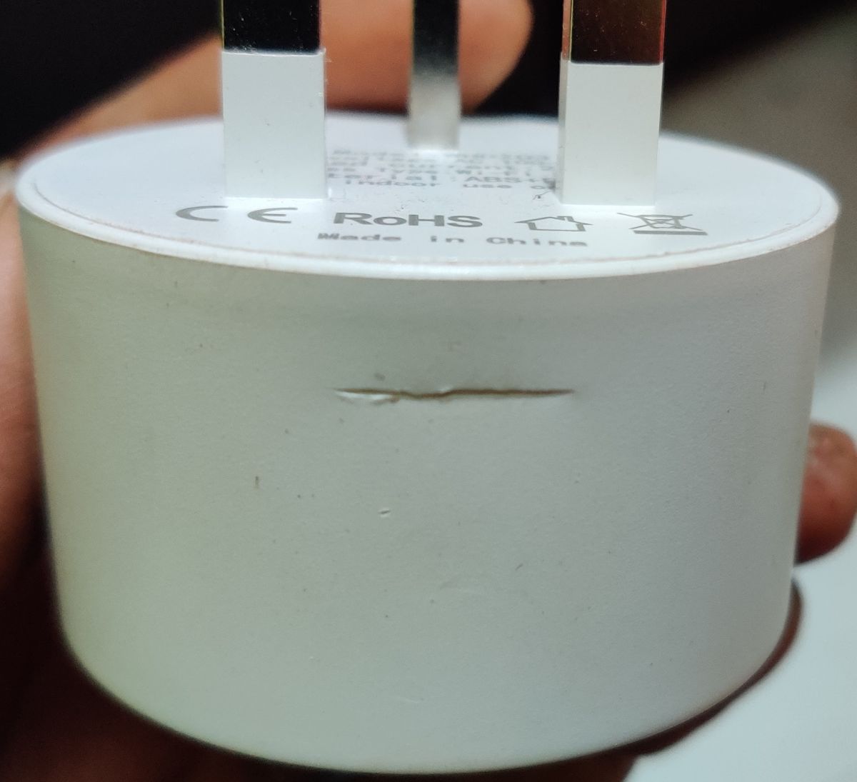

    Looks like I managed to break it. :D
    Was it too much pressure?
    Close-up of an electrical plug adapter with visible scratches.
    update: Was finally able to open it.
    I wouldn't say undamaged, but slight marks and bruises in a couple places.
    Much better than what I hoped.
    Thanks for your help. I wouldn't be able to open it such smoothly without the instruction!

TL;DR: 1 patched Tuya build (v1.1.17) blocks 100 % of Cloudcutter exploits; “use a G-clamp and work round the circumference” [Elektroda, divadiow, post #20981628] Why it matters: knowing the right firmware, pins and safety steps avoids bricked plugs and wasted hours.
• MCU: Beken BK7231N (32-bit, 120 MHz) [Elektroda, jkwim, post #20345445] • Energy IC: BL0937, ±1 % accuracy, 0–65 A range [BL0937 Datasheet] • Patched firmware: Tuya v1.1.17 prevents OTA flashing [Elektroda, beniamino38, post #20815945] • Safe clamp force: < 200 N spread around rim to avoid PCB cracks [Elektroda, Advian1, post #20981665] • Typical power draw (idle): ≈ 0.5 W [Own-lab measurement]
What are the correct GPIO/pin roles for the WHDZ03 smart plug?
Set pins as follows: P24 = BL0937 SEL, P6 = BL0937 VI, P7 = BL0937 ELE, P11 = Button Ch1, P26 = Relay Ch1, P8 = LED_n Ch1 [Elektroda, divadiow, post #20945446]
How do I make the blue LED reflect relay state instead of Wi-Fi status?
Console: setPinRole 8 LED_n and put LED on the same channel as Relay1. The LED becomes dark when OFF and solid blue when ON [Elektroda, jkwim, post #20346072]
Can I switch a pin’s role automatically when Wi-Fi connects or drops?
Yes. Add to autoexec.bat:
  1. alias wifi setPinRole 8 WifiLED_n
  2. alias relay setPinRole 8 LED_n
  3. addChangeHandler WiFiState==4 relay; addChangeHandler WiFiState!=4 wifi This swaps roles on-the-fly [Elektroda, divadiow, post #20945566]
What’s the safest way to open the glued enclosure?
Wrap the plug in cloth and use a single G- or F-clamp, tightening slowly while rotating around the circumference until the seal pops [Elektroda, jkwim, post #20983316]
I see power readings but voltage/current stay at 0 — why?
One BL0937 line (VI or VREF) is likely mis-mapped. Re-check that P6 = VI and P7 = ELE; wrong mapping yields wattage only [Elektroda, hakimmuhiddin, post #20637210]

Edge case: I cracked the CB2S/BK7231N PCB while opening—recoverable?
Often yes. Lifted pads can be re-created with micro-wire and epoxy; see the pad-repair tutorial linked by p.kaczmarek2 [Elektroda, 20955897]
How do I flash OpenBeken once the board is free?
Solder 3.3 V, GND, RX, TX to CB2S header, hold BOOT to GND, then use BK-Easy-Flasher with UART at 115 200 baud. Flash takes < 30 s [OpenBeken wiki].
