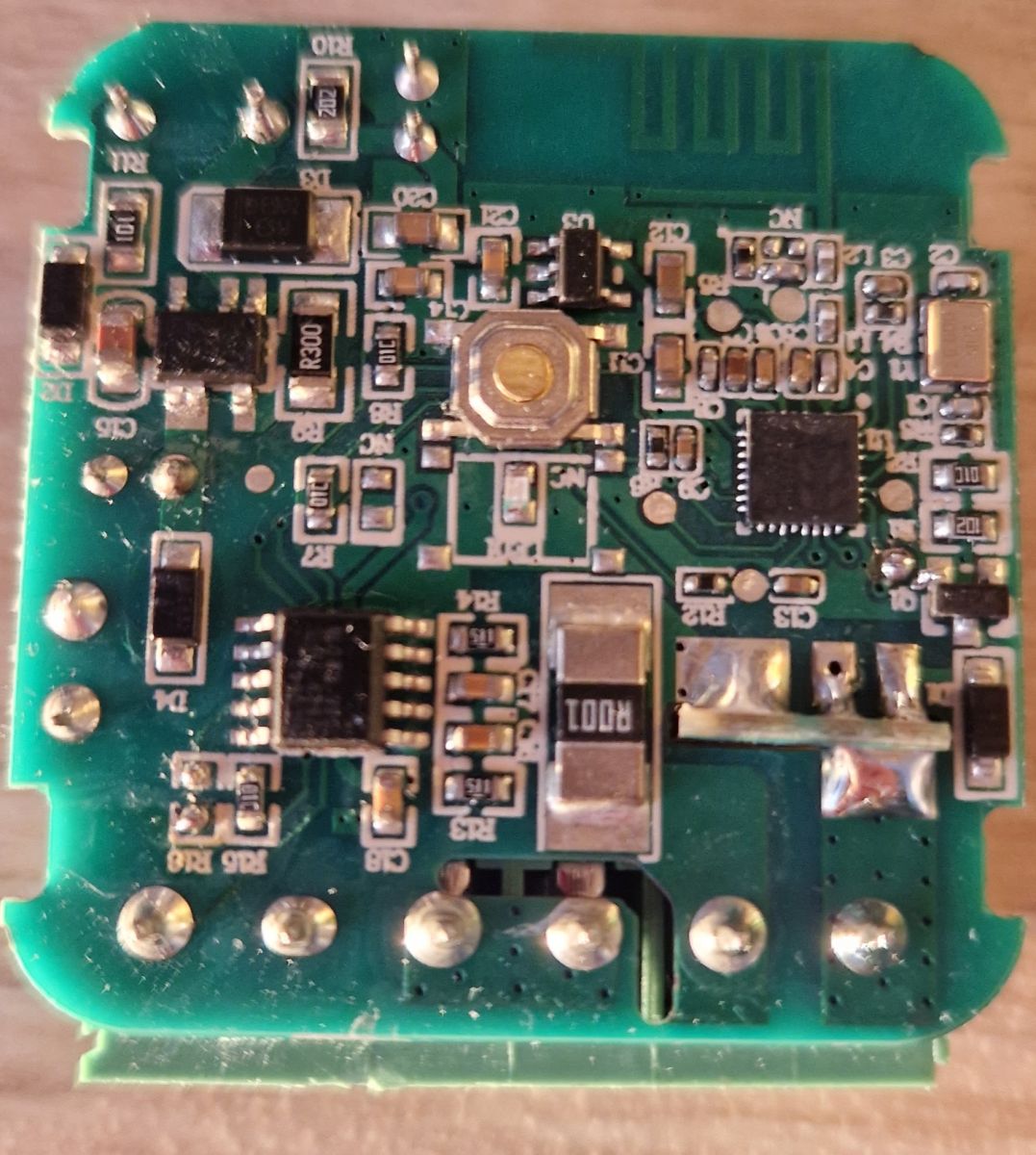

    Hello, I am having a problem defining the switch configuration correctly. I am sending a copy of the original batch.
    • readResult_BK7231N_QIO_openbnk_2025-22-11-12-49-22.bin (2 MB) You must be logged in to download this attachment.

    #40 21759109
    Posts: 14755
    Rate: 12881
    Device seems to be using CB2S module, which is BK7231N chip.
    - Relay (channel 1) on P7
    - WiFi LED on P26
    - TglChannelToggle (channel 1) on P6
    - Pair/Toggle All Pin on P23
    - BL0942 (?) RX on P10
    - BL0942 (?) TX on P11
    Template OBK:
    Remember to calibrate, as in Tasmot, VoltageSet, etc., possibly via the web App under Tools.
    Can you show a picture of your unit?
    Also enable PowerSave 1 (in startup command add).

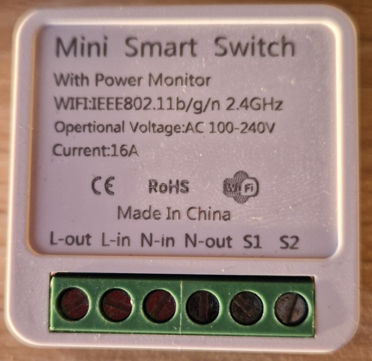

  • Relay toggles with button, but LED stays unsynced

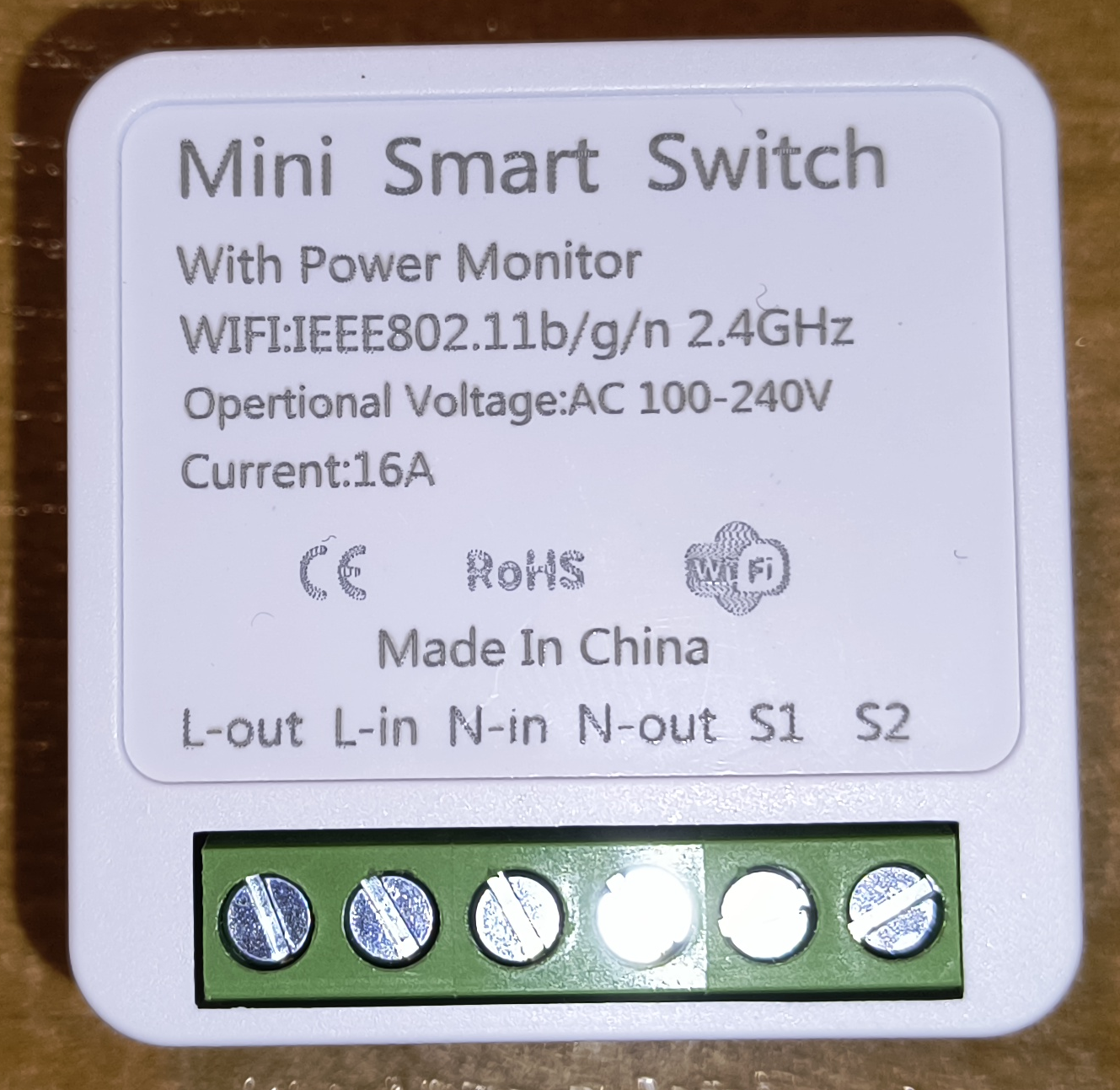

    #41 21759252
    sp8tlh1
    Posts: 7
    Thank you very much for your quick reply. I have another module of the same kind to reprogram and have checked how it works. Pressing the button on the housing switches the relay on and the same button switches the relay off. The LED lights up depending on the state of the relay. After entering this configuration, I can only switch the relay on via the browser and the LED does not respond to the relay status.
    Added after 32 seconds:
    Electronic module with visible SMD components on a PCB board. Mini smart switch with power monitoring and screw terminals
  • #42 21760306
    sp8tlh1
    Posts: 7
    Everything already works as it did in the original before the software change. I can switch the relay physically with a button. To make it work for others starting out with the OpenBk software.
    Go into Configure General/Flags disable the Flag 41 item - [BTN] Ignore all button events (aka child lock), give Submit and Save. And it should work.
    I'm glad I managed it myself.

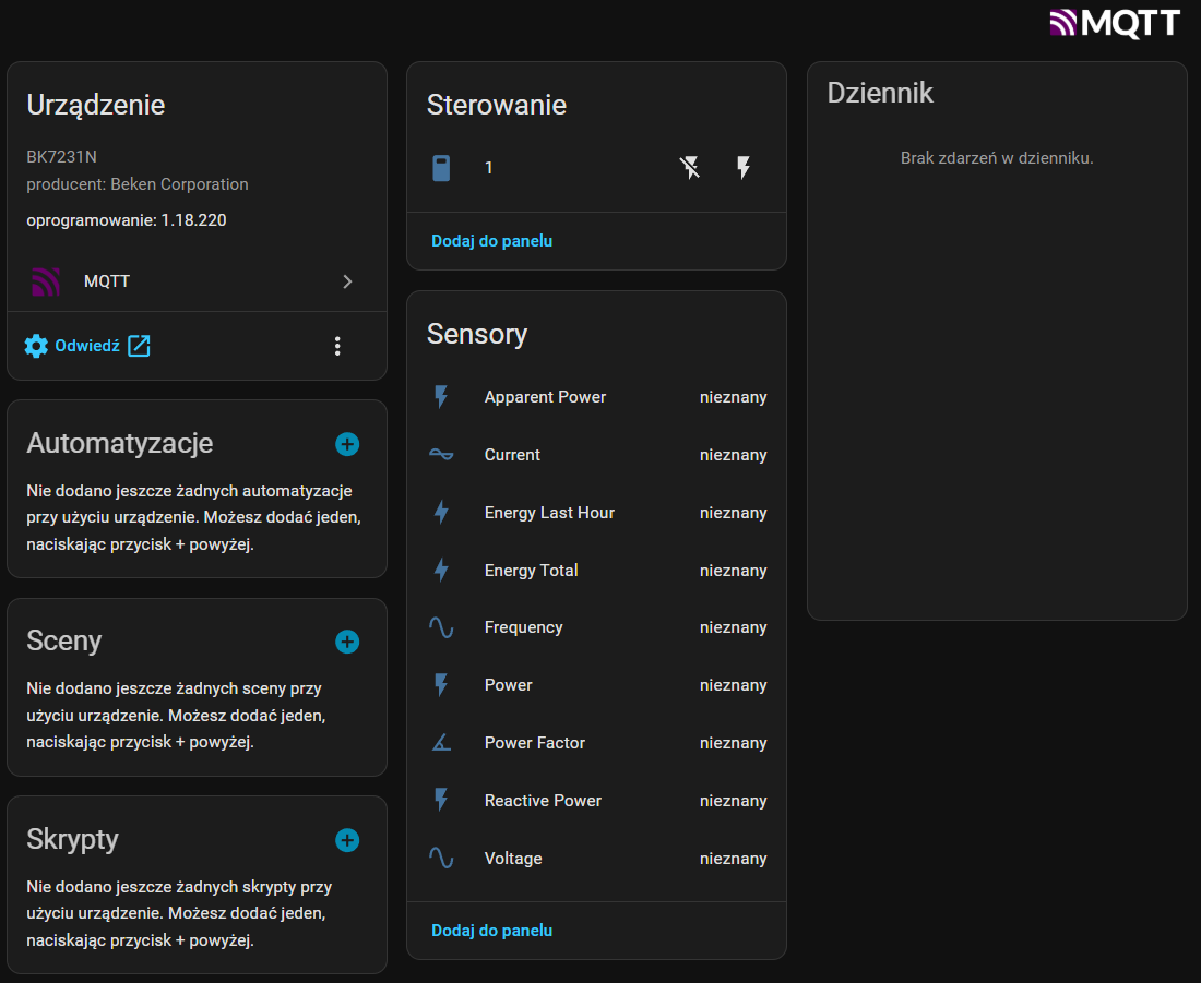

  • MQTT discovery topics mismatch leaves sensors unknown
    #46 21767335
    sp8tlh1
    Posts: 7
    Hello, I have a problem with a module after adding to HA. HA module detects after MQTT and creates an entity. But the sensors have a status of unknown. I asked AI to diagnose and based on the log it stated:
    OpenBK publishes data on topic:
    tele/OpenBK_F85E000B6/ENERGY;
    And entities created by Discovery are listening on topic type:
    OpenBK_F85E000B6/voltage/get
    OpenBK_F85E000B6/energycounter/get
    OpenBK_F85E000B6/power/get
    OpenBK does not publish data on these topics, so the entities remain empty.
    BK7231N device panel in Home Assistant; sensors show “unknown” status
    Maybe some ideas on how to deal with this problem?
  • #47 21769452
    sp8tlh1
    Posts: 7
    Software version 1.18.221 now works without any problems.
    Home Assistant detects the module without any problems and updates all sensors.

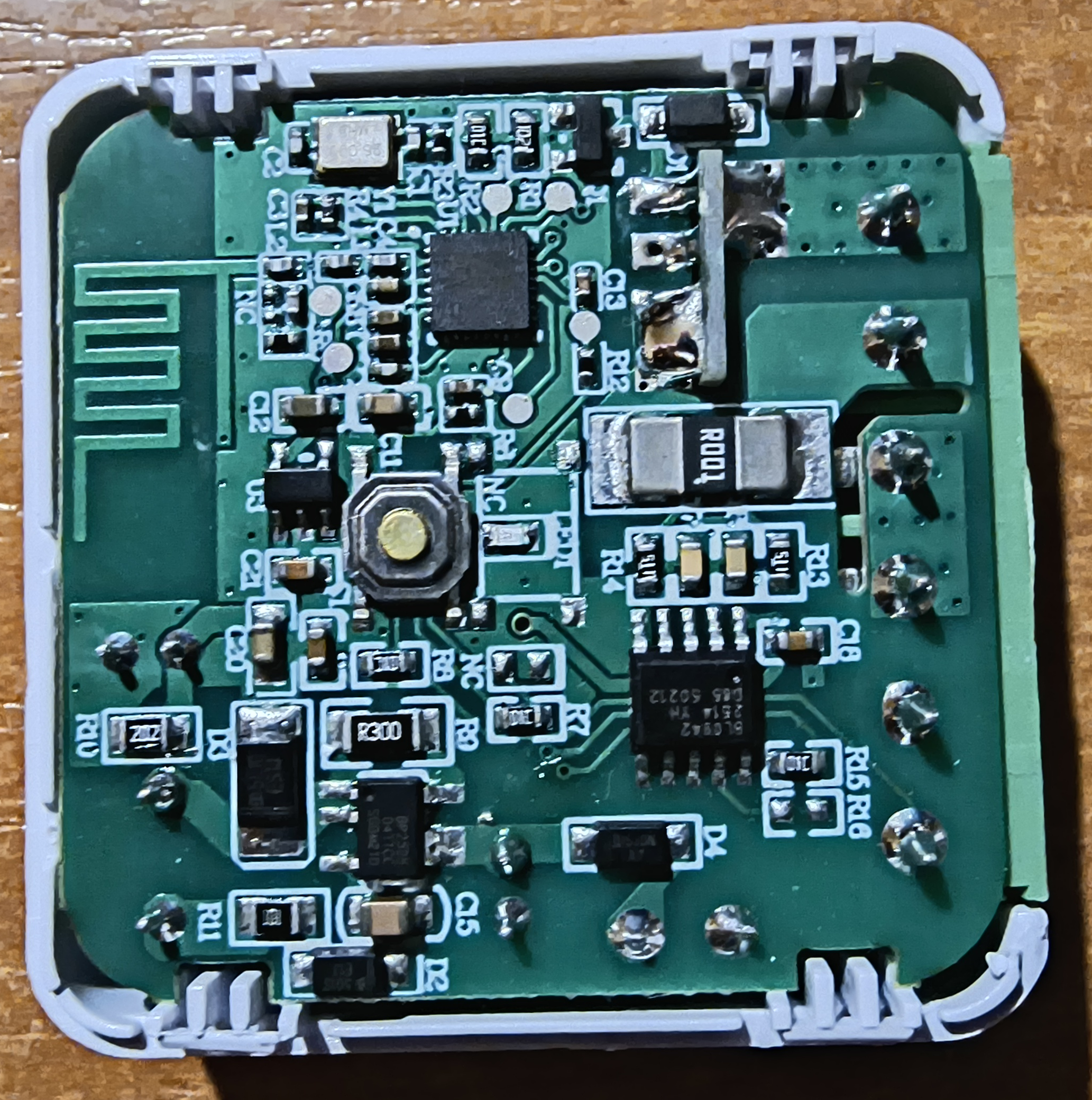

    Rate: 29

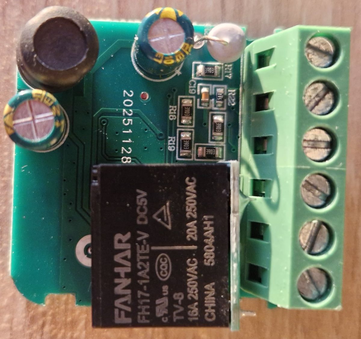

    Got this one too. It's great that it has power monitoring in live leg, so you can put in under switches without neutral going through. Also easy to change capacitors to better ones.
    Tuya firmware though seems to be changed, and not much is readable (or is it bad read?) and so, I do not know pinout, but likely same as above?
    Close-up of a green PCB with SMD components and a printed antenna trace
    Relay module with capacitors and terminal block on green PCB
    Wi-Fi smart switch with power monitor and labeled connection terminals
    • readResult_BK7231N_QIO_2026-16-1-20-17-31.bin (2 MB) You must be logged in to download this attachment.

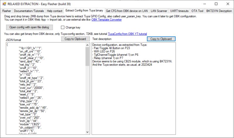

    #50 21811555
    Posts: 5212
    Help: 446
    Rate: 914
    @divadiow and @insmod recently worked on improving GPIO detection, maybe it works with newer version of the flasher?
    extraction fails still even with the release with new methods added https://github.com/openshwprojects/BK7231GUIFlashTool/pull/100
    this failure is because of how much of the json EF is looking through - try https://github.com/divadiow/BK7231GUIFlashTool/actions/runs/21092821480
    Screenshot of Easy Flasher app showing Tuya device configuration in JSON
    an example of:
    divadiow wrote:
    We've already seen users getting no extraction because EF doesn't show/match enough.

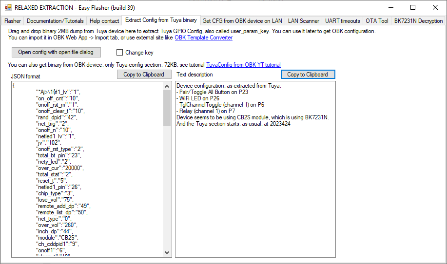

  • BL0942 on P10/P11 and CB2S pinout
    #51 21811634
    miegapele
    Posts: 173
    Help: 15
    Rate: 29
    There is also BL0942 which app does not find. Online tool finds it:
    - WiFi LED on P26
      "vendor": "Tuya",
      "bDetailed": "0",
      "name": "TODO",
      "model": "TODO",
      "chip": "BK7231N",
      "board": "CB2S",
      "keywords": ["switch", "power monitoring", "bl0942"],
      "pins": {
        "6": "TglChanOnTgl;1",
        "7": "Rel;1",
        "23": "Btn_Tgl_All;0",
        "26": "WifiLED_n;0"
      "command": "startDriver BL0942",
  • #52 21812126
