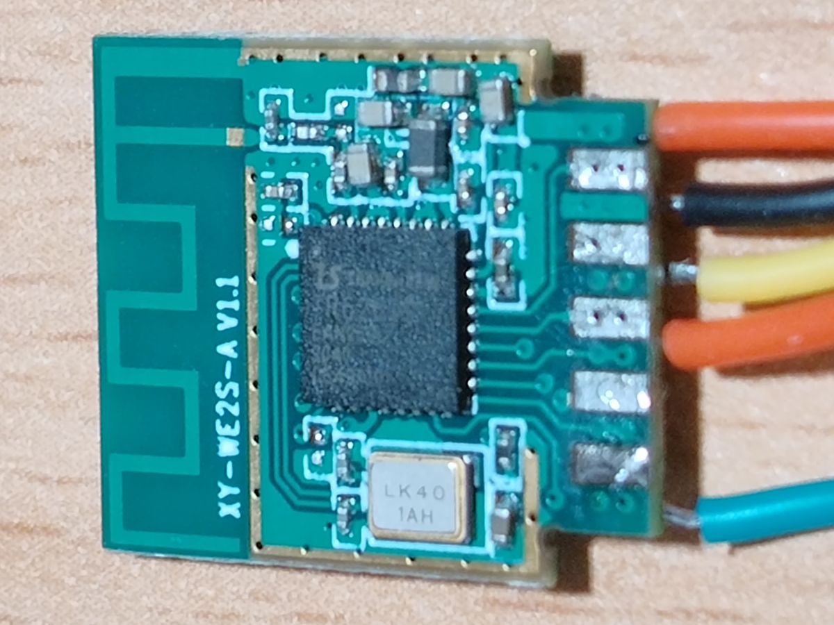

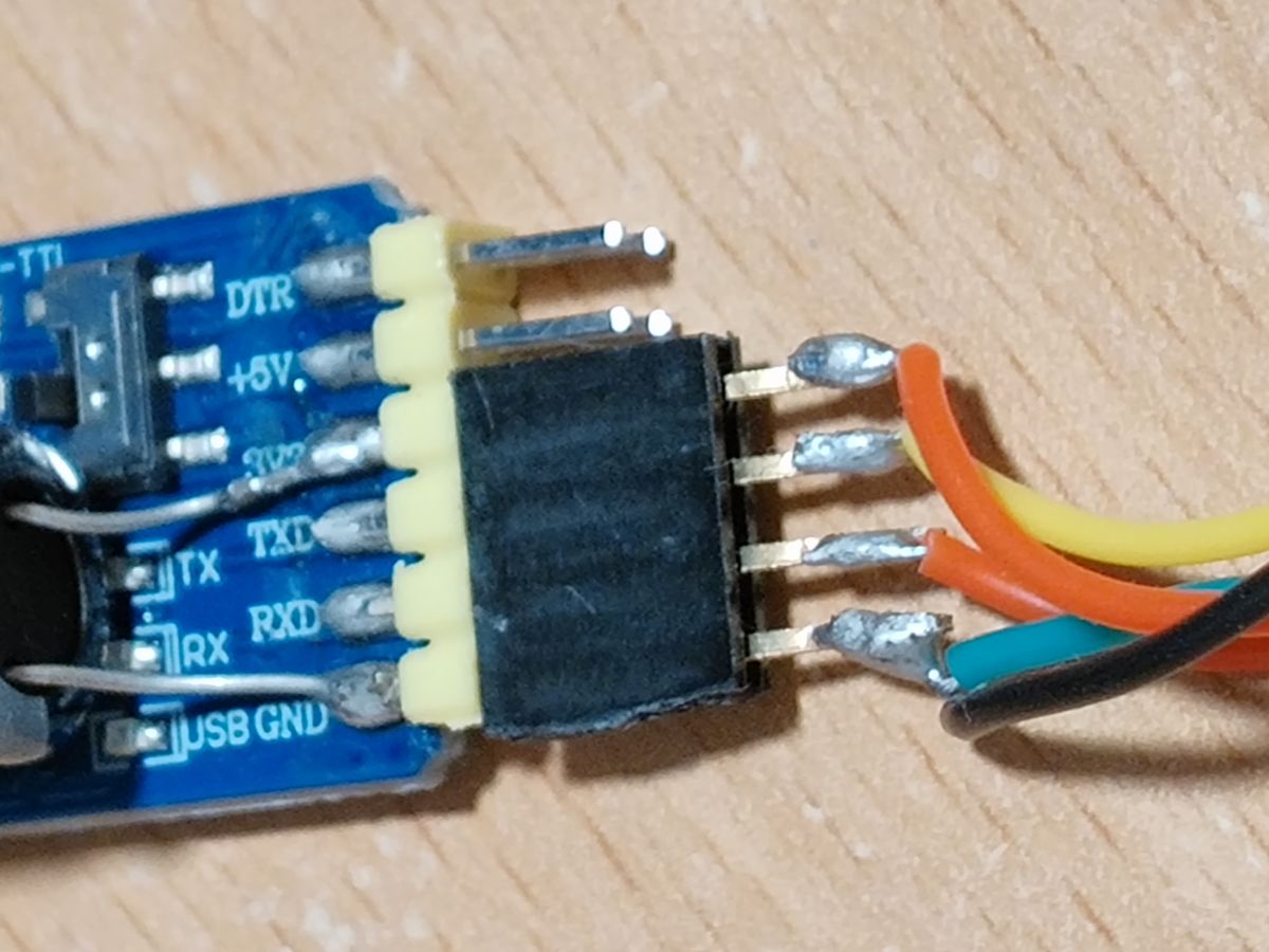

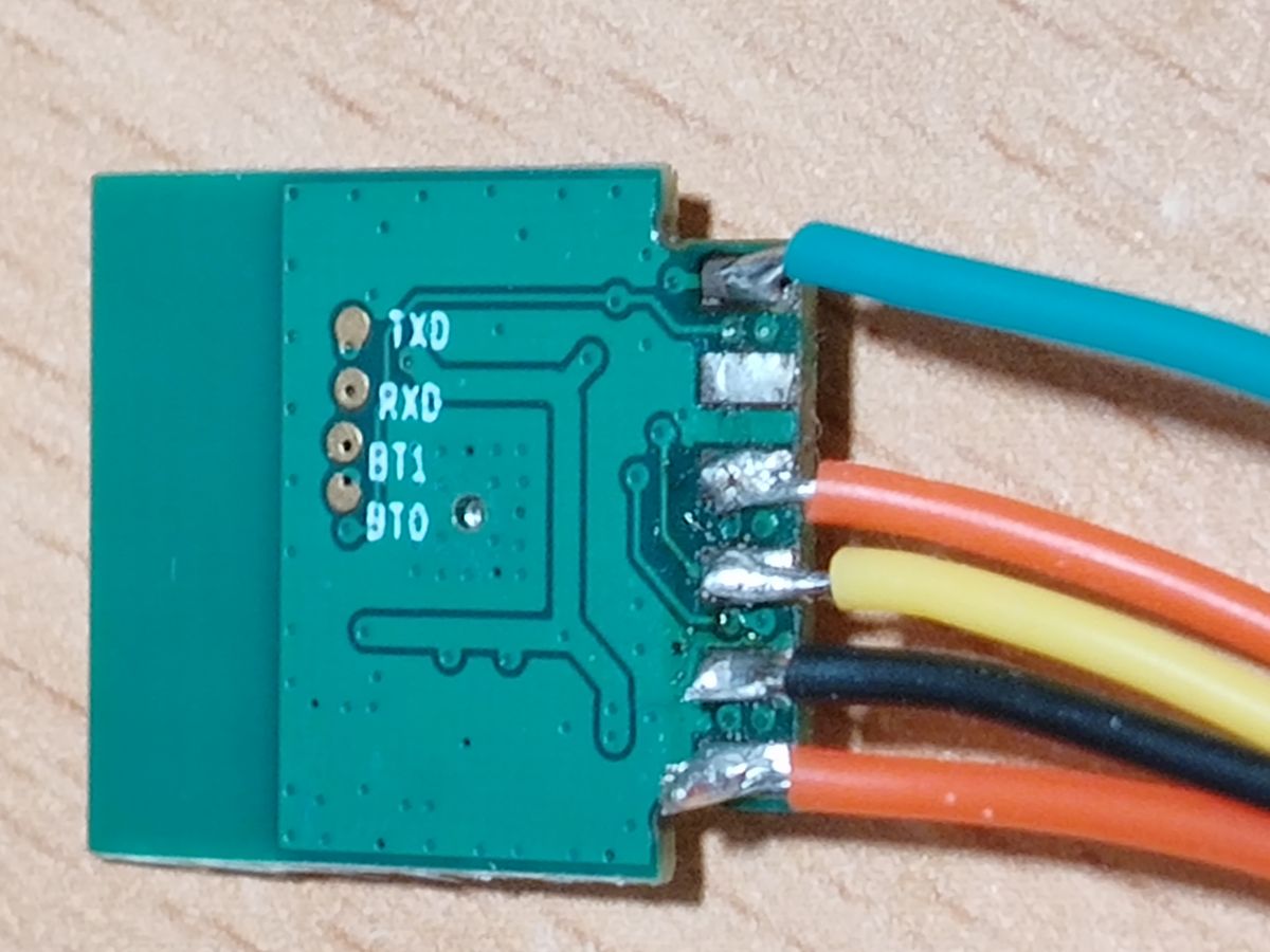

    Close-up view of an ESP module with attached colored wires. ESP-02S module with connected wires Close-up of a USB-TTL module with attached wires. Screenshot of a software uploading tool for the TR6260 microprocessor with an error message.
    works with esp-02s?
    have I moved a jumper setting wrong since? set to usb-ttl right

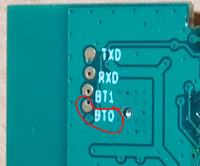

  • Questioning whether the grounded pad is BT0/GPIO14
    #34 21314483
    Posts: 5232
    Help: 449
    Rate: 918
    >>21314458
    not sure what you mean by ESP-02S but what is the pad you've also grounded with the blue cable?
    Close-up of a PCB with soldered wires.

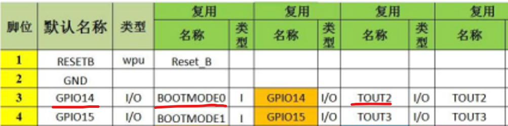

    does it definitely trace to GPIO14/TOUT2 pin on the TR6260 IC?
    if anything it looks like BT0 is perhaps the most likely candidate for GPIO14. BT0=Bootmode0 maybe
    Close-up of a circuit board with pin labels TXD, RXD, BT1, and BT0.
    Table showing pin assignments, highlighting pins GPIO14 and TOUT2.

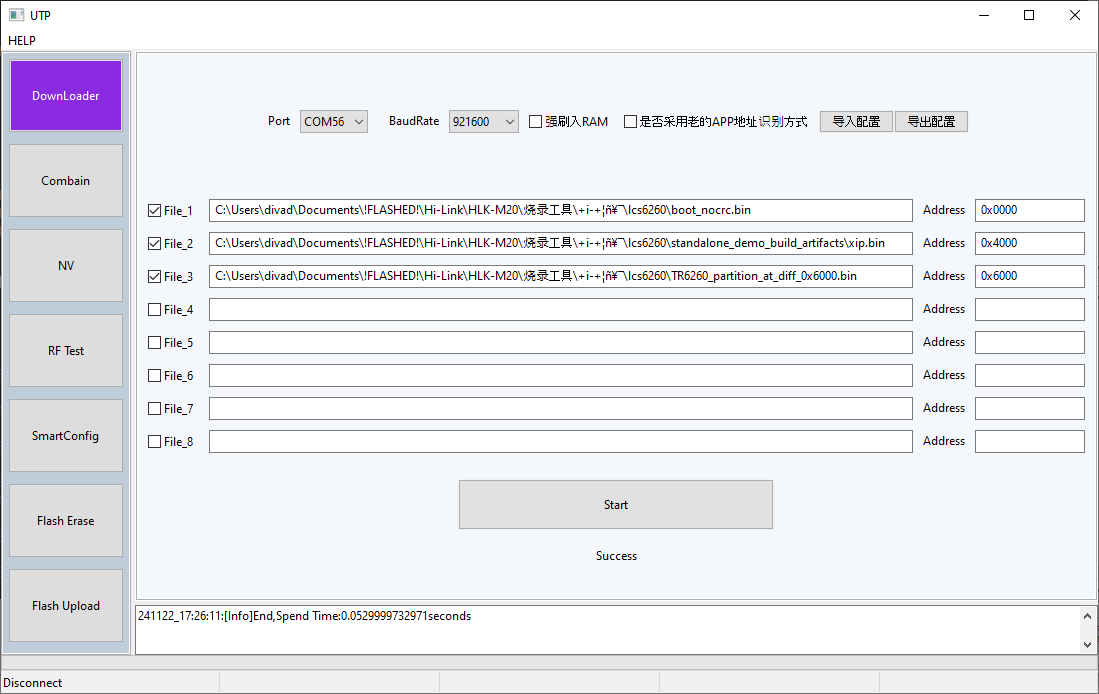

    I was not able to get my board into UART boot mode so far, need to re-solder some connections.
    Also, I don't have a Windows env so testing the UTP app might be troublesome.
    Attaching build artifacts of the SDK demo app in case someone wants to try flashing.
    Looking at the artifacts with a hex editor, they don't seem to have a bootloader one must be provided separately I guess.
    Firmware binaries in HKL-M20.7z have bootloaders or one can be dumped from the board itself.

    micbanand
    Posts: 13
    >>21314483 I soldered it to what is pin 14 on esp-02s
    but I will try bt1 :) ooh pin bt0 :)

    micbanand wrote:
    but I will try bt1 ooh pin bt0
    yes sorry, corrected post from BT1 to BT0
  • #38 21314507
    micbanand
    Posts: 13
    >>21314491 no luck on bt0
    out of time for today. Suggestions are welcome :)
  • #39 21314509
    Posts: 5232
    Help: 449
    Rate: 918
    I would try to trace where GPIO14 of the TR6260 goes to with multimeter probes. I've soldered a sewing needle to one probe so I can touch individual chip legs under a microscope with care and certainty.
    do the same at your own risk of course ;)
    Added after 11 [minutes]:
    or try BT1?
  • Requesting TR6260 pinout and GPIO0 flashing details
    #40 21314551
    micbanand
    Posts: 13
    >>21314483
    "not sure what you mean by ESP-02S but what is the pad you've also grounded with the blue cable?"
    all the smart contacts.
    where the 6260 modules come from.
    are replaced with a esp-02s module.
    the blue cable is going to ground with a switch in between. so I can make a short to ground while plugging in the reader/flasher.
    it went to gpio0 on the esp-02s and it is the pin I tried on gpio14 know bt0 and bt1 and other pins later?
    and yes I can try to follow traces under microscope. do we have a pinout of the 6260 chip?

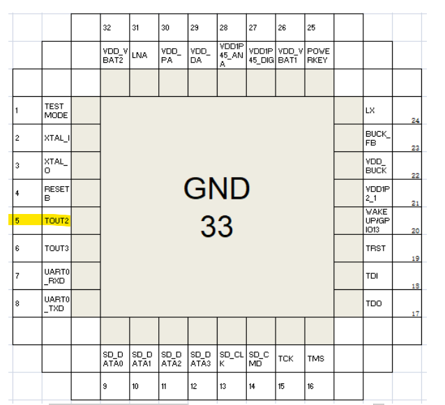

  • TR6260 pinout mismatch suggests GPIO14 programming mode
    #41 21314580

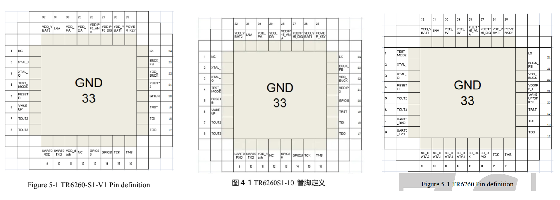

    Posts: 5232
    Help: 449
    Rate: 918
    yes, but something's currently a little unclear. I didn't actually trace the GPIO14-labelled pad on the HLK-M20 module to the leg on the IC to match it up, until now. The Skylab engineer said in his little email guide that "TOUT2" (of the Skylab LCS6260) should be grounded to get into programming mode.

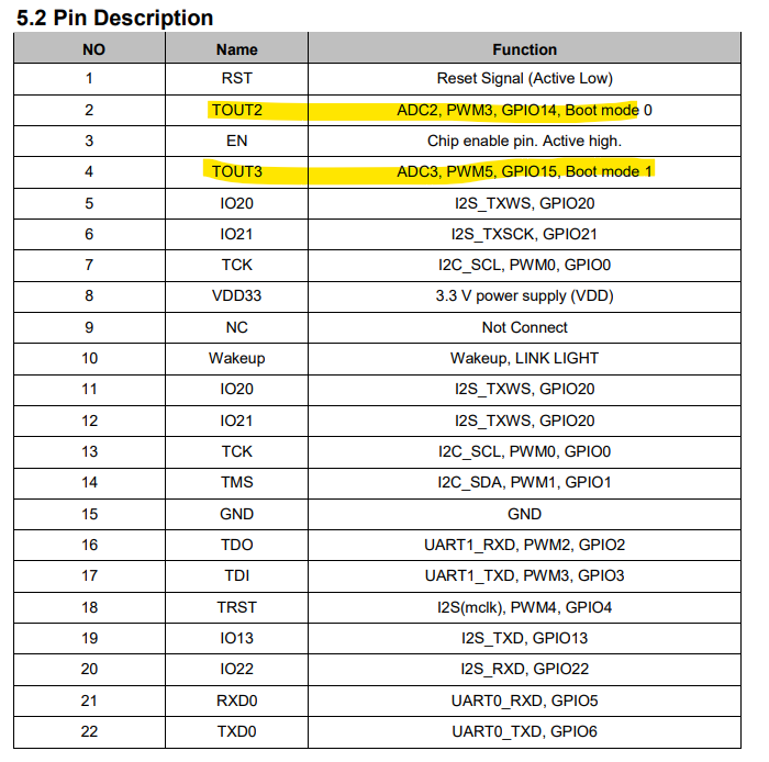

    If you look at TOUT2 of the IC from the diagram in the Transa Semi datasheet TOUT2 is pin 5. BUT on the TR6260S1 on my HLK-M20 module, pin 6 has continuity to GPIO14 pad, meaning TOUT3, which is what you see in the earlier post is what I grounded.
    Diagram of the TR6260 integrated circuit with TOUT2 pin highlighted.
    So, it's either GPIO14 or 15, something's not matching yet. Is TR6260 the same as TR6260S1?
    Either way, you need to pull one of those low. Don't forget you could monitor the TX log out to see which mode each gets you into.

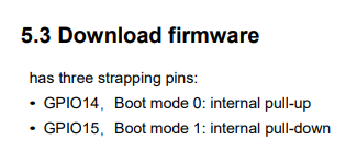

    Added after 9 [minutes]:
    LCS6260 datasheet for added reference.
    Section of documentation detailing boot modes for GPIO14 and GPIO15 pins. The pin description of SCT6260 with TOUT2 and TOUT3 highlighted.
    I guess pulling down GPIO14 would make sense as 15 is already low.

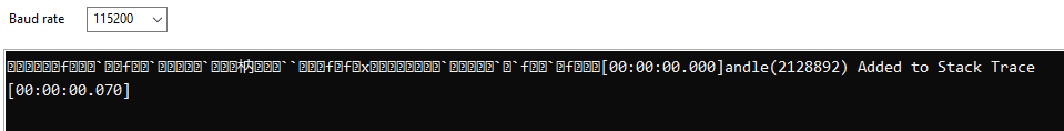

    #42 21314648
    Posts: 5232
    Help: 449
    Rate: 918

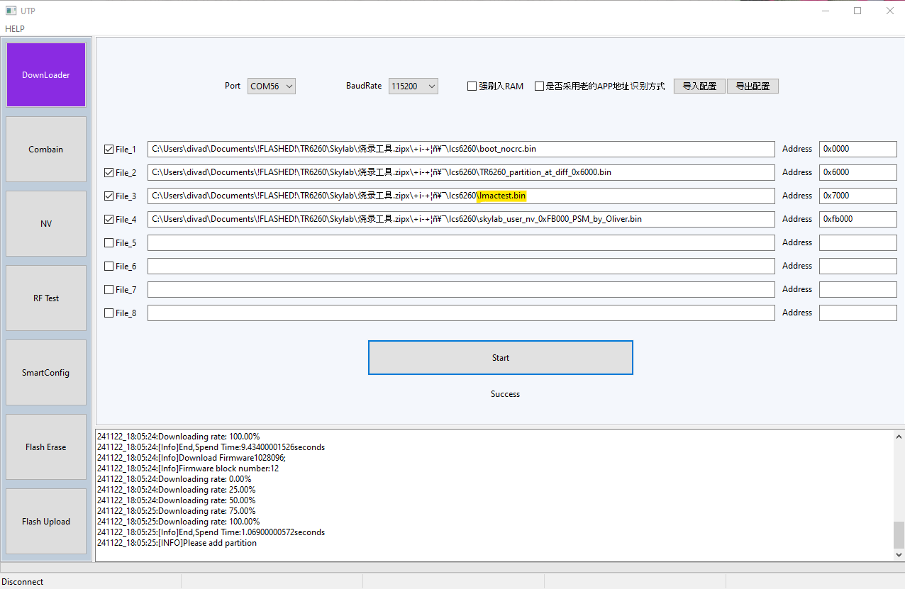

    >>21314485

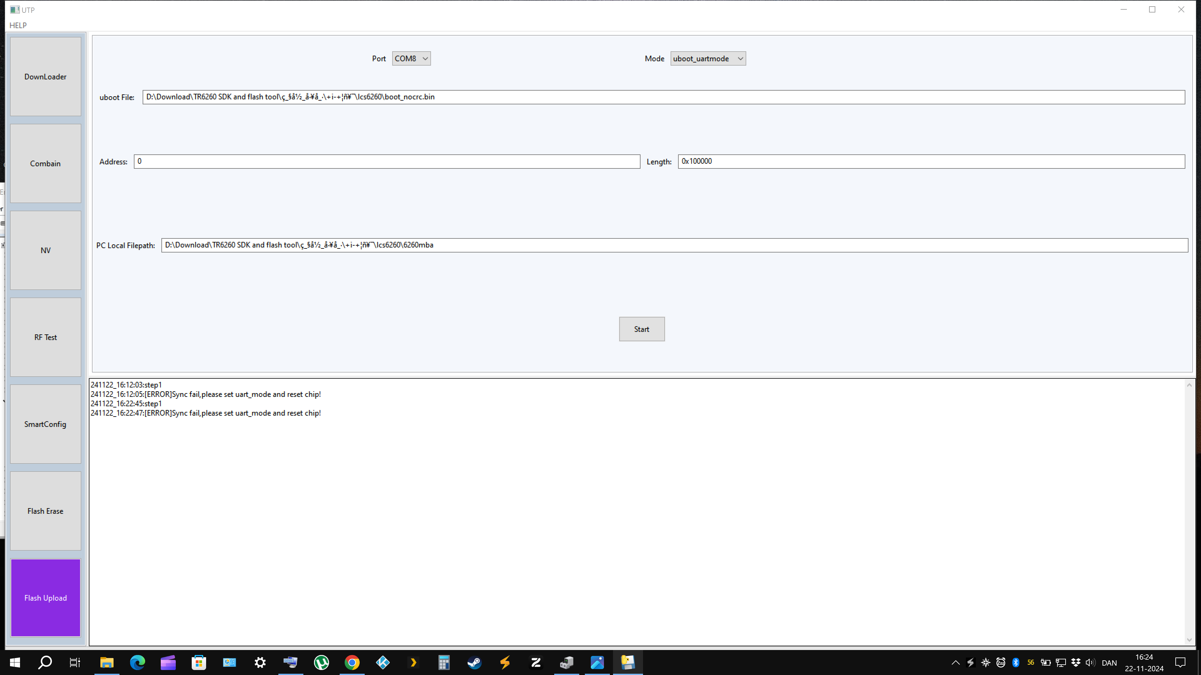

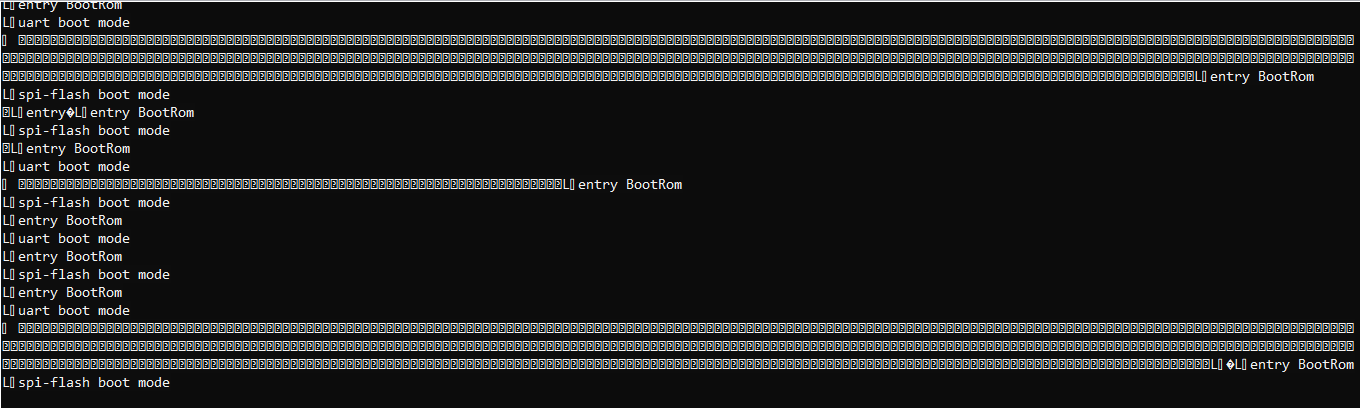

    so I've tried a few things and although it's not output anything about a boot fail, it still has only output the standard lines
    Screen displaying text with boot modes and unrecognizable characters.
    those being
    Lentry BootRom
    Lspi-flash boot mode
    so not really sure what it's doing. those unrecognisable character lines are just when I was programming it.
    im trying variations on this with both bins in your zip

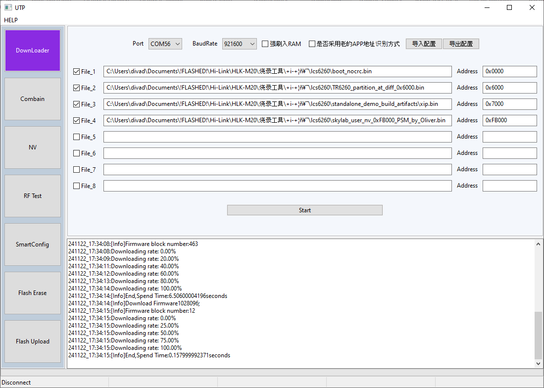

    Screenshot of a firmware flashing program with several selected files for flashing.

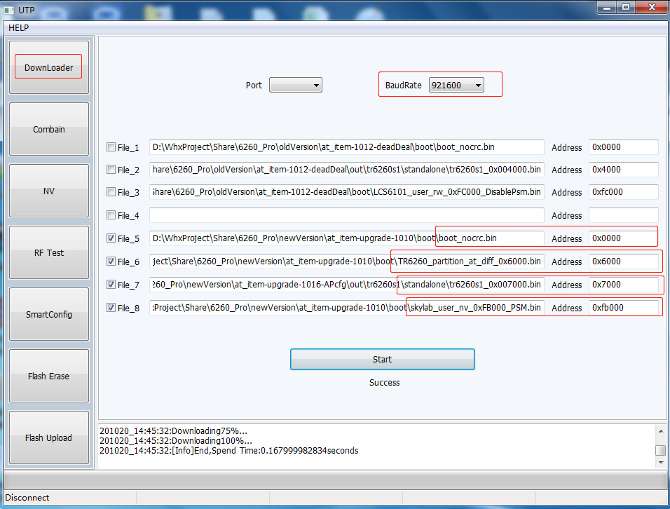

    interesting is the jpg in the Skylab supplied zip:
    A screenshot of UTP software showing various files to upload, their paths, addresses, and status.
    Added after 4 [minutes]:
    same TX out with this. It'd be good to know how we're to know we're supposed to tell if it's booted.
    Screenshot of a firmware uploading program for a device.
    I've asked Skylab for some demos
    Added after 32 [minutes]:
    if you flash lmactest.bin in the zip you get this output at 115200
    Screenshot of UTP software for microcontroller flashing.
    Terminal output showing unrecognizable characters and diagnostic messages.

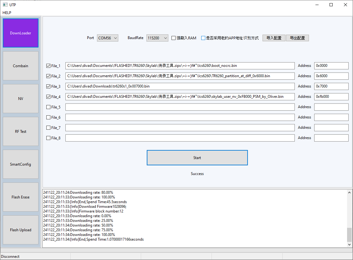

    Thank you! The "good" binaries seem to all start with some sort of bootloader section:
    00000000  62 65 6e 6f 04 00 00 00  01 00 00 00 00 00 00 00  |beno............|
    00000010  c0 41 00 00 02 26 20 18  fe 09 96 08 5e b8 c2 00  |.A...& .....^...|
    00000020  00 00 41 80 00 00 00 40  00 01 c0 00 ab 4f b9 58  |..A....@.....O.X|
    00000030  18 14 0f 00 62 6f 6f 74  2d 76 65 72 73 69 6f 6e  |....boot-version|
    00000040  2d 64 65 62 75 67 00 00  00 00 00 00 00 00 00 00  |-debug..........|
    Also, I found the script that generates the binary you noticed in the screenshot earlier:
    https://github.com/divadiow/TR6260/blob/main/...scripts/build_tr6260s1_standalone_diff.sh#L21
    It checks the sizes of the binaries and adds these numbers to the start of the file, then concatenates the binaries themselves.
    Attaching the resulting file - maybe flashing it to the offset would provide some results. Still not quite clear what this _diff build target is supposed to produce however.

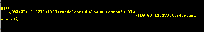

    #46 21314908
    Posts: 5232
    Help: 449
    Rate: 918
    awesome!
    Screenshot of software for uploading binary files to a device.
    Screenshot of a terminal with unreadable text and baud rate set to 115200.
    whatever it is is booting
    Added after 6 [minutes]:
    response to "AT"
    Screenshot showing Unknown command: AT error in a console.
    Added after 31 [minutes]:
    Maybe the attached is meant for use with what's been built, though I see no AT commands in plain text in that binary and it's not responding to commands.
    • 62189e143c081.pdf (892.41 KB) You must be logged in to download this attachment.

    I've scraped a couple of different TR6260 datasheets from around the net. Added to GH. A little comparison:
    Three diagrams depicting pin definitions for TR6260.

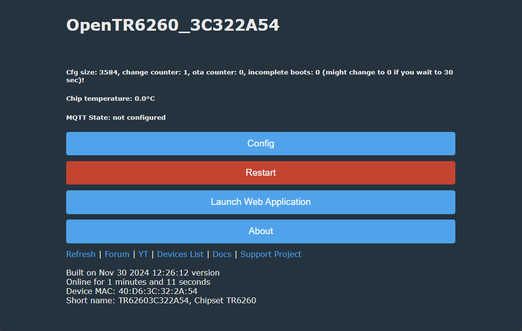

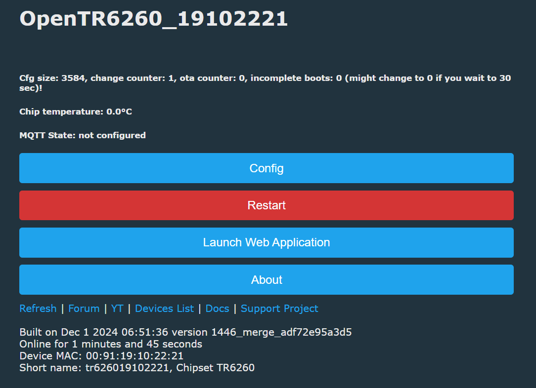

    Device configuration interface for OpenTR6260 with technical information and action buttons.
    Was able to get AP working, but dhcp is not working (edit: now works).
