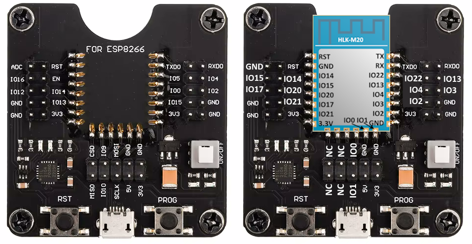

    if using this exact ESP module adaptor then this may be of use. I made for my ref. Original on the left, headers relabelled for HLK-M20 module use on the right.
    Two ESP modules, ESP8266 on the left, and one labeled HLK-M20 on the right, with visible pins.

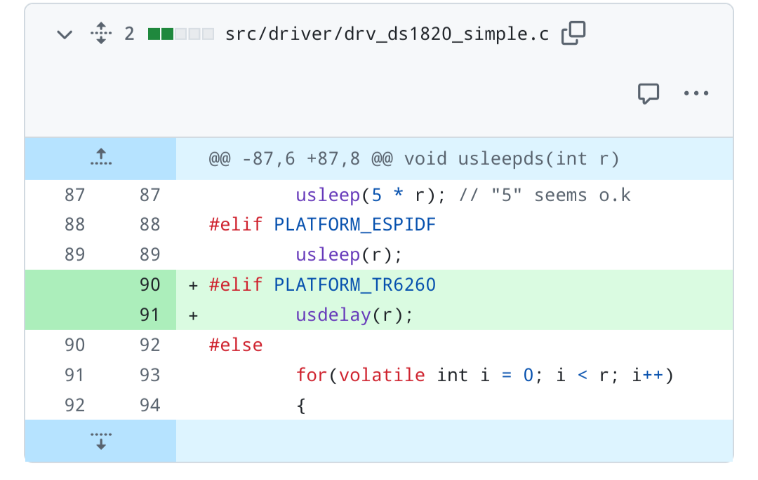

    insmod wrote:
    , on ds18b20 i get either this
    That probably means some tests for the timing.
    The driver uses a handcrafted usleep() for most SDK versions turned out to be far away from sleeping the number of useconds provided.
    Since I don't own one of these, I can't do some tests with a logic analyzer to track down the right number of NOPs or usleep factor.
    You might take LN882H as a template and try with "10*r" in the code for TR6260 in /src/driver/drv_ds1820_simple.c
    Code snippet in file src/driver/drv_ds1820_simple.c with added condition for PLATFORM_TR6260.
    if the log is kind of correct...
    [Edit] changed the screenshot...
    Added after 12 [minutes]:
    ... but since the "small" amount of 5.000us in the test loop takes 5ms (correctly) while 100.000us only take twice the time(10ms) it might also indicate we need an own implementation...
  • #71 21342626

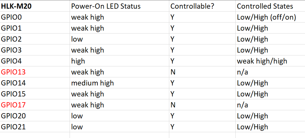

    LED behaviours on HLK-M20 for me
    Table showing the LED state on the HLK-M20.

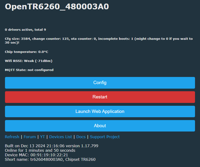

    Help: 449
    Rate: 918

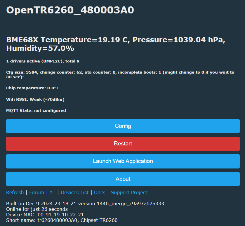

    nice to see build number done too
    Screenshot of the OpenTR6260_480003A0 user interface displaying system status and configuration options.

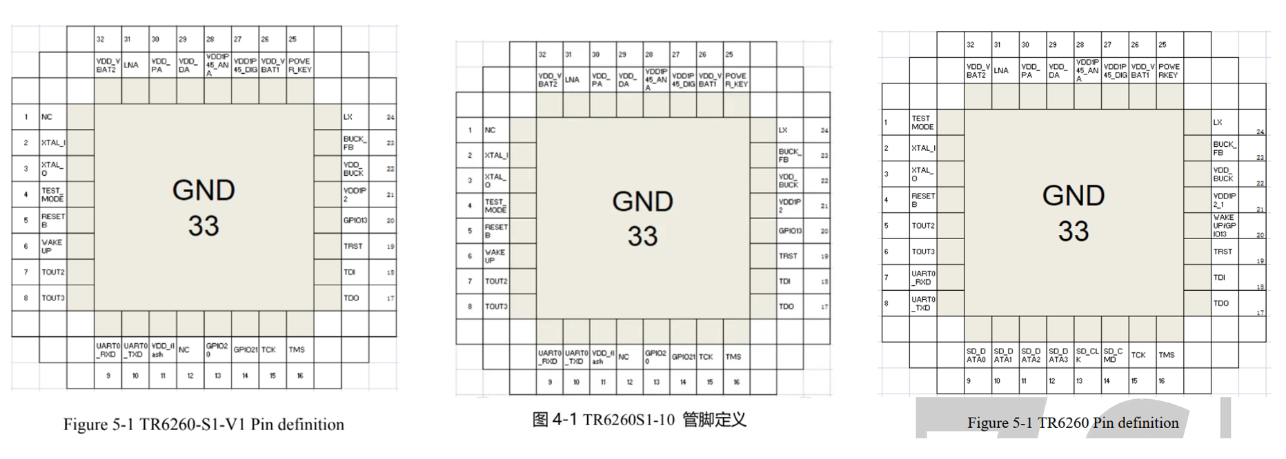

  • HLK-M20 continuity suggests unmatched TR6260S1 pinout
    #76 21347487
    Posts: 5232
    Help: 449
    Rate: 918

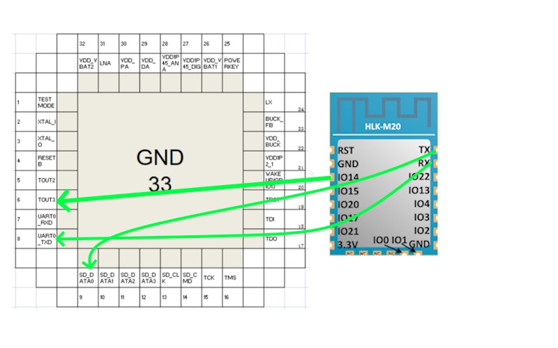

    >>21314580
    @insmod (or anyone with HLK-M20) could you please sanity-check something when you have a mo? On the HLK-M20 I have continuity like this:
    Connection diagram between HLK-M20 module and another electronic circuit.
    if right, it means none of the images we have in the datasheets matches exactly for the TR6260S1 on the HLK-M20, despite being labelled as TR6260S1.
    Pin definition diagrams for TR6260S1-V1, TR6260S1-10, and TR6260.
  • #77 21347491
    insmod
    Posts: 1432
    Help: 168
    Rate: 455
    >>21347487 I got it too
  • #78 21347492
    Posts: 5232
    Help: 449
    Rate: 918
    OK interesting. thank you.

    Added after 33 [minutes]:
    Screenshot with the text Online for 40 minutes and 12 seconds.
