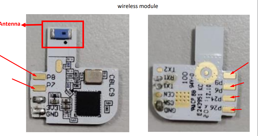

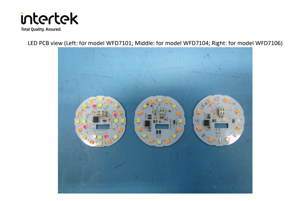

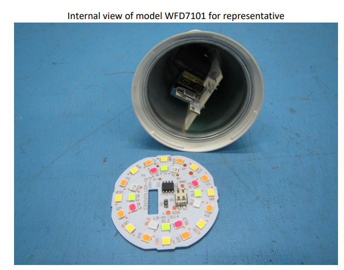

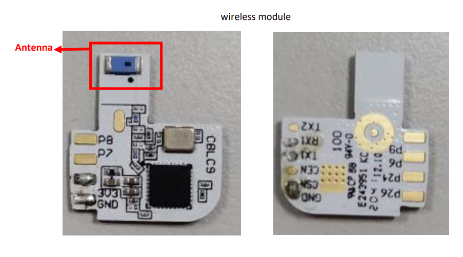

    Hello, the photos suggests that the device is using a "I2C" (modified protocol) LED driver, but I can't see which one is it. Can you open one and read the label from the IC?
    New to UltraPro WFD7102 RGBCW Light (BK7231N, CBLC9): Need Profile & Pin Config Help
    I can clearly see SDA/SCL labels on the PCB, I can also see just 4 pins used to connect the LED board.
    The used WiFi module also doesn't give much options when it comes to IOs...

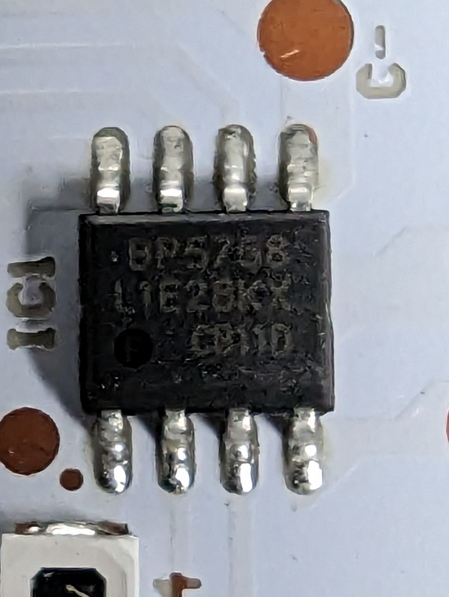

    BP5758, I see those in the dropdowns. I also see what you are saying about the 4 pins only. Looks like it is only 6, 9, 24, 26 that are used?

    OpenBeken already supports BP5758, but now you need to know which pin is used for SCL and for SDA of BP5758. Are you able to check that with multimeter?

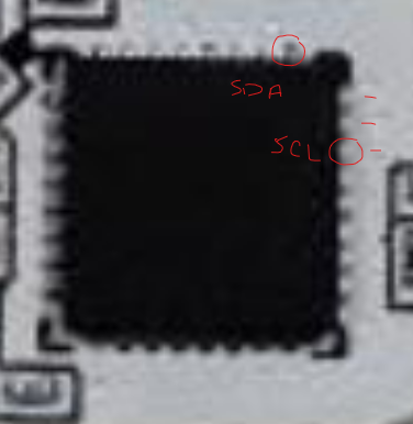

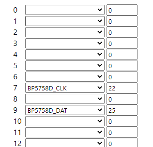

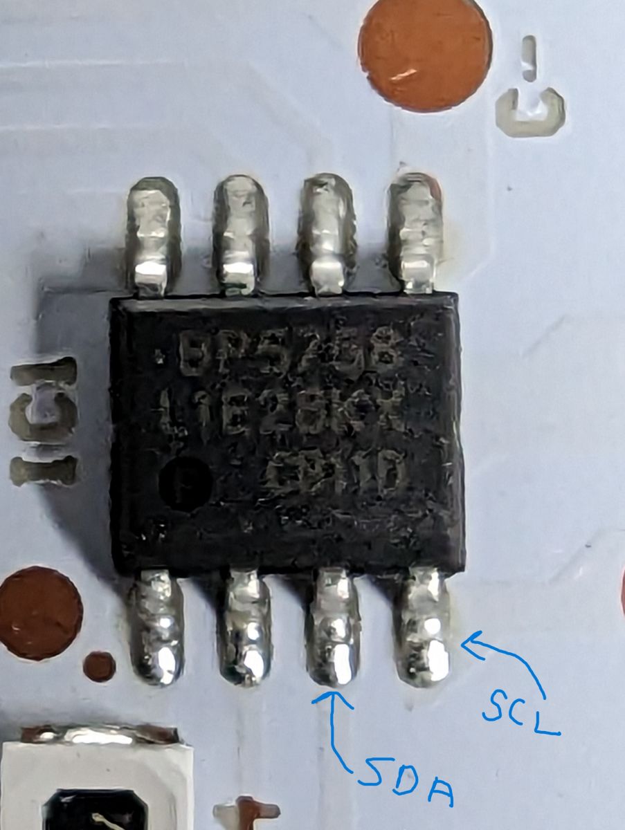

    These are the pins that SCL and SDA are connected to. Does this help narrow down where I need to put them?
  • #8 20521486
    Posts: 14797
    Rate: 12955
    Yes, those are CLK and DAT pins of BP5758, but we need to know which GPIO of CBLC9 are they connected to.
    Please check with multimeter continuity test (of course with bulb disconnected from power) or just try to analyze the board to see where the traces go.

    I don't need to know the pinout of QFN obviously.
    I just need to know which one of these pins:
    is SCL, and which is SDA.
  • #11 20522068
    bobthemonkee
    Posts: 33
    Oooops, pardon my ignorance! Here we go
    P7 is SCL
    P9 is SDA
    Got it working!!!
    #12 20522114
    Posts: 14797
    Rate: 12955
    Very good, but... why are you trying to change channel indexes of those pins? Those are not needed. Channels are like groups, they are used to group together relays and buttons, you don't need it in this case.
    Now you can setup some extra features, for example start SSDP driver in short startup command so Windows can see OBK device in network.
