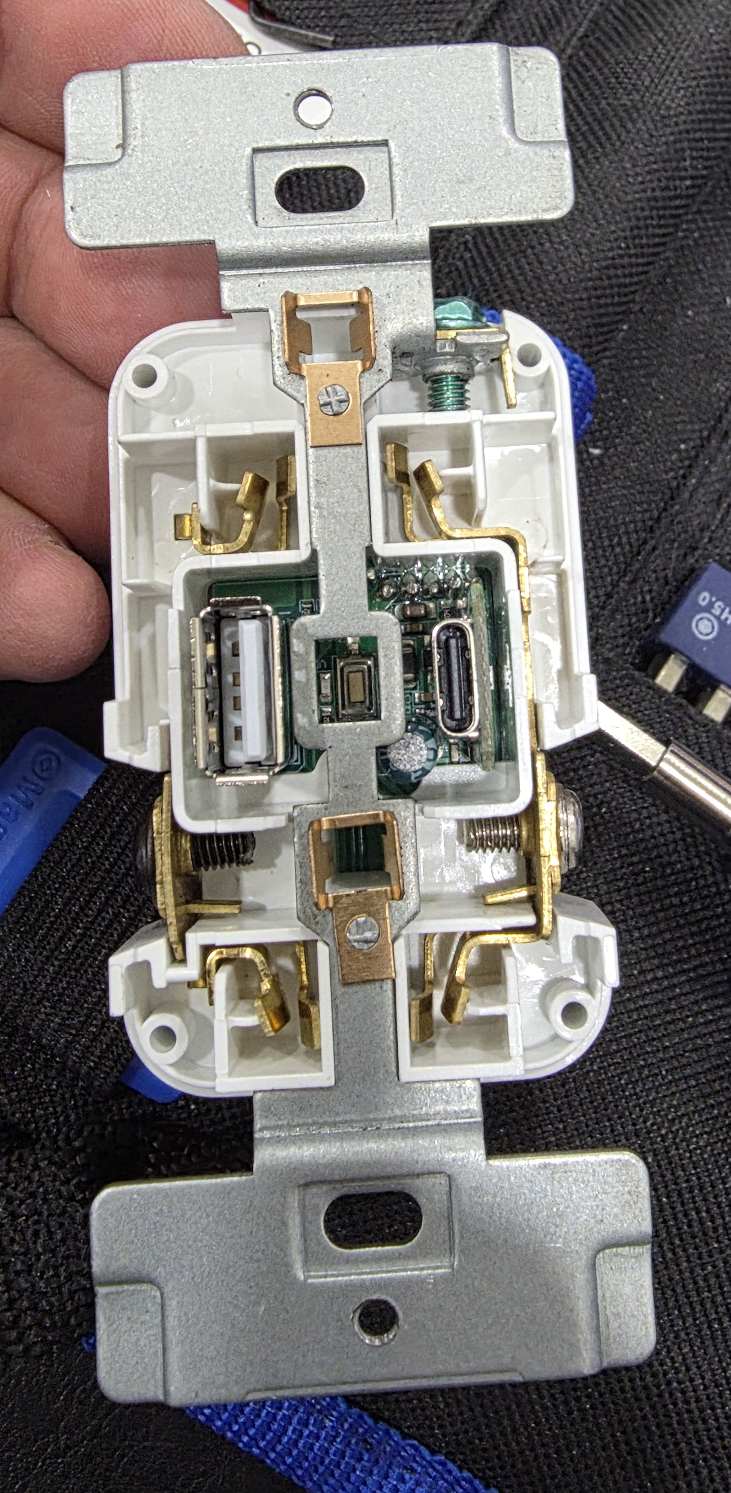

    Hi folks,

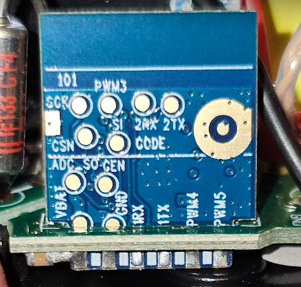

    I have a few of these Geeni Current + Charge outlets, and I'm going to attempt to get OpenBK on them.
    Packaging of Geeni Current + Charge outlet with USB ports.

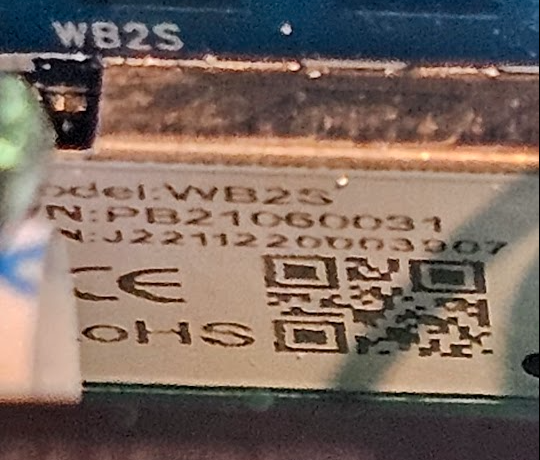

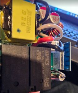

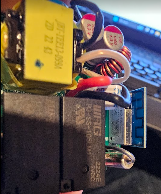

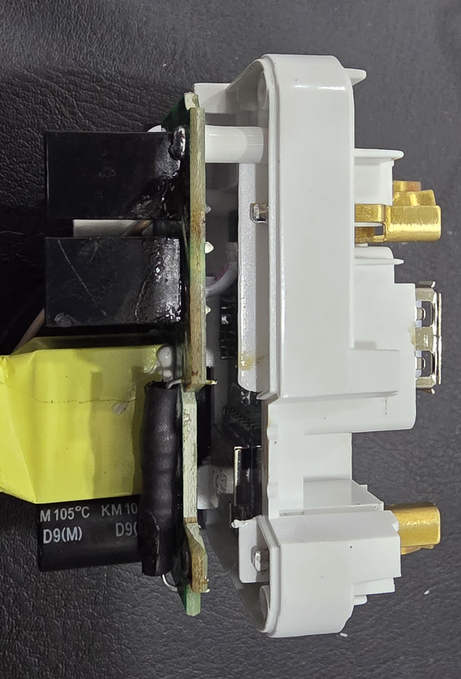

    I've pulled the thing apart, and it looks like it's a WB2S module.
    Close-up of the inside of a Geeni Current + Charge smart outlet with a visible WB2S module.
    Close-up of the WB2S module with model and serial number markings. Close-up of a WB2S electronic module with visible pins and printed labels.
    Going to probe around a bit to see if I can figure out which pins to use for flashing - but guessing that the RX2 and TX2 pins will be the business.
    Will update as I progress!
    (Impetus for the hacking is that we recently had an internet outage, and we were unable to control the plugs. Hilarious! So now I'm going to look at doing a more direct integration with HASS, bypassing the whole Tuya cloud stuff.)

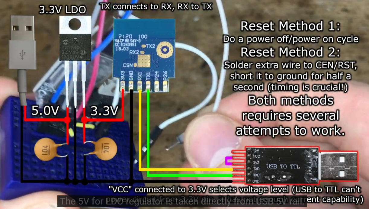

    Welcome to forum. On Beken platform, we use TX1/RX1 for flashing, see our flash tool readme:
    See our tutorials here:
    https://www.youtube.com/@elektrodacom/videos
    Sample tutorial for CB2S (WB2S is similiar):
    Keep in mind that you can also flash WB2S in-circuit, as long as RX1/TX1 are not used for anything on the board and you power the board correctly from a safe power supply, for example, by providing 5V at the input of on-board AMS1117-3.3V LDO. Do not connect board to mains while flashing.

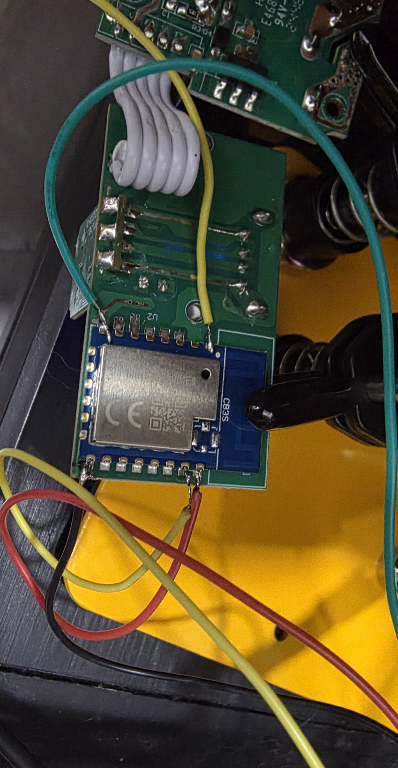

    I am getting console output on tx2/rx2, and I don't think tx1/rx1 is used for anything - it's soldered to the board, but I don't see any leads connected to it. Looks like just the GPIOs and power have leads on the PCB - so good sign, I think!
    And yeah, not putting it anywhere near mains power till it's all put back together. I don't want to die. :)

    My soldering skills are so weak, lol! But, I finally got some patch wires soldered to the appropriate pads/pins.
    Stock firmware attached.
    Going to try flashing the new firmware now - wish me luck! Thanks for the help!

    zac1
    Great success!
    Outlet is now online, reporting in to HA via MQTT, and is fully controllable.
    Now just have to do the other ones I have installed and I'll be free of Tuya's cloud!

    Would you mind confirming which connections/pinout used on device/programmer?
    Have you watched tutorial?

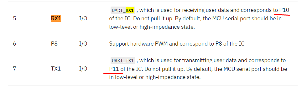

  • #11 21052468
    Posts: 14612
    Help: 655
    Rate: 12630
    I would say that most likely he didn't because RX1 is P10 and TX1 is P11 and they don't seem to be used in the template:

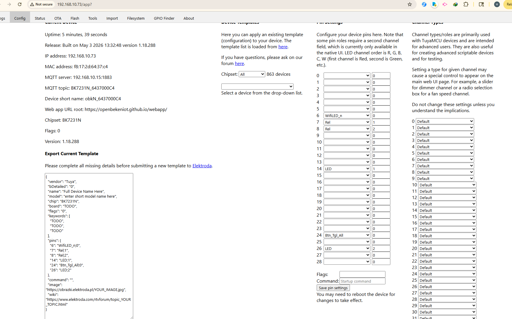

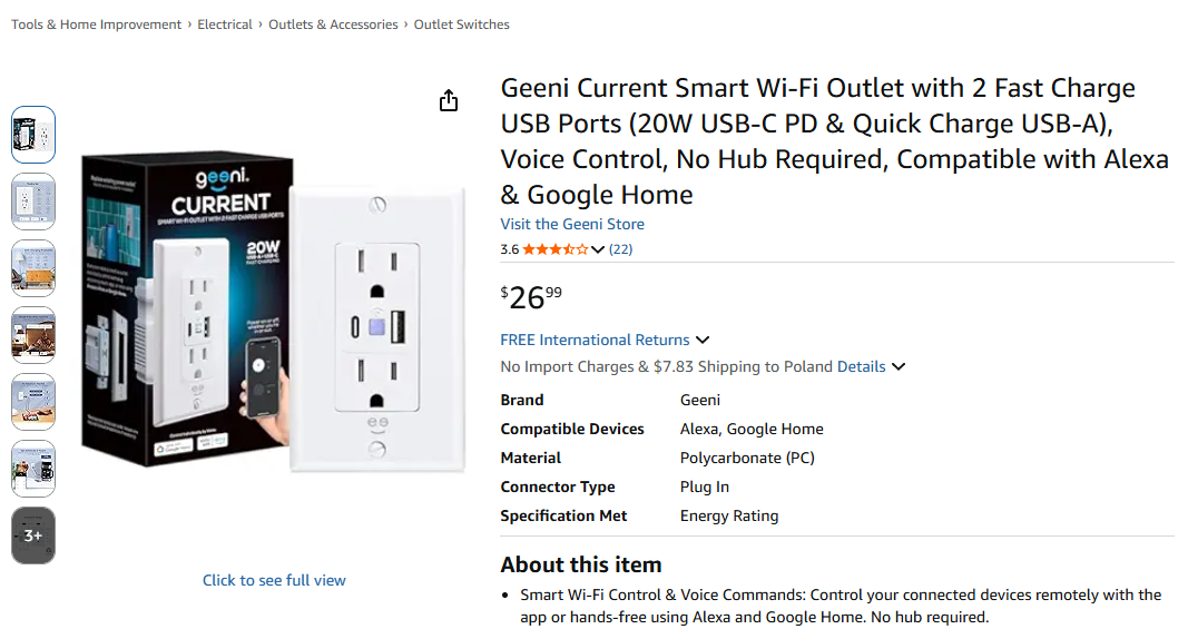

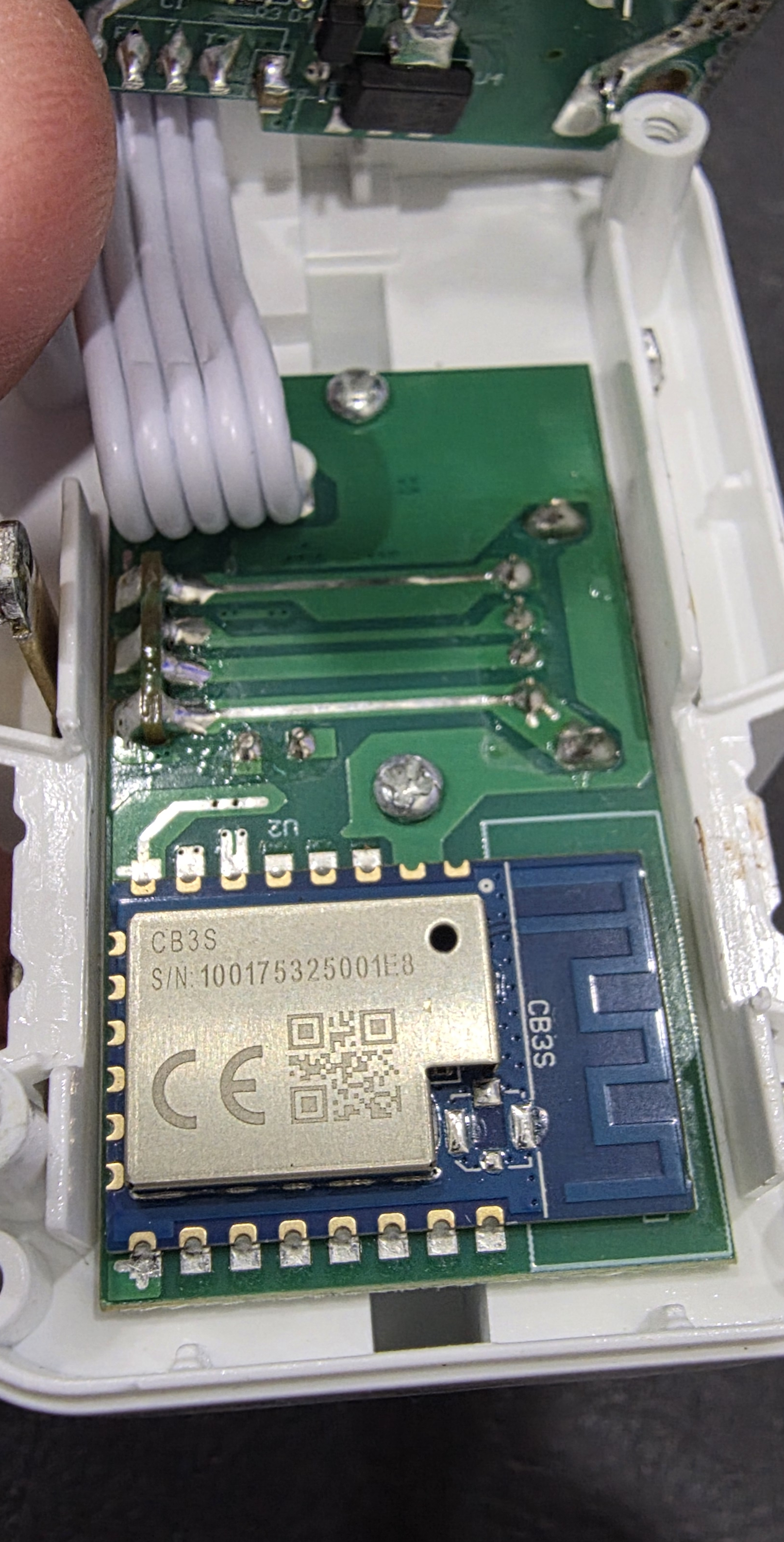

    Bought this version from Amazon:
    https://www.amazon.com/dp/B0DYWGSPF3
    Flashing Geeni Current + Charge with OpenBK on WB2S Module
    Here is info
    - LED (channel 1) on P14
    - Pair/Toggle All Button on P24
    - Wi-Fi LED on P6
    - Relay (channel 2) on P8
    - LED (channel 2) on P26
    - Relay (channel 1) on P7
    Device seems to be using CB3S module, which is using BK7231N.
    And the Tuya section starts, as usual, at 2023424 (0x1EE000).
    Able to flash OpenBeken, got 2 relays working for each outlet, but can not switch USB A/C.
    Any idea what to check? (Already tried to assign "rel" to all empty pins - no luck).

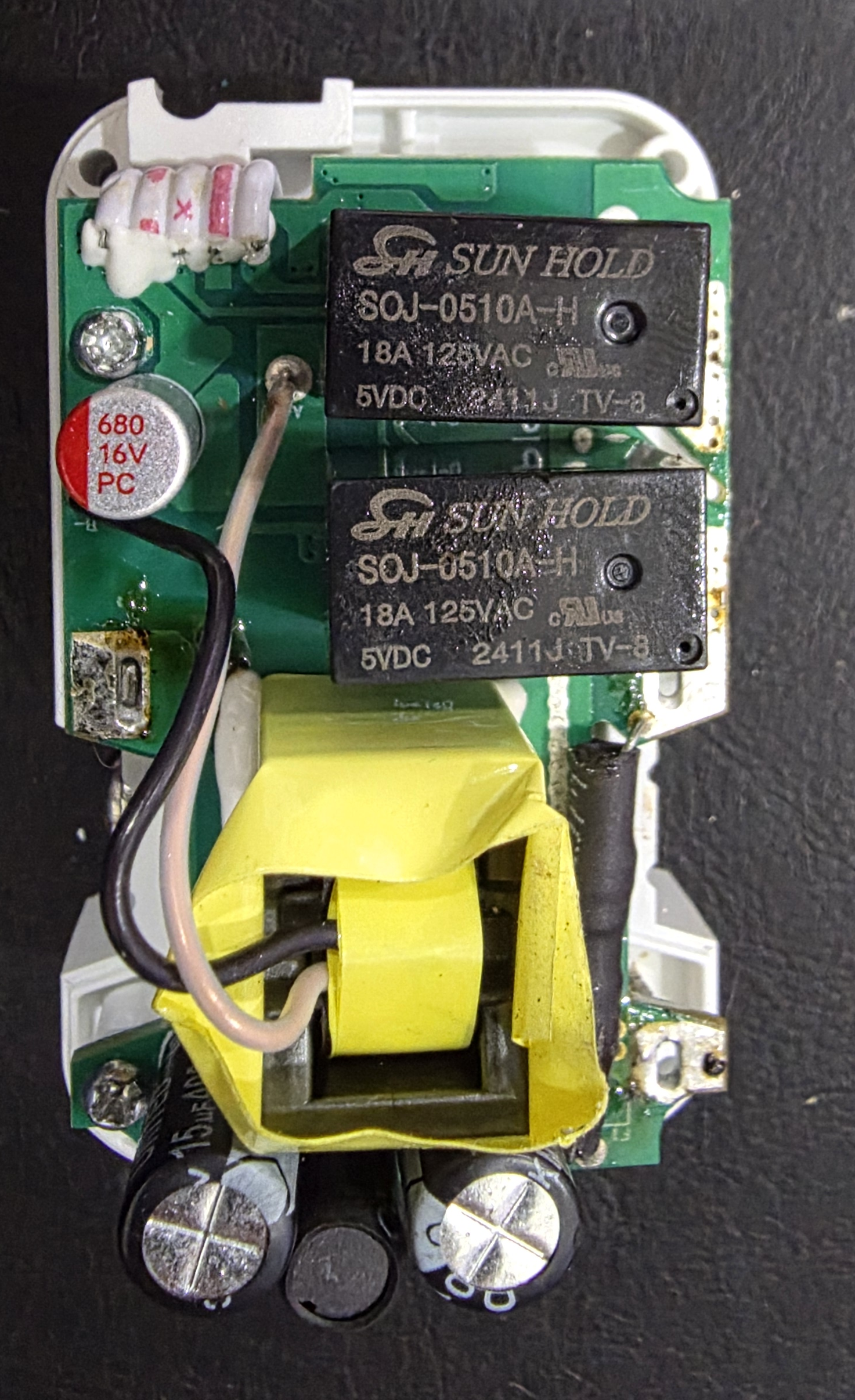

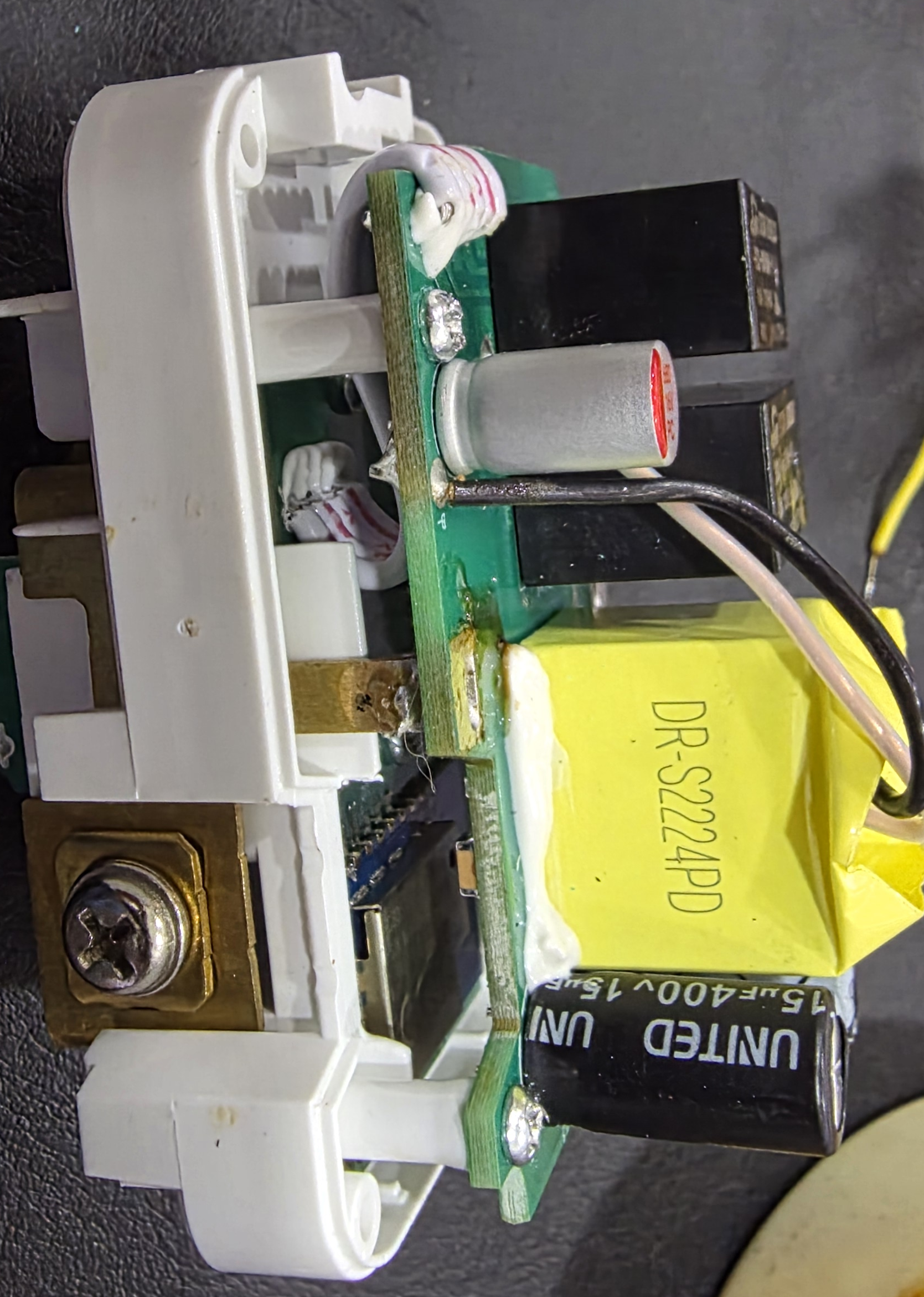

    Are you really sure that you've checked all pins with GPIO Doctor? The one from the Web App? There isn't much options left... I wouldn't expect TuyaMCU or anything like that inside.
    Can you show some photos from the inside?
    Do you have factory firmware backup?
  • #14 21909339
    gomelkiev
    Posts: 15
    Added after 56 [seconds]:
    Backup.
    • readResult_BK7231N_QIO_geeni1_2026-23-5-21-15-41.bin (2 MB) You must be logged in to download this attachment.

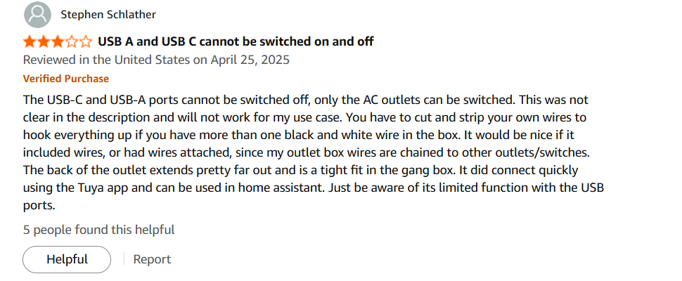

    On this page, I selected 'rel' for all pins and put consecutive numbers. None of those GPIOs controlled USB.
    Here is a review from Amazon.
    Looks like this particular model does not allow to switch USB ports.

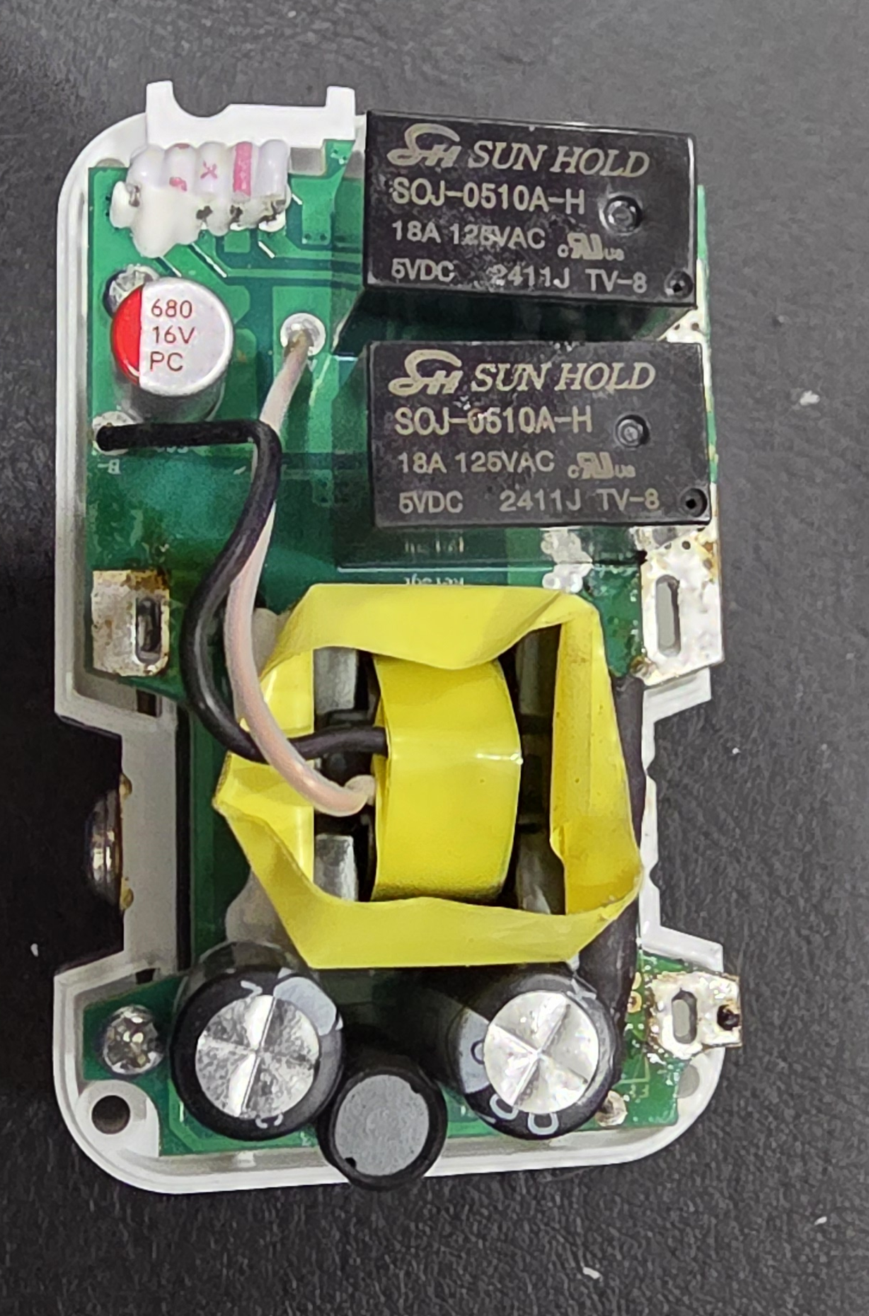

  • #16 21910442
    gomelkiev
    Posts: 15
    After couple days device stopped working, took apart, soldered 3.3V and GND, CB3S is working, web is up (I set startup to -1 for both relays), but when I solder both PCB together, device is not working. Any ideas? I don't want to spend a lot of time on this model b/c it will not work for what I need (already got Moes and it's working), anyone in US want it? Just pay shipping from 33414, let me know.
  • #17 21910538
    Posts: 14612
    Help: 655
    Rate: 12630
    Faulty/bulked capacitor in the power supply?
