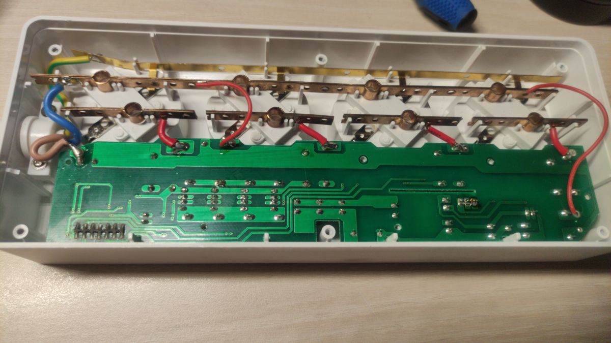

    This is how it looks inside:
    [BK7231T/WB3] Experience: Firmware for IMPITER WiFi Smart Power Strip - Inside Look & Setup

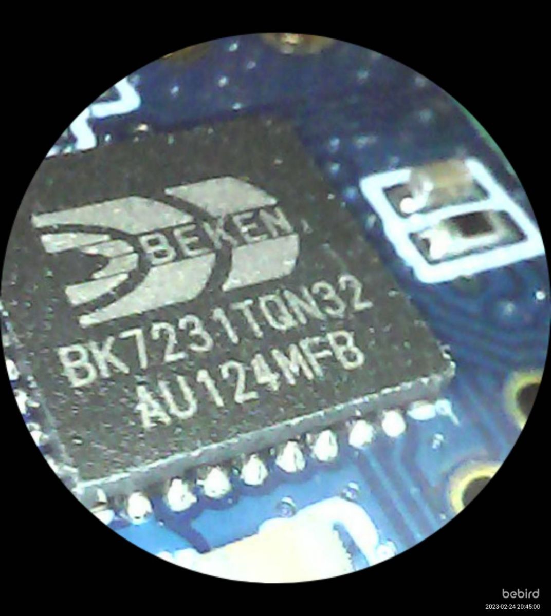

    The extension cord is assembled on the basis of a chip BK7231T / WB3

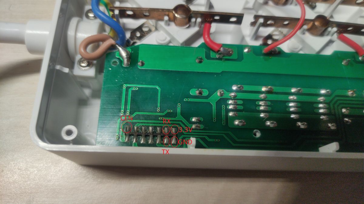

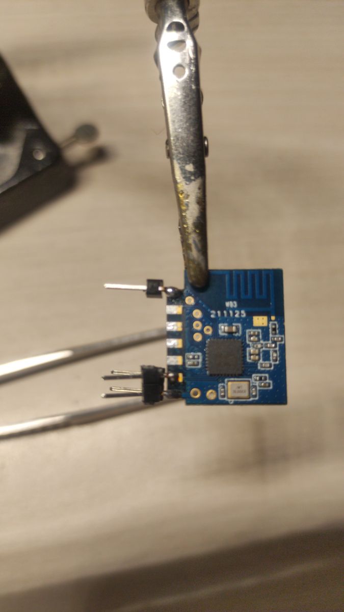

    On the chip itself, the pinout is as follows
    [BK7231T/WB3] Experience: Firmware for IMPITER WiFi Smart Power Strip - Inside Look & Setup [BK7231T/WB3] Experience: Firmware for IMPITER WiFi Smart Power Strip - Inside Look & Setup

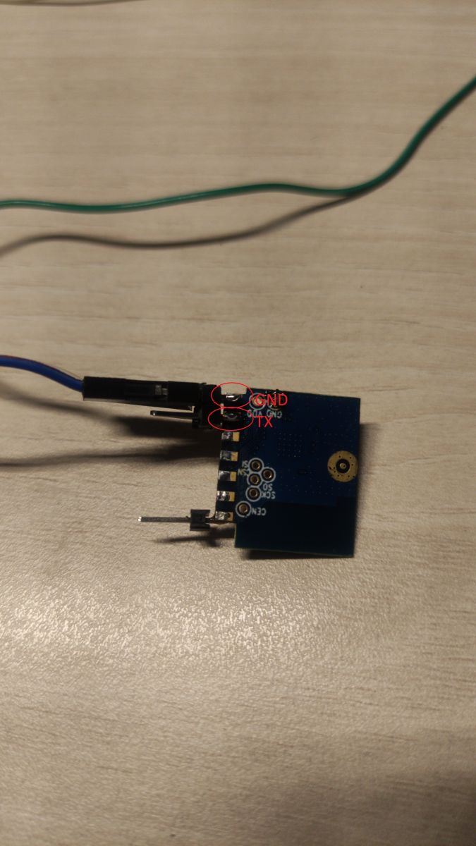

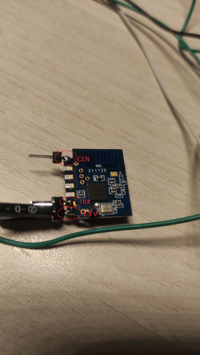

    In order not to solder the chip, here is an example of where to solder on the board

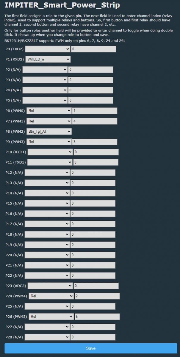

    This is how you need to set up channels
    Here is the json config:
      "vendor": "Tuya",
      "bDetailed": "0",
      "name": "WiFi Smart Power Strip",
      "model": "IMPITER",
      "chip": "BK7231T",
      "board": "WB3",
      "flags": "1024",
      "keywords": [
        "Mains Power Strip",
        "USB Power Supply",
        "4 Gang"
      "pins": {
        "1": "WifiLED_n;0",
        "6": "Rel;1",
        "7": "Rel;4",
        "8": "Btn_Tgl_All;0",
        "9": "Rel;3",
        "24": "Rel;2",
        "26": "Rel;5"
      "command": "",
      "image": "https://obrazki.elektroda.pl/9881821800_1679809090_thumb.jpg",
      "wiki": "https://www.elektroda.com/rtvforum/topic3967318.html"

    Why do you solder goldpins to the WiFi module? Is it to save wires from cutting? Still, I think it's a bit more hard than just soldering wires.
  • #3 20509856
    druidblackarm
    Thanks. It's more convenient for me. I don't want to cut the wires. Sometimes I leave such contacts soldered to the chip. You never know when you will need direct access to the firmware.

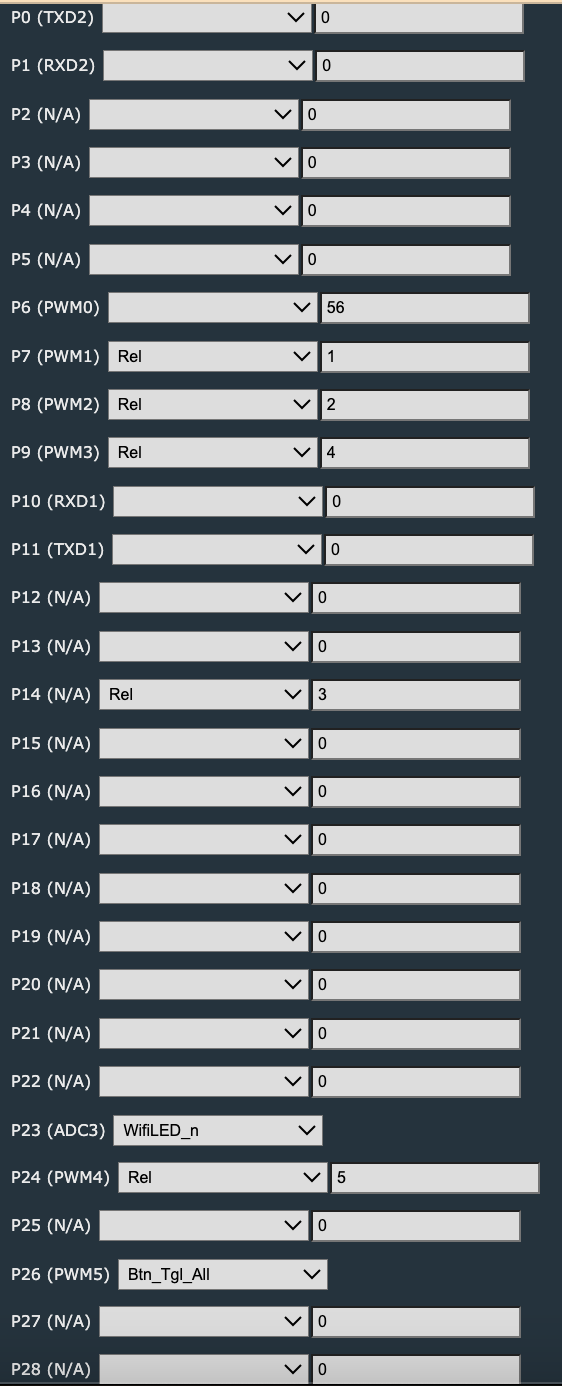

  • BK7231N pinout for Tuya power strip config
    #4 20903716
    Gasp27
    Hello, I bought one but it was a chipset BK7231N so the configuration is not the same.
    this is my config :
    Pin configuration for BK7231N chipset
