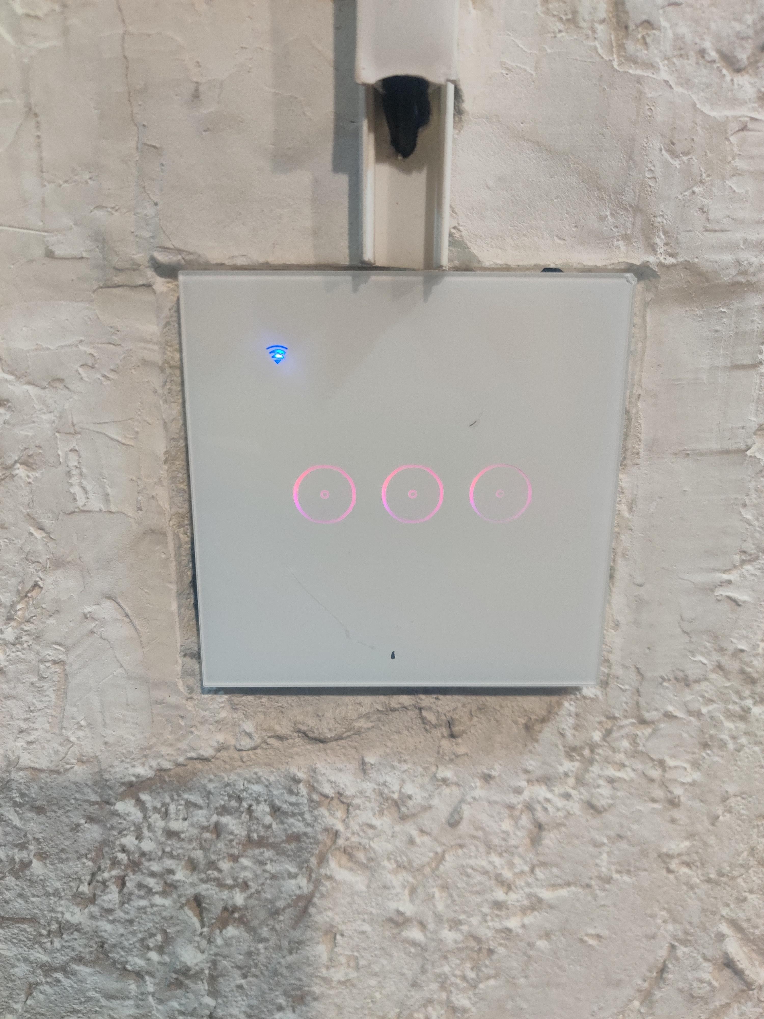

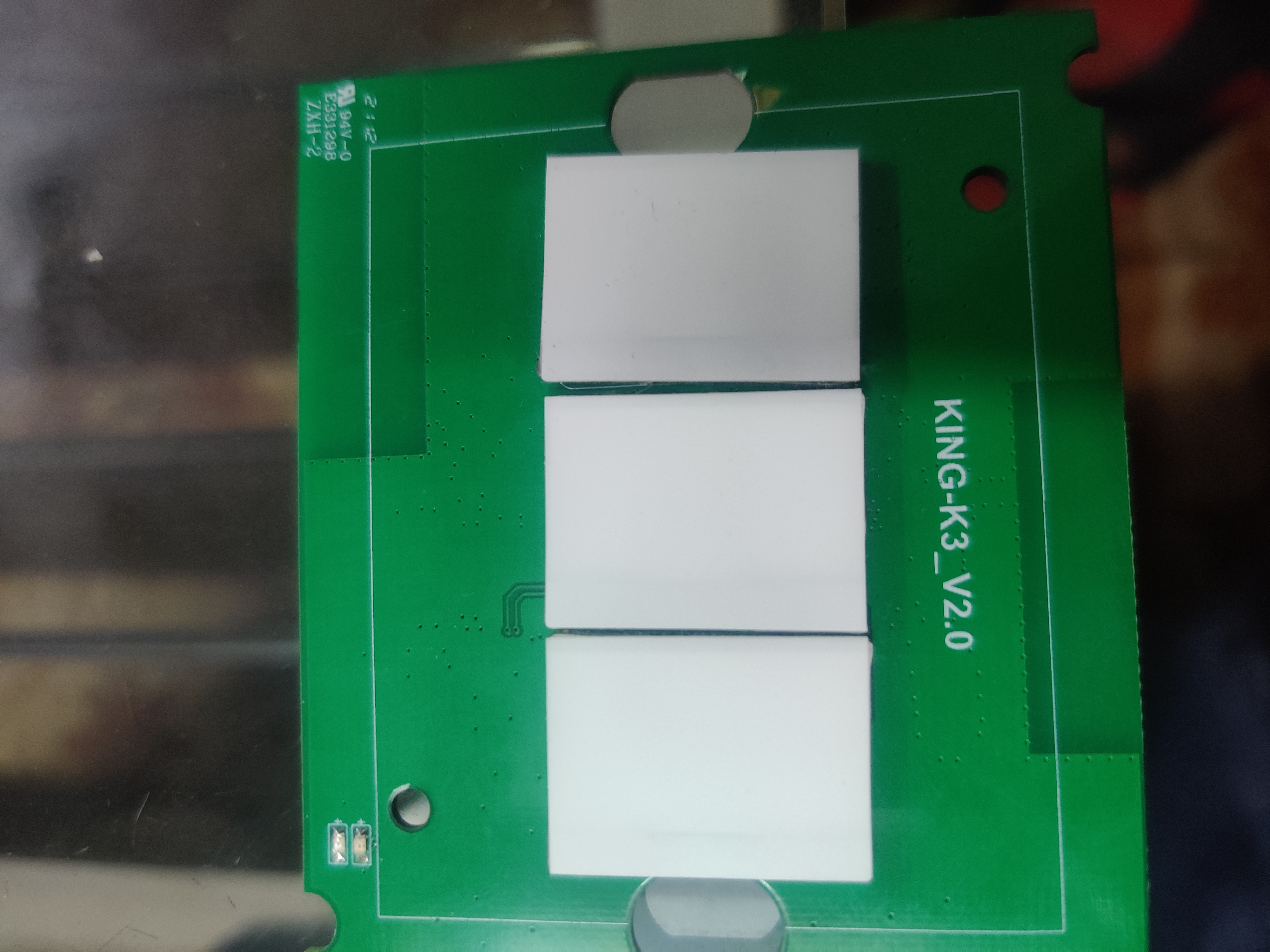

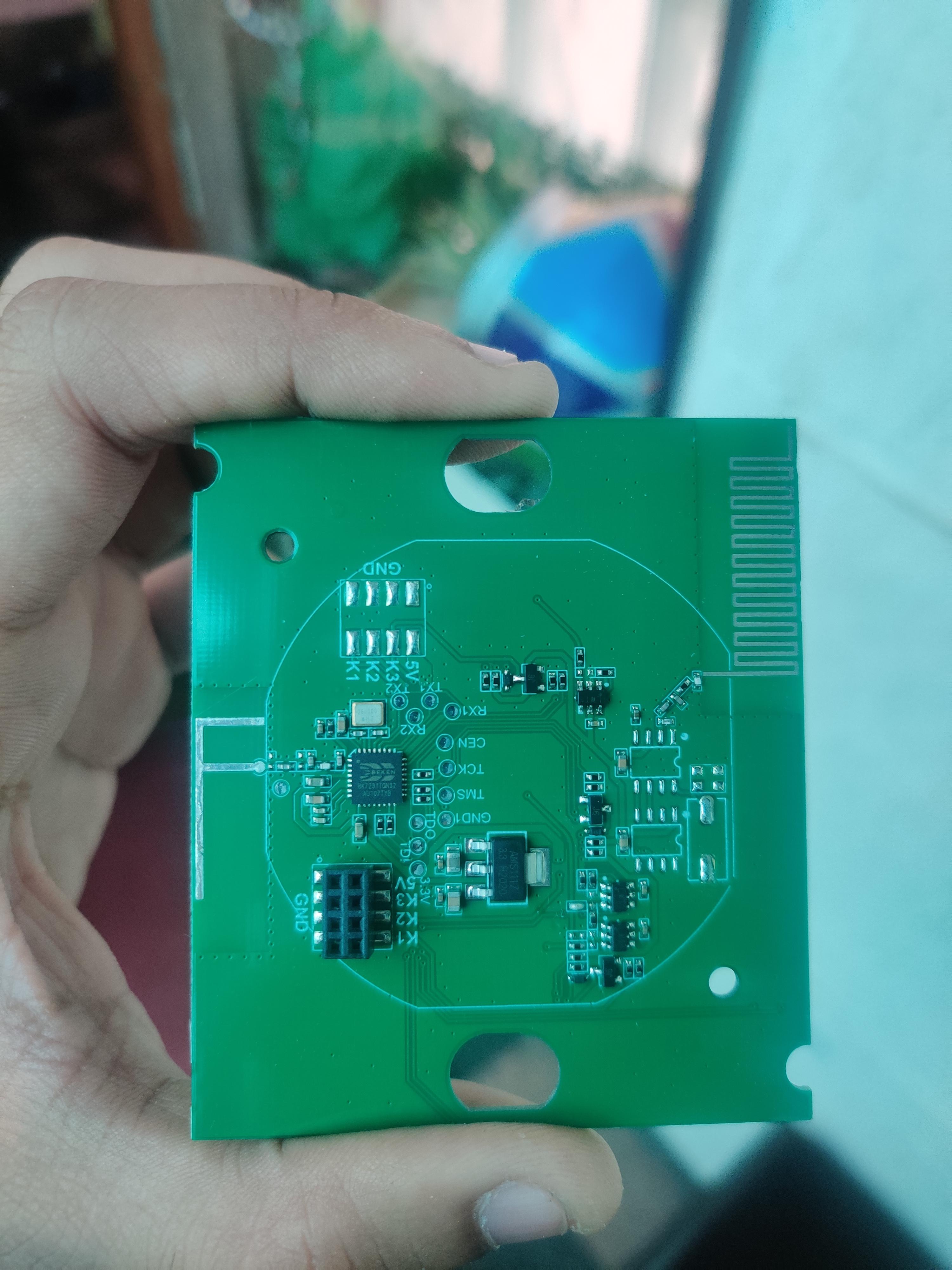

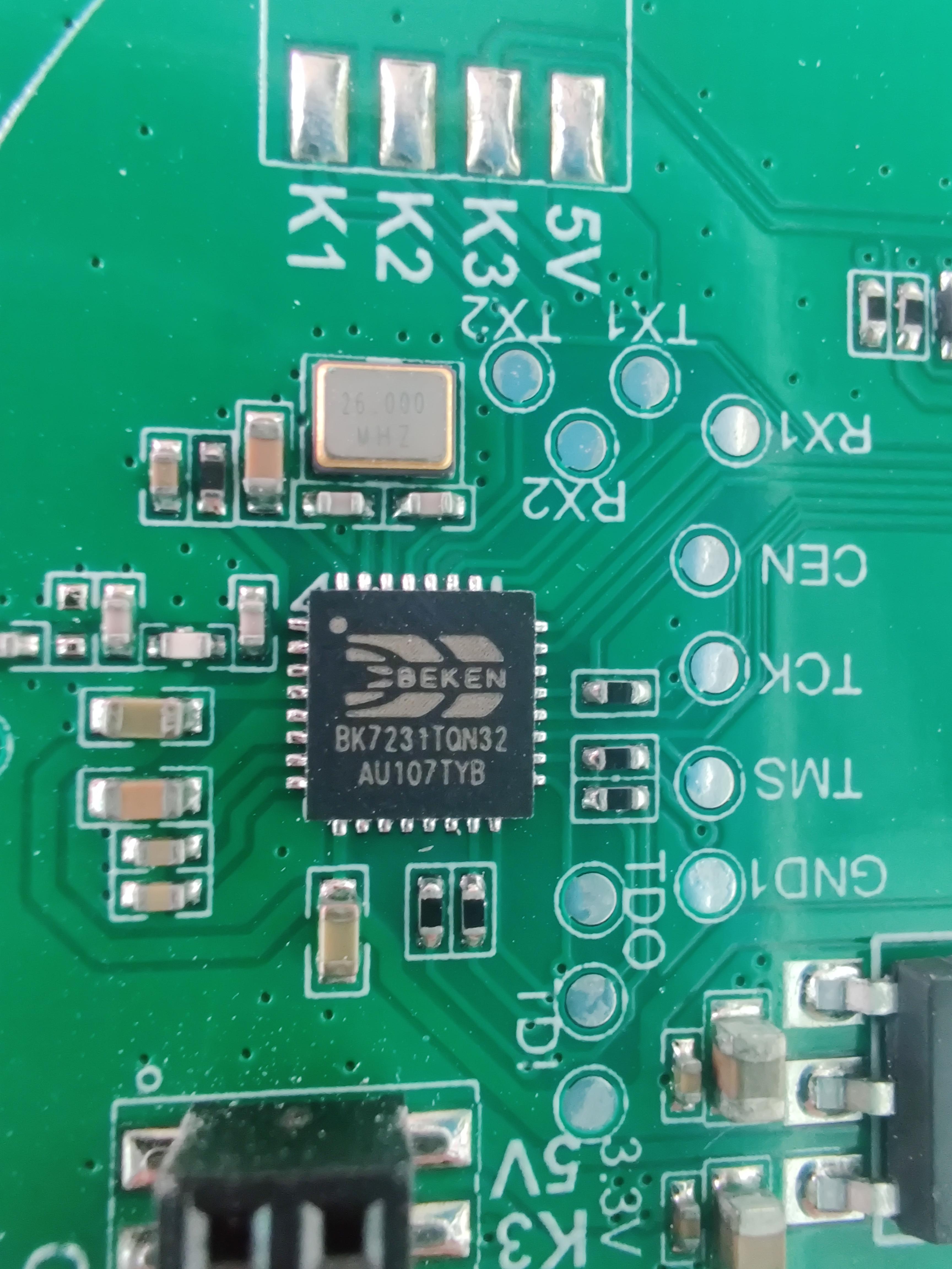

    Hi Team,

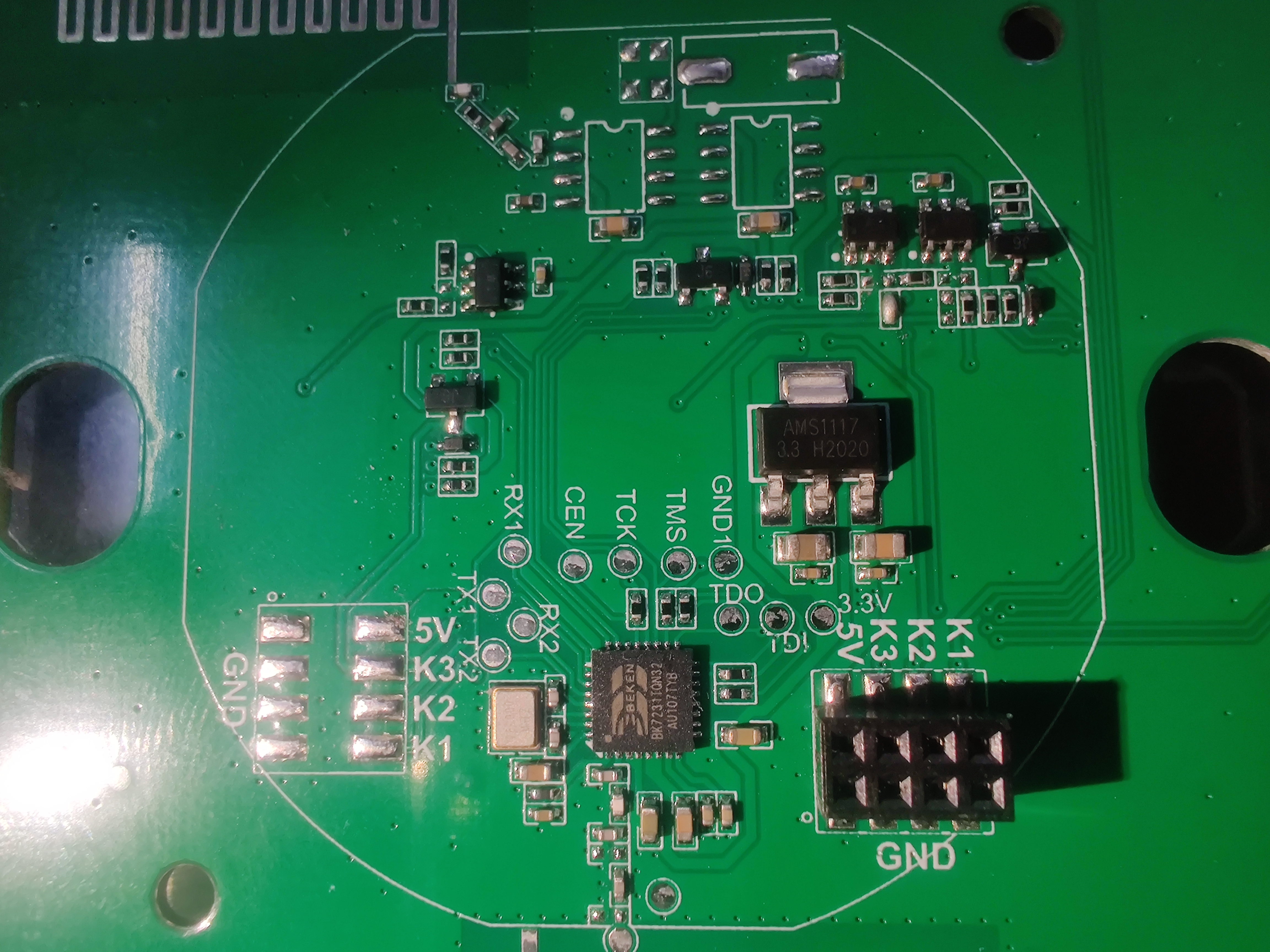

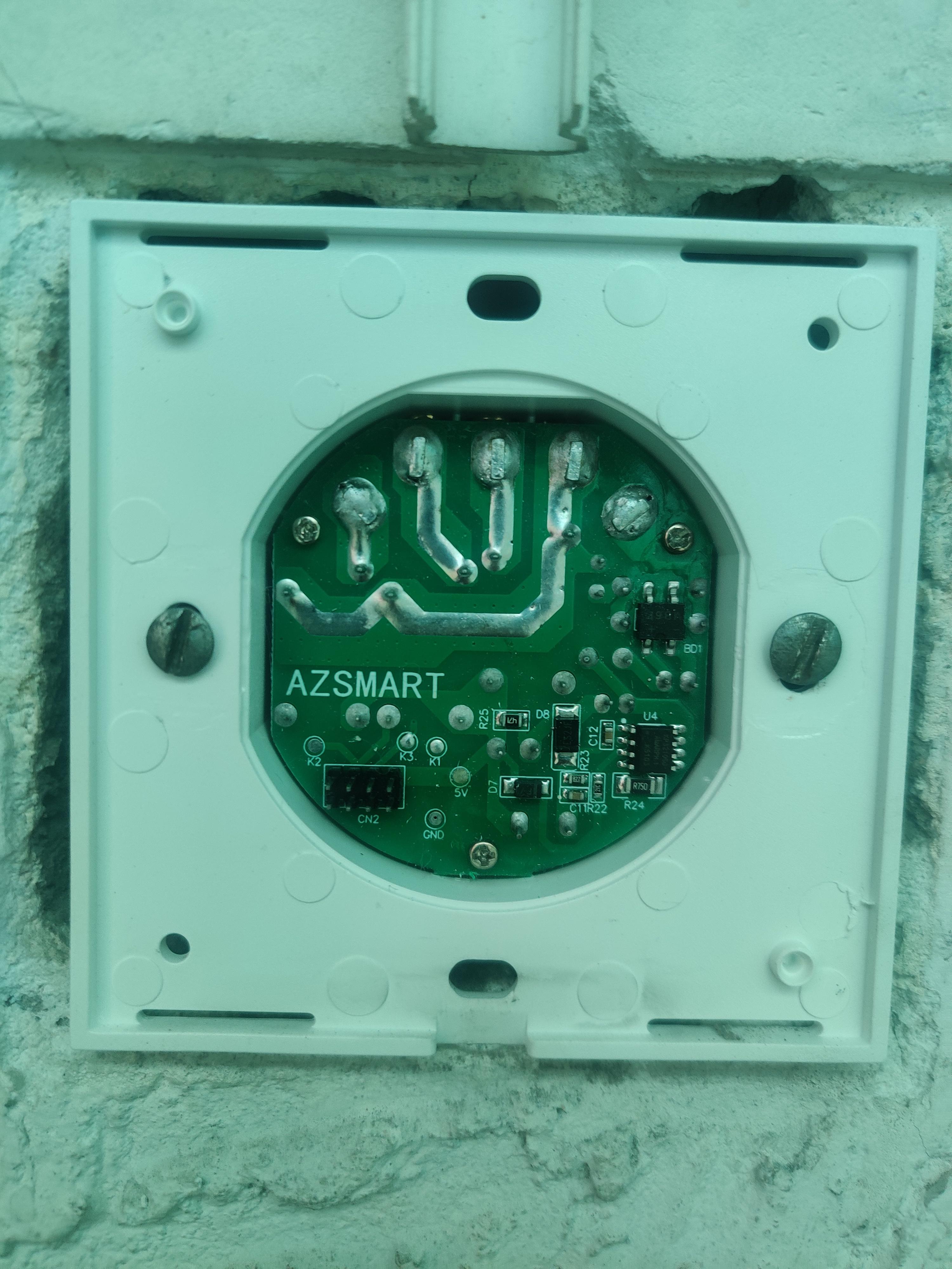

    I have a 3 gang touch switch from Tuya similar to '3 Gang Switch (DS-103)' in the list. I was able to use this profile to install the Open Beken using Cloud Cutter.
    The problem is the pin layout of the device in the profile did not work. I manually figured out the pins for WiFi LED along with the 3 Relays. What I noticed was all 3 touch buttons are connected to the same GPIO PIN P23.
    This is the Analog pin, Seeting this to Temp I was able to measure the values as follows.
    no button 4095 C
    1st button 1604 C
    2nd button 897 C
    3rd button 2 C
    1st and 2nd 602 C
    1st and 3rd 4 C
    2nd and 3rd 3 C
    Is there any way to use the touch switch reliably?
    I am attaching the factory bin file along with the PCB pictures.
    Current Pin
    P7 Relay 1
    P8 Relay 2
    P22 WiFiLED
    P24 Relay 0
    Added packaging pictures.
    -Rishab

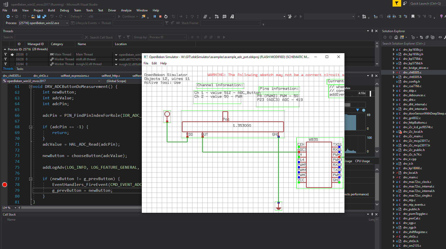

  • ADCButton mapping and autoexec setup for 3 buttons
    #8 20539846
    Posts: 14797
    Rate: 12955
    Hello, I didn't have time to test, but I will push a test version of a driver.
    Steps to setup:
    1. check ADC values for buttons
    You already gave me this:
    no button 4095 C
    1st button 1604 C
    2nd button 897 C
    3rd button 2 C
    2. Create margins between values (as average values):
    no button 4095 C
    2900
    1st button 1604 C
    1250
    2nd button 897 C
    450
    3rd button 2 C
    3.
    Set role ADCButton for ADC in Configure Module
    4. Write autoexec.bat:
    // start driver - always first
    startDriver ADCButton
    // setup map to choose button
    AB_Map 450 1250 2900
    // setup event handlers for buttons
    // when got "no button" reading - do nothing
    // addEventHandler OnADCButton 0
    // on 1st button
    addEventHandler OnADCButton 1 toggleChannel 1
    // on 2nd button
    addEventHandler OnADCButton 2 toggleChannel 2
    // on 3rd button
    addEventHandler OnADCButton 3 toggleChannel 3
    Tested only in simulator:
    [BK7231T] Tuya switch with multiple buttons on single ADC pin
    Please test and let me know if it works
    I hope you know our scripting syntax.
