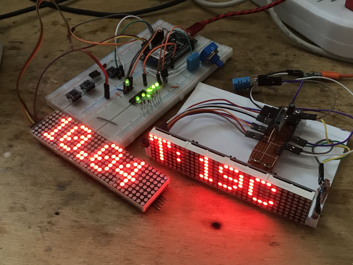

    Right now, I am finalizing the clock:
    Using Tuya Aubess Mini Smart Switch (Belon2028N) with 16-Channel Relay Board: Shift Register Method Using Tuya Aubess Mini Smart Switch (Belon2028N) with 16-Channel Relay Board: Shift Register Method
