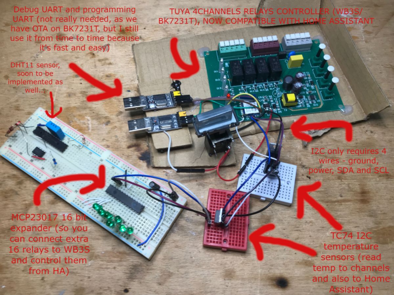

    Hello, I have did a similiar thing in the past with I2C port expander that provides up to 16 GPIO able to drive relays.
    Using Tuya Aubess Mini Smart Switch (Belon2028N) with 16-Channel Relay Board: Shift Register Method
    I2C port expanders are cheap:
    And they are already supported.
    Still, I can make that work for you with a shift register as well. Which approach do you prefer?

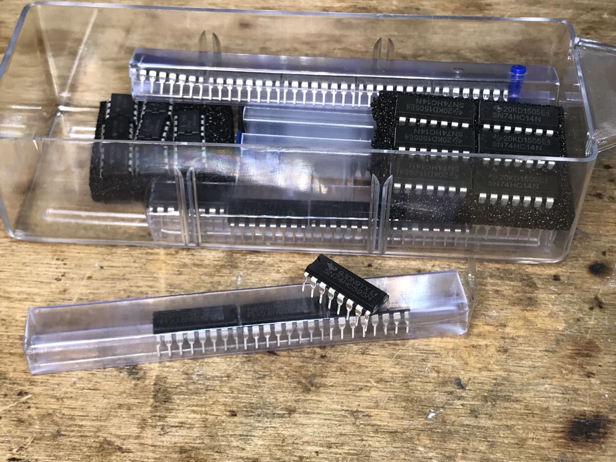

    I have some of 74hc595
    And the relay board is active low

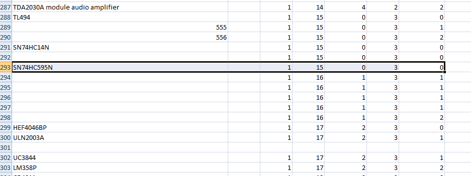

    #6 20529426
    Posts: 14767
    Rate: 12906
    It seems that I have them in stock:
    Yes, here it is:
    I will try to get it running with OBK. Please remind me tomorrow if I forget.

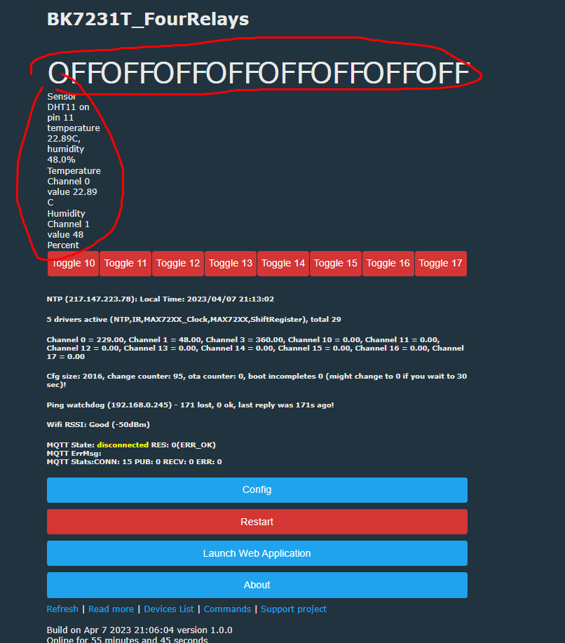

    Currently port shift out function is working on 32 bit integer, so we can have 4 registers chained together
    I have working basic driver, but only for a single register. Tomorrow I will add support to multiple ones.

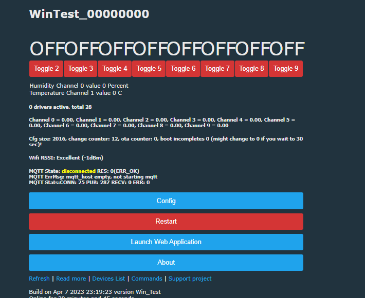

    There is a slight issue with HTML page style:
    The current config approach for driver is following:
    // startDriver ShiftRegister [DataPin] [LatchPin] [ClkPin] [FirstChannel] [Order] [TotalRegisters]
    startDriver ShiftRegister 24 6 7 10 1 1
    // If given argument is not present, default value is used
    // First channel is a first channel that is mapped to first output of shift register.
    // The total number of channels mapped is equal to TotalRegisters * 8, because every register has 8 pins.
    // Order can be 0 or 1, MSBFirst or LSBFirst
    // To make channel appear with Toggle, please also set the type:
    setChannelType 10 Toggle
    setChannelType 11 Toggle
    setChannelType 12 Toggle
    setChannelType 13 Toggle
    setChannelType 14 Toggle
    setChannelType 15 Toggle
    setChannelType 16 Toggle
    setChannelType 17 Toggle
    More details tomorrow.

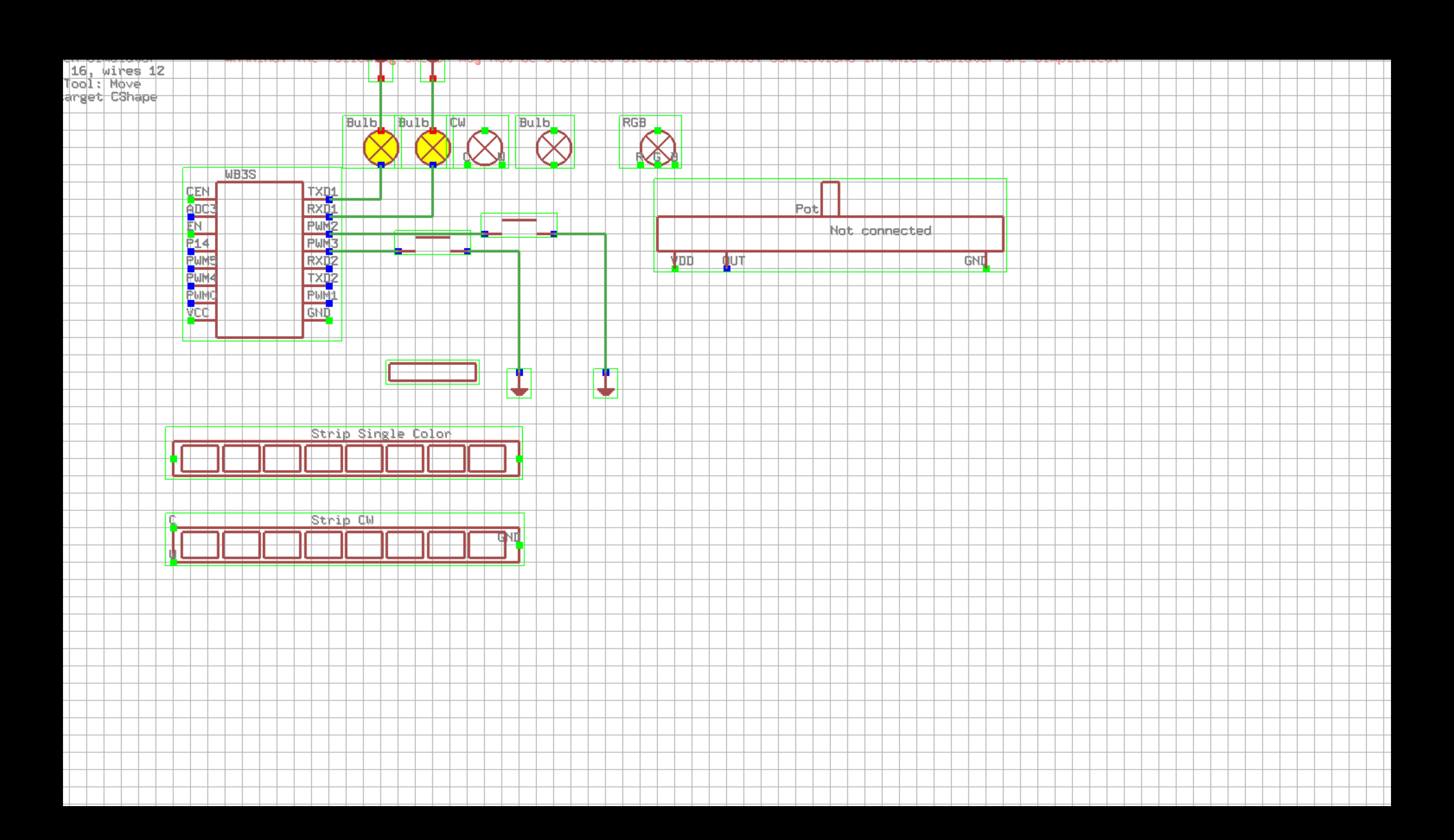

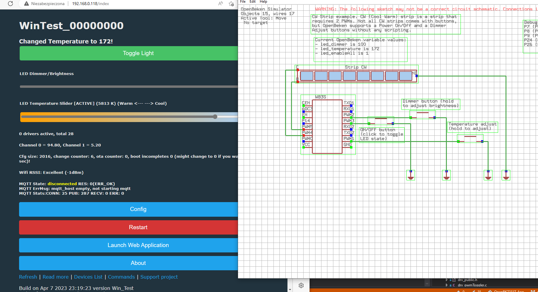

    What would you like to know when it comes to source code? Do you know that OBK runs on Windows as well?

    Since you told it can run in Windows... My first step would be setting it in my Windows machine. The I would figure your style of programming so I can keep the same style of code in my additions.

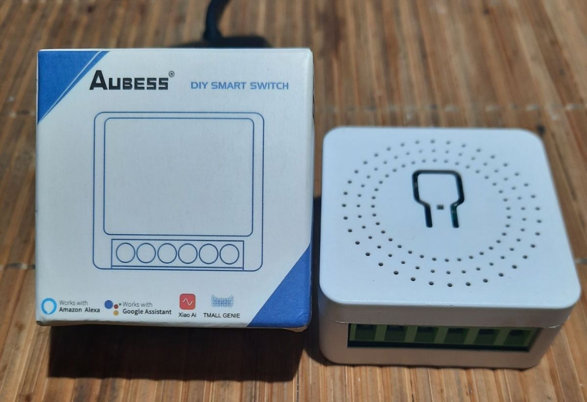

    So. I got some time to talk about my project.
    Some time ago I bought some units of this tuya module: tuya aubess mini smart switch (Belon2028N). I used some of them in my shop for testing and they work well.

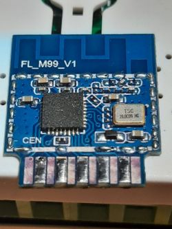

    Then, one day, I got a lightning strike in one of the external lights that were using the module and it fried.
    So, last week I decided to analyse the damage and it turns out just the power supply part of the board is gone, and the wifi chip still works fine.
    I decided to remove the wifi module from the relay board and tried to power it and it worked and I figured it had some IO not being used in the original board.
    So I googled for some hacking for its chip (BL2028N). That's when I got to the OpenBK guide for the module
    Since I had one of those 16 channel relay boards laying around, I thought of reprogramming the tuya wifi module to drive it.

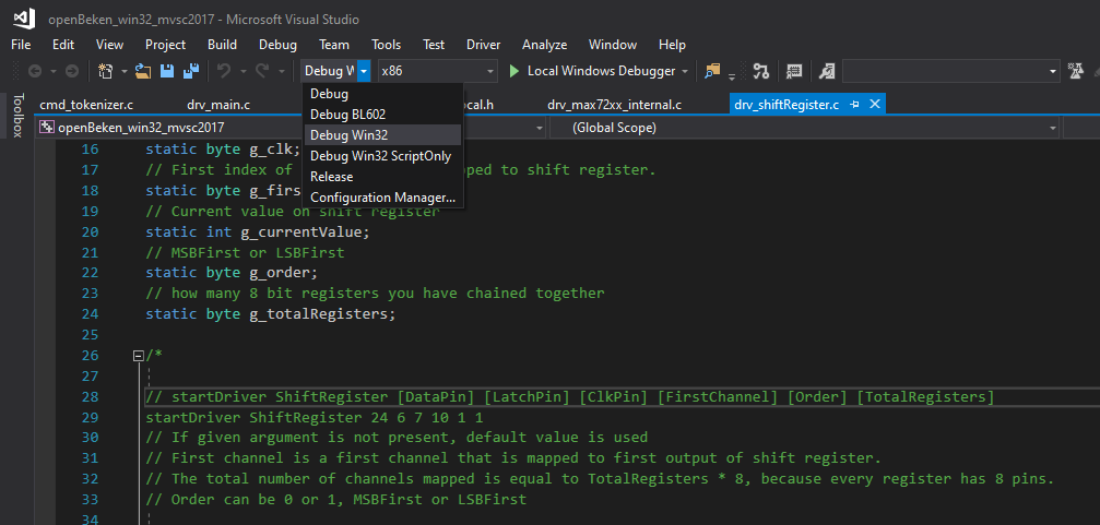

    @pkaczmarek262 You mentioned the possibility to run OpenBK in windows. Is there a guide for that?
    Nevermind. I found the git page for building
    Added after 1 [hours] 8 [minutes]:

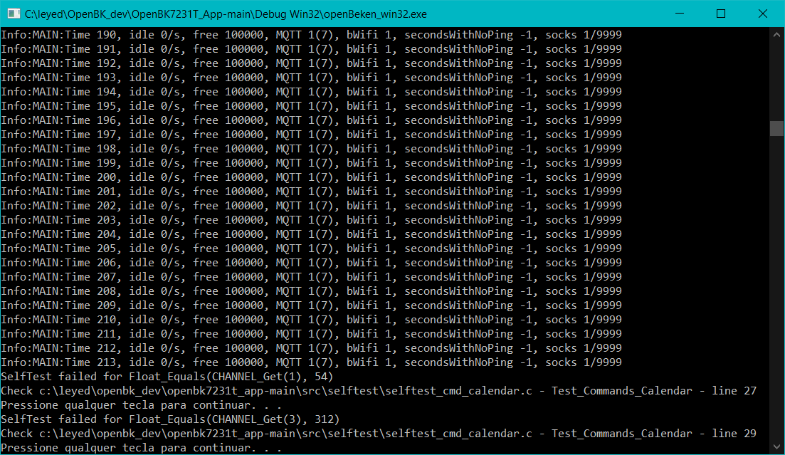

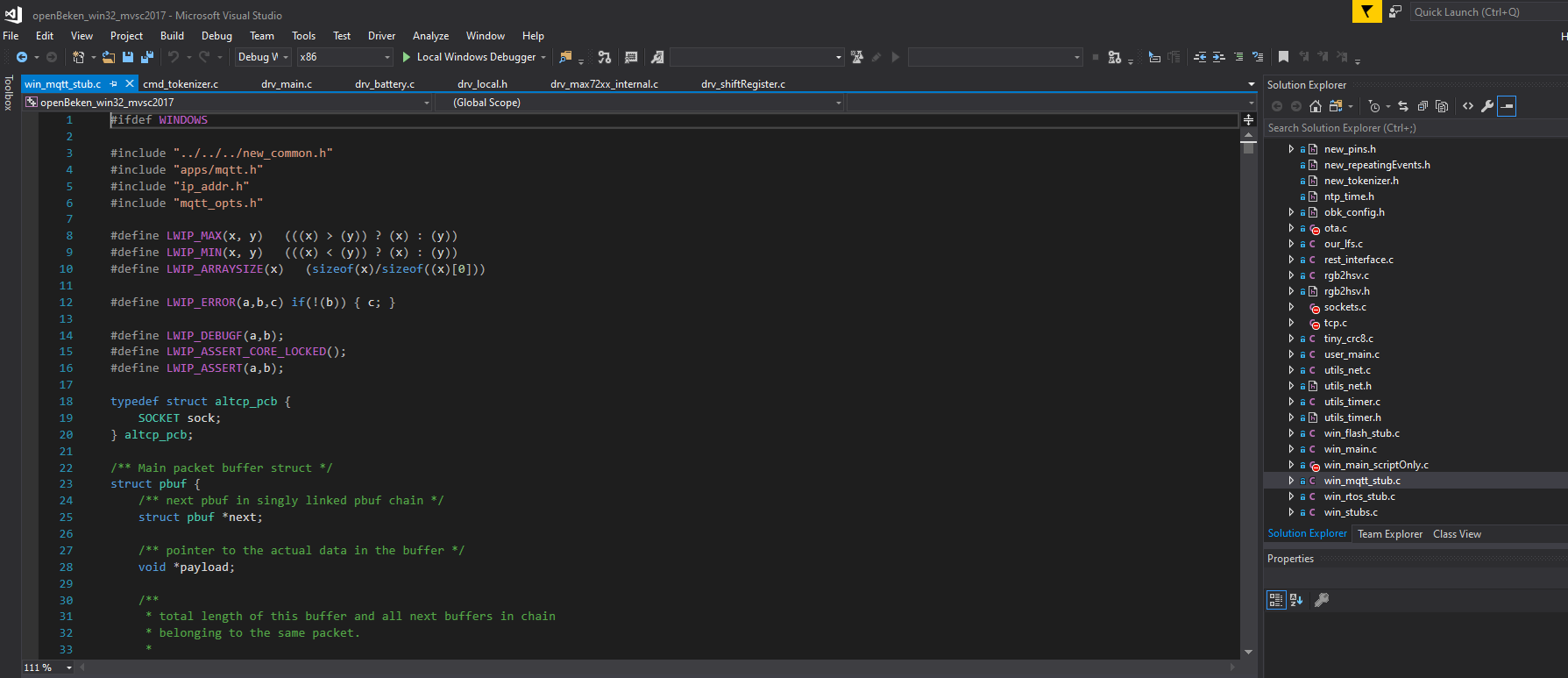

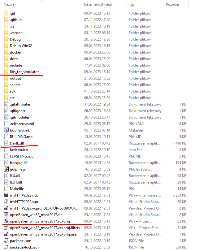

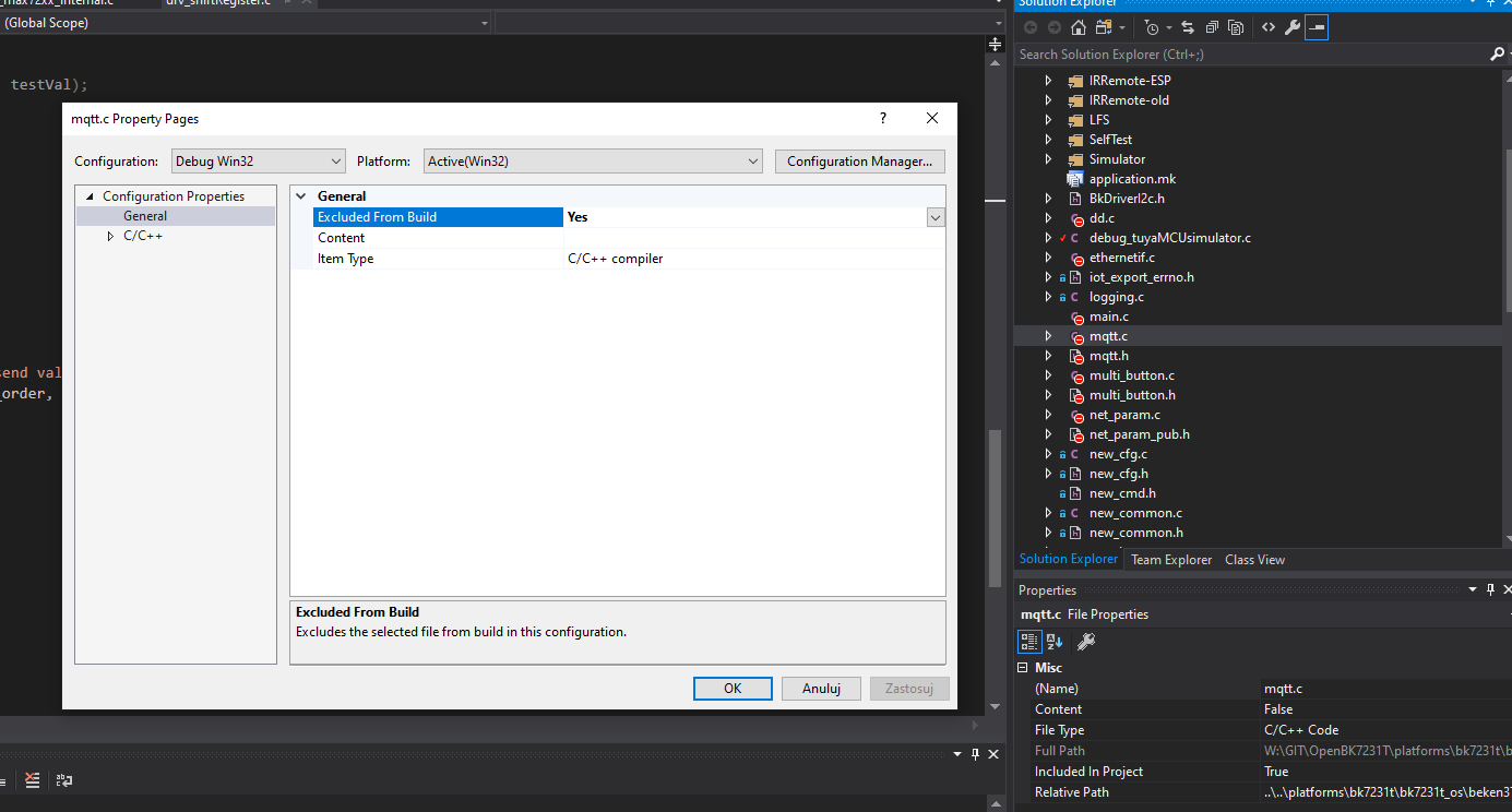

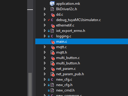

    So. I started trying to build it and I already see some missing important information on the guide:
    First:
    new_builtin_devices.c - this file is needed for building and VS gave me a missing file error... I saved a blank file and it stopped.
    Second:
    windows debug build uses SDL - I am familiar with the lib but it is not installed in my actual system. I will setup SDL in my machine and see if there's something else missing in the guide[/align]
    Added after 6 [minutes]:
    Third:
    Glut lib is being used too
    Added after 12 [minutes]:
    Fourth:
    Native File Dialog lib[/quote]
    Added after 3 [minutes]:
    Fifth:
    Libdevil...
    Added after 2 [hours] 8 [minutes]:

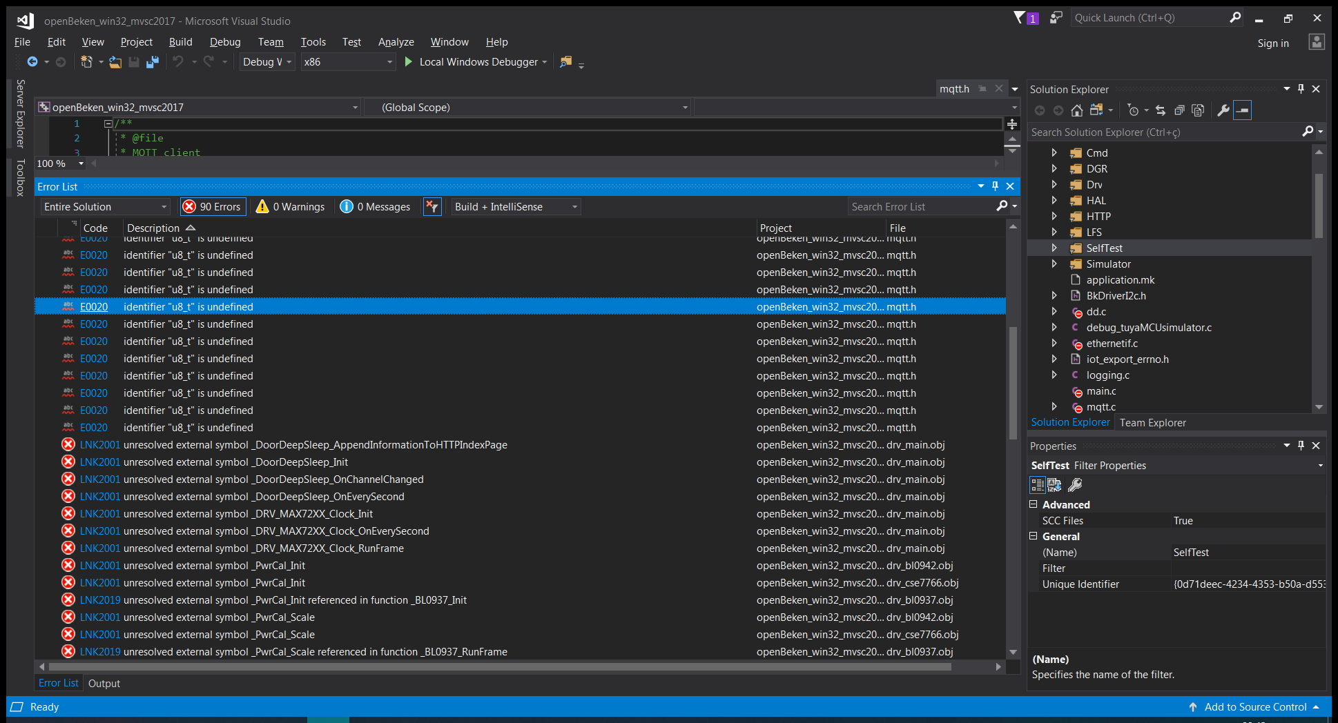

    So... I managed to set all those dependencies, but I still have some problems to compile the windows test version.
    looks like you linked some files that are in paths that are not in the project folder...
    I got some undefined symbol errors and some files in solution manager are with the missing icon.
    I inspected those files and they are referenced to paths outside of the project folder... So I don't have them...
    dd.c
    ethernetif.c
    main.c
    mqtt.c
    mqtt.h
    multi_button.c
    multi_button.h
    net_param.c
    net_param_pub.h
    sockets.c
    tcp.c
    I tried finding those files manually and had no success...
    Maybe there's something set differently in your system?

    That's the dependency OpenBK7231T...
  • Win32 build uses separate MQTT stub

    Hello, sorry for the late reply, but it's 8AM morning in my country and I was sleeping earlier.
    I can upload all dependencies to separate repository to make it easier, if you need it.
    The important part is here:
    You need to select Win32 build. This is because the posted list of files are not needed for Win32. They were just included in project for a reference.
    Added after 48 [seconds]:
    See how it looks for me:
    they are excluded from build
    On windows, MQTT from Beken SDK is not used:
    Windows has separate MQTT stub that works with Winsock (non-blocking sockets, single threaded):

    So. I think I got all the right dependencies:
    Freeglut
    LibDevil
    NFD
    SDL
    VS is not asking for include or lib files anymore.
    But it still throws me some errors:

    1. Get this repo:
    2. Get this repo:
    https://github.com/openshwprojects/obkSimulator/
    3. Copy content of "simulator" to base dir from previous repo
    Make sure that "libs_for_simulator" are in the same dir that vcxproj is
    4. build project - select Win32 build
  • Copying nfd_d.lib fixed the linker error

    Severity Code Description Project File Line Suppression State
    Error LNK1104 cannot open file 'nfd_d.lib' openBeken_win32_mvsc2017 C:leyedOpenBK_devOpenBK7231T_App-mainLINK 1
    copying nfd_d.lib from the build I tried resolved the issue
    trying to figure the gui now

    In the setup there's some self test errors too:
    at the end localhost is working and i have OpenBK to manage.
    Finally it works. Thanks
  • Asking how to reproduce addClockEvent self-test errors
    #23 20532156
    Posts: 14767
    Rate: 12906

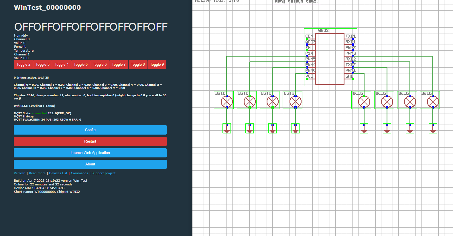

    There are tools bound to key 1, 2, 3, etc. Unfortunatelly there is no readme about it yet, and no icons for tools. I can try to write one today or tomorrow for you. In general, official release of simulator is on our TODO list. We are hoping to create a simulator tutorial for our Youtube channel someday:
    I will push shift register update today or tomorrow.
    Can you tell me how do you get self test errors? I can see they relate to addClockEvent self test, but how? I tested right now and I get no self test errors.
  • #24 20532166
    smkassist
    Level 4  
    Posts: 33
    I understand you made this tool, right?
    The number for the tools is 1 through 7.
    There's no component for simulating shift register yet
    those self test errors appear as soon as the compilation is done... Before the SDL window starts
  • OpenBeken simulator lacks shift register support
    #25 20532301
    Posts: 14767
    Rate: 12906
    Yes, I made OpenBeken and I made the simulator. It's my tool used to speed up development of OpenBeken.
    I don't get self test errors, so it's strange, it's worth investigating, but maybe we can do it later.
    There is no shift register component in the simulator indeed, but you can still play around with all other features of OBK, including MQTT and Hass Discovery. And you can test how scripts behave, etc.
    And of course ShiftRegister driver is still running on Windows, so you can put breakpoints, etc, to debug and check how it works. It's very useful for the development.

    I think those self test errors are not really important for now... The system seems to be running ok. I see that the simulator part is coded in C. I am reviewing the code and I think I can be useful with it.
  • ShiftRegister now supports up to 4 registers

    I would really want to know why those self test errors happen. Maybe somehow your build is missing "addClockEvent" function?

    It seems to work well:
    I also saw your topic about RF addon, I will look into it.
    What else can I do for you now? Is there any other peripheral you've got in mind?
    Added after 30 [minutes]:
    I am looking into why HTML breaks:
    Added after 7 [minutes]:
    EDIT: I have improved HTML a bit:

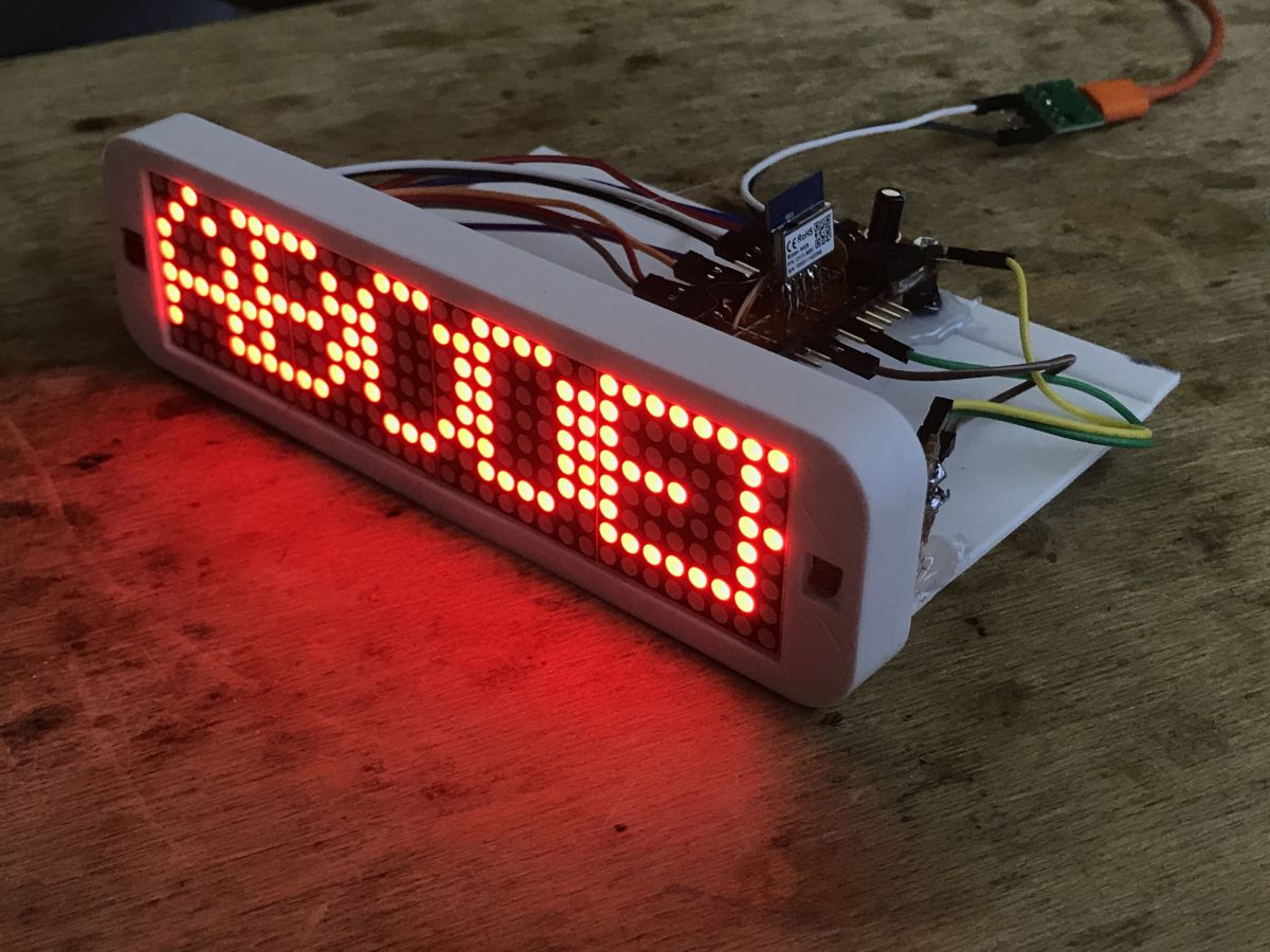

    How is simulator working for you? Have you experienced any bugs? Any feedback is welcome.
    I submitted some Obk Sim examples:
    https://github.com/openshwprojects/obkSimulat...mmit/82037eb517c2bfcf49e9b53c83d6291cd5282592
    Our IR tries to mimic Tasmota behaviour. You can see an example here:
    I don't know about RF behaviour. We would need to look how Tasmota handles it, I assume that it would require a single GPIO and some kind of driver. Probably an interrupt-based one, It's on my TODO list.
    My clock has IR receiver:
    Using Tuya Aubess Mini Smart Switch (Belon2028N) with 16-Channel Relay Board: Shift Register Method Using Tuya Aubess Mini Smart Switch (Belon2028N) with 16-Channel Relay Board: Shift Register Method Using Tuya Aubess Mini Smart Switch (Belon2028N) with 16-Channel Relay Board: Shift Register Method

    Self-test error continues to appear every time I start the simulator. But nothing crashes or gets a strange behavior.
