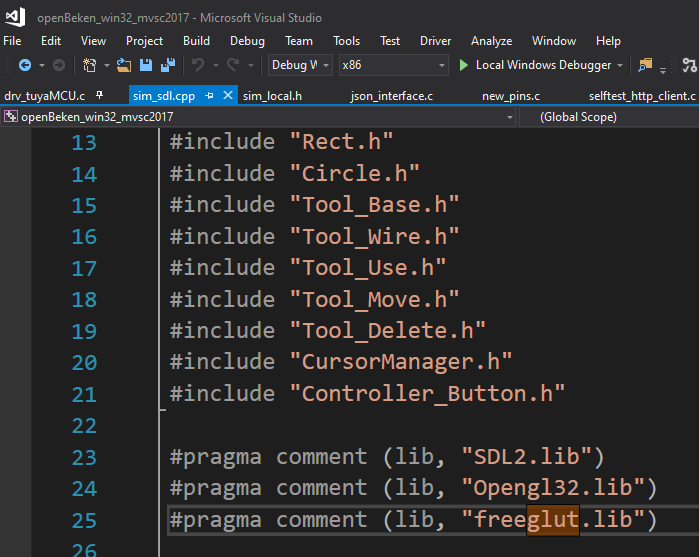

How do I compile the simulator in Visual Studio?
  1. Clone OpenBK7231T_App.
  2. Add SDL2, FreeGLUT, OpenGL include and x86 libs; ensure glut32.lib path is correct.
  3. Build the ‘sim’ target; compile time is under three minutes on i7-6 Gen [Elektroda, snakesrules94, post #20949208]
