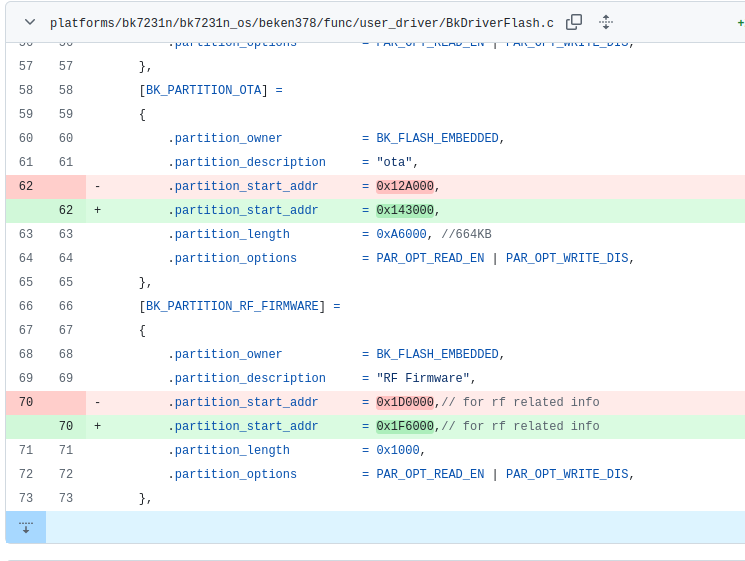

    Since we use a script, you can also use all other commands to change files, like "sed".
    So say you need to change two values in BkDriverFlash.c file and want to change .partition_start_addr"
    for [BK_PARTITION_OTA] from 0x12A000 to 0x143000 and
    for [BK_PARTITION_RF_FIRMWARE] from 0x1D0000 to 0x1F6000
    in this section
    Comparison of BkDriverFlash.c file versions before and after changes.
        [BK_PARTITION_OTA] =
            .partition_owner           = BK_FLASH_EMBEDDED,
            .partition_description     = "ota",
            .partition_start_addr      = 0x12A000,
            .partition_length          = 0xA6000, //664KB
            .partition_options         = PAR_OPT_READ_EN | PAR_OPT_WRITE_DIS,
        [BK_PARTITION_RF_FIRMWARE] =
            .partition_description     = "RF Firmware",
            .partition_start_addr      = 0x1D0000,// for rf related info
            .partition_length          = 0x1000,
        [BK_PARTITION_NET_PARAM] =
    You can use a "sed" command to do the change.
    To make sure, the replacement is only done at the correct line(s) you could/should use ranges before the replacement, like in this command:
    # as ranges we use "/\[BK_PARTITION_OTA\]/,+4" and "/\[BK_PARTITION_RF_FIRMWARE\]/,+4"
    # the line with ".partition_start_addr" is the 4th line after the matching "header"
    sed -i "/\[BK_PARTITION_OTA\]/,+4 s/0x12A000,/0x143000,/; /\[BK_PARTITION_RF_FIRMWARE\]/,+4 s/0x1D0000,/0x1F6000,/" sdk/OpenBK7231N/platforms/bk7231n/bk7231n_os/beken378/func/user_driver/BkDriverFlash.c
    Or, taking a look in the source, we see the numbers to change are between line 62 and 70 and the values are unique in this area, so we can also use the range "62,70"
    sed -i "62,70 {s/0x12A000,/0x143000,/; s/0x1D0000,/0x1F6000,/}" sdk/OpenBK7231N/platforms/bk7231n/bk7231n_os/beken378/func/user_driver/BkDriverFlash.c
