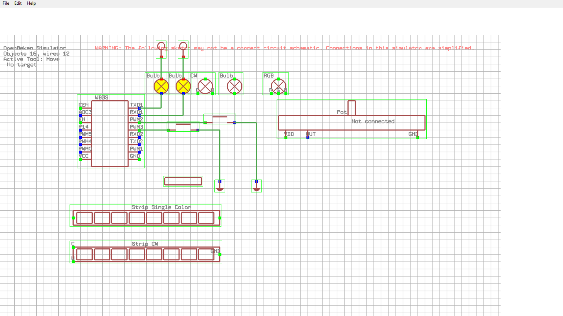

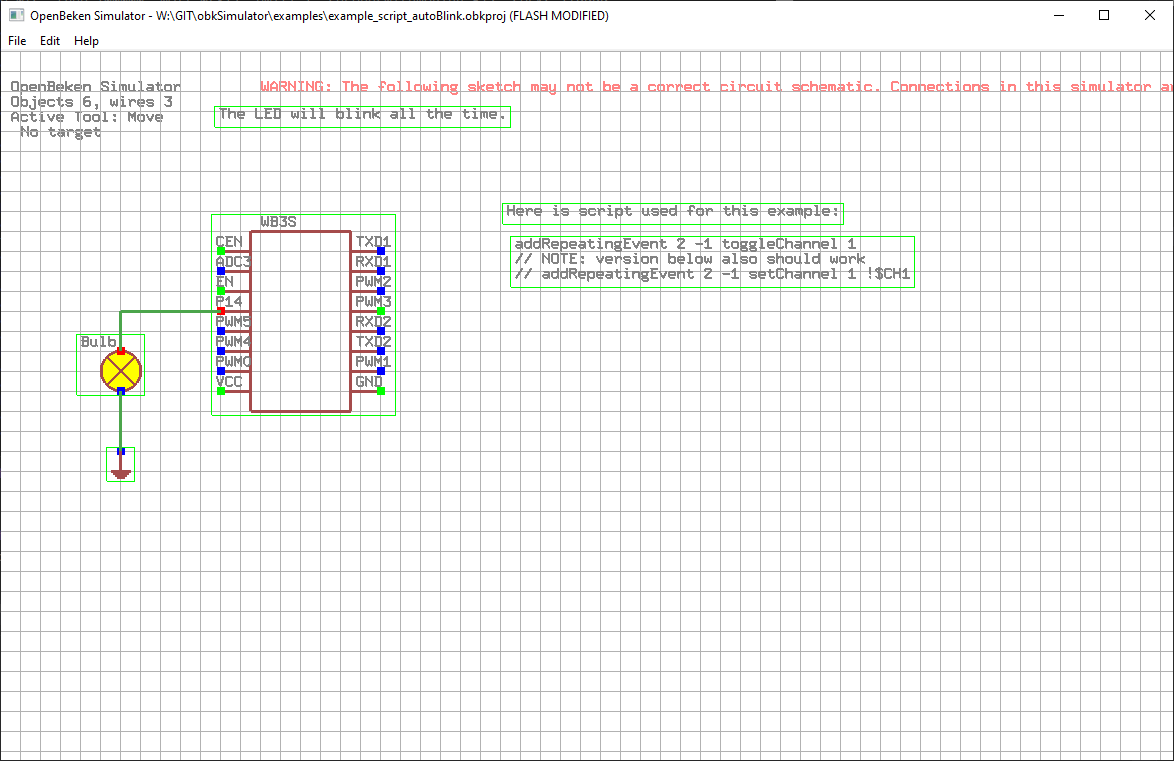

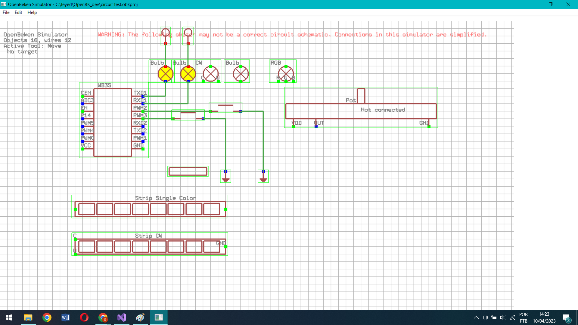

    I see that the SDL Window and SDL Renderer uses the variables "WinWidth" and "WinHeight" in sim_sdl.cpp
    the pre-set resolution is 1680x940, but when I start the program on my laptop (1920x1080) the program render is offset and some of the items in the render is out of my screen.
    Window Mode:
    OpenBeken Simulator Discussion and improvements
    Fullscreen mode:
    The solution I found was to change the base resolution manually for now.

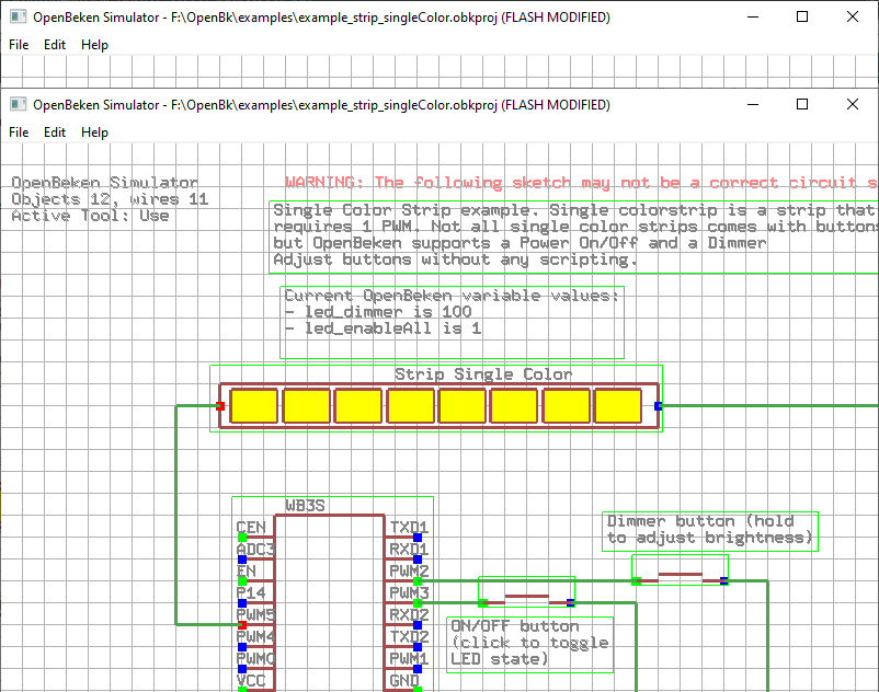

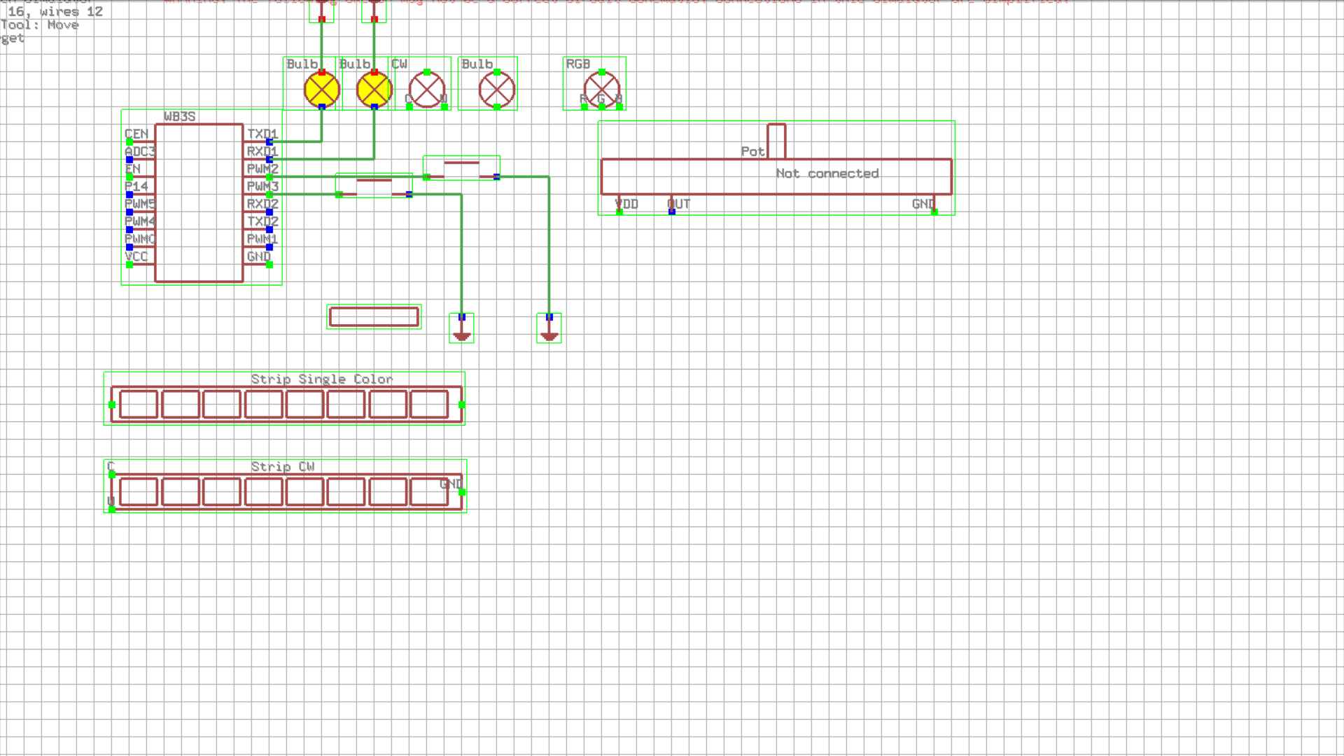

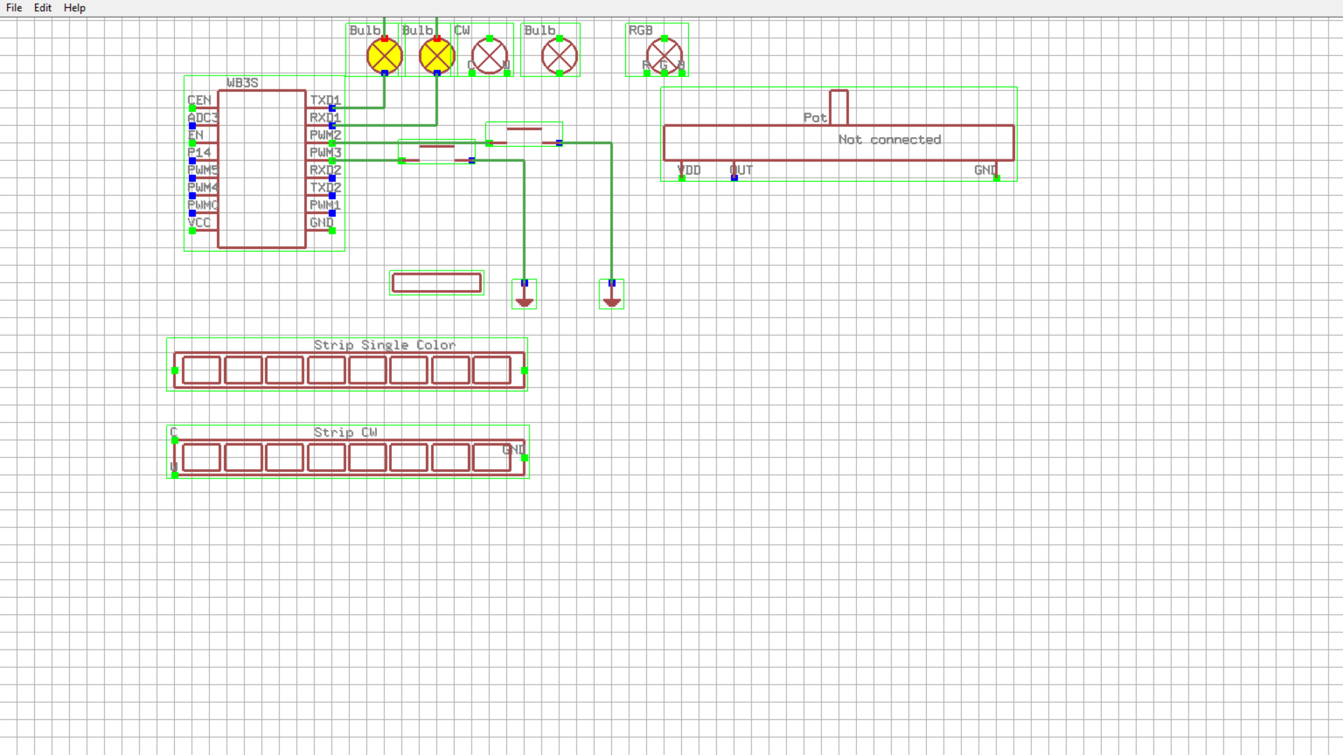

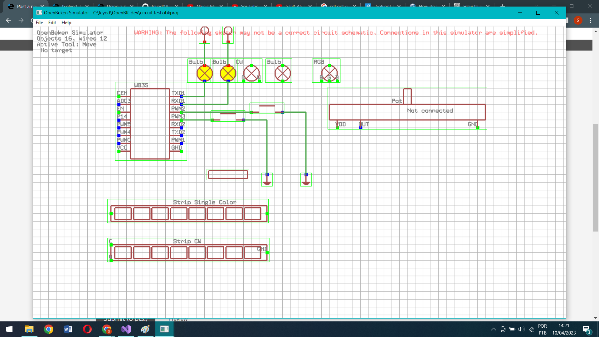

    Here's an example using the resolution 1366x768 and using SDL_WINDOW_RESIZABLE in window flags on simulator.cpp:
    Windowed mode:
    Maximized Window:
    FullScreen:
    Now content Renders with top left corner in the right place. When I maximize the window or change to fullscreen the render doesn't adjust to the new resolution.
    I am going to try to change that so the renderer adjusts every time there's a window change event, and later I find it useful to add the functionality to move and zoom the renderer.

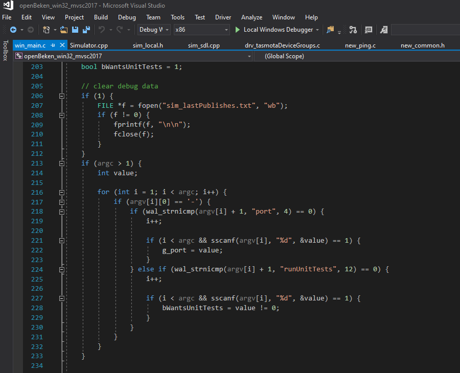

    You can also consider changing win_main.cpp (btw, it's a bad name, because it should also work on linux, it's SDL app) to support setting custom resolution in command arguments:
    That way you can create, for example "sim_800x600.bat" script that just runs simulator in given vid mode.

    Thank you, merged. You can also add ability to specify resolution via command line while starting the simulator.

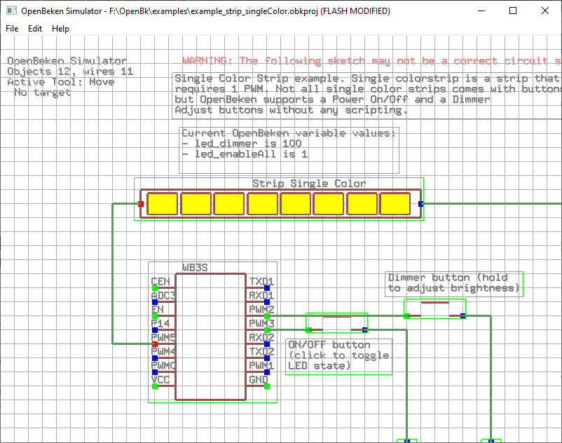

    Thank you for reporting,
    I have updated the scene change logic to fix the autoexec issue.
    You can check it now, for example on this scene:

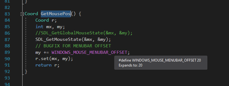

    I had made a little change and sent a PR. Did you see that? PR 784. After the screen resolution fix, the collision checks had a vertical offset for some reason, so I did a little adjust until I find the correct solution
  • #17 20537961
    Posts: 14460
    Help: 650
    Rate: 12470
    hmm but I added this offset to fix collision issue caused by WINAPI Menubar addon, see sim_sdl.cpp:
    so it looks like our changes cancel each other out.
    Does it mean that handling WINAPI resize message somehow indeed fixed correctly the menubar? Well... it makes sense, if you think about....
    It seems that your windows resize event made my offset hack unnecessary. Nice.
    I need to double check that and remove both offsets.

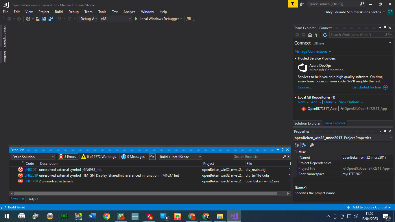

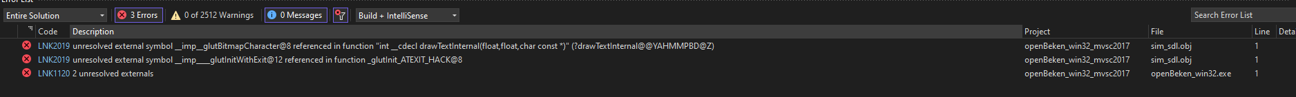

    Something Broke in the last commit:
    I think it would be useful if you kept libs_for_simulator folder in the OpenBK7231T_App Git page (remove it from gitignore) so if something is changed in the deps we don't have to sync the app branch AND change manually the deps
    >>20537961
    Different approaches to the same thing. But yours seem to be a better approach... Ignore mine and fix it the right way then.

    I was adding a TM1637+GN6932 custom driver and forgot to update msvc project.

    snakesrules94
    Posts: 37
    I've tried to compile under VS Community to get the simulator working but I can't succeed. I've added all the libs/includes needed and at the end, I have those errors:
    Compilation error list in Visual Studio showing unresolved external symbols related to GLUT.
    Is there a kind of guide/tutorial to get it running or maybe I forgot something?
    Regards.
