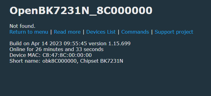

    I am using the OpenBK7231N_QIO_1.15.699.bin software and I do not have the Configure IP option in the WEB GUI

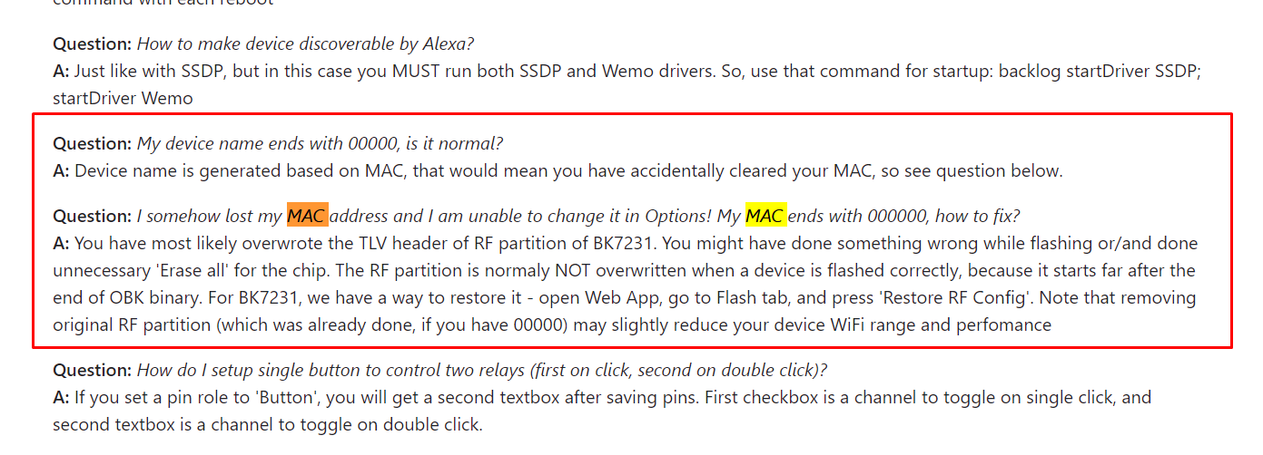

    You need to update the firmware. In addition, from the description of your problem, I'm beginning to suspect that you may have performed an operation in the flasher Clear all , i.e. you have removed the entire Flash memory, as a result of which the MAC address has changed to the default one, ending with 0x00 characters. Now if you have another same device, you will have two devices with the same MAC, which will result in problems connecting them.
    The normal OpenBeken upload operation does not clear the entire memory, only its beginning, and leaves the MAC sections unchanged.
    If your MAC address ends in 0x00, there are two solutions:
    1. via UART, in our flasher, do Restore RF partition: https://github.com/openshwprojects/BK7231GUIFlashTool
    2. In our Web Application, in the Flash Memory tab, press the Restore RF partition button
    The Restore RF Partition operation will assign a new random MAC address to your device and solve WiFi connection issues.
    Btw: we already have a lot of answers in the FAQ:
    https://github.com/openshwprojects/OpenBK7231T_App/blob/main/docs/faq.md

    RF partition removal detected from zeroed MAC address
    #36 20546859
    Posts: 14782
    Rate: 12920
    You have indeed removed the RF partition, as evidenced by the device name ending in zeros. This name comes by default from the MAC, which also ends with zeros, which means that during flashing you had to overwrite the RF section or perform Clear All (the entire 2MB flash).
    There should be a big "Exit safe mode" button in the main menu, but the Web App downloads from the web, so it may not open for you. I have separate wifi and separate internet connected by cable, so it works for me. Try the Web App anyway.
    If it doesn't go, disconnect the device with the same MAC from the router (I guess it is, because this problem has already appeared on the forum), or fix the RF partition on that device, and then fix it on the other one, it was written in like previous post.
    As a last resort, you can also simply repair the RF partition via UART.

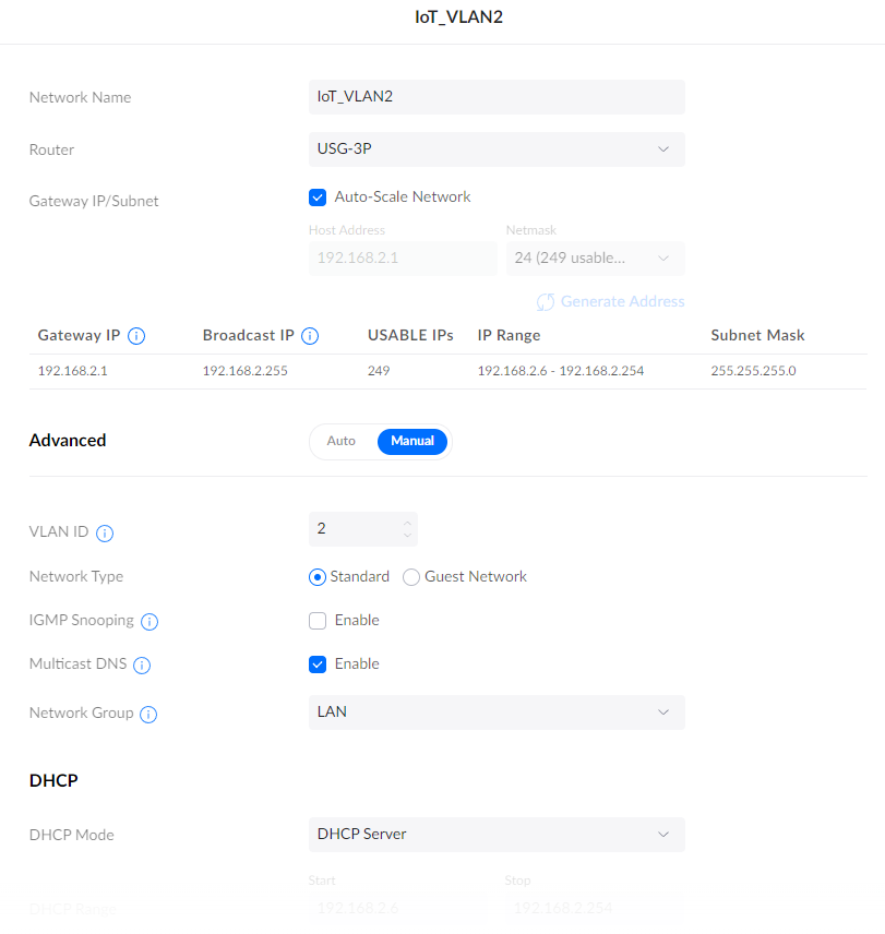

    Fixed IP: 192.168.2.44, 255.255.255.0, 8.8.8.8, 192.168.2.1
    2.4GHz WiFi network
    Unfortunately, there is still no IP and no access to the device, DHCP does not assign an address for this device, and somehow setting the IP to a fixed one also does not change anything Using CH341A Programmer for BK7231N/CB3S Door/Window Sensor PB-69W VER 1.3: UART & OpenBK7231N_QIO Using CH341A Programmer for BK7231N/CB3S Door/Window Sensor PB-69W VER 1.3: UART & OpenBK7231N_QIO

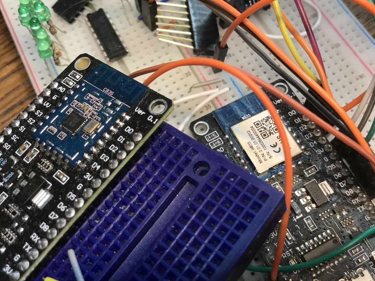

    The situation becomes very mysterious. To sum up - you wiped 2MB flash, lost the RF partition, then restored it, and the device still won't connect to your WiFi?
    On which BK are your devices, on which is the strip, and on which door sensor?
    I have two dev boards with BK7231T and BK7231N, just to be sure, I will clean their flash at home and check if they connect ....
