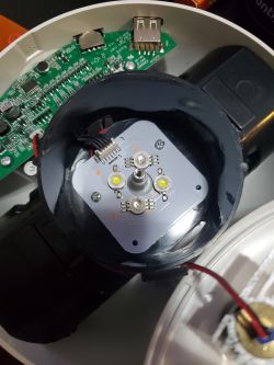

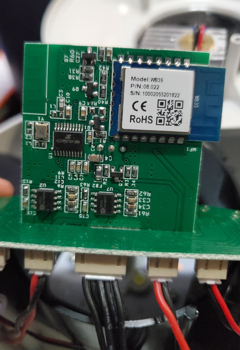

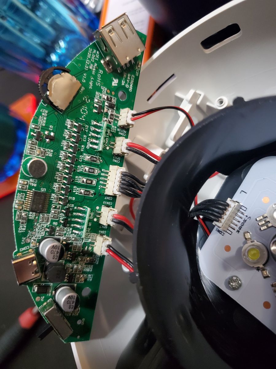

  • Internal photos show LED board cable color markings
    #3 20538689
    specialistk
    Posts: 7
    Here are some pictures of the insides. The black cable is the one that connects to the LED board and has color values marked. Hopefully that helps! I'll update this post with the pin values once I put it back together.
    Adding Tuya BL-XK01 Star Projector Light to OpenBeken: Configuring, Pin Values & Device Profile Adding Tuya BL-XK01 Star Projector Light to OpenBeken: Configuring, Pin Values & Device Profile Adding Tuya BL-XK01 Star Projector Light to OpenBeken: Configuring, Pin Values & Device Profile Adding Tuya BL-XK01 Star Projector Light to OpenBeken: Configuring, Pin Values & Device Profile
  • #4 20538793
    Posts: 14767
    Rate: 12906
    There are indeed two types of diode - RGB and cool white (I guess? YOu'd have to check if they are cool or warm). So 4 PWM channels for LED.

    Is the MCU connected to WB3S via RXD1/TXD1 port of WB3S, like in TuyaMCU product? So it uses UART for control...
