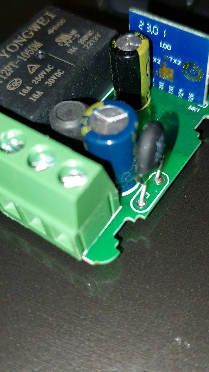

    [BK7231N+BL0942] DIY Smart Mini Switch - WBP-1G - configuration, pinout, program Hello forum.
    On Ali I bought a DIY Smart Mini Switch with energy measurement. I initially drew the pins for programming. Has anyone ever used such a device. (In Smart Live seen as WBP-1G. [BK7231N+BL0942] DIY Smart Mini Switch - WBP-1G - configuration, pinout, program
    Regards

    Indeed, it seems that the pads are marked correctly. Can you also attach a 2MB dump from this device and its IO configuration later?

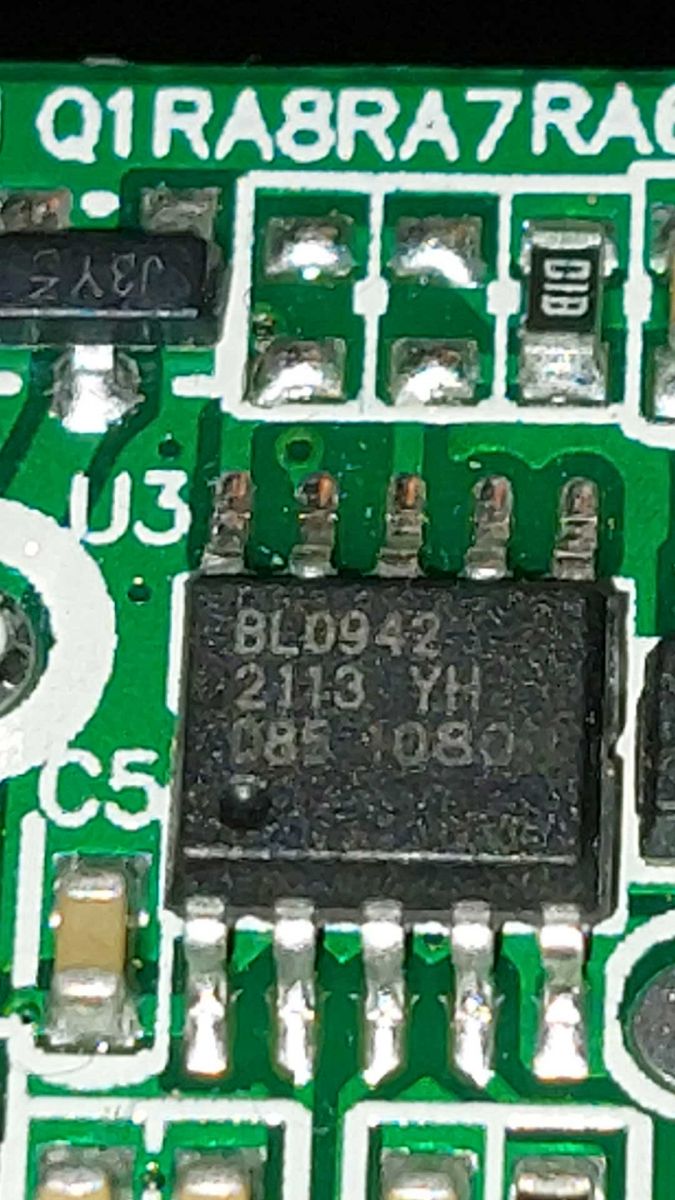

    In addition, I have the impression that I see BL0942 there (also in the picture, it has 10 legs). It is normally on the UART1 port, i.e. on P10 and P11.
    Does this configuration work for you?
    Due to the fact that the configuration of this device is almost complete, I separate these posts into a separate section.

    Oh and I learned something again, is it already uploading your software or something else needs to be done.
    (yes there is BL0942) [BK7231N+BL0942] DIY Smart Mini Switch - WBP-1G - configuration, pinout, program

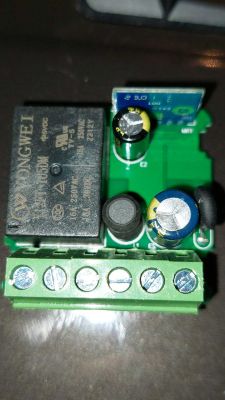

    Photo of the mini switch [BK7231N+BL0942] DIY Smart Mini Switch - WBP-1G - configuration, pinout, program

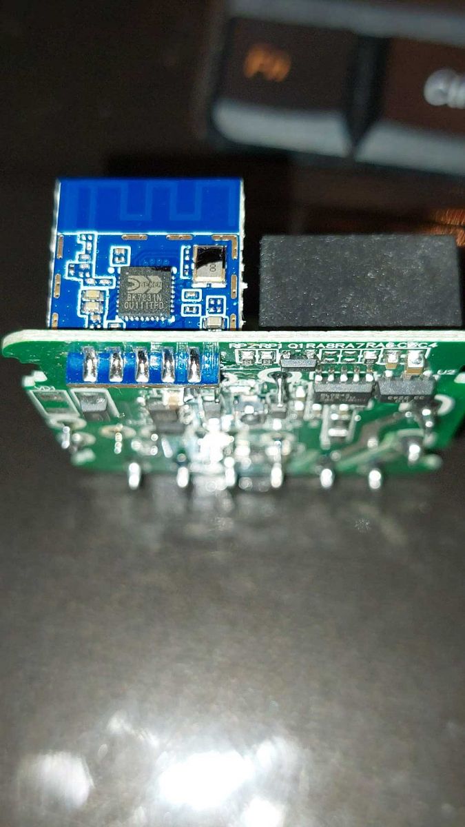

  • New WBP-1G smart switch board photos
    #21 20521696
    piratee

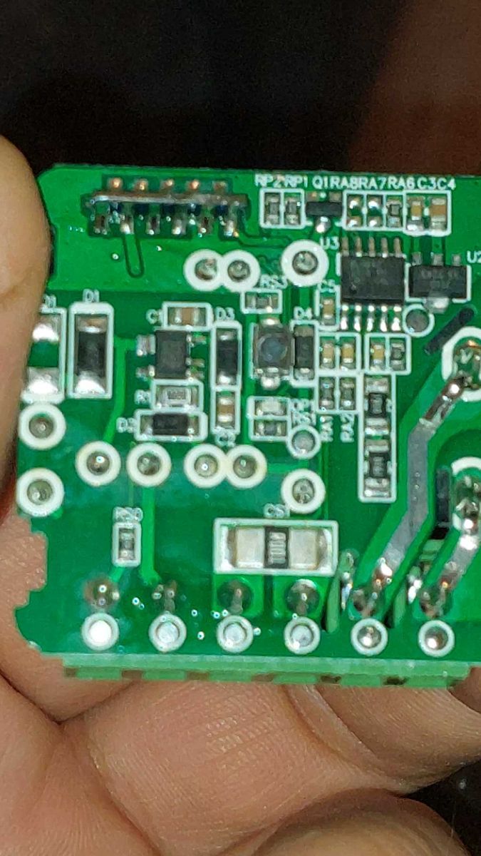

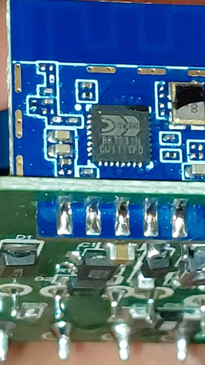

    Posts: 69
    [BK7231N+BL0942] DIY Smart Mini Switch - WBP-1G - configuration, pinout, program Hello.
    New DIY Smart Switch.
    Different design as the previous chip soldered vertically on a separate board.
    Pictures and read firmware [BK7231N+BL0942] DIY Smart Mini Switch - WBP-1G - configuration, pinout, program [BK7231N+BL0942] DIY Smart Mini Switch - WBP-1G - configuration, pinout, program [BK7231N+BL0942] DIY Smart Mini Switch - WBP-1G - configuration, pinout, program [BK7231N+BL0942] DIY Smart Mini Switch - WBP-1G - configuration, pinout, program [BK7231N+BL0942] DIY Smart Mini Switch - WBP-1G - configuration, pinout, program [BK7231N+BL0942] DIY Smart Mini Switch - WBP-1G - configuration, pinout, program [BK7231N+BL0942] DIY Smart Mini Switch - WBP-1G - configuration, pinout, program [BK7231N+BL0942] DIY Smart Mini Switch - WBP-1G - configuration, pinout, program [BK7231N+BL0942] DIY Smart Mini Switch - WBP-1G - configuration, pinout, program
    • readResult_BK7231N_QIO_2023-02-4--20-04-59.bin (2 MB) You must be logged in to download this attachment.
  • #22 20521756

    Hello again, based on the attached 2MB firmware dump, I am able to suggest the following configuration:
    - BL0942 on UART1 (standard)
    - WiFi LED on P8
    - Relay on P26
    - Pairing button on P23
    - TglChannelOnToggle on P24 (external switch)
    For verification.

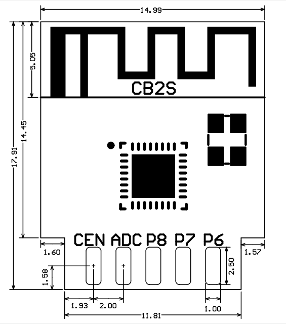

    ADC to jest to samo co ADC3 (P23). Poniżej masz pinout CB2S:
    Pin number Symbol I/O type Function
    1 3V3 P Power supply 3V3
    2 P6 I/O Support hardware PWM and correspond to P6 of the IC
    3 GND P Power supply reference ground
    4 P7 I/O Support hardware PWM and correspond to P7 of the IC
    5 RX1 I/O UART_RX1, which is used for receiving user data and corresponds to P10 of the IC. Do not pull it up. By default, the MCU serial port should be in low-level or high-impedance state.
    6 P8 I/O Support hardware PWM and correspond to P8 of the IC
    7 TX1 I/O UART_TX1, which is used for transmitting user data and corresponds to P11 of the IC. Do not pull it up. By default, the MCU serial port should be in low-level or high-impedance state.
    8 ADC I/O ADC, which corresponds to P23 of the IC
    9 P24 I/O Support hardware PWM and correspond to P24 of the IC
    10 CEN I/O Reset pin
    11 P26 I/O Support hardware PWM and correspond to P26 of the IC
    Test point RX2 I/O UART_RX2, which corresponds to P1 of the IC. This pin is not allowed to use.
    Test point TX2 I/O UART_TX2, which is used for outputting logs and corresponds to P0 of the IC
    Test point CSN I/O Mode selection pin. If it is connected to the ground before being powered on, enter the firmware test mode. If it is not connected or connected to VCC before being powered on, enter the firmware application mode. It corresponds to P21 of the IC.

Can I program the module without soldering every pad?
Yes. Clip 3.3 V, GND, RX, TX to the vertical CB2S board and flash OpenBeken successfully, no full disassembly needed [Elektroda, piratee, post #20521909]
