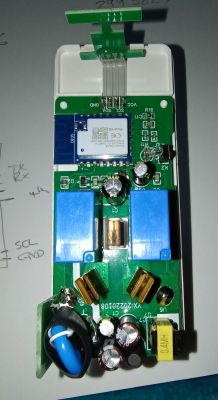

    Seems to be welded shut mainly in corners, few bashes with rubber mallet (ok gentle whacks!) and spudger and case came open, no damage, just go easy is my input
    Board and chips:
    Arlec PCTH01HA - Bunnings - CB3S BK7231N Arlec PCTH01HA - Bunnings - CB3S BK7231N Arlec PCTH01HA - Bunnings - CB3S BK7231N Arlec PCTH01HA - Bunnings - CB3S BK7231N
    In terms of flashing, tried a few times with windows version before reading comments that for the N version, python is the better way.
    Loaded up ras pi with spare sd card, raspbian lite installed and using python method, worked straight away. No desoldering any chips needed, just directly soldered jumpers to the chip vcc, gnd, rx and tx - all to cheap generic usb to serial dongle.
    My command was this, renamed the downloaded firmware to file.bin for easier typing:
    sudo python3 uartprogram /home/pi/file.bin --unprotect --startaddr 0x0 -d /dev/ttyUSB0 -w
    That's it, bang straight away it came up with open access point, added wifi credentials, up and running in web ui, fantastic!

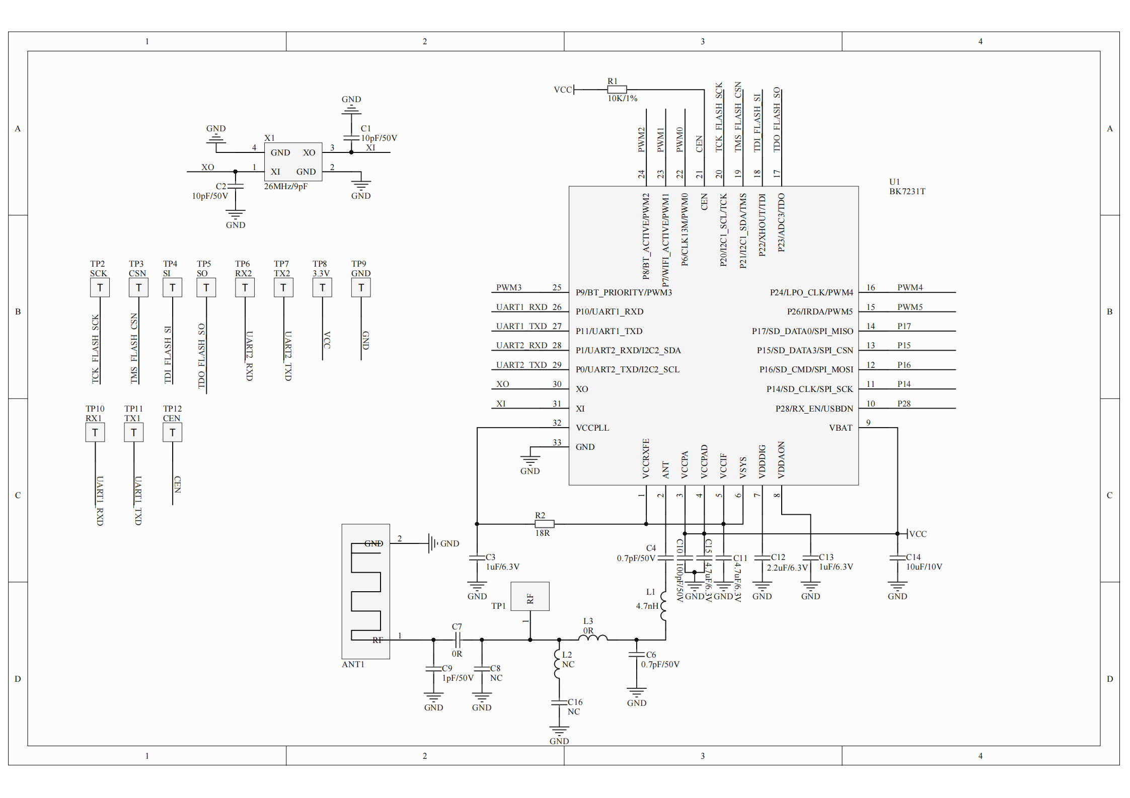

    BK7231 has two hardware I2C ports and they are already working in OpenBeken.
    I2C1 is P20/P21:
    I2C2 is P0/P1:
    P9 is not a hardware I2C..
    That means we need a software I2C... of course assuming that the target chip is using a non-modified I2C protocol... I will check this soon

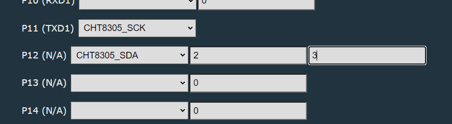

    Thanks to our contributor, a simple CHT8305 driver has been added.
    USAGE:
    - select CLK pin
    - select data pin
    - save pins
    - for data pin, select two channels to store temperature and humidity (not the same channel! Two different ones...):
    Please try it out.
