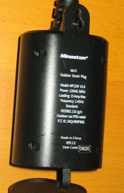

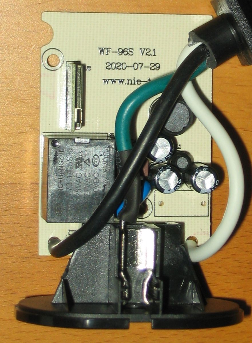

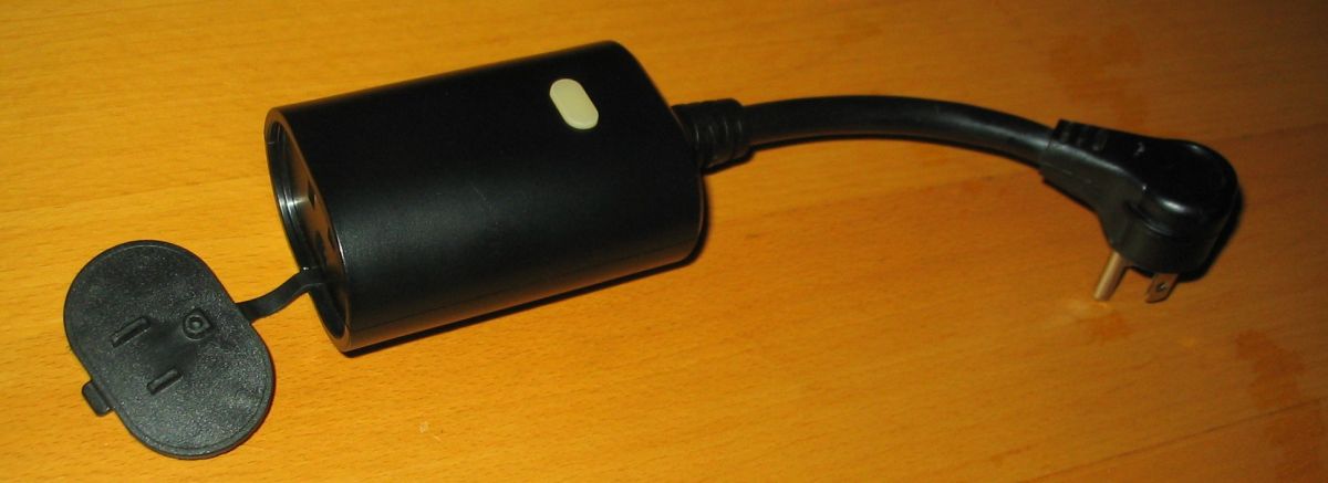

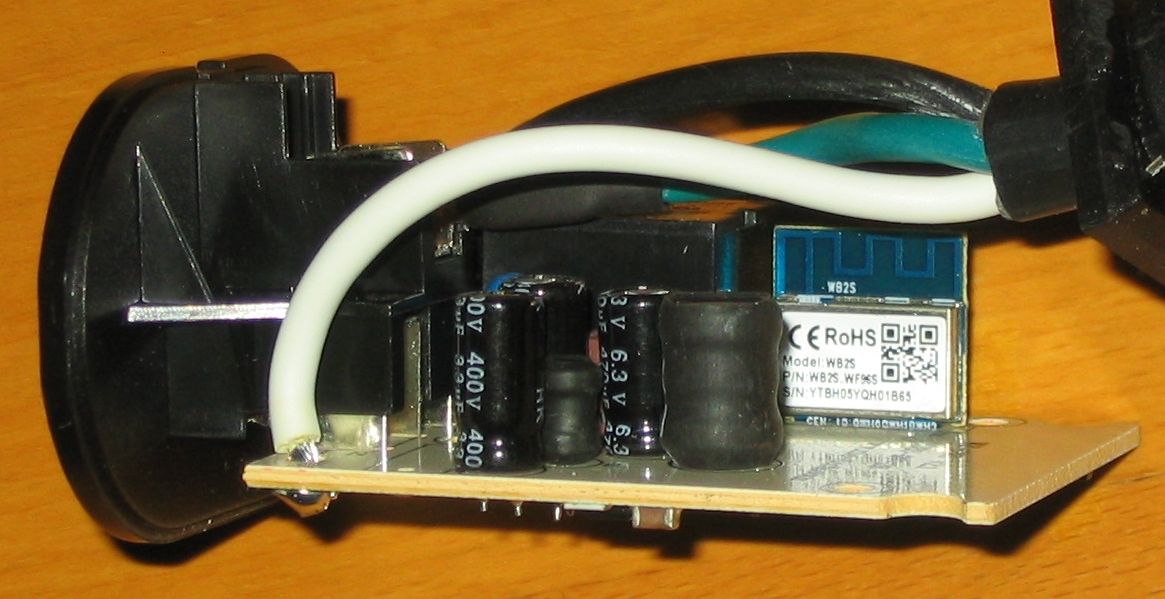

    teardown a power plug, Minoston MP22W, ver 2.0, Date code 0920, FCC ID 2AQRWF96S

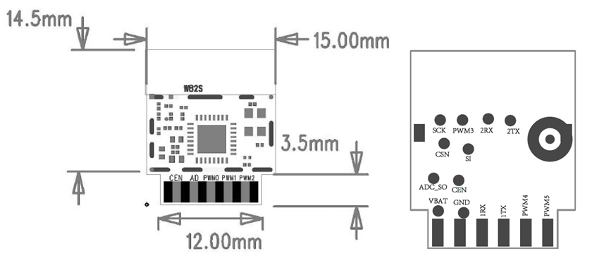

    This Minoston MP22W v2.0 has a new module, WB2S-WF96S, V2.1, 2020-07-29, with a BK7231T chip. OEM manufactured as WF96S by https://nie-tech.com/
    https://developer.tuya.com/en/docs/iot/wb2s-module-datasheet?id=K9ghecl7kc479
    1, my USB to TTL converter has a ch341 chip
    2, solder wires from ch341_USB to VBAT 3.3v, GND, 1RX and 1TX on WB2S
    3, flash OpenBK7231T_UA_1.17.11.bin into this WB2S module, with BK7231Flasher.exe v1.0.7 on MS Windows 10,
    4, search for a new wifi AP, OpenBK7231T*, ip: 192.168.4.1
    5, input wifi SSID and password.
    6, configure.

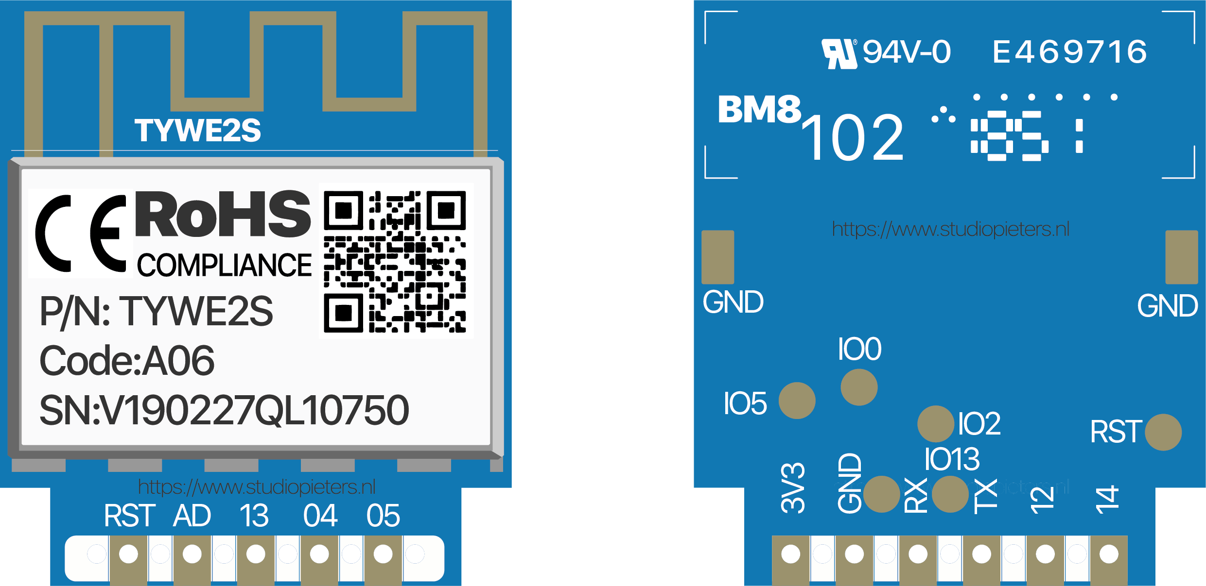

    The old Minoston MP22W (ver 1 ?) was built with TYWE2S modules, based on ESP8266 chips. The old configuration at Tasmota is available.
    https://templates.blakadder.com/minoston_MP22W.html

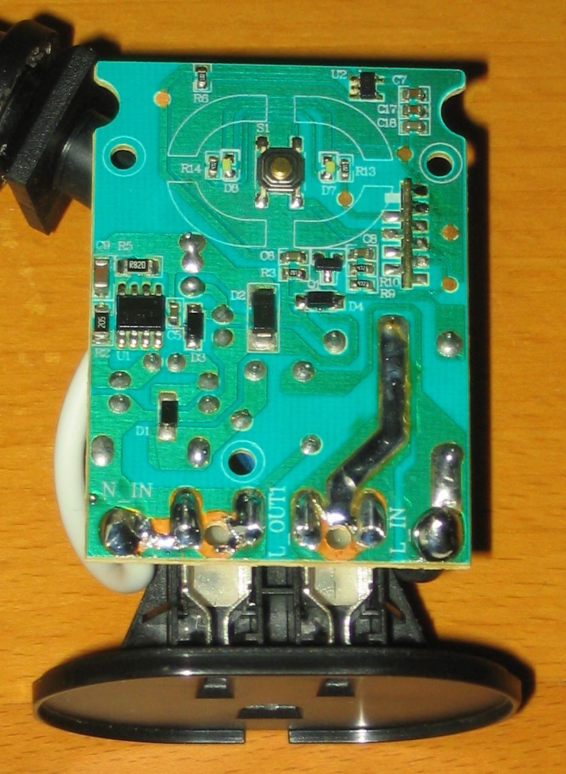

    Matched the pinouts of TYWE2S to WB2S, got the following configuration. After saving new configuration, this plug won't reboot by itself, . I have to use a power strip to power-cycle it.
    Configure module
    P6 (PWM0) Btn 1
    P7 (PWM1) LED_n 1,
    P24 (PWM4) Rel 1,
    P6 (PWM0) on WB2S = I/O_13 on TYWE2S
    P7 (PWM1) on WB2S = I/O_04 on TYWE2S
    P24 (PWM4) on WB2S = I/O_12 on TYWE2S

    After flashing and configuring, the plug works.
    But that button has significant delays, I have to push it twice. The first push seems like a wakeup call, the second one switches the plug on/off. Fixed

    I saw the GPIO13 was set as Button1n at TYWE2S_ESP8285. But I didn't know that "n" = Button logic. So I transplanted that "n" to Btn_n at P6 (PWM0) on WB2S_BK7231T. I tried both settings. Both work in the same Btn way.
    I tried the LED_n and LED at P7 (PWM1). LED_n 1 means the LED lights on when toggle on. LED 1 means LED on when toggle off.
