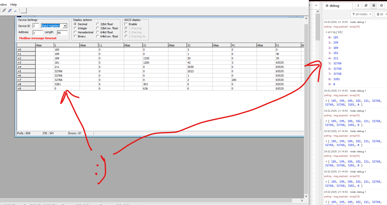

    Screenshot of a program with a data table and debug results on the right side. .
    See @michal.zd because I don't believe it myself.
    Now the question of what I managed to read.
    Question how to read other tables from the radzio program ??

    Apparently so.
    Others have a different starting address. Everything is in the document you sent me.
    In it you will also find the descriptions of the data you read.

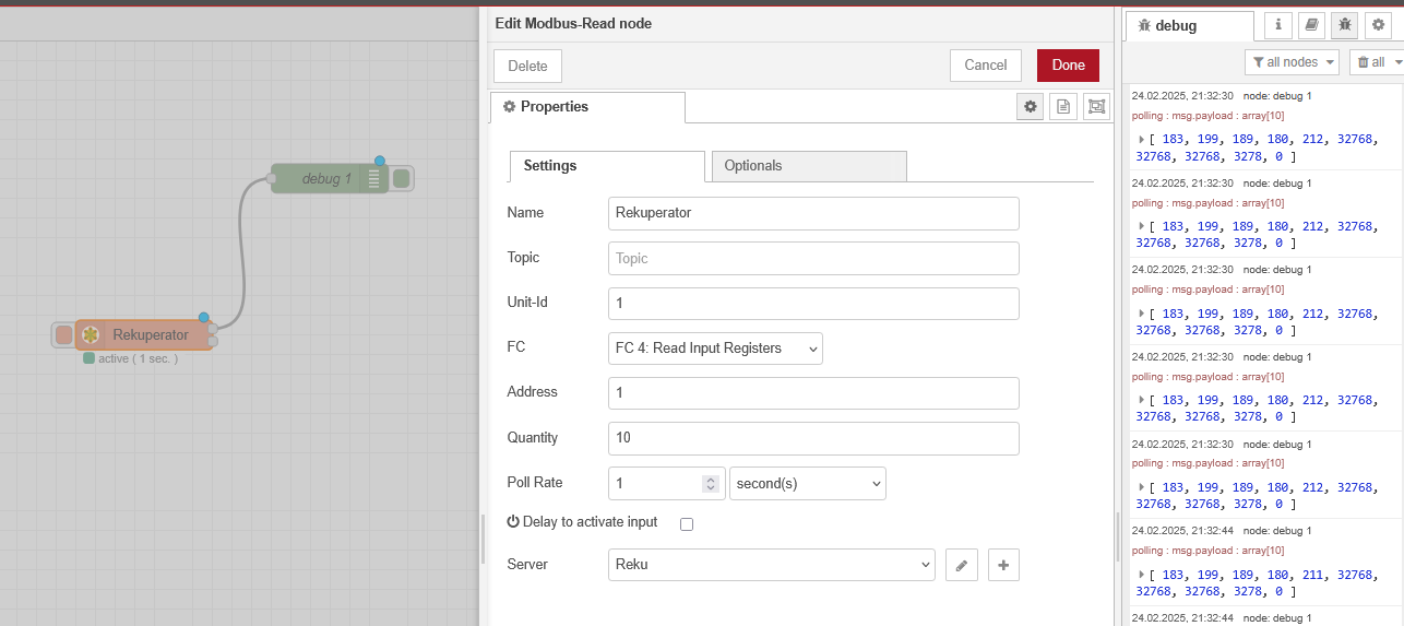

    I set it up that way and it went:
    Screenshot showing Modbus-Read node configuration in Node-RED with active debugging. .

    In node-red you can basically embrace everything, but sometimes there will be a complicated flow. It is easier to do the same in a normal program written in c/cpp.

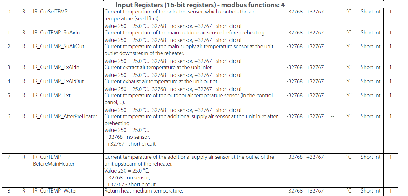

    I have temperatures like nothing:
    bb647f92a Table of input registers with Modbus functions for temperature. .

    Daro1003 wrote:
    I set
    There is an address there, you currently have a value of 1. The next address where something is is 21 and 31 and 41.
    Type there and see if the data agrees with the data in the corresponding columns.

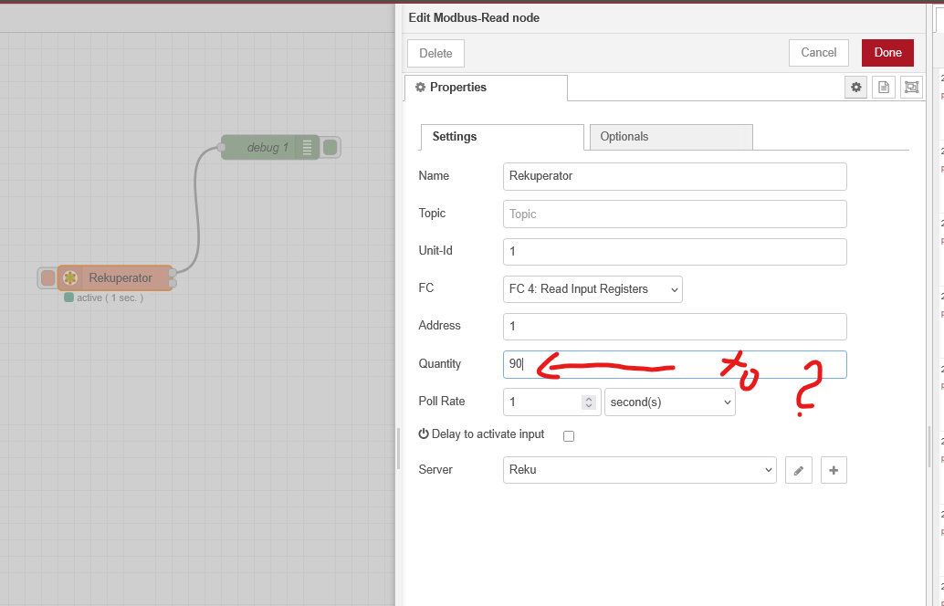

    Aa in the program you read 90 registers at once. Set up the same way in node-red.

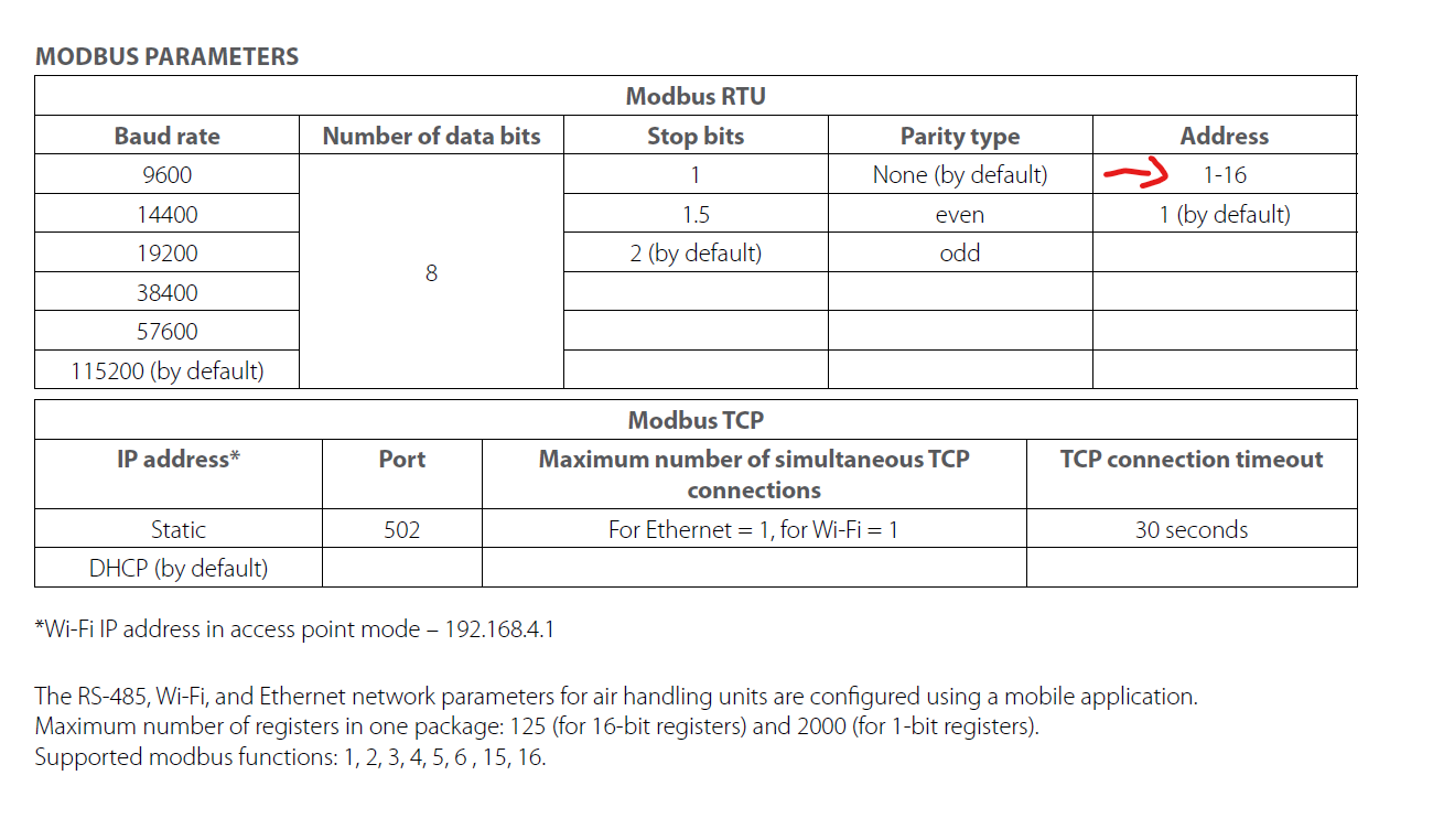

    michal.zd wrote:
    The next address where something is at is 21st and 31st and 41st.
    And in the documentation it says 1 - 16
    Table showing Modbus parameters with address column highlighted as 1-16.
    I do not understand why exactly.

    Screenshot of Node-RED editor configured for a Modbus node with the quantity field set to 90. .
    Continues to show 10 as I give here at 90
    Added after 1 [minute]:
    It is ok though:
    Debug interface displaying array values with a ok annotation.

    I don't understand why exactly.
    Sometimes it's not worth getting into 😉 . Read 90 registers from address 1, you get the same data as you see in the program.
    I don't know the node, for reading modbus, look on the net where it is set up.

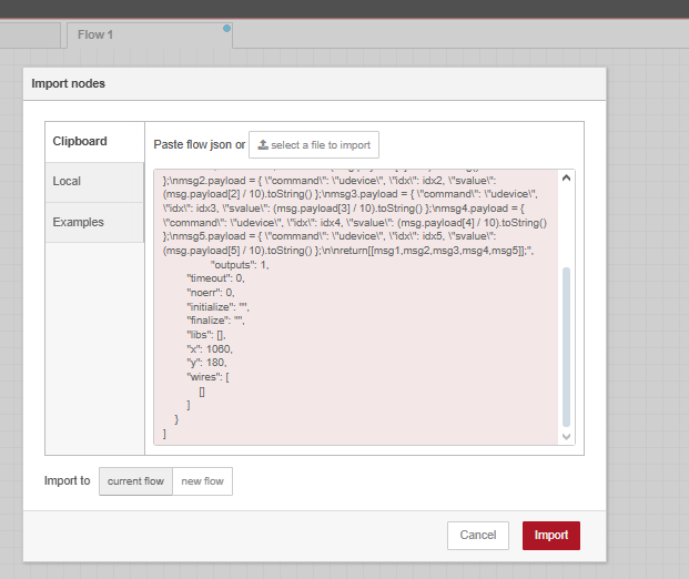

  • Node-RED function copies identical Domoticz JSON nodes
    #52 21454831
    Daro1003
    Posts: 2716
    Help: 295
    Rate: 608
    michal.zd wrote:
    Identical json, you can just copy this node and replace the idx and svalue.
    So something in the code below needs to be changed:

    Added after 4 [minutes]:
    You still have to process the data somehow because it is, for example, 183 and that is 18.3 degrees.

    @michal.zd I already have a feature node from a fellow domoticz forum member.
    The only topic left is how to embrace the data from the recuperator to make it not 199 but 19.9.
    Currently it commands me the data the recuperator sends.

    recuperator to make it not 199 just 19.9
    Ee o just plain maths, divide by di before writing to msg.

    I think you've confused them with domoticz's idx.
    Then that's what you specify in node with the msg formatting function.
    Added after 1 [minute]: .
    And yes, just import into the new flow do:
    Screenshot of Node-RED interface for importing flows with JSON code. .
    and then in
    View of a function node in Node-RED labeled Rekuperator do Domoticz. .
    substitute idx for domoticz.
