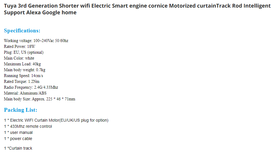

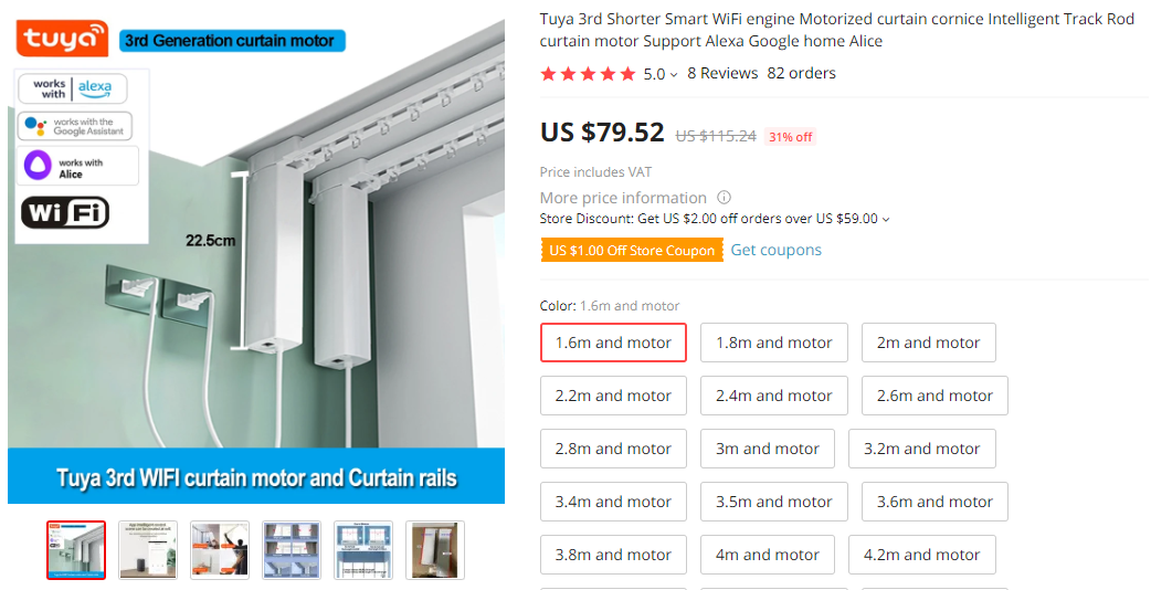

Can this Tuya smart curtain motor be connected and flashed with OpenBeken?

    I am sorry, but I don't know this particular model of the device. It is very possible that it runs on BK7231 chip and can be programmed with OpenBeken, but I can't say it with 100% certainty. It may also be on ESP8266 or something else. Someone would have to order one piece and check.
    I can help with adding new features for that kind of device, if that's needed.

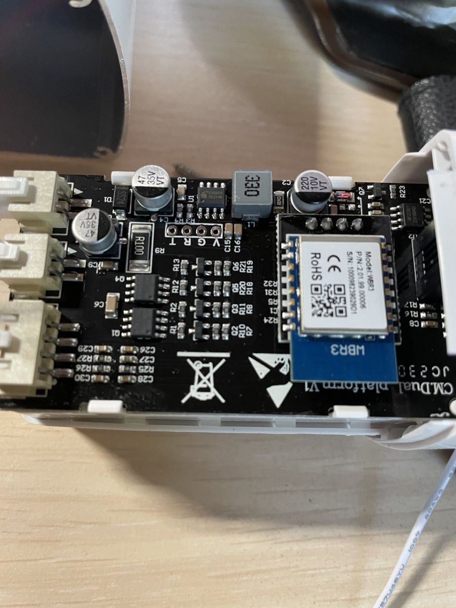

    I received the engine, is it possible?

    @kinziulisKinziulisLT unfortunately it's a Realtek chip, not supported yet for OpenBK

    We've been working on Realteks in the past year:
    https://github.com/openshwprojects/OpenRTL8710BN
    By the way, do you know how to make a safe UART capture on such a device so we can analyze TuyaMCU packets?

    Are you sure? But you know that you must never do it while the device is connected to mains?
    Maybe you could do packet capture when doing chosen actions with Tuya App so we can analyze it with:
    https://www.elektroda.com/rtvforum/topic3970199.html#20528459
