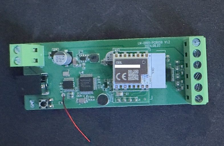

    Hi, just confirming that this is a TuyaMCU and that I can control this RGB controller with OpenBeken? If anyone has the pin out and instructions on how to do the wiring and steps to put the chip into programming mode I'd greatly appreciate it.

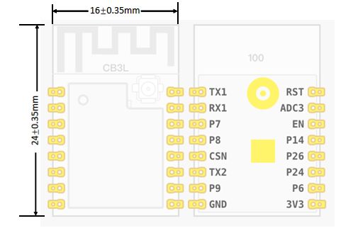

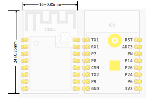

    Ah, sorry, it's CB3L, not CB3S. That caught me off-guard. I always assumed that "L" means "Lighting" and "L" modules are for LEDs.

    >>21608004 I have two pieces. They're sold as "BTF-LIGHTING 2.4G WiFi DR03W RGB SPI Controller Tuya APP/Smart Life/Google Home/Alexa Control Support WS2812B WS2811 WS2815 etc Addressable LED Strip Work with WR01RF RC03RFB RF Remote" on amazon. https://www.amazon.com/dp/B0DB5P7LBC
    The Wifi module is just removable (it's just sitting in a four pin header).
    I need to find the pin out for the 6 connectors on the right. Assuming pin 1 is on the bottom in this picture ... I can find the VCC and GND pins easily enough with a multimeter, how do I find the other pins?

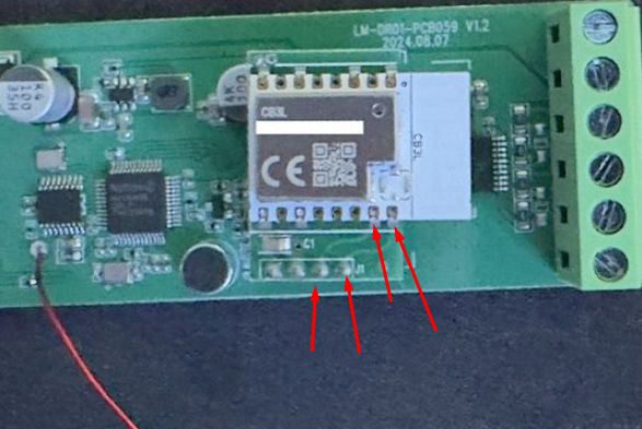

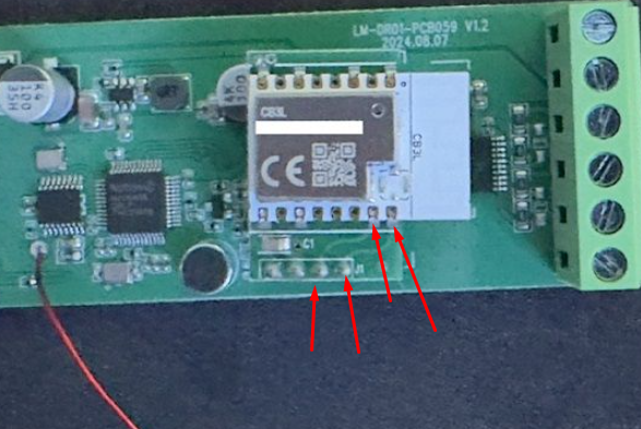

    Which connectors? I can see 4 pin connector, not 6. TX and RX is clearly visible:
    TuyaMCU RGB Controller Compatibility with OpenBeken: Pinout and Programming Guide
    Or are you asking which screw terminal is which LED wire? That should be marked on device case.
