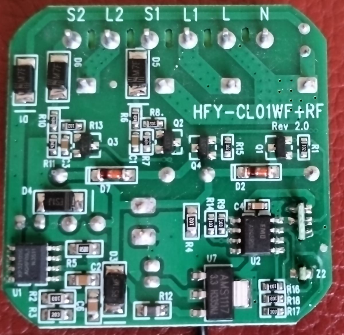

  • A Tuya Wi‑Fi+RF Curtain Module for shutters and curtains uses a CB2S module with a BK7231N SoC.
  • Rear-side disassembly reveals stacked PCBs and the BK7231N-based controller inside the no-name unit.
  • The board includes 2× relays rated at 10A and a 433MHz RF receiver, plus a supplied remote control.

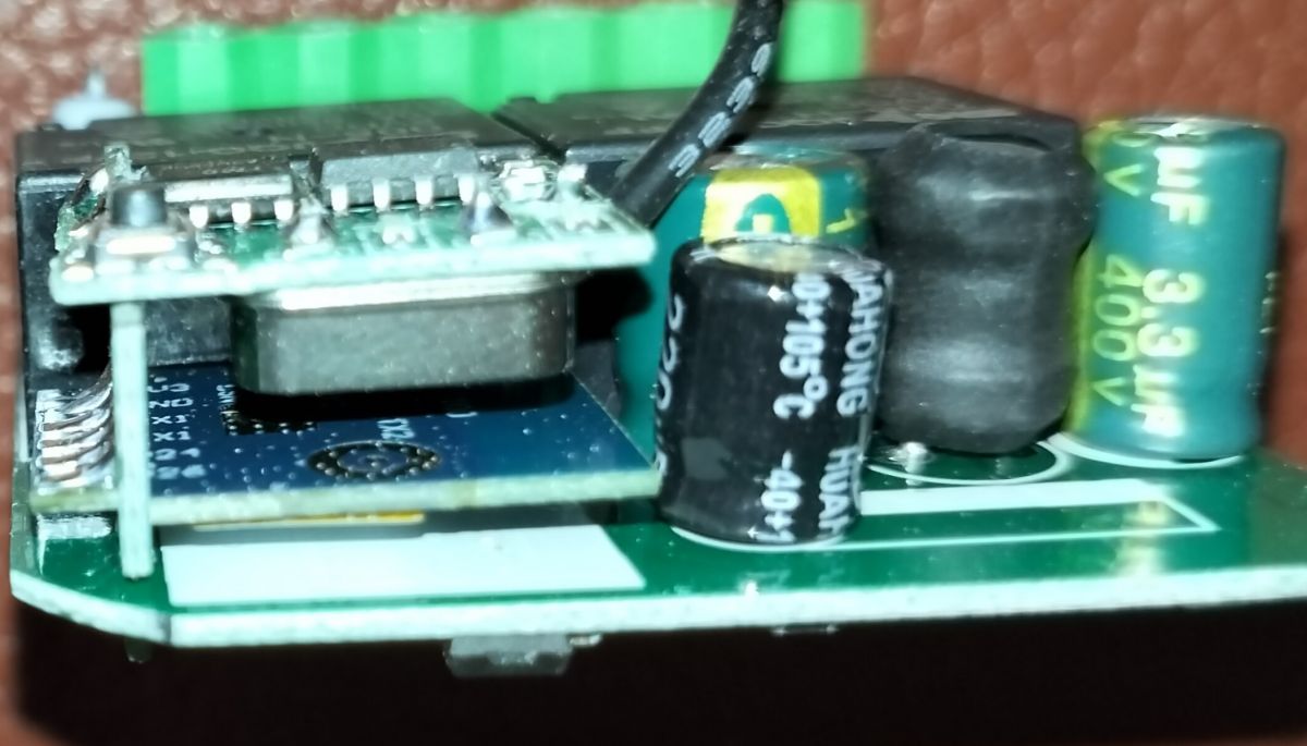

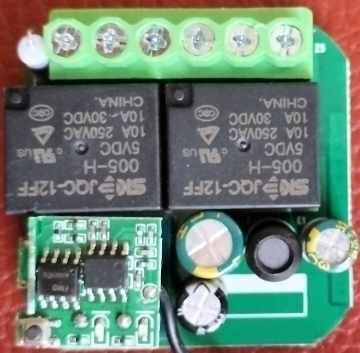

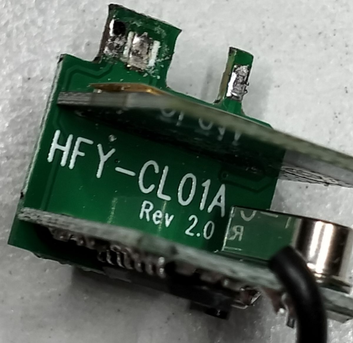

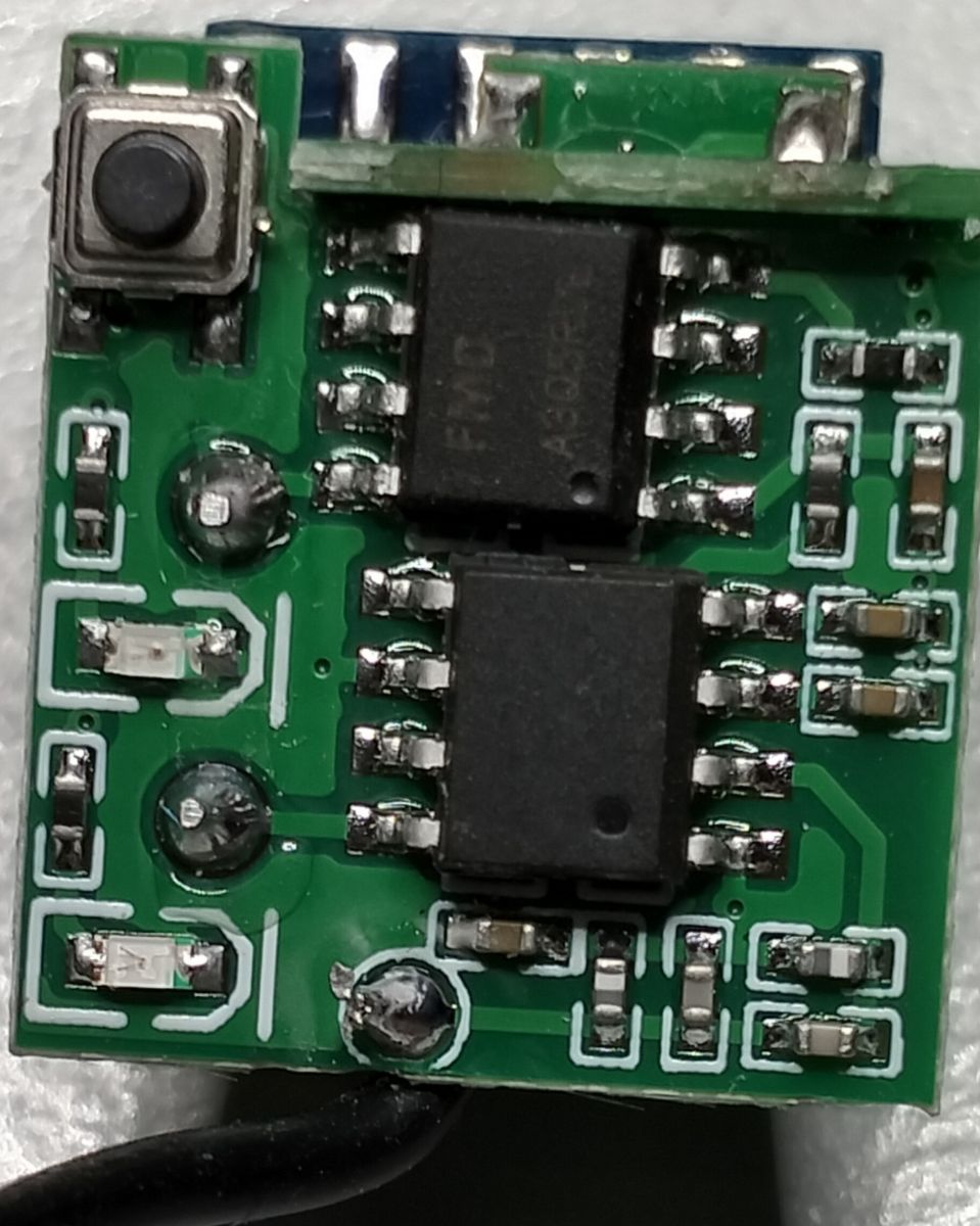

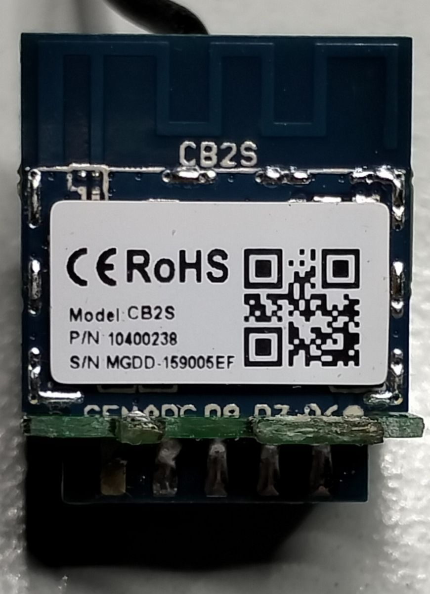

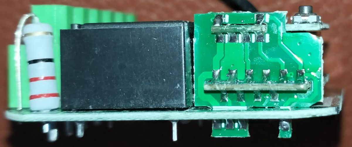

    Disassembly is quite easy from rear side with small screwdriver - self explanatory.
    Here I removed the stacked PCBs to see/show the SOC itself.
    Curtain controller set with Wi-Fi+RF module and remote control. Image of a curtain controller with two relays on a PCB. Circuit board of a curtain control device with electronic components. Close-up of the PCB board for a curtain control device. Close-up of a curtain controller PCB with visible electronic components. CB2S module with CE RoHS sticker and QR code. Close-up of an electronic PCB with components, including a button and integrated circuits. PCB labeled as HFY-CLO1A Rev 2.0

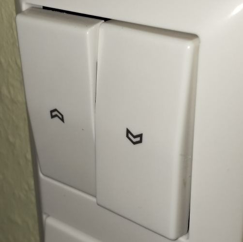

    Now to my request:
    similar as in my earlier post .
    The wall switch I have is a rocker switch with mechanical interlock and TRI-stable status (UP/OPEN - STOP - DOWN/CLOSE). The motor has two end-switches integrated. When the wall switch is pressed, the motor will run until end switch cut out - but wall switch can remain pushed. Sorry, find it hard to explain...
    White wall switch with two buttons marked with arrows.
    Like that, I don't have buttons for up/(stop/)down, but steady/stable switches instead.
    Now, the 'smart' controller expects a button function in the wall switch and does not understand the wall switch rocker function.
    Problem: When I press UP or DOWN on the wall switch, controller waits for me to press STOP first, then starts the motor.
    This has a low WAF...
    I am wondering, if there is a way to solve this within TUYA firmware - would be sufficient for me as IObroker already can control it.
    Or should I flash the CBU / BK7231N to openBK to solve this problem, which I did not do by now - I only flashed some ESPs to Tasmota.
    Or should I replace the CBU with a ESP32-C3 with Tasmota.
