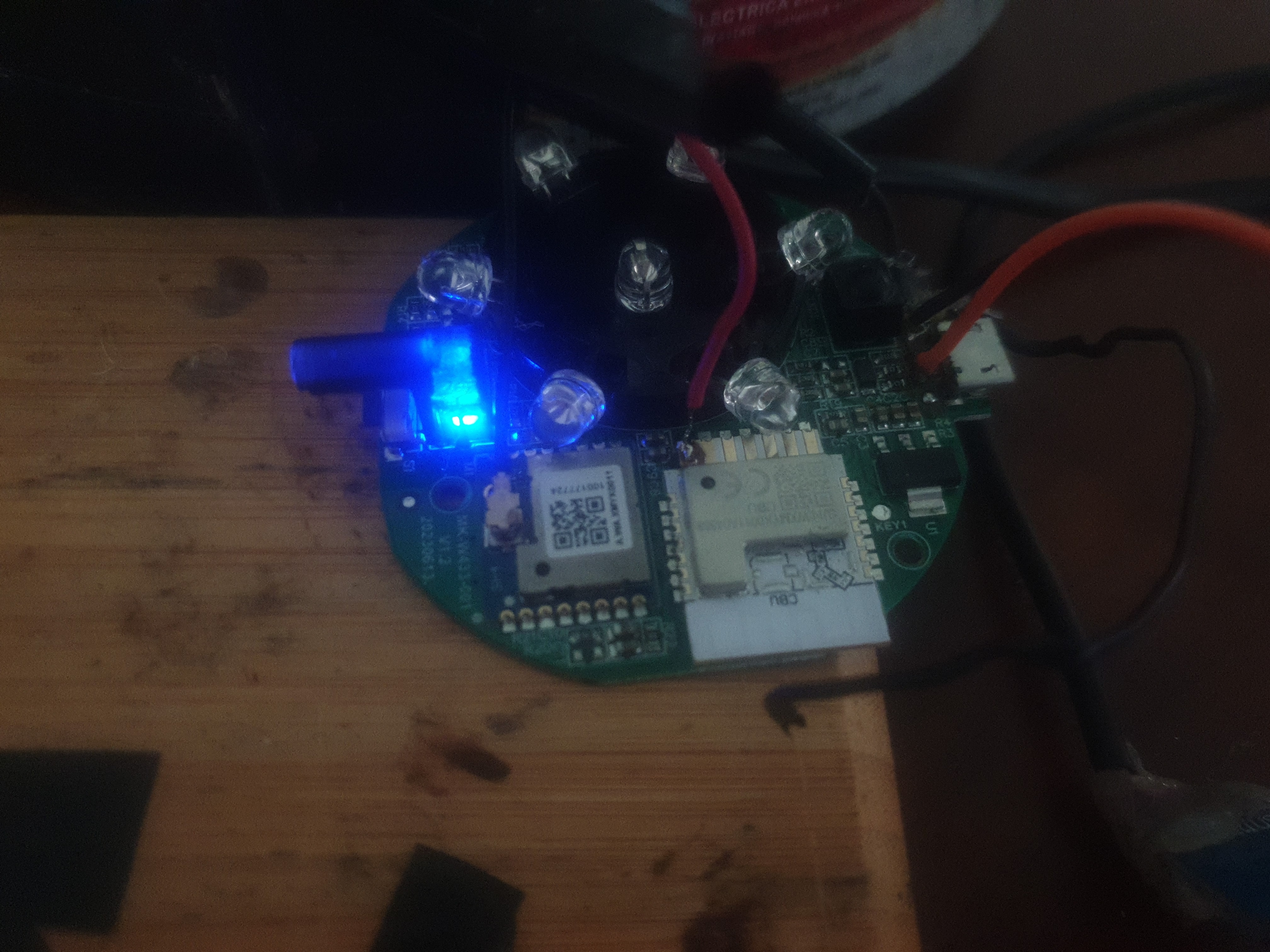

    --RF: 433/315Mhz
    Opening the device is by sharp tool from the top circle, no screws, just clips.
    The board contains CBU and RF module (SH-4) from Tuya.
    Sadly, I didn't download the original firmware, so I had to manually trace the connections between the RF module SH4 and the CBU module.
    On the front side, you could see 4 pads for -V, TX, RX, V+. I used the TX+RX, while the VCC i soldered directly to CBU (it was hard to solder 3 wires to the pads).
    The back side of the board does not contain anything interesting.
    I only missed the small reset button, which i couldn't find its connection to CBU.
    Opened AVATTO S16 PRO IR+RF remote with visible PCB and electronic components. Close-up of a circuit board module with electronic components. Close-up of the smart IR+RF device S16 PRO circuit board with TX and RX labels.
    Wiring (tested with multimeter)Wiring diagram for SH4 and CBU modules.
    I can confirm that the IR is working like my previous module BK7231N - Universal IR Remote Contorl.
    GPIO settings
    GPIO-CBUFunctionSH-4 pinComment
    GPIO 07IR - Tx transmitterconfirmed working
    GPIO 08IR - Rx receiverconfirmed working
    GPIO 09Status LED (blue led)confirmed working
    P6CSB
    P14SCLK
    P20GPIO01
    P22GPIO02
    P26FCSB
    i don't know how to set the SH-4

    Eventually, I was able to make the device work in ESPHome (sorry...). i have both IR and RF control 🥳
    I had to use @olivluca component and the latest dev version of LibreTiny (as of writing this post, it's version 1.7.0) which contains a fix that @olivluca contributed there too.
    Bottom line, there is open source solution to work with CBU and SH4 from Tuya! Now, it's just a matter of priorities and effort until it will show up in OpenBeken (and officially supported in ESPHome).
    thank you all!

  • #20 21733992
    juleswit
    I just bought an Avatto Tuya S16Pro. Hope my question is in the good forum. I'm not familiar with ESPHome (first time), but I did a lot of ESP32 ESP8266.
    So I would like to save the factory bin or if it not possible at least have a communication with UART USB. Unfortunately I can't get anything working. I do the following command:
    bk7231tools chip_info -d /dev/ttyUSB0
    bk7231tools installed through pip install, and Arduino IDE monitor shows connection on /dev/ttyUSB0. I always get timeout errors, I "play" with CEN pin as seen on many videos (I keep it with my finger), but after one afternoon, still have no success to just get chip info. Also tried ltchiptool without luck.
    I attached picture of my wiring, and I have a dedicated 3.3 V adaptor connected to CBU pin.
    Any thought how to get it work ?

    2) Upgrade to firmware of olivluca (https://github.com/olivluca/tuya_rf).
    a) First compile by typing:
    esphome run tuya.yaml
    It will create the firmware.bin in /tuya_rf-master/.esphome/build/tuya/.pioenvs/tuya/firmware.bin. Copy the firmware.bin to tuya-cloudcutter/custom-firmware/avattos16pro.bin
    b) Upgrade the firmware through cloudcutter:
    sudo ./tuya-cloudcutter.sh -p tuya-generic-ir-rf-universal-remote-controller-v2.0.15 -f avattos16pro.bin (it will take again 2 restarts with slow blinking).
    My logs ended with:
    Processing endpoint /v2/url_config
    Processing endpoint tuya.device.active
    Processing endpoint tuya.device.dynamic.config.get
    Processing endpoint tuya.device.upgrade.get
    Processing endpoint tuya.device.upgrade.status.update
    Processing endpoint /files/avattos16pro.bin-bk7231n-extracted.ug.bin
    Firmware update progress: 30%
    Firmware update progress: 60%
    Firmware update progress: 88%
    [Firmware Upload] /files/avattos16pro.bin-bk7231n-extracted.ug.bin send complete, request range: bytes=0-534031/534032
    Firmware update progress: 98%
    Firmware file has been sent and MQTT reported a progress of nearly complete. Waiting 15 seconds to ensure flashing completes.
    Flashing should be complete. It takes about 15 seconds for the device to reboot and verify the flash was valid.
    Please wait about 30 seconds then look for signs of activity from the firmware you supplied (either watch for AP mode or check if it joined your network).
    Device MAC address: f8XXXXX
    I didn't have any problems doing the steps. I did step 1) of cloudcutter about 4 times because I wasn't waiting long enough to see the avatto IP on my router. So just be patient, and the first time will be OK...
