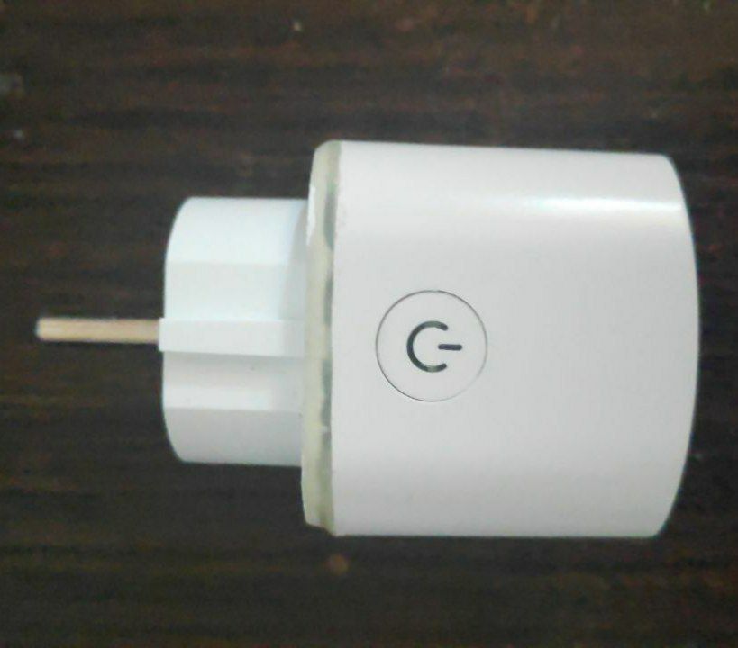

    The socket case has absolutely no marking at all. (Sorry for hot glue, I've already opened it with a Dremel and diamond cutting disc, bastards had the plastic parts welded together, so some plastic had to go)
    Sorry, I didn't take any photos from inside, but this is a pretty standard typical socket like this one.
    The only thing I remember I didn't like at all is that there is no fuse or any other kind of protection in the power circuit, just a single open relay contact. MCU is a separate CB2S module without a protective screen, soldered at 90 degrees to the main board. Also, on the main board sits a BL0937 and a small switching 3.3v power source.

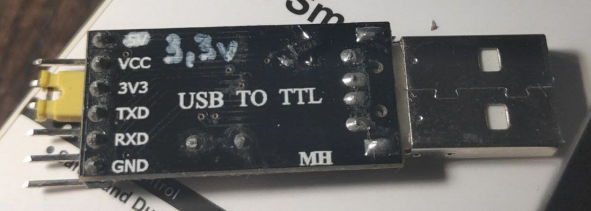

    Since one of the RX1 or TX1 (I don't remember which in particular) is connected on board, I've desoldered it completely to flash OpenBK firmware.
    The rest of the process is pretty straightforward and well-documented, I used a CH340 3.3v self-modified UART to USB converter and 115200 baud rate because faster speeds gave errors in the process of verifying when flashing firmware. DIY is typical, cut the 5v trace and solder LM6206N3 in between source 5v, output, and nearby ground:

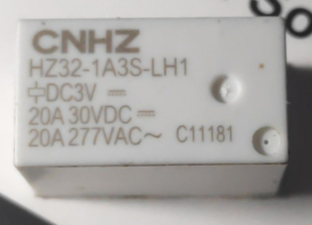

    P.S. Now about the fault. This is the relay that was faulty:
    [BK7231N/CB2S] Yet Another Noname Smart socket with BL0937 meter
    I've searched around for a suitable replacement but found nothing due to the miniature size and footprint of this little sucker.
    It's probably easier to use the hardware in another project and buy a new socket!
    By the way, I personally don't believe it can really stand 20 Amps of load.
    So I've got nothing to lose and removed the relay's housing and cleaned its contacts, and voila, it's working again!
    That's all, folks!

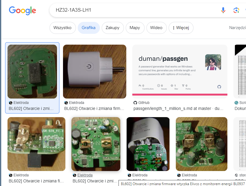

    HZ32-1A3S-LH1... rated at DC 3V? Do I see correctly? That's new to me, I remember only seeing a 5V and 12V coil relays in Tuya products so far.
    Let me google for HZ32-1A3S-LH1....
    Hmm results are leading back to our forum, nice:
    It must have been used in another Tuya product.
  • 3V relay identified as HZ32-1A3S counterfeit
    #3 20617170
    P0intLess
    Level 4  
    Posts: 8

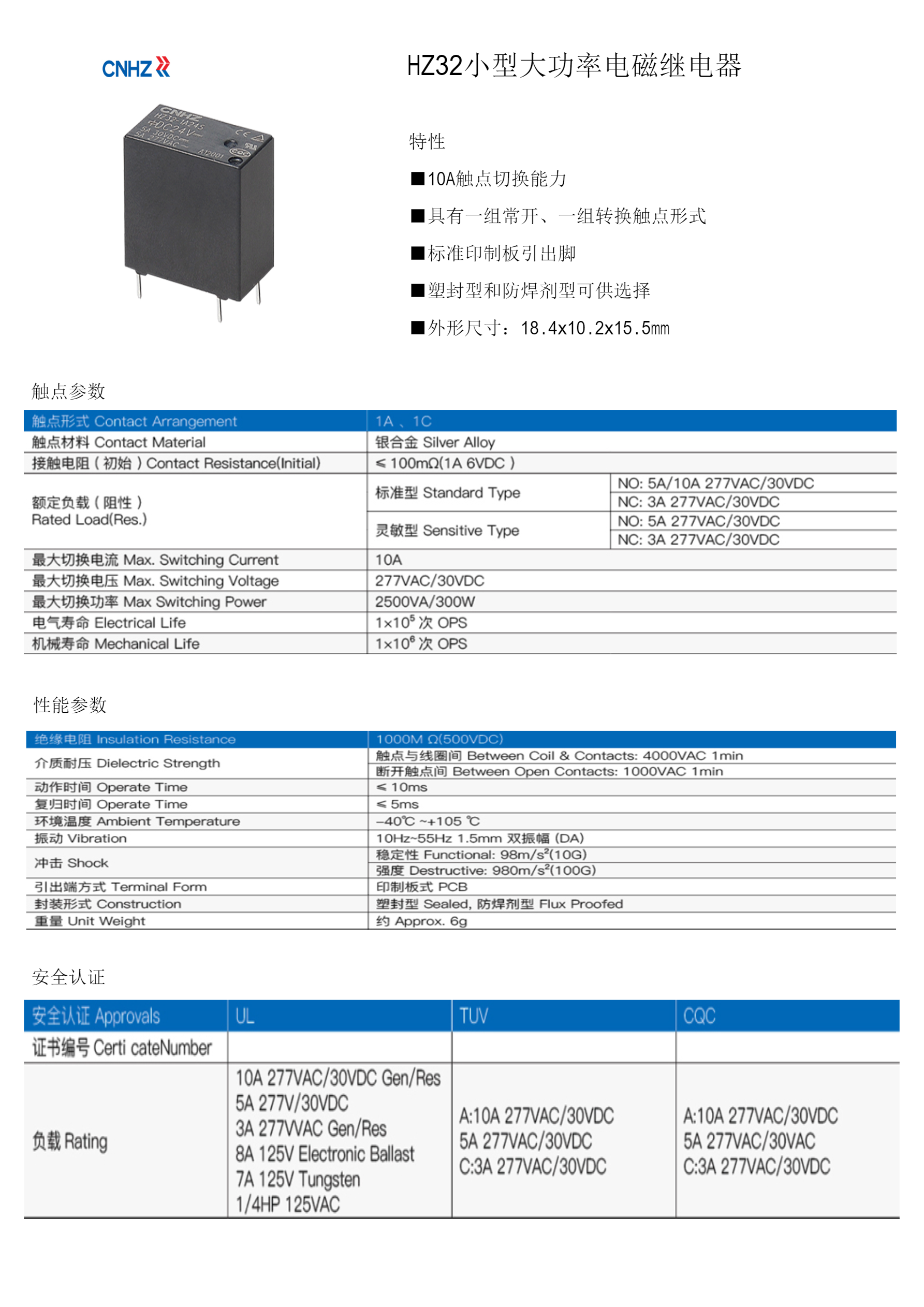

    >>20617096
    Yes, that's a 3v relay. There is no 12v/5v source on board and no 3.3v LDO either.
    Google only HZ32-1A3S. The first link is to a Chinese supplier site, where you can get some info on those.

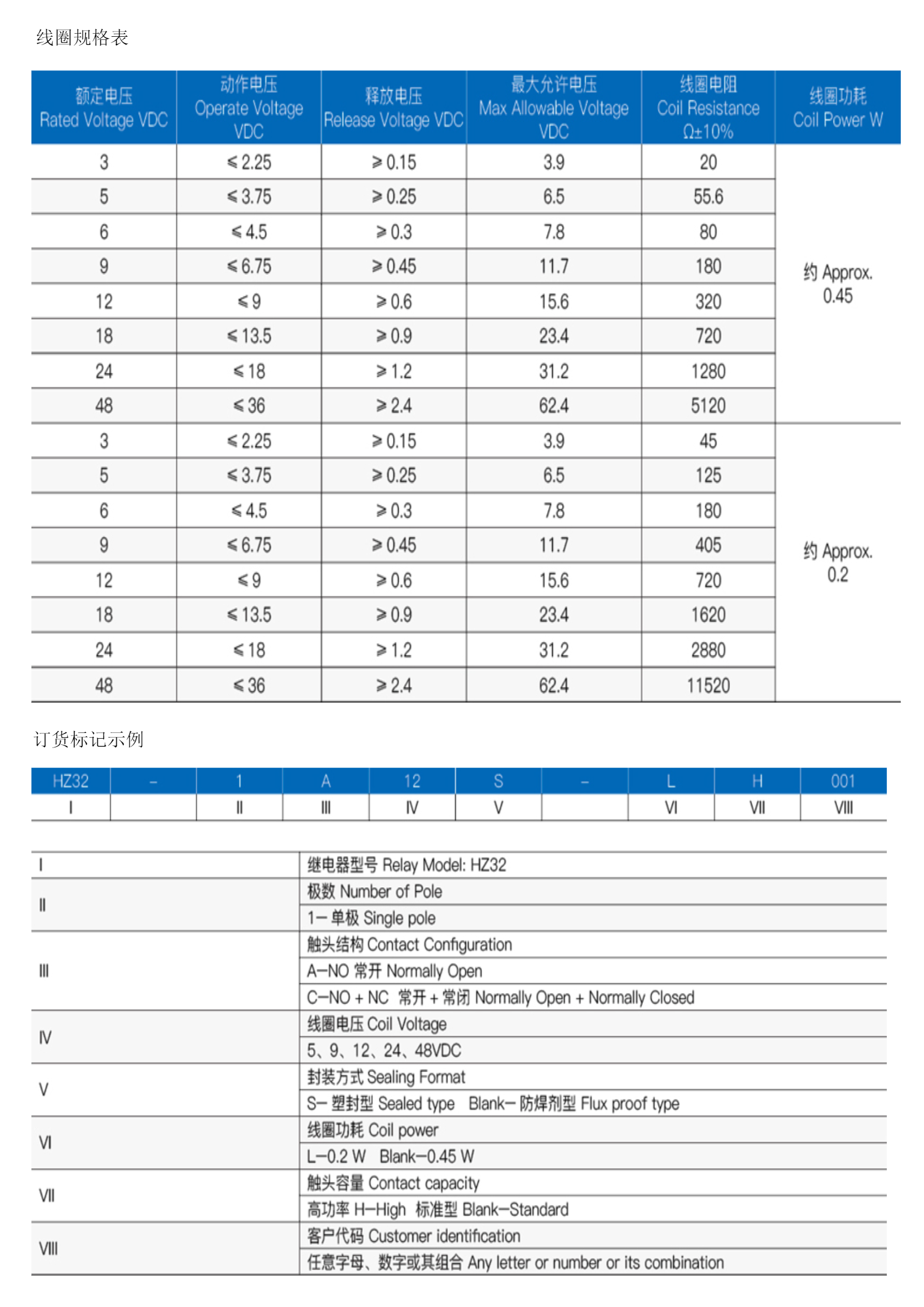

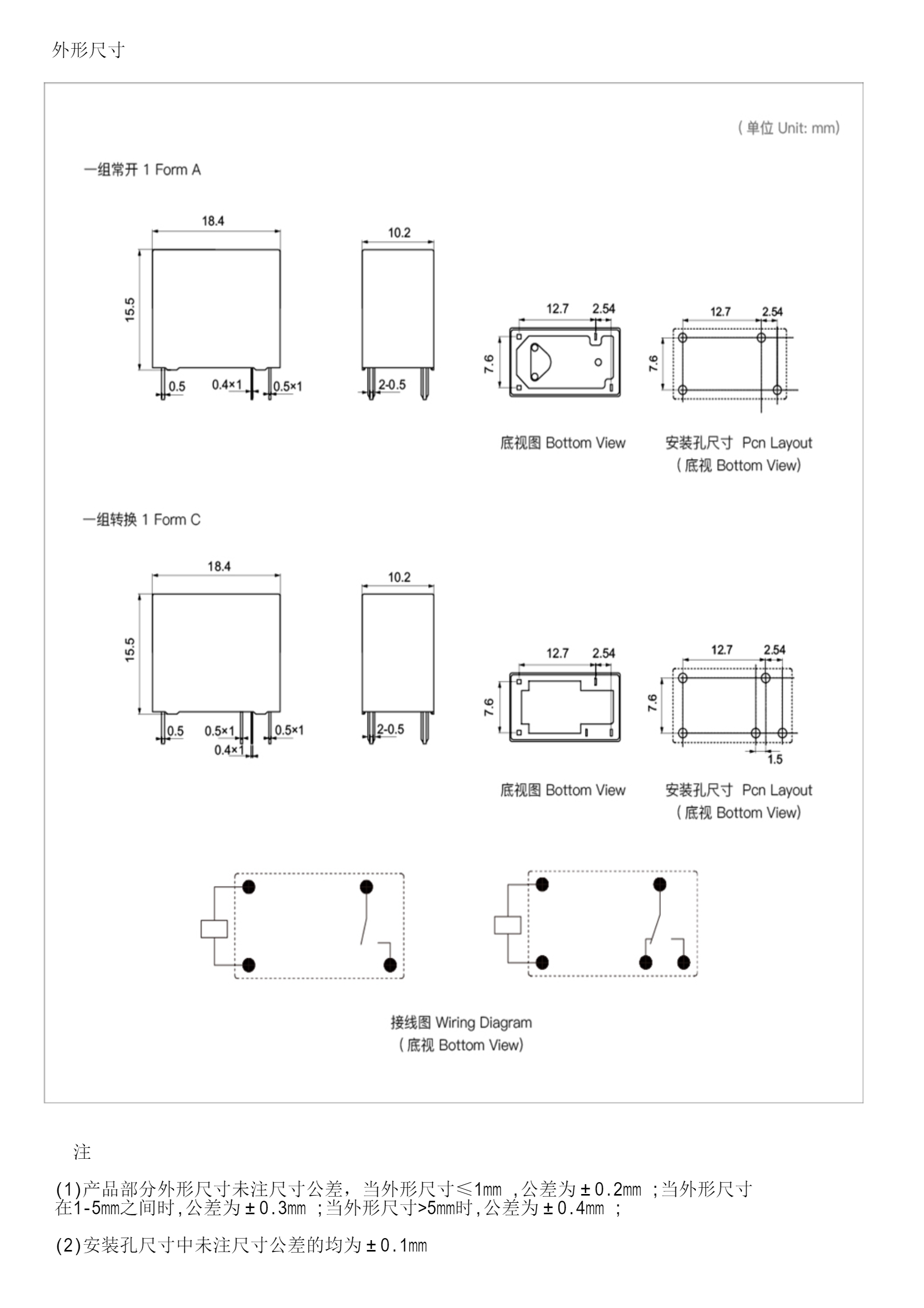

    I've attached HZ32 datasheet pages from there in this post.
    So according to page 2 here we have an HZ32 series, 1 = single pole, A = NO normally open, 3 = 3VDC, S = sealed type, L = 0.2W coil power, H = high contact capacity (and no explanation what it is and how it affects the characteristics), 1 = some custom ID.
    The interesting thing is that all their relays according to page 1 are 1) black colored 2) rated 3/5A switching current with 10A absolute maximum flowing current.
    I'm sure these white ones are a counterfeit product. Guy here you mentioned had a black relay case and "rated" 16 Amps - aaaand still it's counterfeit too. Real ratings are 5A switching, 10A max flow.
    The maximum switching power is limited by 300W in the datasheet, be careful!
