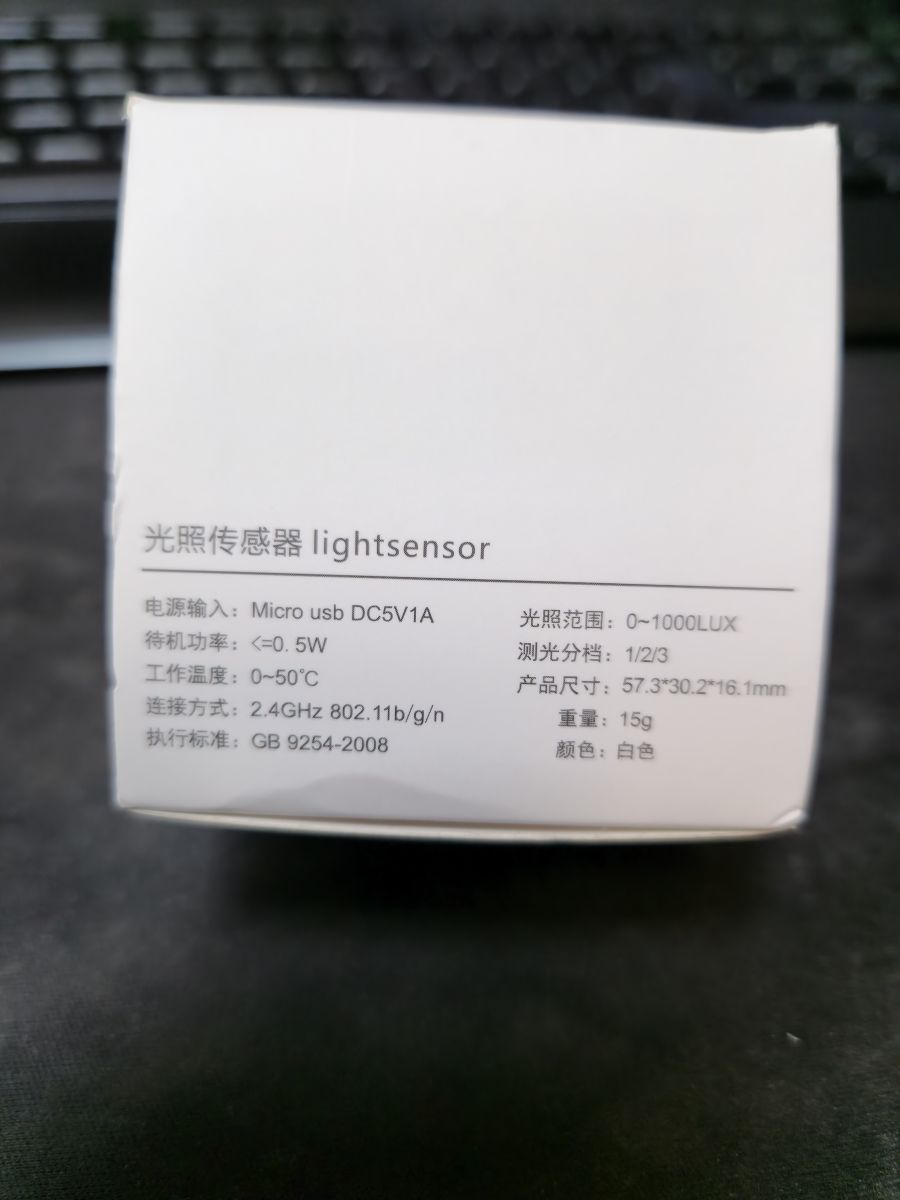

    Lightsensor, GB 9254-2008, few details
    Lighting sensor with WiFi powered by USB - TuyaMCU, communication protocol, firm

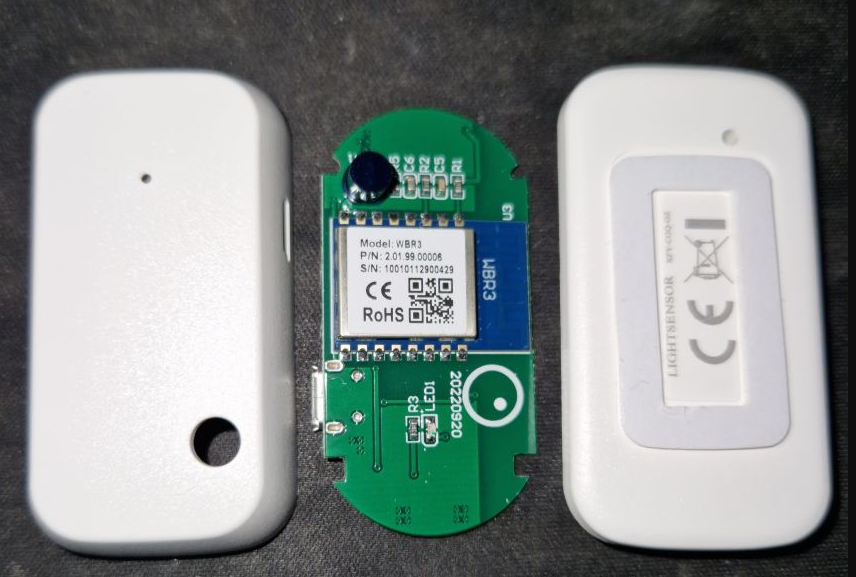

    Interior and communication protocol

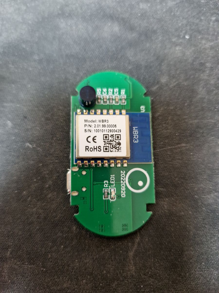

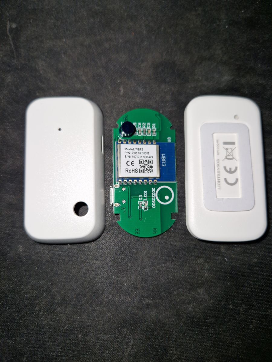

    We look inside, pry the plastic cover:
    Lighting sensor with WiFi powered by USB - TuyaMCU, communication protocol, firm Lighting sensor with WiFi powered by USB - TuyaMCU, communication protocol, firm

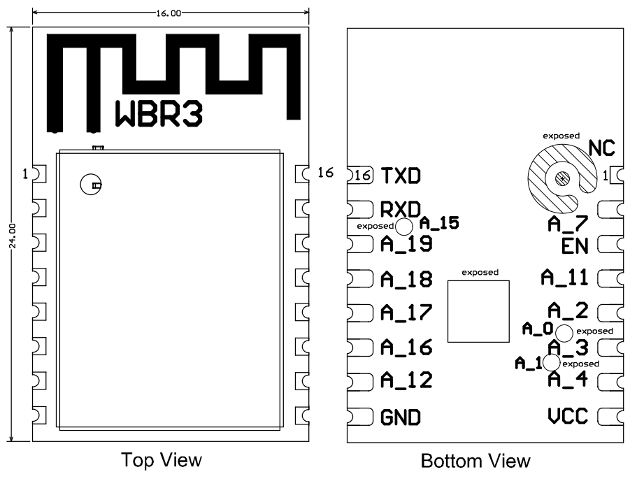

    We have WBR3 here... I'm working on it, but it's not Beken. Date 2022-09-20.

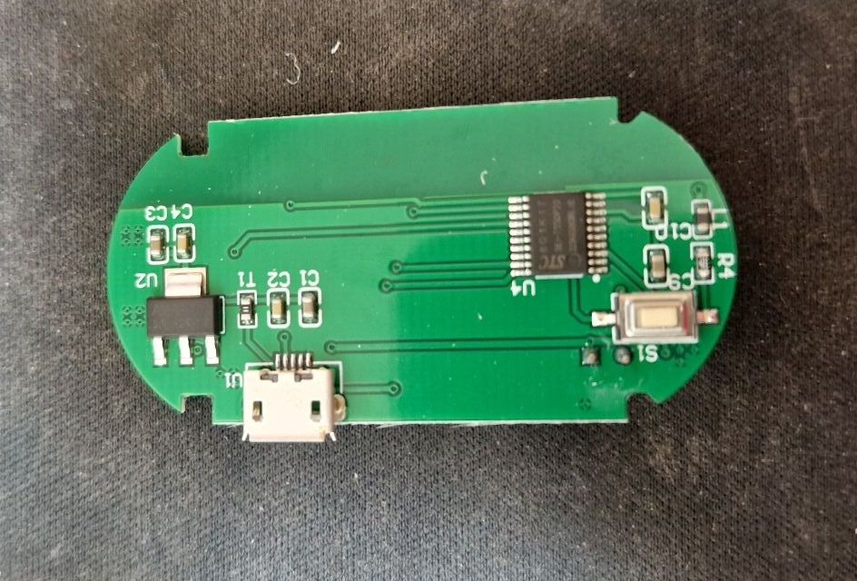

    Lighting sensor with WiFi powered by USB - TuyaMCU, communication protocol, firm But what is on the other side of the PCB?

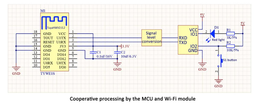

    There is of course the AMS1117-3.3V LDO regulator to get 3.3V from 5V from USB, but we also see an additional microcontroller here.
    It looks like this device is using TuyaMCU:

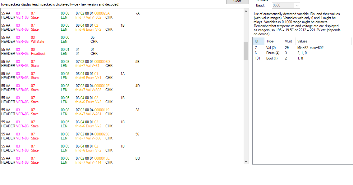

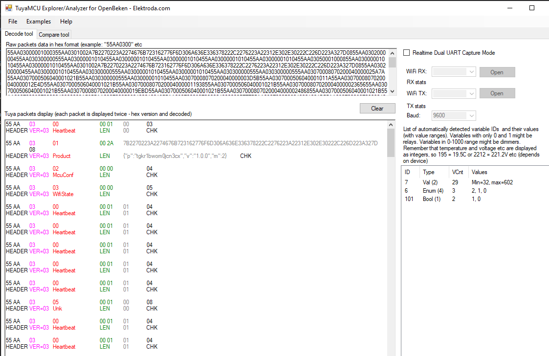

    Therefore, we launched the analyzer, sequentially collecting data on the RX and TX of the WiFi module. Bingo!
    The most important interception of packets was made on the RX of the WiFi module. We look at what the MCU sends to us:
    At first, apart from checking in, the MCU gave no measurements. This was due to the fact that it had to be paired.
    Since then, the variables have appeared:

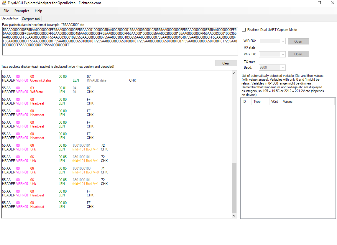

    There is a "FindMe" option in the Tuya app that makes the LED blink. We also managed to overhear the change of its state, it is a boolean variable with dpID 101. The eavesdropping was made on the TX of the WiFi module (it is the WiFi module that sends its change to the MCU):

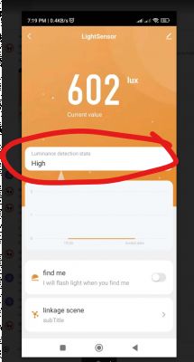

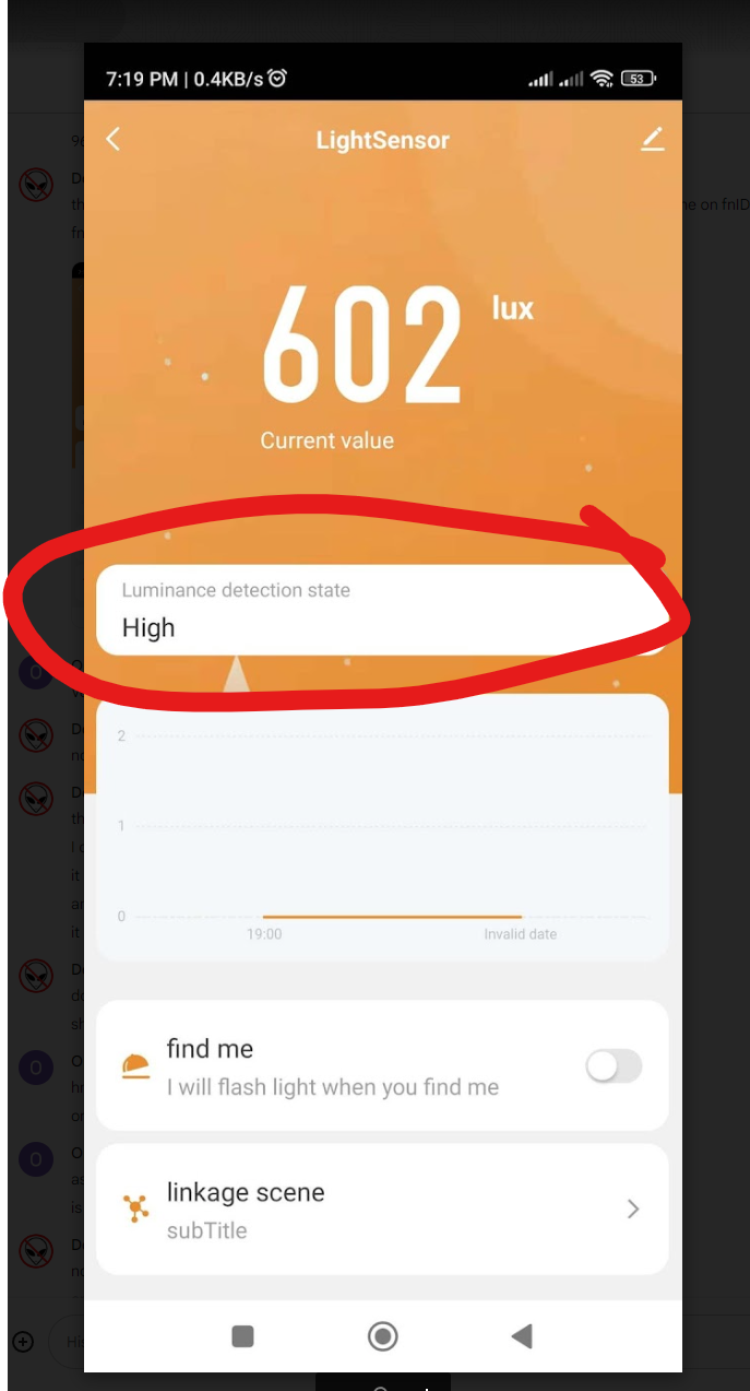

    After the analysis, we assessed:
    - dpID 6 is enumeration, lighting level, 0, 1 or 2
    - dpID 7 is the illumination level in lux
    - dpID 101 is "find me" option from Tuya application
    The dpID6 in the app looks like this:

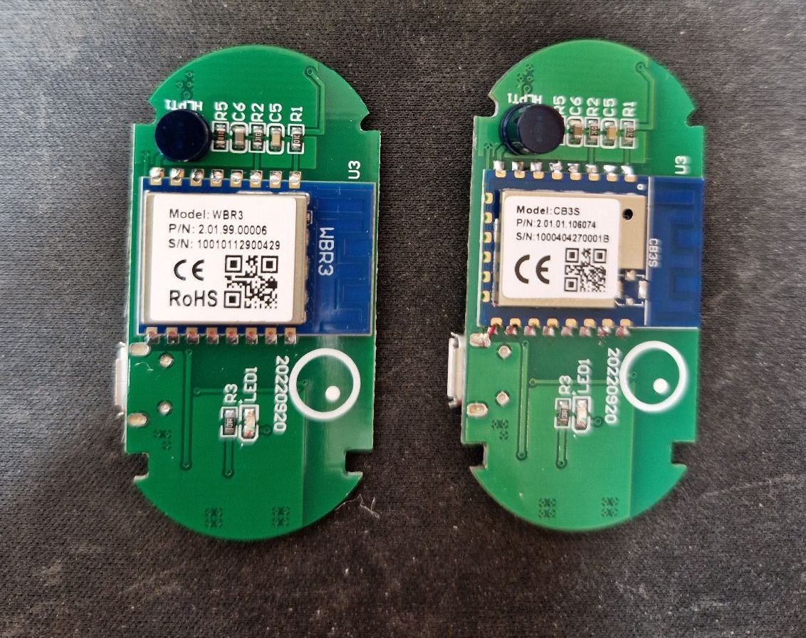

    Firmware change?
    Work on WBR3 is in progress, but a friend had a free CB3S module, so we soldered it in its place to test the TuyaMCU support code from OpenBeken:

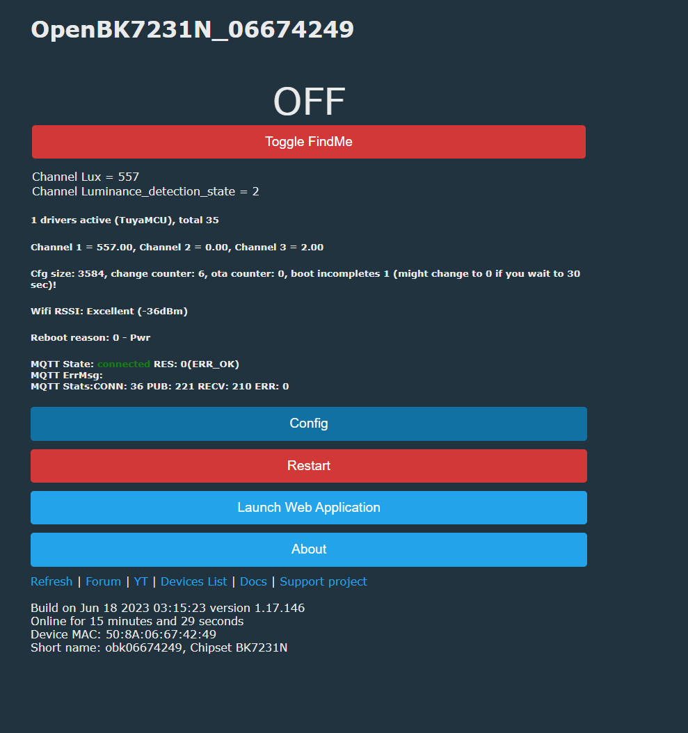

    Then we prepared the autoexec.bat OpenBeken:
    startDriver TuyaMCU
    // always report paired
    tuyaMcu_defWiFiState 4
    setChannelType 1 Illuminance
    setChannelLabel 1 Lux
    linkTuyaMCUOutputToChannel 7 val 1
    setChannelType 2 Toggle
    setChannelLabel 2 FindMe
    linkTuyaMCUOutputToChannel 101 bool 2
    setChannelType 3 ReadOnly
    setChannelLabel 3 LightLevel
    linkTuyaMCUOutputToChannel 6 enum 3
    The above code maps variables from TuyaMCU to OpenBeken channels. Sets them labels to display and channel types. Channel types then also determine how Home Assistant displays them.
    Initially, we tried without "default wifi state 4", but without it, in the absence of MQTT, we would not get measurements. The MCU must "think" that it is paired with the cloud to give measurements.

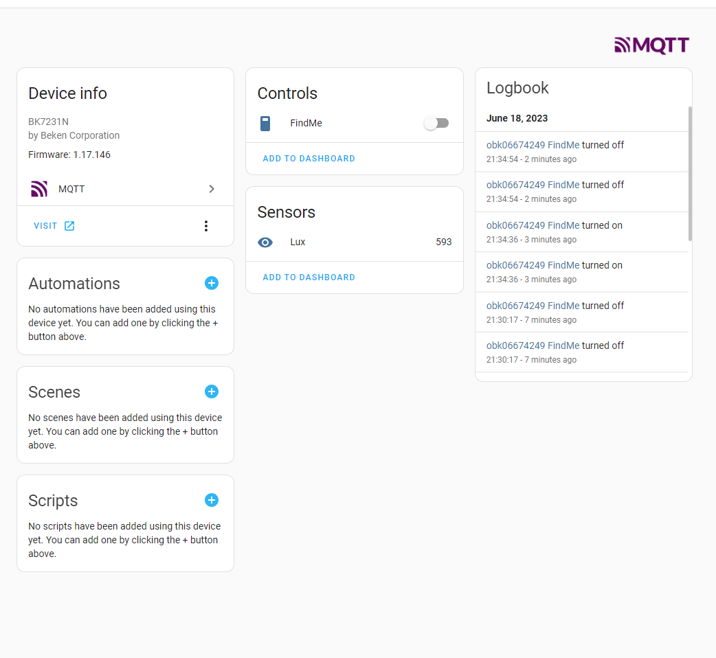

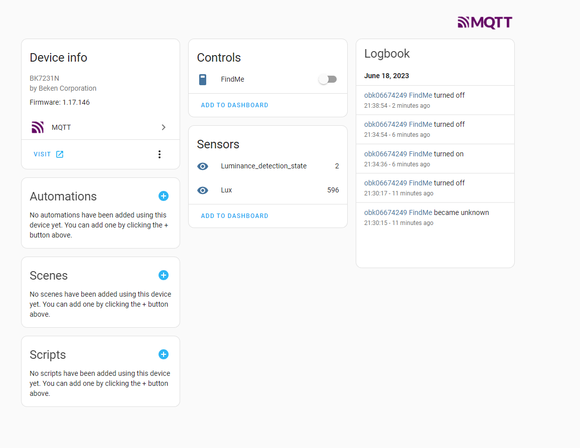

    Success! We have measurements on the OBK panel. Now it's still worth doing Home Assistant Discovery, which is already automatic with us. Below are screenshots before the introduction of the Illuminance channel type:
    Even after adding this lighting level enumeration:
    Everything works, although ultimately this lighting level (enumeration) will get its channel type so that it is displayed in text on the HA panel. And if necessary, you can always add it yourself via configuration.yaml.

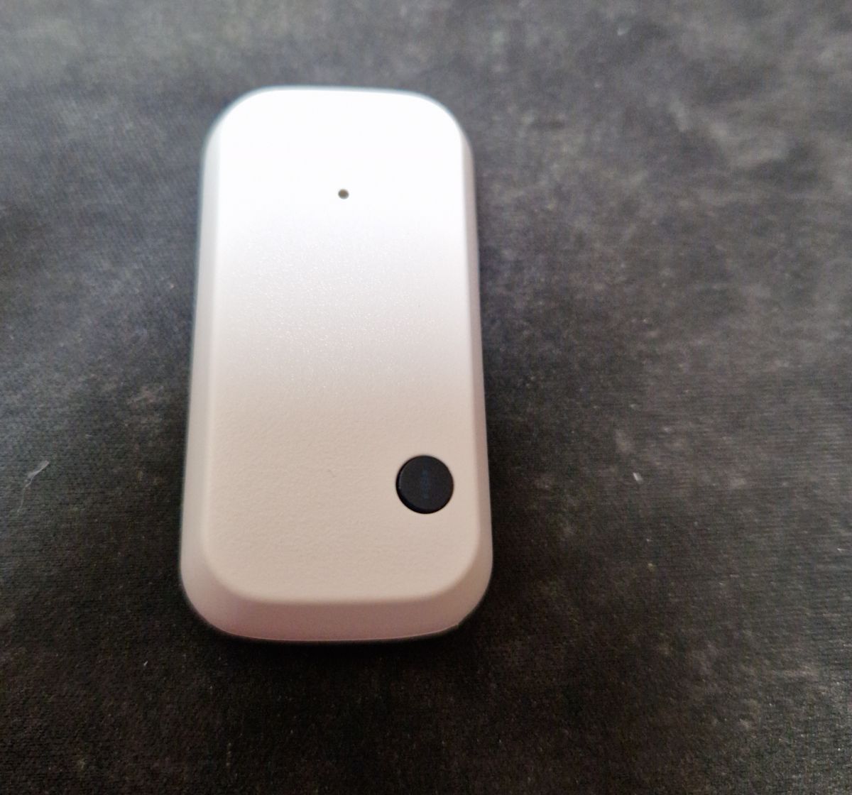

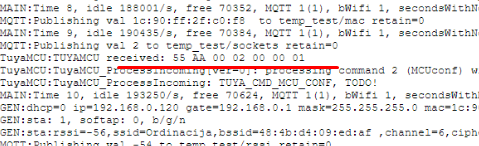

    Pairing button on TuyaMCU
    It is also worth paying attention to what TuyaMCU sends when we press the pairing button. This button is connected to the microcontroller, not to the WiFi module:
    Packet 55AA0002000001 is sent, which is packet type 02 with 00 00 bytes of data (that is, no data, the last byte, 01 here, is the checksum).
