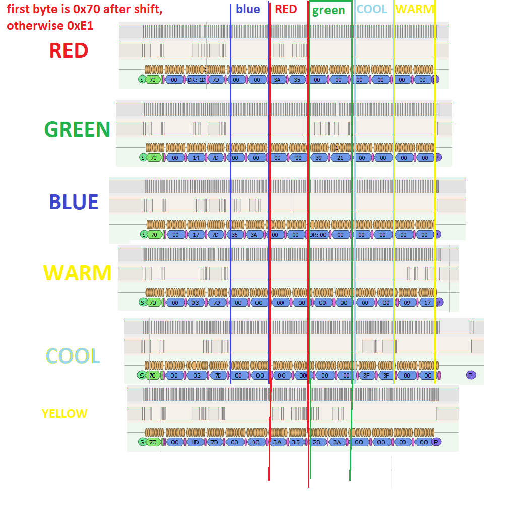

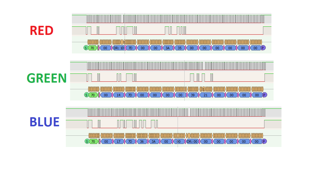

    Hmm, maybe let's try with red, green and blue at full bright first. Here or in private message.
    Added after 30 [minutes]:
    I've got something from @DeDaMrAz , here's a screenshot (modified by me in paint):
    [BK7231N/CB2L] Lumary 5/6 Inch Downlight - OpenBeken driver for KP18058esp LED controller
    Added after 40 [minutes]:
    we're getting closer [BK7231N/CB2L] Lumary 5/6 Inch Downlight - OpenBeken driver for KP18058esp LED controller

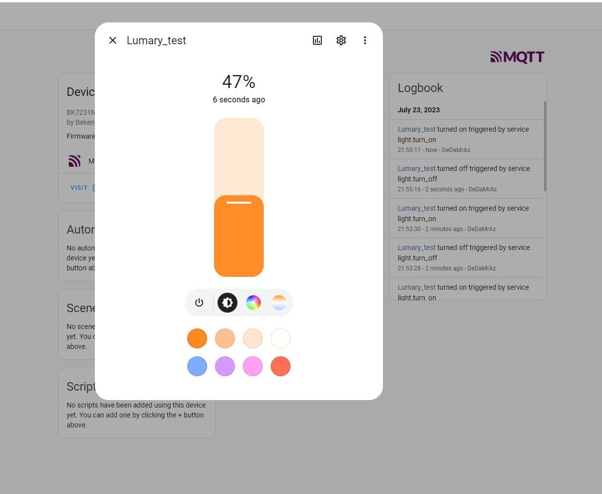

    Progress :) build 1.17.189
    KP18058_RGBCW FF00000000 - turns light on
    KP18058_RGBCW 0000000000 - turns light off

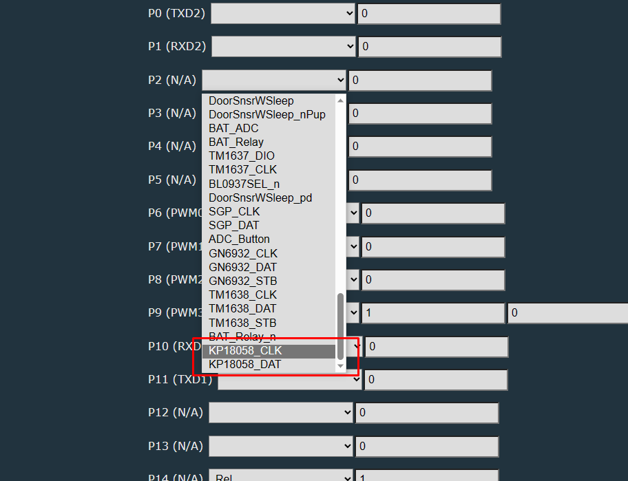

    Running 1.17.199 - The driver loads OK. Driver commands return OK. How can I define pin assignment to test fully?
  • #36 20665523
    DeDaMrAz
    Posts: 621
    Help: 34
    Rate: 130
    Since your light is the same you can create autoexec.bat file and enter following commands:
    startDriver KP18058
    KP18058_Map 2 0 1 3 4
    and test, pin assignment will be complete in the next build.
    EDIT: pin assignments is currently hardcoded so P8 -> SDA and P7 -> SCL

    Thank you for the cooperation, I have pushed the KP18058 pin roles selection support.
    It should be available in the next release.
