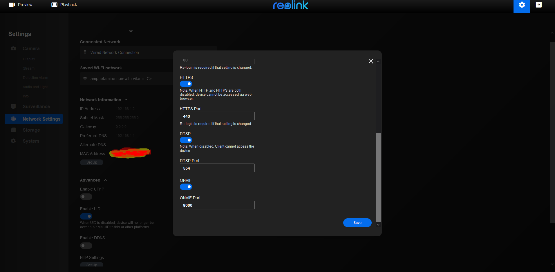

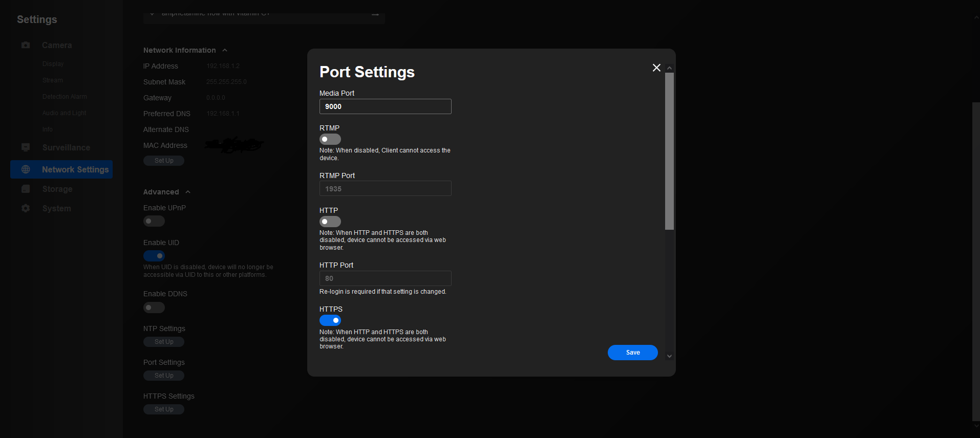

    I don't know where I could be going wrong
    Login password
    Https://IP
    Port 80
    I've tried about 30 combinations and nothing.

    How can I set the gateway?

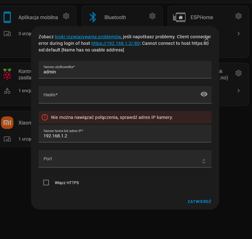

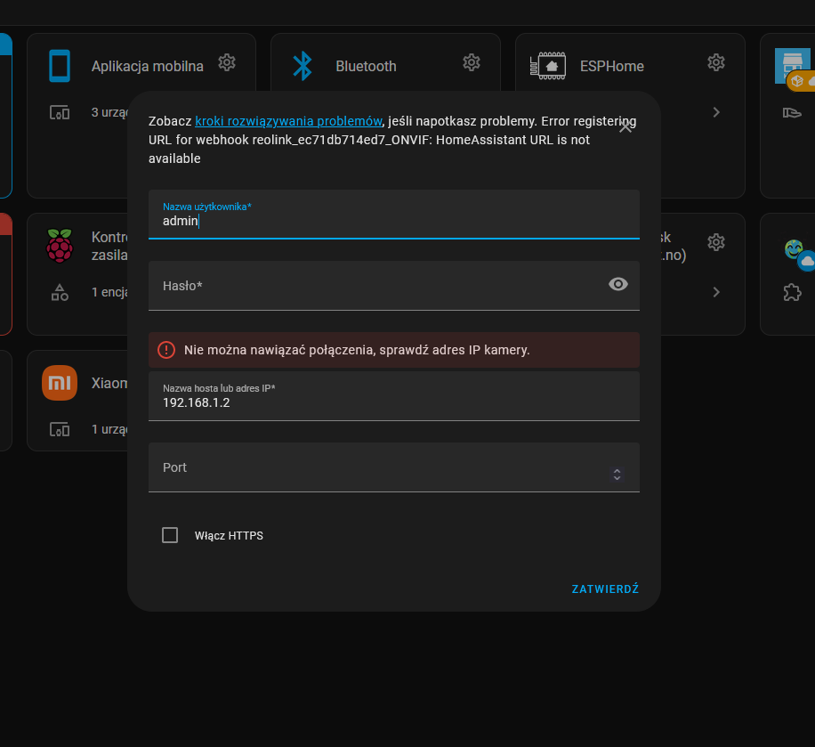

    When it comes to trying to log in:
    - In the browser, when I log in via https://192.168.1.28:443 and https://192.168.1.28 everything works (the Reolink login window launches for me). When I try to log in via https://192.168.1.28:80, it gives me an error: "An error occurred while connecting to the server "192.168.1.28:80". SSL received a record exceeding the largest allowed length".
    - As for errors when logging in via HA, that's all that shows in the screenshots.
    I'm using DuckDNS for remote access.
  • #6 20632926
    tgup
    Posts: 37
    Problem solved!
    It was enough to enter the address without the initial http:// or https://
