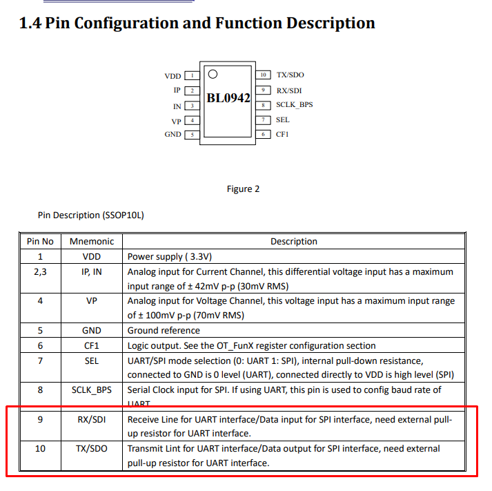

    Pin configuration diagram of the BL0942 chip with a description of each pin function.
    BL0942 just sends data via UART (or SPI) to WiFi module and WiFi module can process it once it's received.
    EDIT: I edited out incorrect information, it seems that BL0942 has actually ability to detect overcurrent/overvoltage via FUNX register and signal it on CF1/CF2/ etc pins.
    If you don't need to react very fast, you can use obk autoexec.bat script:
    addChangeHandler Voltage > 251 POWER OFF
    etc, etc...

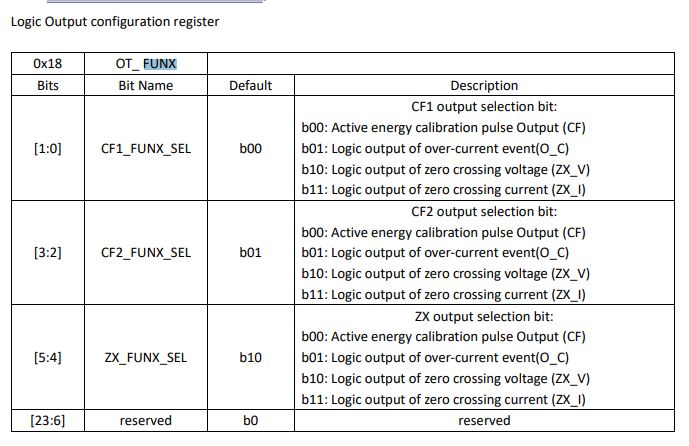

    It seems you can configure the BL0941 V1.06 CF1 output (also CF2, ZX otputs in bigger packages) to signal the over current condition (see OT_ FUNX) register. Is this signal connected anywhere? I can't check this myself for now, but two SY2 are on their way to me so will check when they arrive. The manufacturer clearly distinguishes SY2 from SY1, specifying the protection capability of SY2 as the only difference. But it may actually be poorly and unreliably implemented using the logic executed by the WiFi module as @p.kaczmarek2 said.
  • #69 21300797
    Posts: 14622
    Help: 655
    Rate: 12638
    I see, I wasn't aware that CF1 can be configured in that way.
    Logic output configuration register table with options for CF1, CF2, and ZX.
    If CF1 (etc) are connected somewhere, then maybe we indeed just need to configure OT_Funx register and the circuit will do the rest.

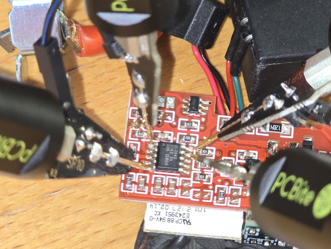

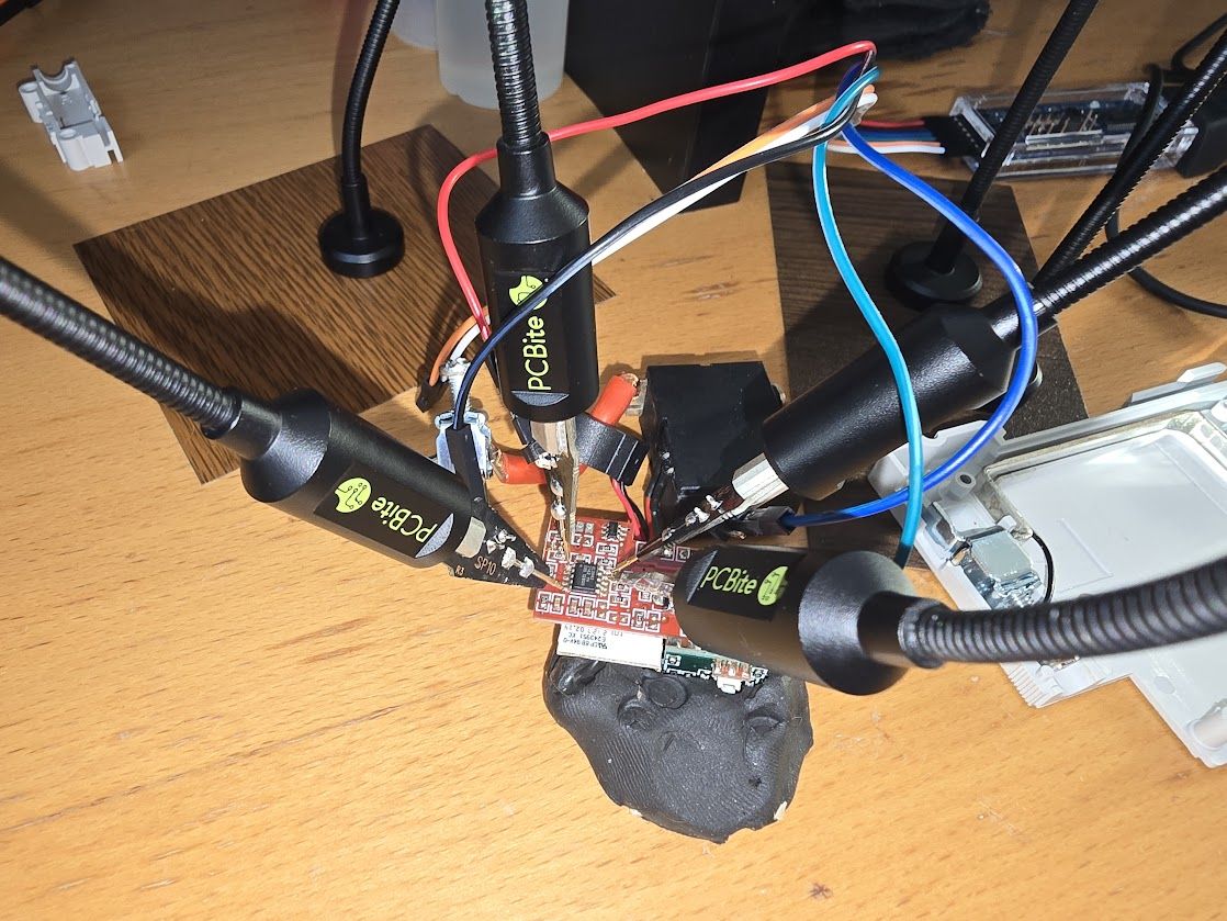

  • #74 21401656
    Drapol13
    Hi,

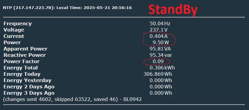

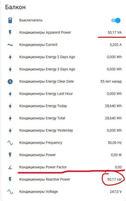

    I'm really struggling to load up this firmware. I tried BK7231GUIFlashTool-v5.
    I wanted to read firmware first. I tried disconnecting GND and also connecting CEN to GND for a fraction of a second.
    I keep getting this counter...
    Read parms: start 0x00 (sector 0), len 0x200000 (0 sectors)
    Now is: poniedziałek, 20 stycznia 2025 16:07:49.
    Flasher mode: BK7231T
    Going to open port: COM4.
    Serial port open!
    Getting bus... (now, please do reboot by CEN or by power off/on)
    Getting bus failed, will try again - 0/100!
    Getting bus failed, will try again - 1/100!
    Getting bus failed, will try again - 2/100!
    Getting bus failed, will try again - 3/100!
    I also tried to load up ESPhome but I also can't connect. Tried swapping RX TX nothing helped.
    Connections are good.

  • #75 21402384
    Posts: 14622
    Help: 655
    Rate: 12638
    max_mcu wrote:
    Hello community, I have the following problem: The relay is a bi stable relay. When the power is lost and then switched back on, the switch + LED is not on if the relay was switched on before the power failure. How can I determine after the power failure whether the relay is still on or off? Can this be fixed in the software?
    Well, maybe it would be enough to just set startup value of relay channel to -1, so OpenBeken remember it between reboots?
    @Drapol13 There can be multiple issues at play:
    - too long wires, poor contacts
    - BL0942 or something may be blocking UART, I'm not sure, but I remember that it also worked for me several times with BL0942
    - you need to have a good 3.3V power supply, directly from USB to UART won't work
    - maybe you need to try other baud or other USB to UART converter

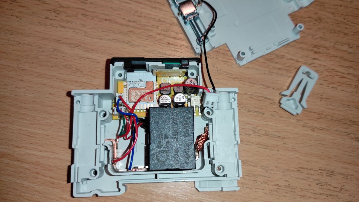

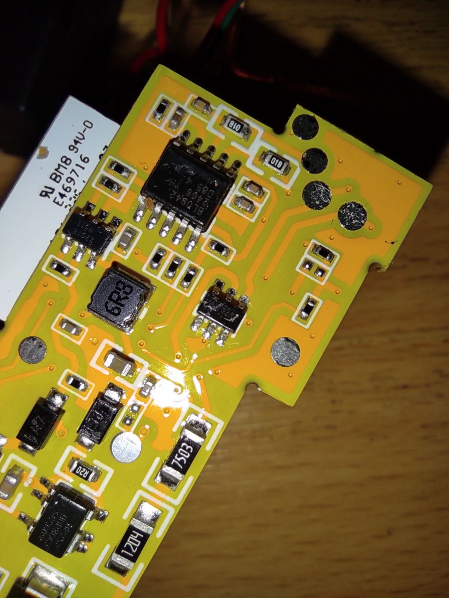

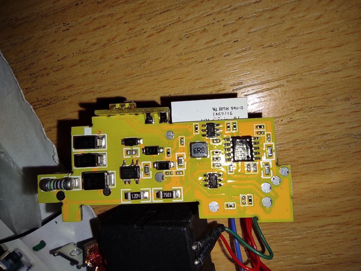

    I've managed to open and flash the SY2 version:
    Opened casing with visible electronics and connected wires.
    Close-up of a yellow PCB with visible electronic components, including an MD7620A integrated circuit.
    Close-up of a circuit board with visible electronic components and the marking 6R3.
    Also checked the connections on the board with a multimeter. The relay is connected to the MD7620A driver. Both inputs of the driver are directly connected to the CBU (P24, P26). The BL0942 CF1 pin seems to be left floating. In case of any autonomous control of the relay by BL0942 it should be some circuity on the board connected to the CF1 and MD7620A but the direct connection between MD7620A and CBU indicates that nothing of this sort is implemented.

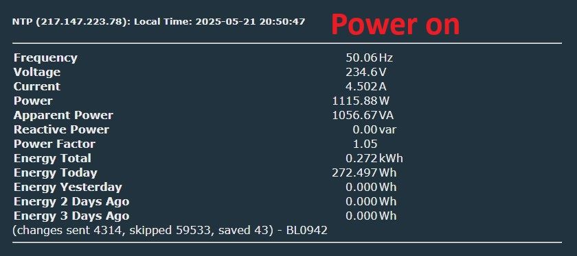

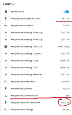

  • #77 21556224
    casiopeia80
    Posts: 15
    Hello everyone!
    Many thanks for the firmware — great work!
    However, I've encountered one issue. After flashing, the module doesn't seem to take the power factor into account in its calculations.
    I've been using this smart switch with the stock firmware for about a year. It powers three air conditioners, and I’m absolutely sure the original firmware correctly factored in cos(φ) (power factor) when calculating the reactive component of the AC current.
    For example, in standby mode, the three air conditioners consumed around 10 watts on the original firmware. With the new firmware, I’m seeing standby values of around 56 watts, which I believe is because the power factor isn’t being considered.
    Could this be improved in future updates?

  • #78 21556241
    Posts: 14622
    Help: 655
    Rate: 12638
    Welcome to forum! Just to confirm, you're using this device from this topic, with BL0942 connected via SPI?
    Added after 41 [seconds]:
    Also, did you calibrate this device after flashing with VoltageSet, PowerSet and CurrentSet commands?
  • #79 21556434
    casiopeia80
    Posts: 15
    >>21556241
    Yes, I am using the TO-Q-SY2-JWT device model.
    I realized that I needed to enable Flag 25 – [POWER] Allow negative current/power for power measurement (all chips, BL0937, BL0942, etc) in the device settings.
    I’ve read about the calibration process in the web interface, but I couldn’t understand how the power factor can be properly calibrated using a purely resistive load like an incandescent bulb.
    So, I decided to try a different approach.
    In my apartment, I have three LG air conditioners connected through this TO-Q-SY2-JWT module. Back when the device was running the original firmware, I monitored its readings and noticed that, in standby mode, the total power consumption was shown as around 10 watts. The line voltage was about 235 volts, and the current draw was 400 mA (with cos(φ) close to maximum in this low-power mode).
    At the time, I also measured the current using a True RMS multimeter — the readings matched the module’s output.
    So I tried calibrating your firmware using the same conditions: I set the air conditioners to standby and entered those known values into the calibration fields in the web interface.
    Now, the readings seem quite accurate — both when the air conditioners are in standby mode and when they are running. The measured values closely match the power consumption reported by the air conditioners themselves on their built-in displays.
    I have one more question: is there any way to extract the calibration data from the original firmware?
    Screen showing electric power consumption measurements and StandBy status.
    Screen displaying electrical energy measurement data with a red Power on message.
