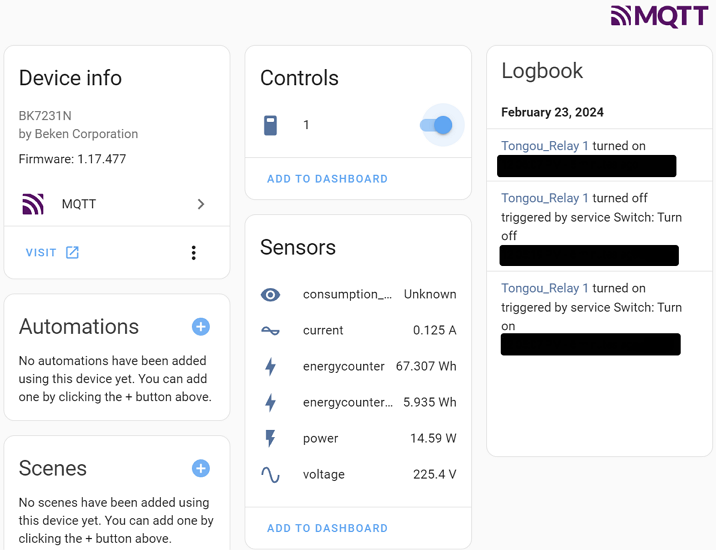

    Spag
    @p.kaczmarek2 Thank you, I was able to flash it via UART and it's working perfectly now - I was just hoping I could flash it without having to destroy the rivets to open the case..
    Congratulations on an amazing piece of software!
    Screenshot of an MQTT interface displaying device info for BK7231N, controls, sensors, and logs.

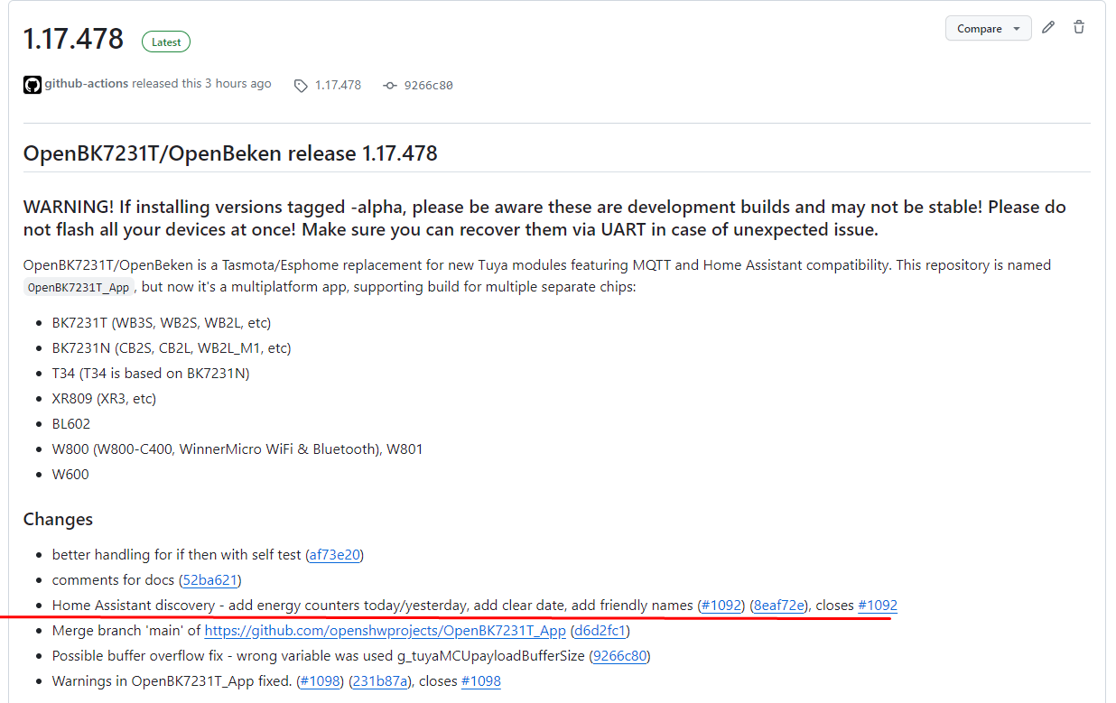

    Thanks, by the way, I think you'd benefit from updating to the new release:
    Screenshot of OpenBK7231T/OpenBeken release 1.17.478 listing changes and developer version warnings.
    Especially thanks to this commit:
    Home Assistant discovery - add energy counters today/yesterday, add clear date, add friendly names (#1092) (8eaf72e), closes #1092

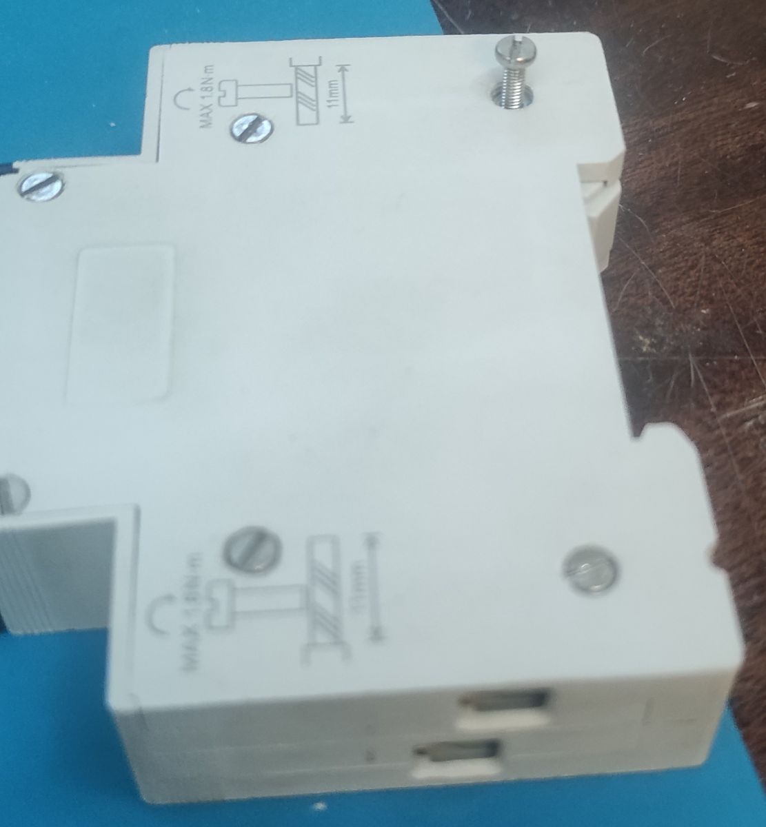

    What was the easy way to open it up ?
  • #35 20974921
    Spag
    @p.kaczmarek2 Fantastic, perfect timing! :)
    @babaganesh You have to drill the rivets to destroy them... only then you can open the case.
  • #36 21080140

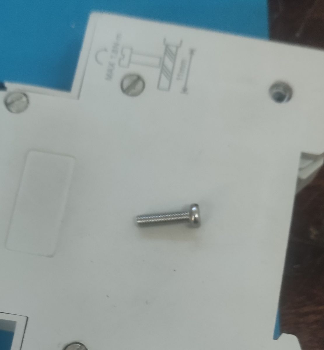

    onkel11
    Posts: 10
    Hi,
    any idea how do seal th device after flashing ?
    Somewhere to buy the seal pins ?

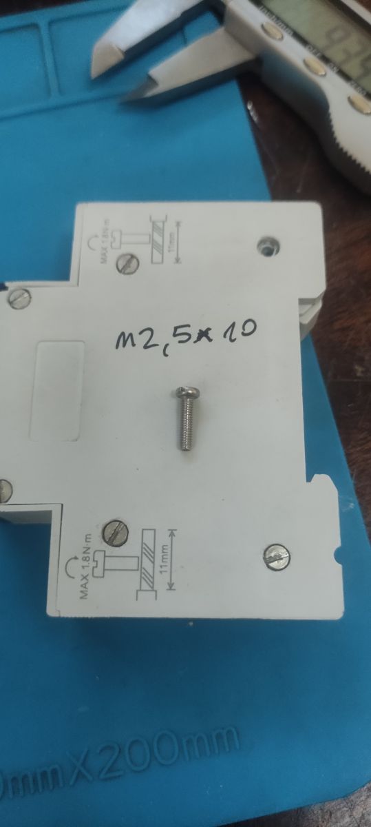

  • #38 21080758
    onkel11
    Posts: 10
    thanks
    Edit:
    I found another solution and will test it:
    Aderendhülsen unisoliert, Nennquerschnitt 1,50qmm, Länge 18mm, Außendurchmesser 2,00 mm
    the original ones do also have almost the same size.
    Keep you informed.
    Update:
    So this worked perfectly:
    hxxxs://www.amazon.de/Aderendh%C3%BClsen-Crimpverbinder-unisoliert-Kunststoffkragen-Nennquerschnitt/dp/B08QS2KR49?source=ps-sl-shoppingads-lpcontext&ref_=fplfs&smid=AER43YRX1AHYK&th=1
    Best regards

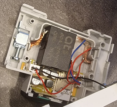

  • #39 21110271
    firsoff091
    We purchased a smart WiFi switch, Tongou TO-Q-SY1-JWT, and flashed it with OpenBeken following your instructions. Thank you for the guidance.
    The device has been working for over a month, collecting metrics and being controlled via Home Assistant (HA). However, we've encountered an issue where the switch turns off the electricity without any apparent reason. This has happened twice, with a one-week interval between occurrences. Unfortunately, we couldn't determine the cause of the "failure" based on the collected metrics in HA. The graphs of the collected metrics show everything within normal ranges.

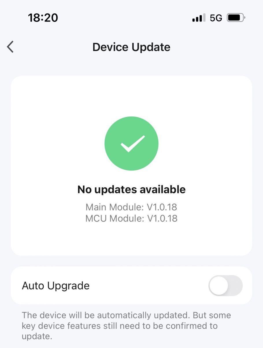

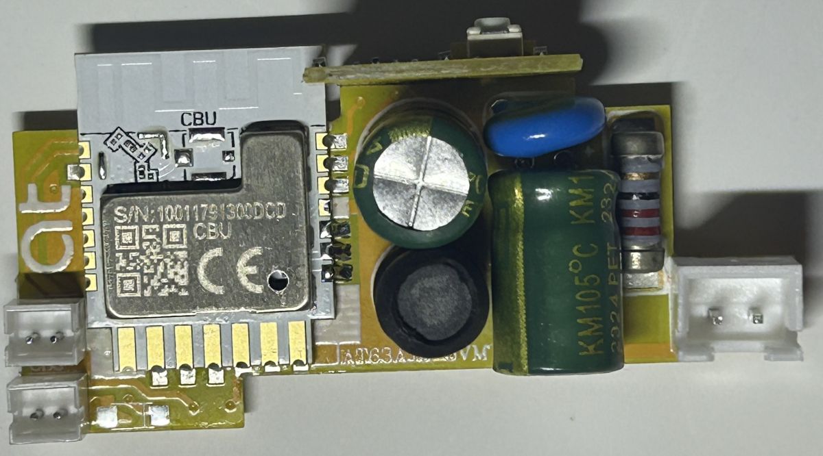

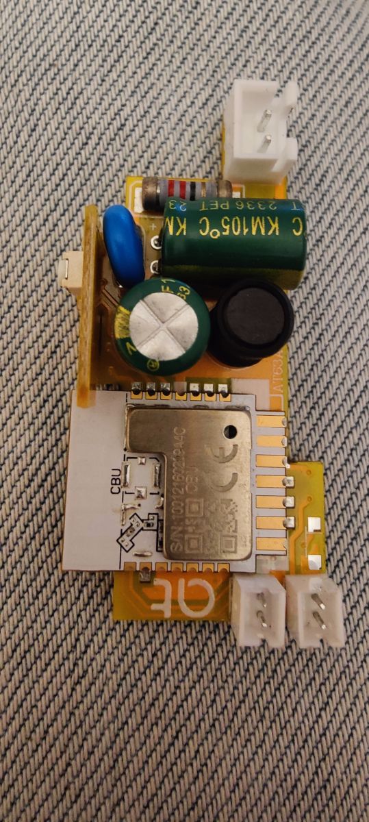

    silvestro_gatto
    Posts: 30
    TO-Q-SY1-JWT 32A Smart WiFi Switch With Metering Function
    Tuya Main Module Firmware V1.0.18 (not supported by Tuya CloudCutter)
    Yellow PCB version AT63AJL-8VMT
    Device update screen showing no updates available.
    Yellow printed circuit board of a smart WiFi switch with electronic components. Close-up of a yellow printed circuit board labeled AT63AJL-8VMT.
    Flashed with OpenBK7231N build version 1.17.612 and configured with the following OBK template
      "pins": {
        "9": "LED_n;1",
        "15": "WifiLED_n;0",
        "17": "Btn;1",
        "24": "BridgeFWD;1",
        "26": "BridgeREV;1"
      "command": "backlog startDriver BL0942; startDriver NTP"

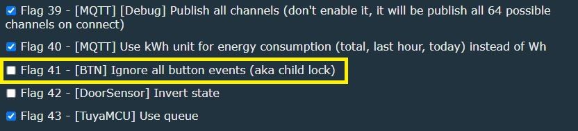

    everything is working fine but the button, when pressed, does not switch on/off
    GPIO Doctor is showing P17 Val changing Low/High only when dInput is selected.
    Any advice? Thank you!
    Added after 10 [hours] 4 [minutes]:
    I found the solution to my problem with the unresponsive button ...
    Flag 41 [BTN] Ignore all button events (aka child lock) in Configure General/Flags was checked by default.
    Screenshot of flag settings in OpenBK7231N software.
    After unchecking the flag, the button started working as expected.

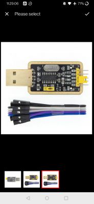

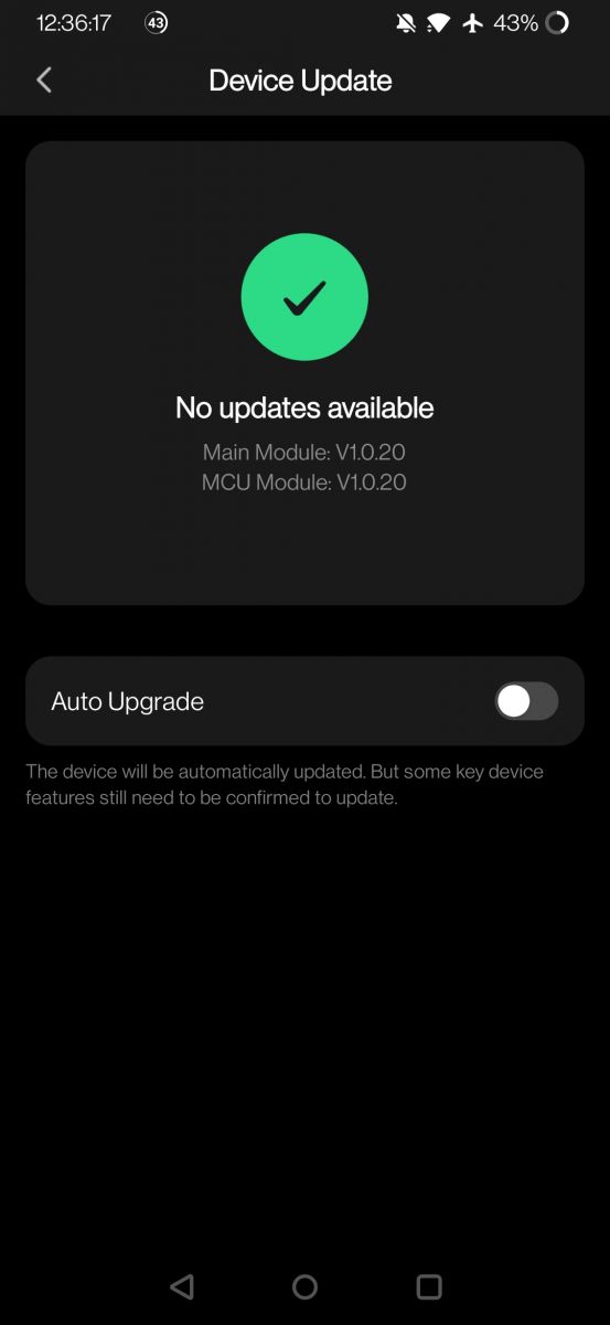

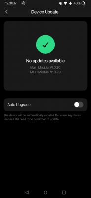

    I am having difficulty flashing this device Tongou TO-Q-SY1_163JWT 63 Amp Version breaker Electronic module on a denim fabric background. The image shows a circuit board of a Tongou TO-Q-SY1_163JWT 63 Amp device. . I am familiar with the process and have successfully flashed other switch devices eg: [BK7231N] Aubess Mini Switch 16A.
    I use a USB / TTL serial device from China CH430G-2 which has worked well in the past plus I swapped it out with a spare to confirm functionality.
    I am using the latest flasher bk7231flasher_1.3.3
    Attempts at flashing in place were unsuccessful so I decided to remove the CBU from the main board but still unsuccessful! Resetting the module by earthing CEN does not start the flash sequence (have tried many times). Also trying another 3.3 v power source, swapping rx1 and tx1 on uart1 just in case but to no avail!
    Attaching it to Tuya Smart app all works OK, noticing the firmware is V 1.0.20. Is it possible that Tuya have disabled flashing (bootloader rom) somehow? I do notice on their web site "Flash and Authorize CB Modules"

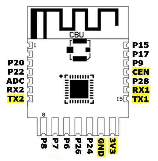

    Hi @Wobbie,
    actually flashing my device (TO-Q-SY1-JWT 32A Smart WiFi Switch With Metering Function - Tuya Firmware V1.0.18 - PCB marking AT63AJL-8VMT) was quite straightforward.
    I checked my notes and I did not find any specific issue with this device.
    I used a cheap CP210x USB to TTL UART Serial Convertor Module (set at 3.3V Voltage Level) and short wires connected to the CBU module, without removing it from the main board.
    This is the CBU module pinout:
    Pinout diagram of CBU module with highlighted pins TX2, RX1, TX1, CEN, 3V3, and GND.
    I used 3.3V, GND, and TX2 to capture the log from factory firmware, then I connected 3.3V, GND, TX1 and RX1 to backup factory firmware and upload OpenBK7231N build version 1.17.612, using BK7231 Easy UART Flasher (Set chip type: BK7231N - Set baud rate: 921600)
    As you wrote, CEN pin has to be shorted to GND to reboot, when BK7231Flasher.exe is "getting the bus ...."
    see the line " Getting bus... (now, please do reboot by CEN or by power off/on)" in the below log from flasher

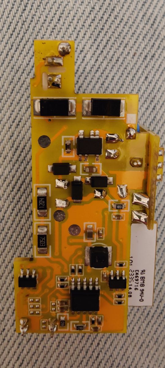

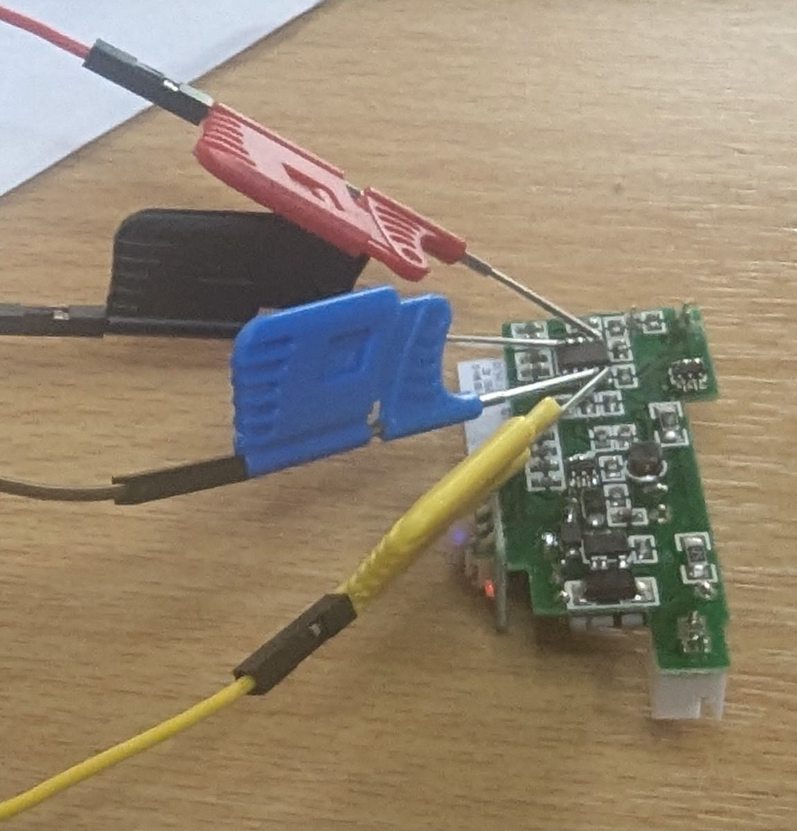

    Not able to test fully, as the power supply in this unit is broken so I can only power the CBU from +3.3v and can't test the relay. But I think this should mostly work as an esphome config. I haven't yet worked out what to do about restoring the original state on reboot, so I'm just forcing it on. It isn't a circuit breaker, and should never be used as a safety device, so I guess that's OK.
    Code: YAML
    Added after 8 [hours] 19 [minutes]:

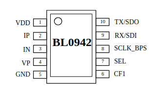

    All the pins needed for flashing this are on the BL0942 on the back of the board, easy to grab with SOIC probes.
    Block diagram of the BL0942 integrated circuit with labeled pins.
    Note that TX and RX are labelled for the BL0942, so they route to the RX1 and TX1 pins on the CBU respectively. I'm tempted to try drilling a tiny hole in the side of the next unit and doing keyhole surgery instead of drilling out the rivets and taking it completely apart.
    Printed circuit board with attached test probes.

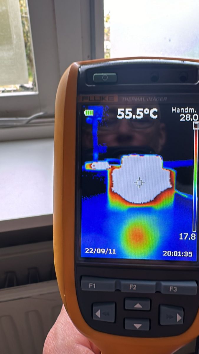

    Successfully flashed a few TO-Q-SY2-JWT, only thing I noticed that of the flashed devices the coils are getting hot, 55 degrees Celsius even without load, original software remains cold.
    Anyone else encountered this issue?
    Thanks
    Erik
    Fluke thermal imager displaying a temperature of 55.5°C.
  • #55 21263433
    dwmw2
    Posts: 19
    >>21263275 Are you driving the 'bridge' with pulses instead of holding the line high?

    dwmw2
    Posts: 19
    >>21264753
    can you please explain how I would be able to tell the difference?
    If you're using OBK, see the discussion about `Rel` vs. `BridgeFwd` at https://www.elektroda.com/rtvforum/topic3934580-30.html
    If you're using ESPHome, see https://devices.esphome.io/devices/Tongou-TO-Q-SY1-JWT (and I've got an actual bridge driver in https://github.com/esphome/esphome/pull/7421 which might one day get merged, to make that a bit easier).
    (Even if you're not using ESPHome, read the part about calibration in that one).

    >>21265055 Thanks for this, I might need to dust of my oscilloscope:-), and I will test weekend or early next week

What does OpenBeken Flag 41 "Ignore all button events" do, and why can it make the TO-Q-SY1-JWT button stop working?
Flag 41 disables button handling entirely, so the front button changes GPIO state but does nothing in normal control. On one SY1 unit, P17 clearly changed Low/High in GPIO Doctor only when configured as dInput, yet the button still did not switch the relay. The user found Flag 41, labeled child lock, was checked by default. After clearing that flag in Configure General, the button started toggling the switch normally. [#21118531]

How do I open the Tongou TO-Q-SY1-JWT case without damaging it too much, and what can I use to reseal it afterward?
Most users opened it by drilling out the factory rivets, because there was no simple non-destructive method reported. After flashing, users resealed the case with either M2.5x10 hardware or uninsulated ferrules matching the original pins closely. One tested ferrule option was 1.50 mm², 18 mm long, with a 2.00 mm outer diameter, and it reportedly worked perfectly. Expect some cosmetic damage, but the enclosure can be closed securely again. [#21080758]
