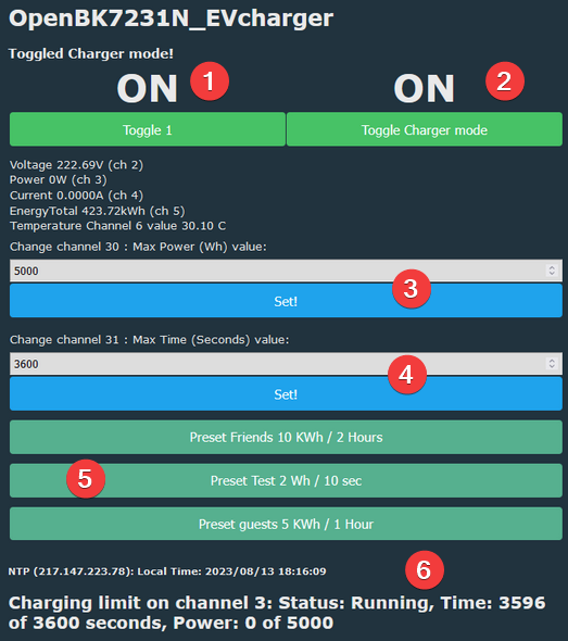

    For scenario 1, scripting an OBK-enabled meter with different users can be an option. OBK would post the totals of each charging session, along with the "userid" variable, to a web-based data collection endpoint. This would also allow for registering different tariffs, although I have not found an existing script to fulfill this functionality yet.
    For scenario 2, the "ChargeLimit" driver in OBK can be used. It enables setting a maximum power limit and/or time window for supplying power to the charger. For example, you can restrict the charging time to a maximum of 60 minutes and the power to a maximum of 10 kWh. If either limit is reached, the charging session automatically stops by disconnecting the power to the charger.
    In both scenarios, when starting the charging session either via MQTT or the OBK GUI, the person wishing to charge would simply connect the cable between their vehicle and the charger to initiate charging.
    For scenario 3, the "ChargeLimit" driver can also be employed. Presets can be easily set up with scripting in OBK, such as an "electrical step" that requires more time but less power, or a "small client" preset that allows for a maximum of 30 minutes and 5 kWh. If you want to charge, you can select a preset like "20 kWh, 2 hours charge (10 EUR)".
    At any time, you can remotely stop the charging session or monitor how much power and time remain.

    An example of how that would look (with presets via scripting) :
    OpenBeken EV charger user interface with charging mode and power limit settings.
    (1) re(start) charging session
    (2) enable/disable charger mode
    (3) set maximum power for the session
    (4) set maximum time for the session
    (5) or select a preset
    (6) current status of the session, how much power or time is left
