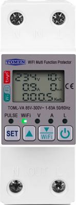

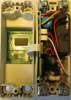

    Just a quick teardown.
    This meter has voltage, leak current, power protection.
    Teardown of TOMZN TOML-VA 63A Wifi Protector: BL0942 Chip and Taoplus CBU BK7231N Module

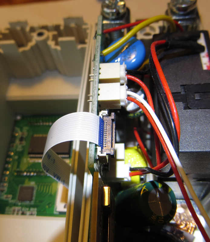

    Opening is easy, just remove 2 screws from the back.
    Interior of disassembled meter with ribbon cable and electronic components
    Remove ribbon cable

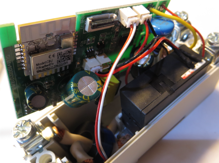

    Connectors for coil, voltage and relays

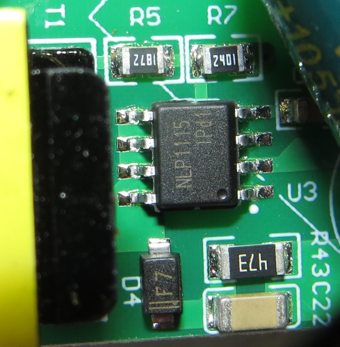

    Power measuring chip BL0942
    Wifi module Taoplus CBU BK7231N

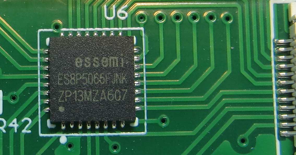

    Controller ESSEMI ES8P5066 MCU
    https://www.essemi.com/uploads/20211013/c4d18e635537d1d3f442a5eae036a2dc.pdf

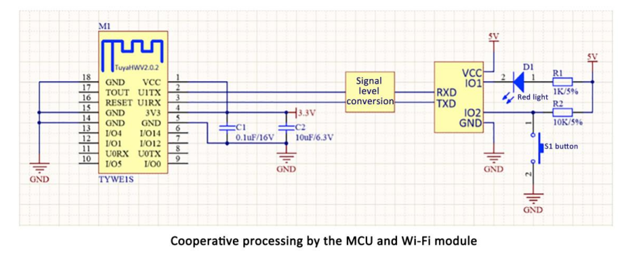

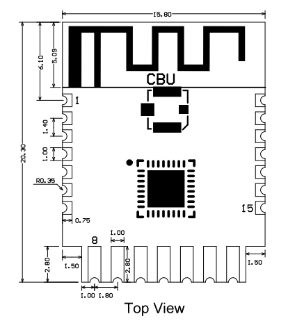

    Hello, this device can easily run OBK. We have similar devices supported.
    This is a TuyaMCU device with CBU WiFi module.

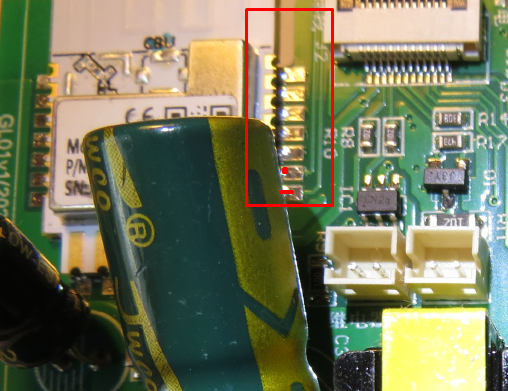

    UART is here:
    Pin numberSymbolI/O typeFunction
    15TX1I/OUART_TX1, which is used for transmitting user data and corresponds to Pin 27 of the IC. For the MCU solution, please refer to CBx Module.
    16RX1I/OUART_RX1, which is used for receiving user data and corresponds to Pin 26 of the IC. For the MCU solution, please refer to CBx Module.
    You can clearly see UART1 traces on the photo:

    I have 20 of these breakers and it is a pain to solder the pins to program it. Is there an easier way?
    Also, when I set up pairing, I only get fast-blinking (which means it is in EZ pairing mode, works with BLE) but I can't get it to do AP mode. I tried pressing all buttons for a long time but no avail.

  • Disconnect ribbon cable for easier programming
    #10 20722779
    Zogdan
    Posts: 25
    Help: 6
    Rate: 13
    No, just disconnect the ribbon cable (which disconnects the module from the main processor). You may check if there is a direct connection of the required pins to the ribbon cable, and create a custom ribbon cable. Or create a clamp yourself.
    Also, when I setup pairing, I only get fast-blinking (which means it is in EZ pairing mode, works with BLE) but I can't get it to do AP mode. I tried pressing all buttons for a long time but no avail
    That is weird, with no config openbeken should be in AP mode. Try disconnecting power 5 times, that should force AP mode.
