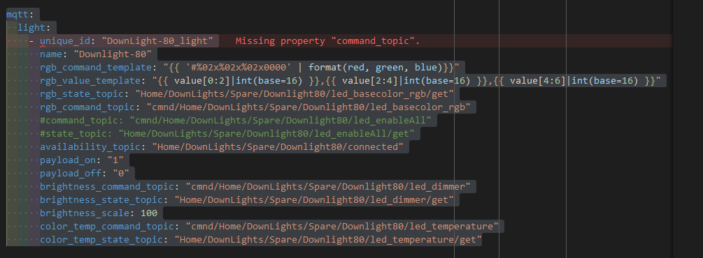

    OK so I commented out like below
    mqtt:
      light:
        - unique_id: "DownLight-80_light"
          rgb_command_template: "{{ '#%02x%02x%02x0000' | format(red, green, blue)}}"
          rgb_value_template: "{{ value[0:2]|int(base=16) }},{{ value[2:4]|int(base=16) }},{{ value[4:6]|int(base=16) }}"
          rgb_state_topic: "Home/DownLights/Spare/Downlight80/led_basecolor_rgb/get"
          rgb_command_topic: "cmnd/Home/DownLights/Spare/Downlight80/led_basecolor_rgb"
          #command_topic: "cmnd/Home/DownLights/Spare/Downlight80/led_enableAll"
          #state_topic: "Home/DownLights/Spare/Downlight80/led_enableAll/get"
          availability_topic: "Home/DownLights/Spare/Downlight80/connected"
          payload_on: "1"
          payload_off: "0"
          brightness_command_topic: "cmnd/Home/DownLights/Spare/Downlight80/led_dimmer"
          brightness_state_topic: "Home/DownLights/Spare/Downlight80/led_dimmer/get"
          brightness_scale: 100
          color_temp_command_topic: "cmnd/Home/DownLights/Spare/Downlight80/led_temperature"
          color_temp_state_topic: "Home/DownLights/Spare/Downlight80/led_temperature/get"
    I think that's all I need to do?
    However as soon as I comment out command_topic I get an error:
    Screenshot of MQTT configuration for a light with the error Missing property 'command_topic'.
    And of course the configuration is invalid message in HA's Check and Restart page

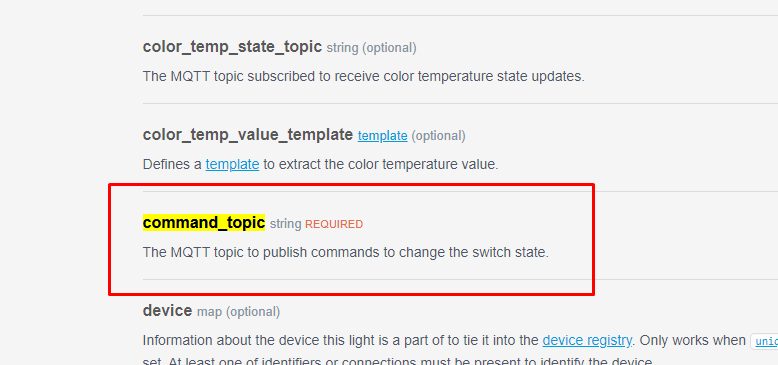

    Oh no, it looks like that the Home Assistant guys are forcing us to have command topics for every light! This is not good.
    Your use case is so unique that they didn't expect nobody to try that...
    Well, the docs confirm:
    https://www.home-assistant.io/integrations/light.mqtt/
    Fragment of documentation on MQTT configuration in Home Assistant.
    Maybe we can try to do the work around.
    So:
    - keep state_topic set like it always was
    - set "command_topic" to something like "this/topic/does/not/exist" etc etc so it goes into the ether... so light never receives the commands for ON or OFF...

    Now the next question - the changes that we worked on for the device in HA - the YAML config for it - is there an option that you can build in OBK HA Auto Discovery to set up a zombie command topic? Will be much better that way so one can use HA auto discovery rather than manually add YAML config in HA. Or OBK auto discovery doesn't work that way?

The best working method is manual MQTT YAML with a fake command_topic. Keep the normal RGB, brightness, and color-temperature command and state topics, but point command_topic to a non-existent MQTT path so HA shows a toggle that cannot actually switch the bulb off. In the thread, this kept brightness, RGB, and temperature working while ON/OFF from HA did nothing. [#20711912]
Why does a Home Assistant MQTT light still show an ON/OFF toggle even when I add the device manually through YAML instead of using MQTT auto discovery?
It still shows because Home Assistant treats an MQTT light as a light entity and expects power control to exist. Manual YAML changes how the entity is defined, but it does not change the platform model. The maintainer confirmed that HA was effectively “forcing us to have command topics” for every MQTT light, so switching from discovery to YAML alone does not remove the toggle. [#20711888]

Create a manual mqtt.light entity and keep the RGB, brightness, temperature, availability, and state topics, but replace only the power command_topic with a dead topic. 1. Copy the working OBK MQTT topics for led_basecolor_rgb, led_dimmer, and led_temperature. 2. Keep state_topic for led_enableAll/get. 3. Set command_topic to an unused path, then restart HA. That leaves HA and Alexa able to change scenes while the physical switch remains the only real power path. [#20711912]
What happens in Home Assistant if I remove the MQTT state_topic or command_topic from a light entity, and why does HA require a command topic for MQTT lights?
Removing command_topic makes the light configuration invalid in Home Assistant. The user tested that change and HA immediately raised a configuration error when command_topic was commented out. The maintainer then checked the documentation and concluded HA requires a command_topic for MQTT lights, which is why the workaround uses a dummy topic instead of removing it. [#20711888]
How do I use a dummy or non-existent MQTT command_topic in Home Assistant as a workaround to block ON/OFF commands for an OpenBeken light?
Point the light entity’s command_topic to an MQTT path that no device subscribes to. The tested example used cmnd/Home/DownLights/Spare/Downlight80/this/command/topic/is_not_Used, while keeping the normal state_topic and all color-control topics intact. After rebooting HA, the light still appeared, ON/OFF did nothing, and brightness, RGB, and temperature continued to work. [#20711912]
