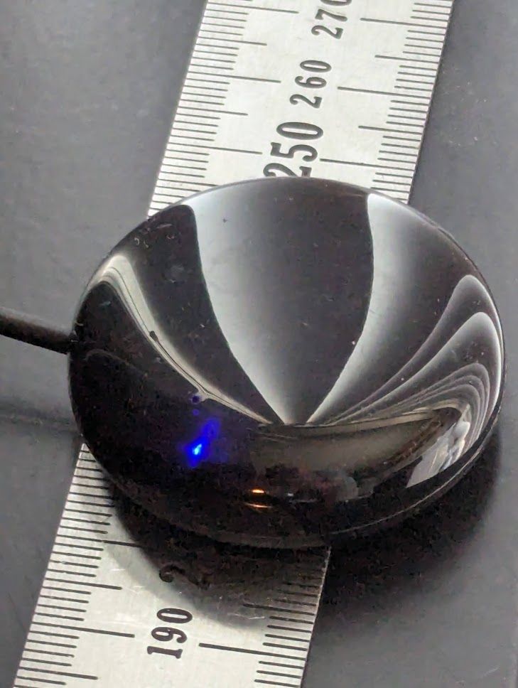

    The whole device is just 38 mm diameter, 15 mm thick.

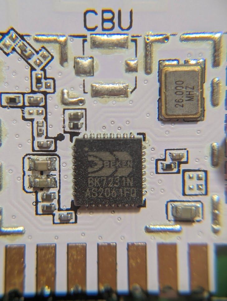

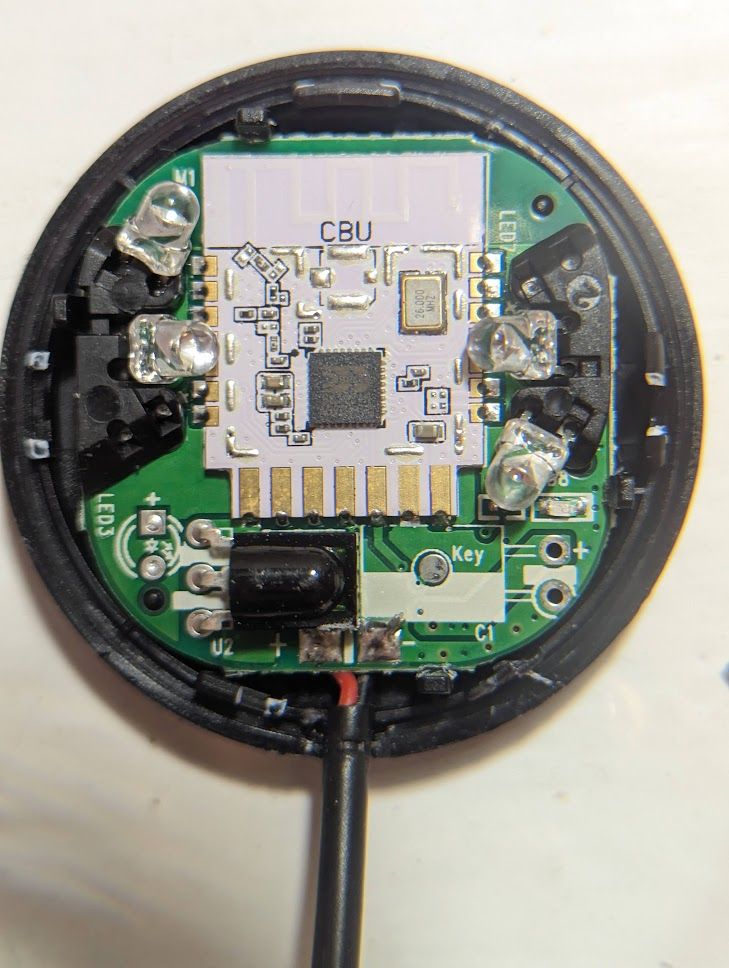

    It has a BK7231N on the common CBU board. Four IR leds on top, and a receiver. Blue status LED and a button on the bottom.
    Trivial to flash with a USB-serial device, the pins are labelled underneath the board. I usually solder some 30 gauge wires to them.
