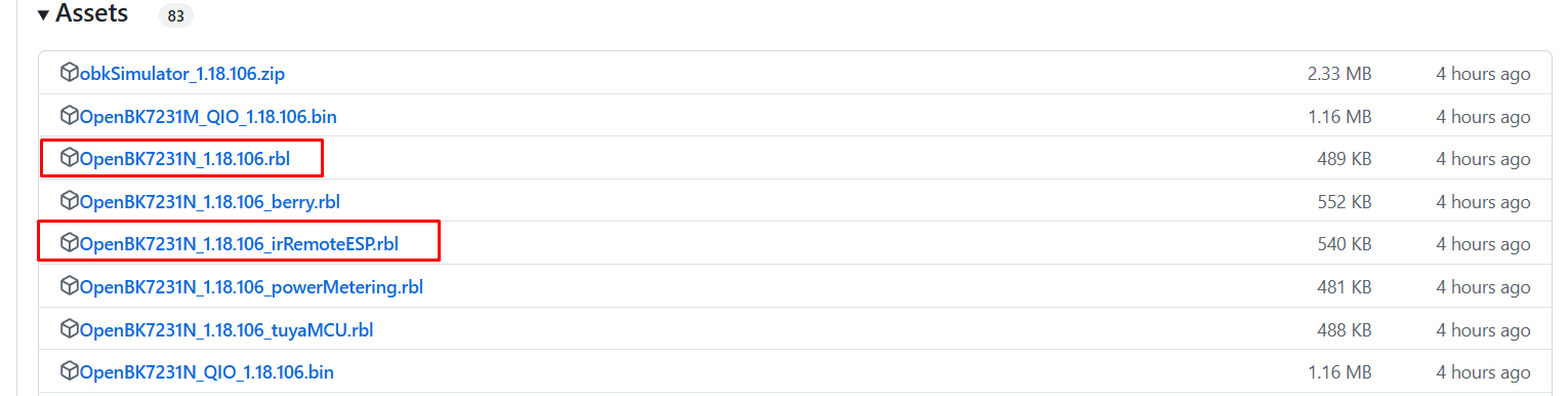

    We have two IR libraries integrated, IRRemote and IRRemoteESP8266. Which one did you try?
    List of downloadable files from a repository; two .rbl files highlighted.

    I'm actually not sure. I think the IRRemote version.
    Is there a way to check from the web portal?
    In the meantime I might try the IRRemoteESP8266 version.

    Quick update. With the IRRemoteESP8266 version, half the signals now show as Gree, so we're making progress! The other half still show as Unknown. Now looking to see if I can dump the whole IR packet
