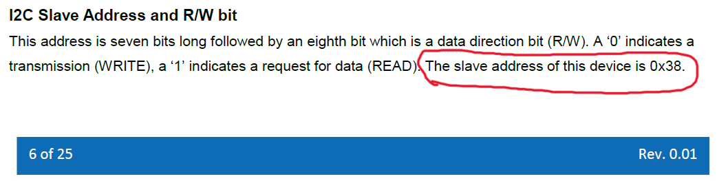

    ....and.. one more thing. a while ago I had found some datasheet during my research for this light sensor (I think it was actually through google picture results).. the sensor looks similar from the product picture on the PDF.. the name is "Ambient Light Sensor with I2C Interface EAALSDIC2020A2" (Everlight Americas)
    Cover of the datasheet for the EAALSDIC2020A2 ambient light sensor with I²C interface from Everlight Americas.
    Now with scrolling through the sheet, I found that the Slave Address is 0x38!!!
    Snippet of technical documentation with the Slave address 0x38 highlighted.

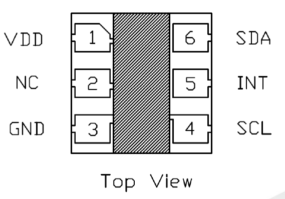

    And the pinout seems to match as well, at least SDA and SCL have the same position as we found here in our analysis, and the middle pin (--> P26) is labelled as INT ("Interrupt pin")
    Top view of an electronic component pin layout with labels VDD, NC, GND, SCL, INT, SDA.
    I'll attach the PDF here for those of you who understand more about electronics. Maybe we are very close to a solution now!
    EAALSDIC2..A2.pdf (828.75 kB)You must be logged in to download this attachment.
