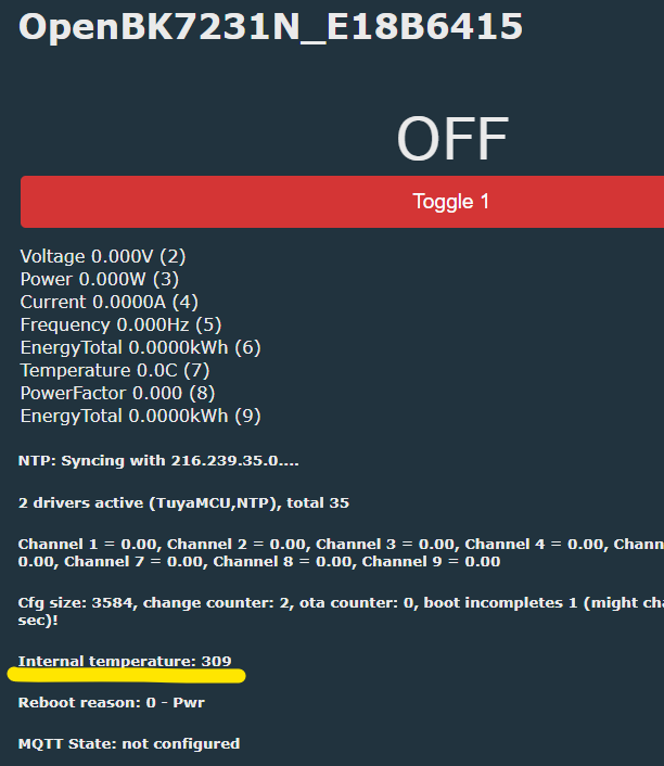

    As you can see in my post above, on this device, the CPU temp is sent on dpid 135 from tuyamcu and set on channel 7 on OBK
    Ah ok. Not from the BK7231N itself. I was curious about a temp reading for all BK7231s
    Next thing, have you had to calibrate the power on this unit itself after flashing to OBK? I bought mine to calibrate other devices flashed with OBK

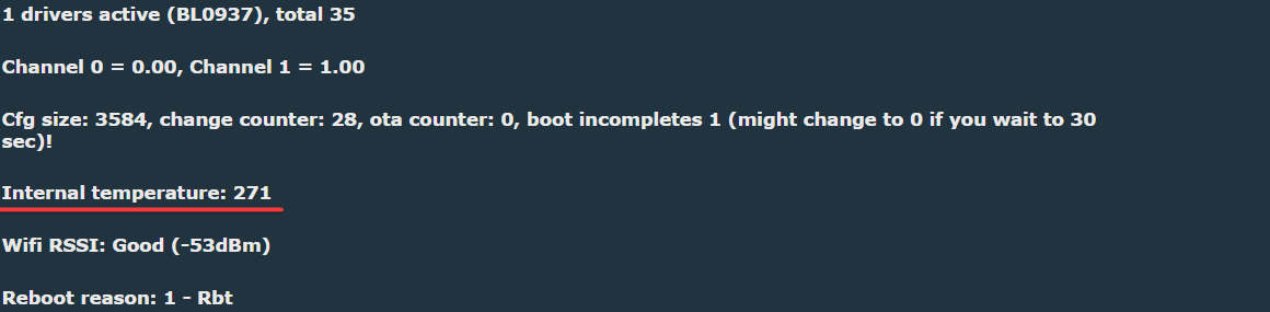

    Beken also has some internal temperature functions, tried to make use of them, but it reports 270 for me, not sure, could it be Celsius *10?
    You can try for yourself this build

    miegapele wrote:
    Beken also has some internal temperature functions, tried to make use of them, but it reports 270 for me, not sure , could it be Celsius *10?
    There is a Temperature_div10 channel type if the temperature read 10x higher, it should fix the reading.
    Screenshot showing diagnostic information for an IoT device.
    This is a very good job, but:
    1. please encapsulate the code in a check for safe mode, I don't want to accidentally brick devices for hundreds of users
    2. is it a scaled value from Beken or raw value from ADC (that is in 0-1024 range, I guess)?

  • #35 20946866
    miegapele
    Posts: 173
    Help: 15
    Rate: 29
    I'm not sure what this is, the sdk limits values to be between 50 and 700. Could be Celsius, but then 70C is sorta low.

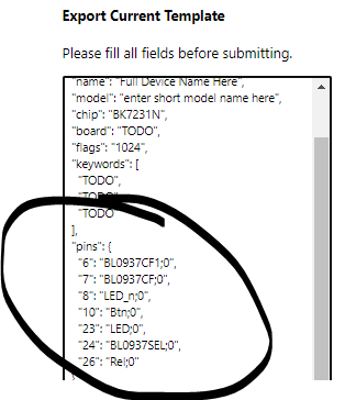

    >>20946773
    this is cool. Hopefully it can be made good for general release :)
    what do your GPIOs look like now as seen in the template export?
    Screenshot of the export template field with highlighted GPIO pin information.
    Oh I understand now. TuyaMCU controls everything, so no GPIO assignments. This is my first real look at anything with TuyaMCU. And also my first CB3S desoldering, which I didnt particularly enjoy, despite the help of this good vid.

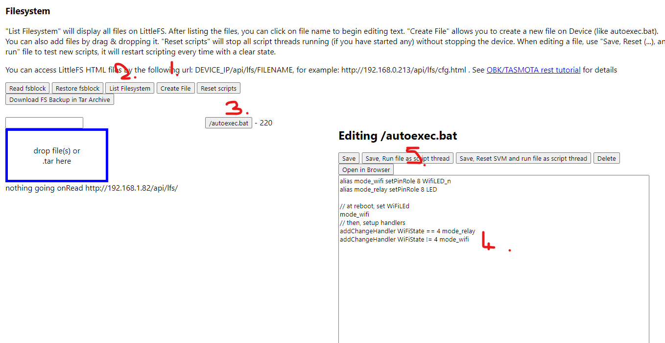

    micbanand
    Posts: 13
    I can see it on a given IP.
    But I get no readings, and the switch on/off is not working.
    Yes, I have watched that video.
    But I can't see anywhere how to upload autoexec.bat to my unit, only how to create it.
    Well, for example drag and drop file or just copy content?
    I just copy the text into the box after opening the autoexec.bat I created in the web app.

  • #46 20957553
    Posts: 14587
    Help: 654
    Rate: 12609
    You can also drag and drop a file on a field that says.... "drop file(s) or .tar here"

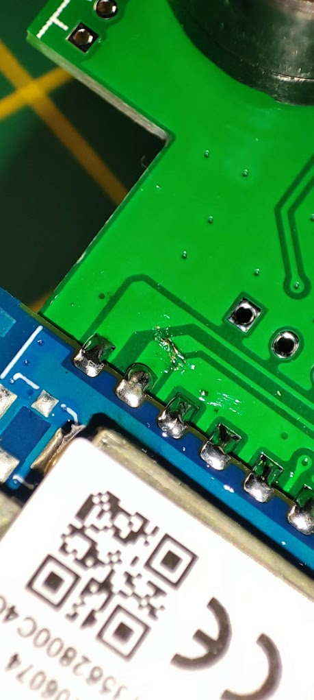

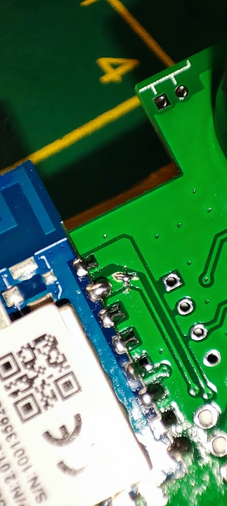

    Finally flashed a replacement after blowing up my first. No desoldering of module, I have no heat gun.
    I had to sever the RX from the CB3S then all was OK flashing with all pins soldered to USB-TTL
    here is Tuya API response for this device
    in summary
    This was trace cut and then soldered with a little blob.

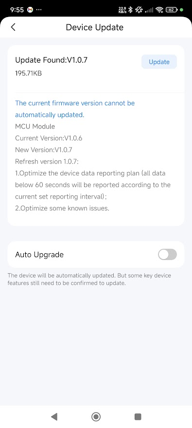

    App screen showing information about available MCU update to version 1.0.7
    this is the 1.0.7 MCU update binary file downloaded by the Tuya app to update from 1.0.6
    • strings.txt (3.98 KB) You must be logged in to download this attachment.
    • Atorch_S1_MCU_1.0.7.bin (195.71 KB) You must be logged in to download this attachment.

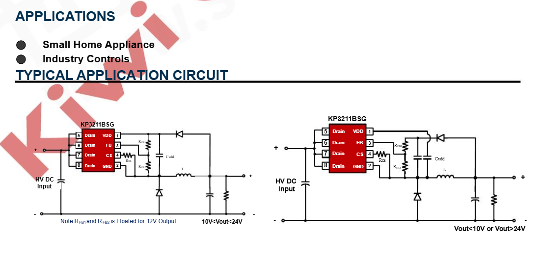

    Could someone please measure the voltage on the 470 µF capacitor located next to the large black inductor? Thanks!
  • #53 21744827
    Posts: 14587
    Help: 654
    Rate: 12609
    Hey, why? Do you have a faulty device? This capacitor is in the power supply circuit, the KP3211BSG is used there.
    Application circuit diagram using KP3211BSG with HV DC input
    Do you suspect your KP3211BSG is faulty?
    Considering the fact that the 6118A 33 (3.3V) voltage regulator seems to be connected there, most likely the voltage there is around 5V, but I don't have this device to check. I would not expect 12V there, there is no need for such voltage and it's not used with LDO s directly, for 12V, we would rather see a step down. So, I think that KP3211BSG provides around 5V DC and then LDO provides 3.3V for WiFi module.

    I’ve repaired this device, but now the supply voltage is around 4.7–4.8 V, and it fluctuates a bit (which might be normal for this kind of converter, considering its somewhat unusual topology). It looks like the device is working, but I’m still not sure whether this voltage is considered normal, or if it’s supposed to be exactly 5 V.

How do I upload or apply an autoexec.bat file in OpenBeken after flashing the device?
Upload it through the OpenBeken web app. You can paste the file contents into the autoexec editor, or drag and drop the file onto the field labeled drop file(s) or .tar here. Users who saw Wi-Fi but no readings or no relay action were told that the missing step was applying the autoexec.bat after flashing. If the web panel opens on the device IP, you already have the right place to do it. [#20957553]

What voltage should appear on the 470 µF capacitor near the large black inductor and KP3211BSG power supply section, and is 4.7 to 4.8 V considered normal?
The expected voltage is about 5 V, and 4.7–4.8 V was reported on a repaired unit that otherwise worked. The reasoning in the thread was that the KP3211BSG likely feeds that rail and a 6118A 3.3 V regulator then powers the Wi-Fi module. The expert comment was clear: “most likely the voltage there is around 5V.” No one measured an exact factory value on an untouched unit in that exchange. [#21744827]
