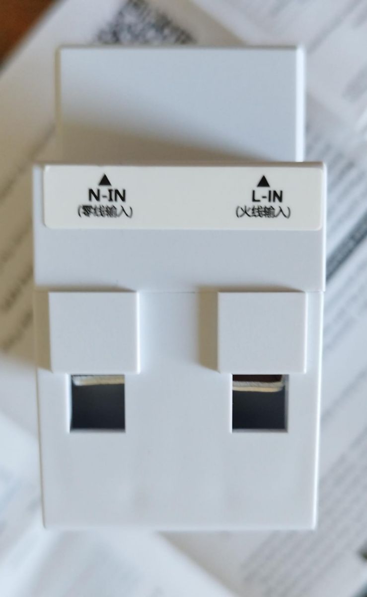

  • Hello to all!
    I recently bought this one for my collection, got it very cheap on sale, but the normal price is also good Link:
    Advertisement for GR2PW WiFi-enabled electricity meter.

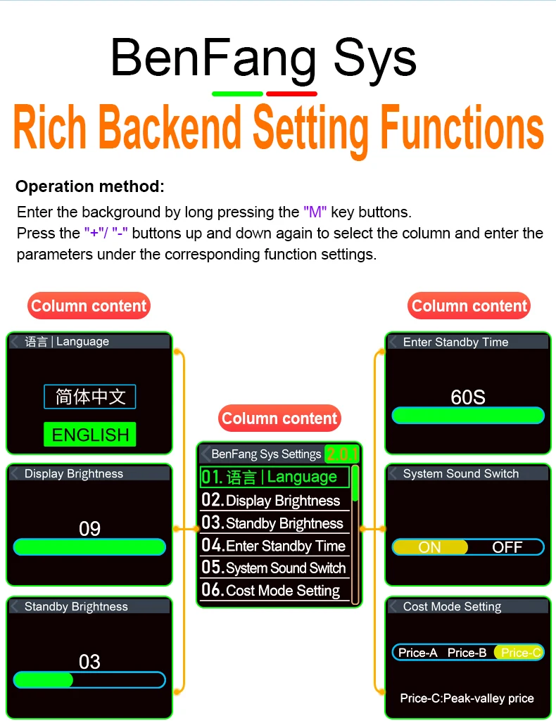

    I found it interesting, compared to the other two similar devices I've been playing with (TOMPD63-WIFI and TOMPD63-LW because of the graphic screen. OTOH, it doesn't have residual current measurement (this version, at least, as we'll see later). Anyway, I don't think software-based RCBOs like those two should replace "conventional" (or this better kind of smart ones), because of safety reasons.
    Ok, let's start with a print of the description from the advertisement (in case the link gets broken), enclosed as the first attachment. It includes a good gallery of screenshots from the device itself and the Tuya app, so I'll skip my own related photos. Also, here's a link to the manual from the manufacturer's page (also attached, in case the link breaks).

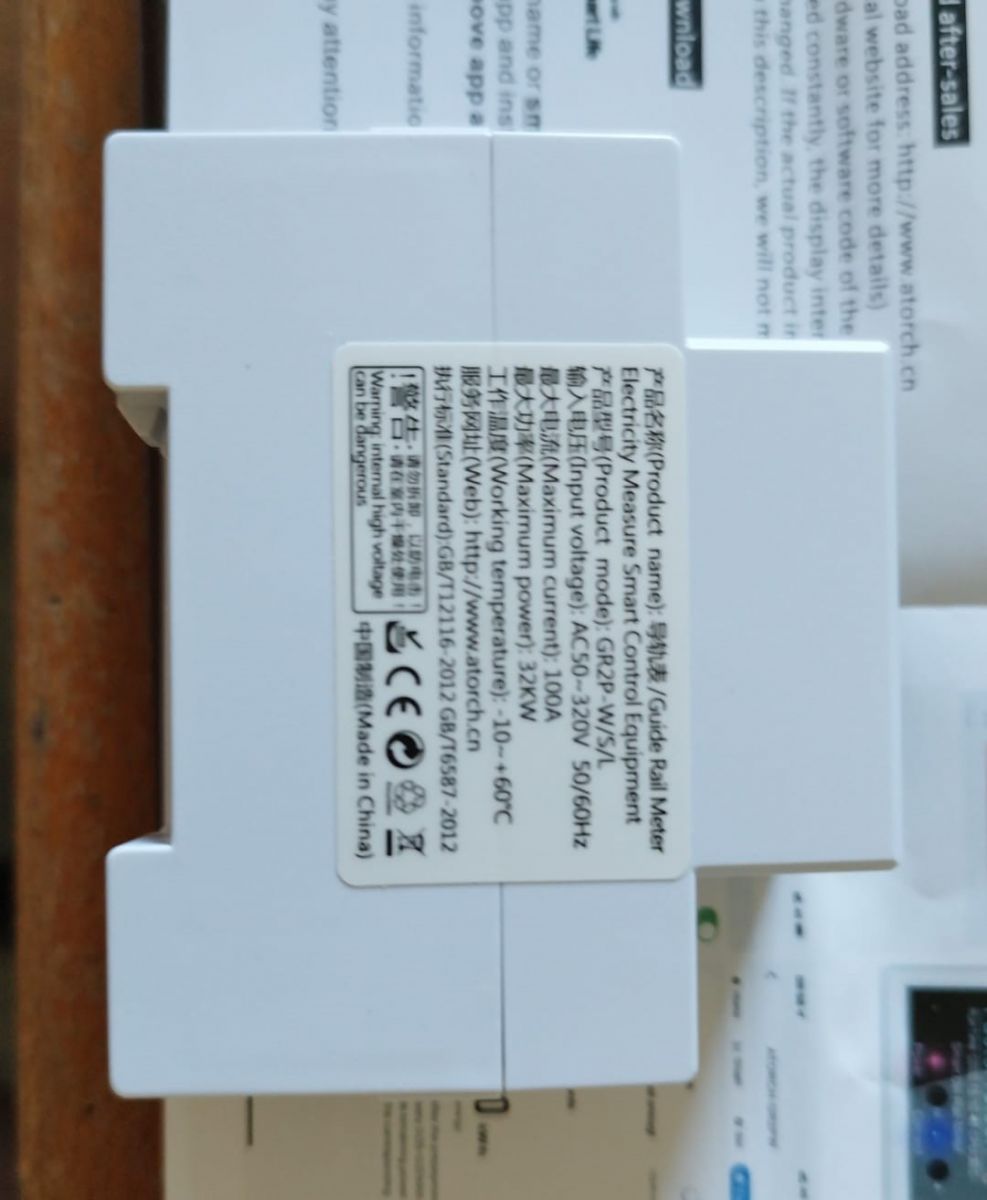

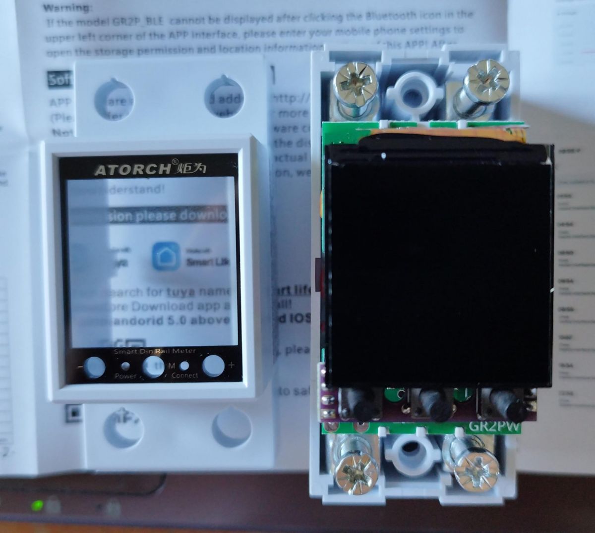

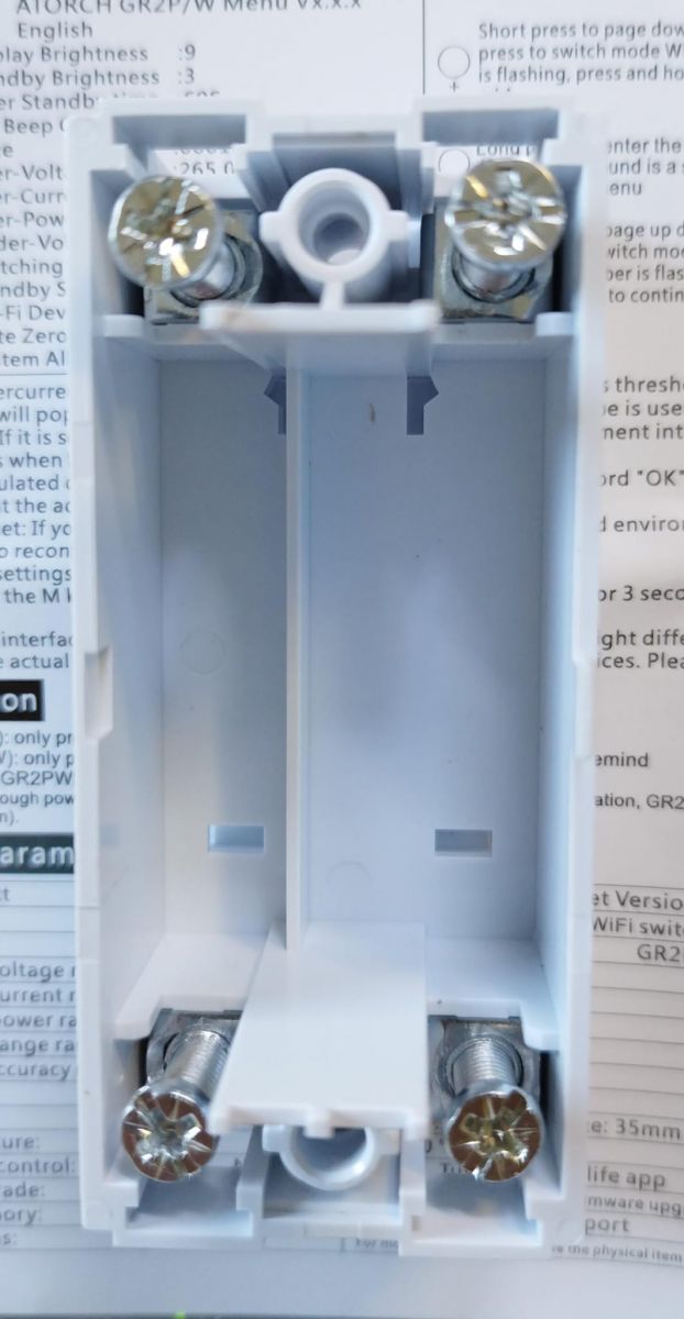

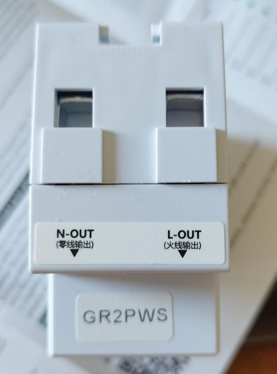

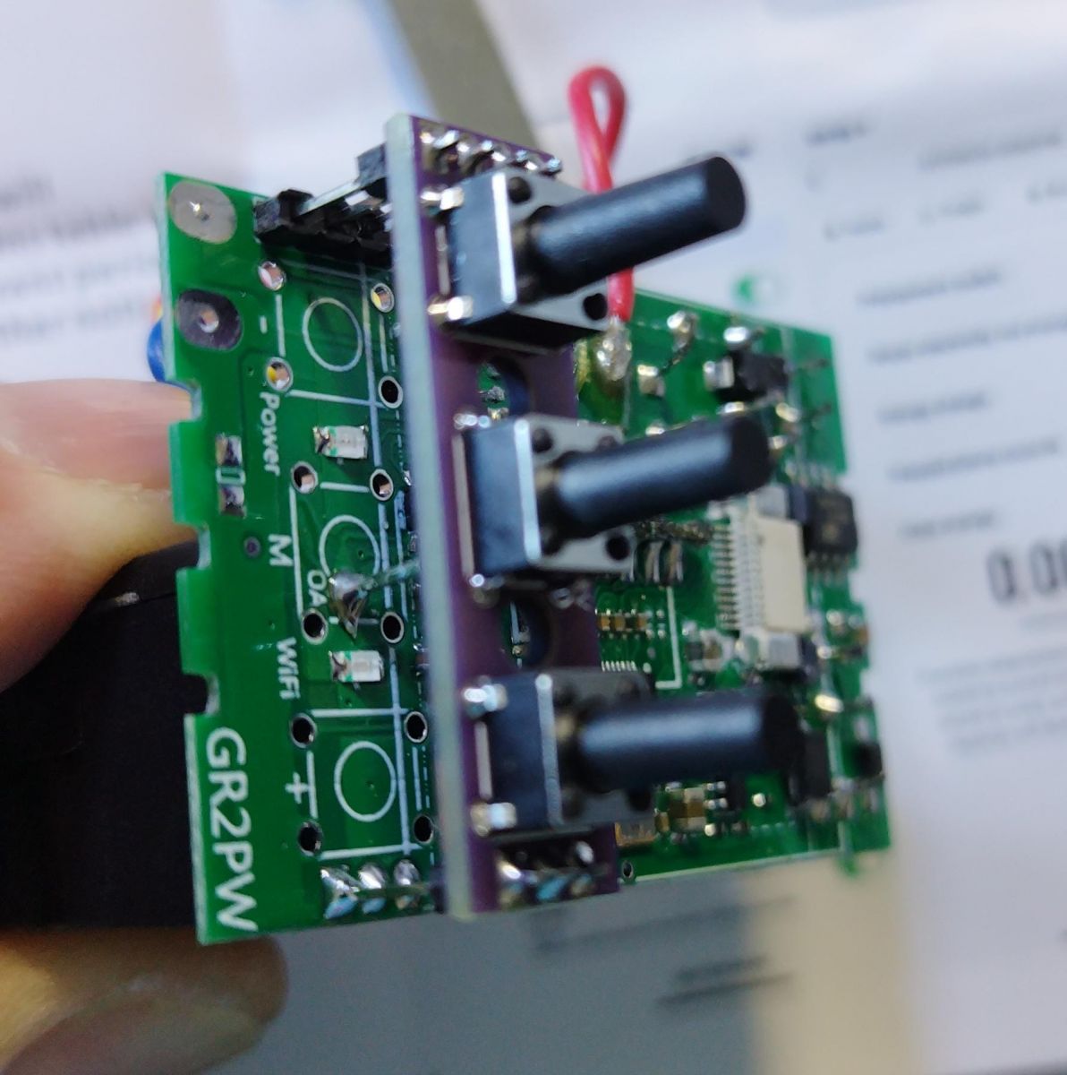

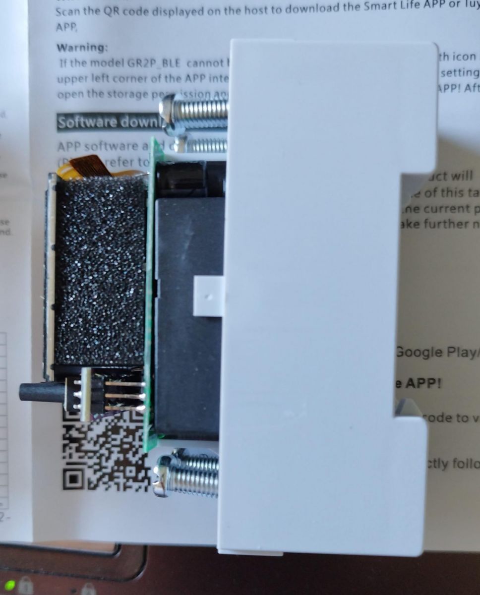

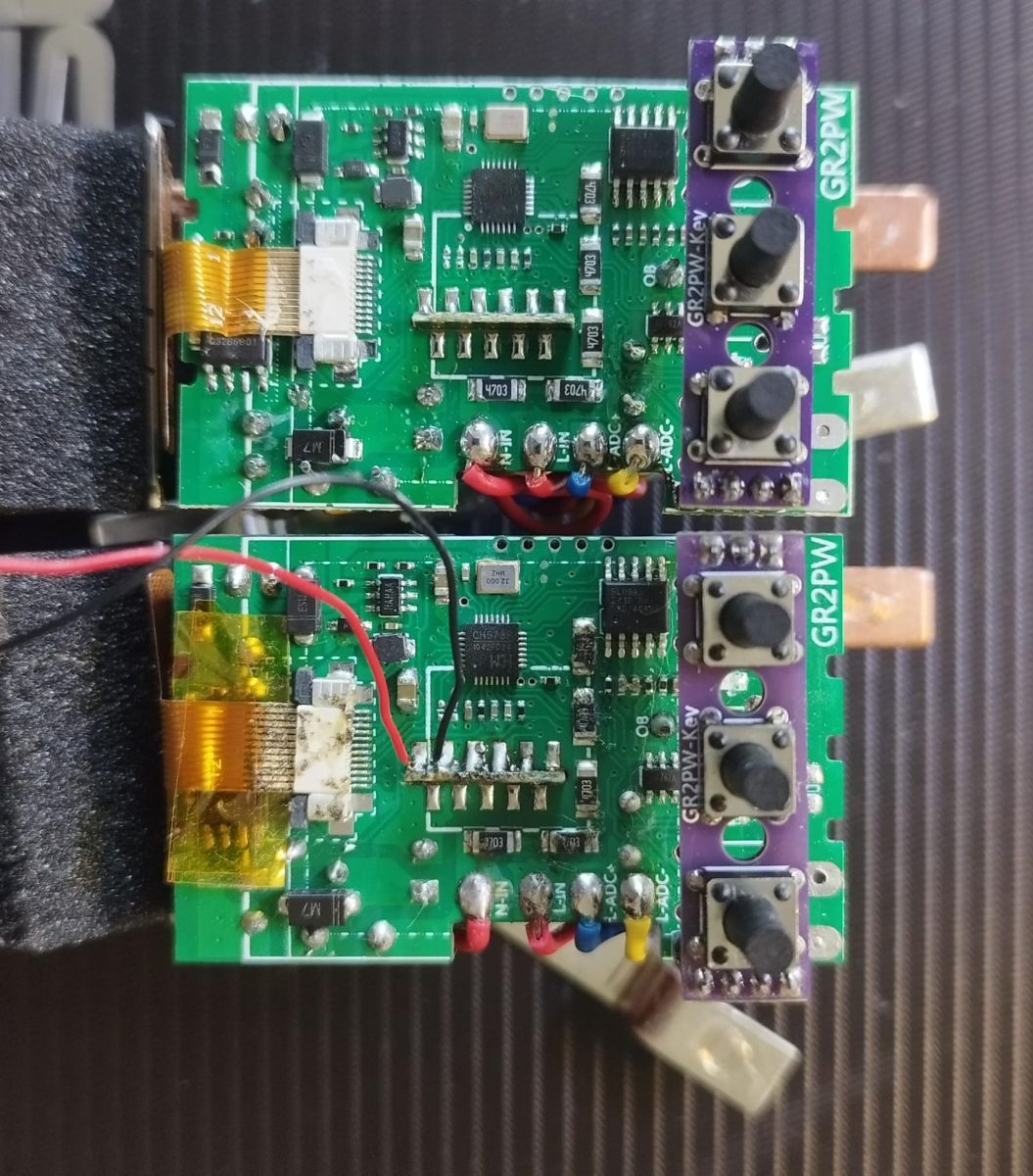

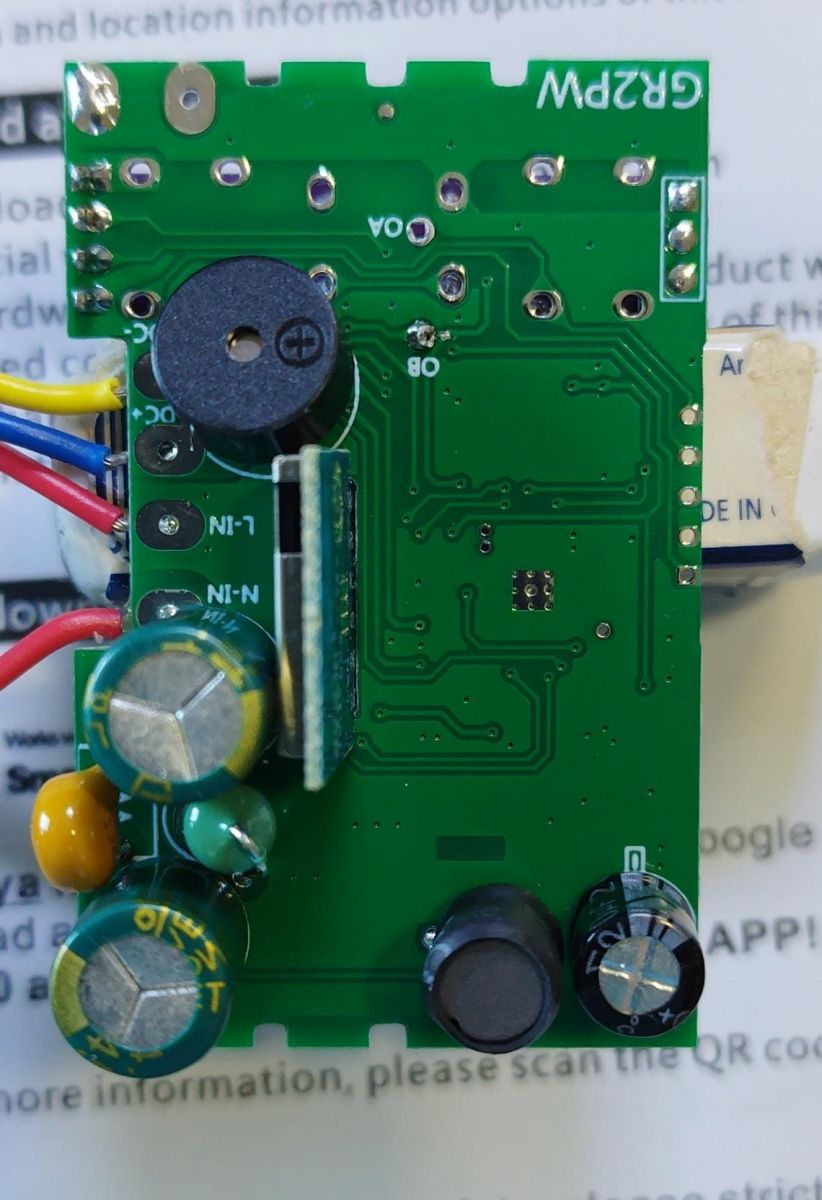

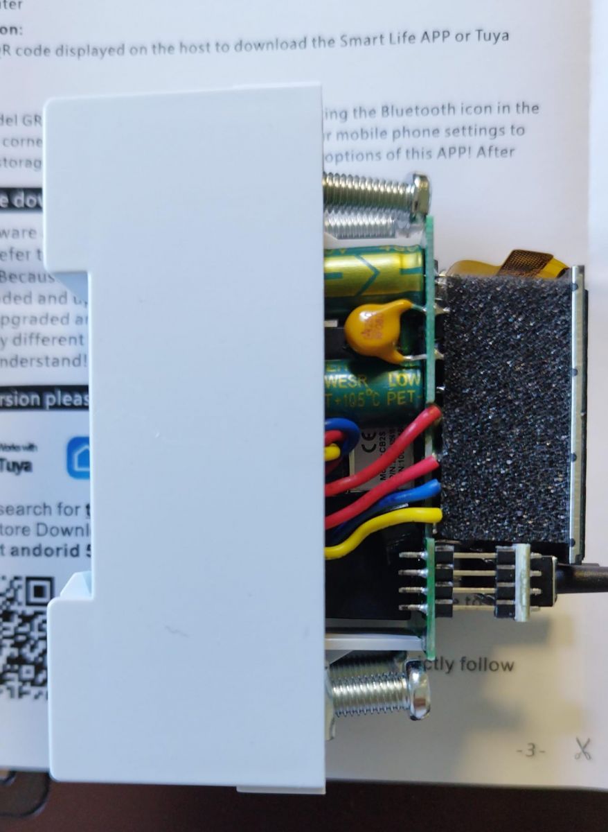

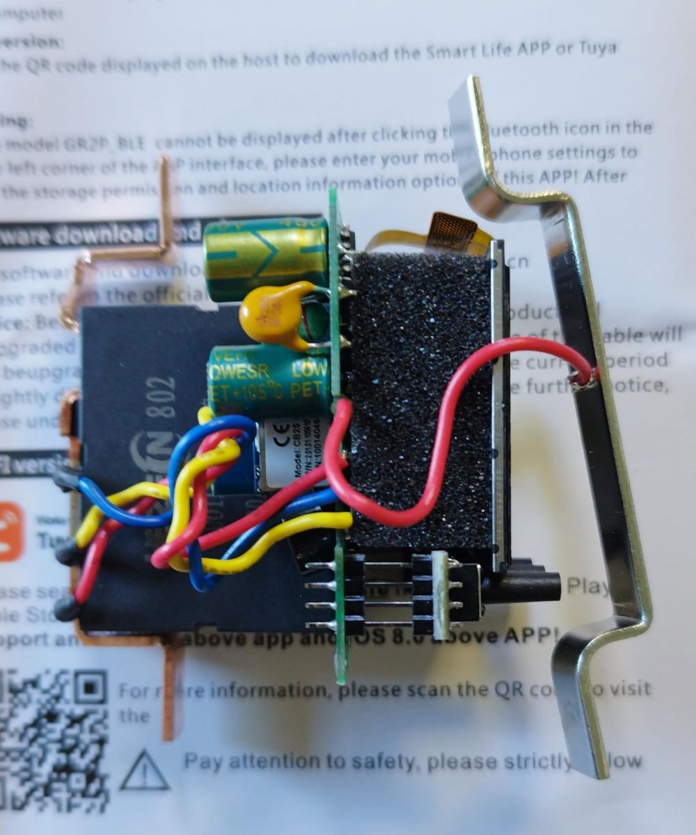

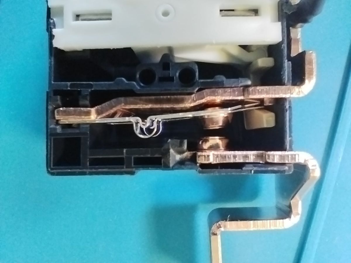

    Now, the teardown gallery:

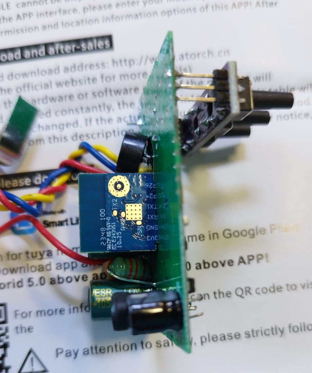

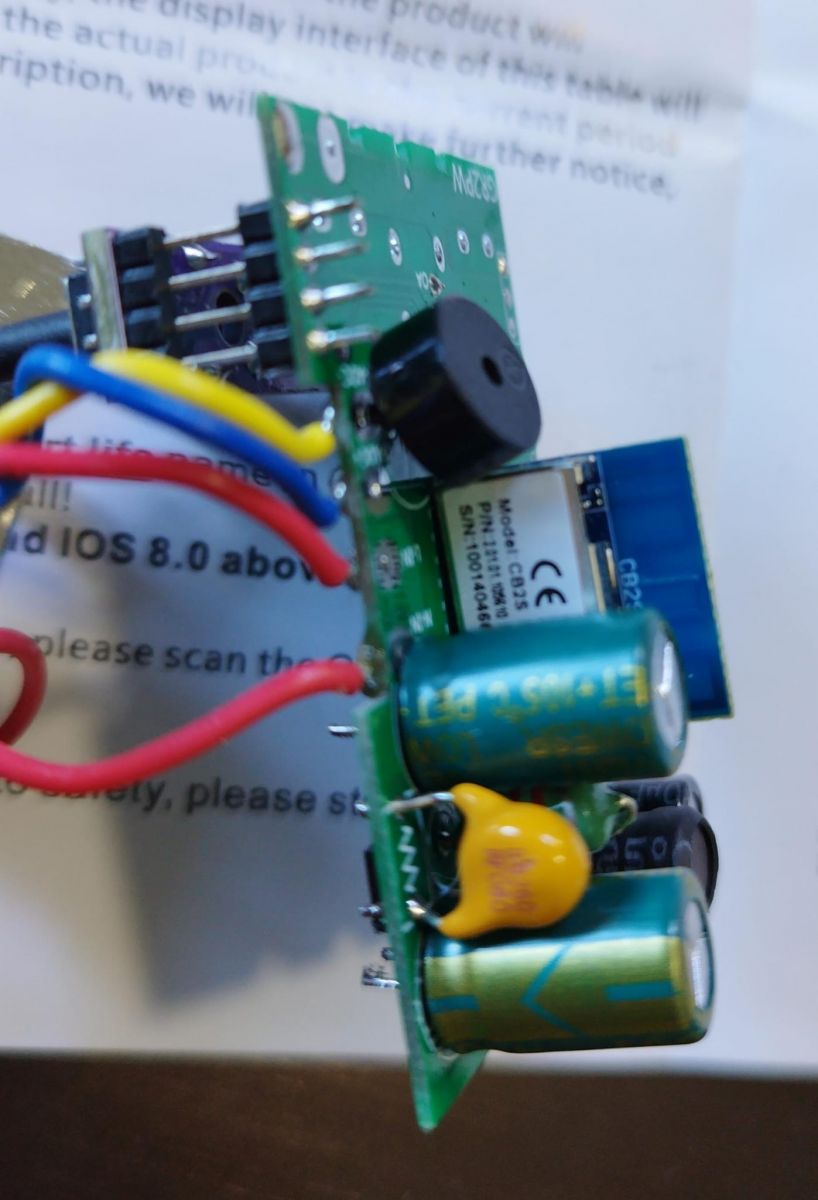

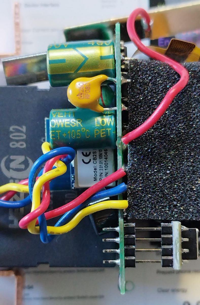

    View of the label on a rail-mounted measuring device. View of GR2PWS device with N-OUT and L-OUT labels. Photo of the front part of an electrical device with ports labeled N-IN and L-IN. Two energy meter modules with displays. Electronic board inside a device with visible wires and components. View of the inside of an electronic device with visible wires and components. Image of a part of an electronic device with visible internal components. Internal view of an electronic module with visible components and wiring. Close-up of the inside of an electronic device with colorful wires and capacitors visible. Close-up of a circuit board with buttons and various electronic components. HEZ 802 relay with 9V DC coil and marking 100A 250V AC against a manual. Close-up of an electronic module with visible components on a circuit board. Close-up of a GR2PW electronic device circuit board with three switches. Close-up of a circuit board with visible electronic components, including attached wires and a CH573F microcontroller. Circuit board with various electronic components. Electronic circuit board with mounted components and connected wires. View of the inside of a plastic enclosure with four mounted screw terminals. Rear view of the GR2PW device circuit board. Close-up of a circuit board with an attached ribbon cable labeled GMT154-01.

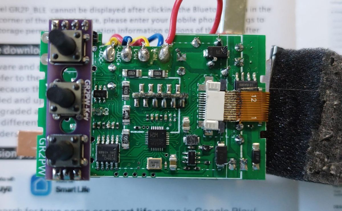

    As we can see, it uses the CB2S WiFi module (datasheet), which employs BK7231N chip, so it is possible to flash OpenBeken on it.

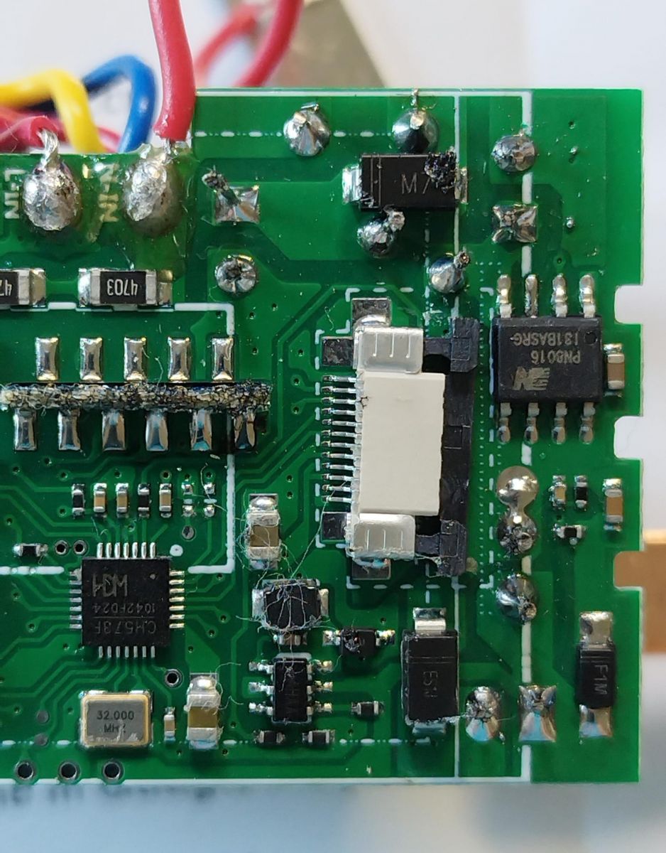

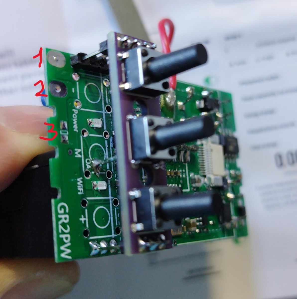

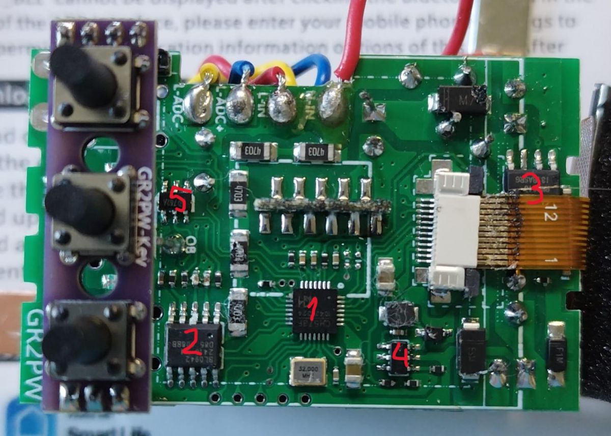

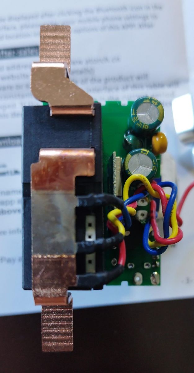

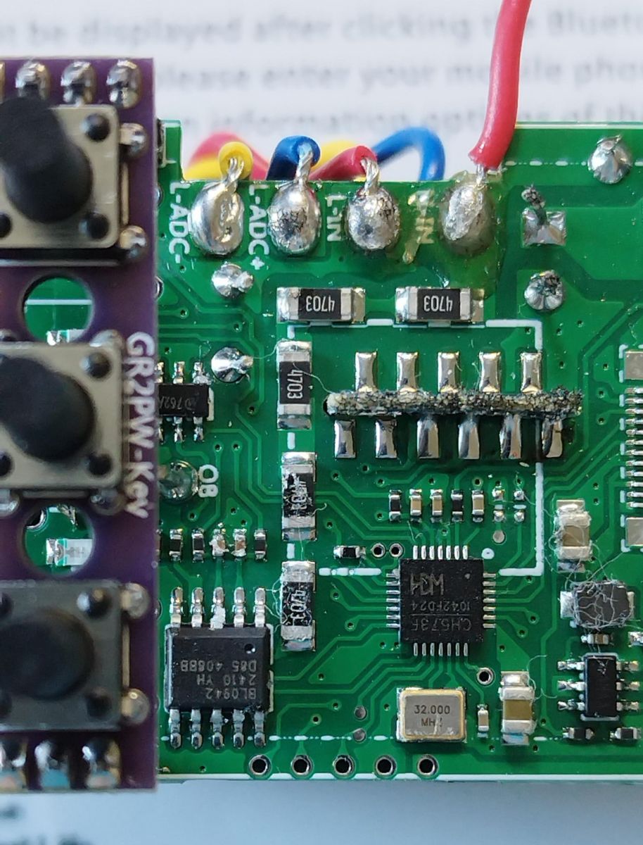

    As for the rest of main components, we can see them in the following image:
    Close-up of a circuit board with numbered components.
    "1" (CH573F) is the Tuya MCU.
    "2" (BL0942) is the AC metering chip
    "3" (PN8016) is an unisolated DC/DC switch mode converter, to get 9V (presumably, as this is the relay's coil voltage) from the rectified AC (measured 10.1V).
    "4" (marked HAHA A) is a switched mode regulator, to get (presumably) 3.3V (measured 3.23) from the previous 9V converter. This one feeds the Tuya MCU, the WiFi module, and the Power indicator LED. I couldn't find anything meaningful related to the markings but, from the peripheral components and connections could be similar to SY21031
    or RT6200
    "5" (marked 762A) is the bistable relay driver (Chinese datasheet)

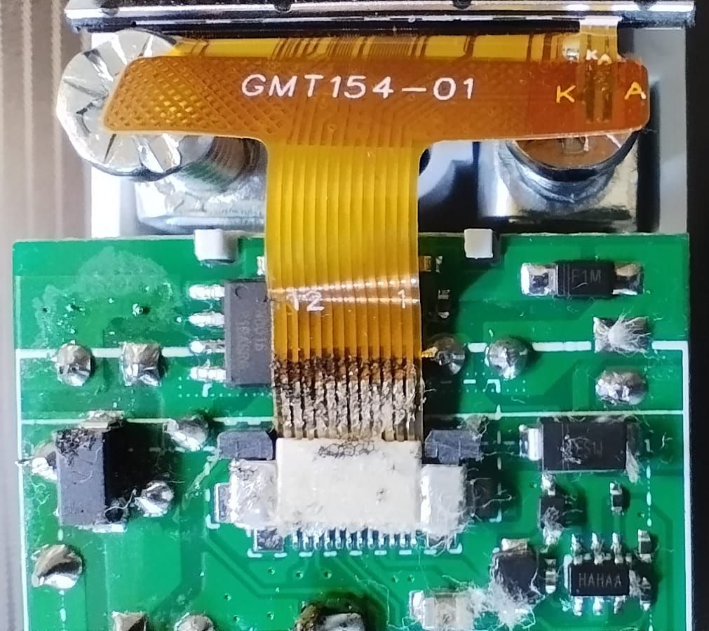

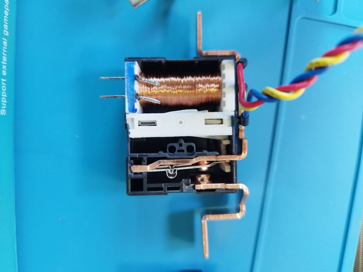

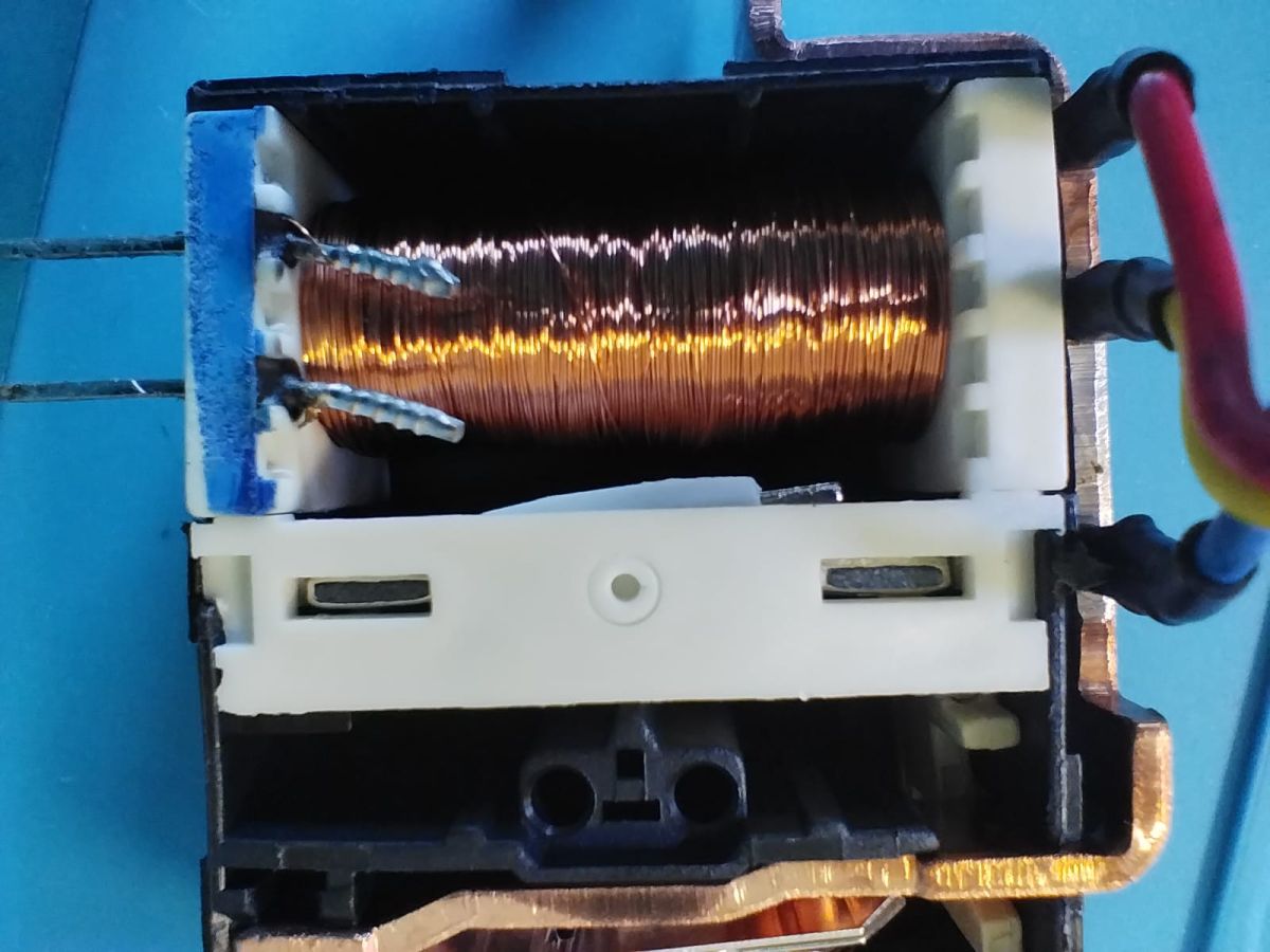

    Other main components are the relay and the TFT graphic screen (labeled GMT154-01, similar to this one).

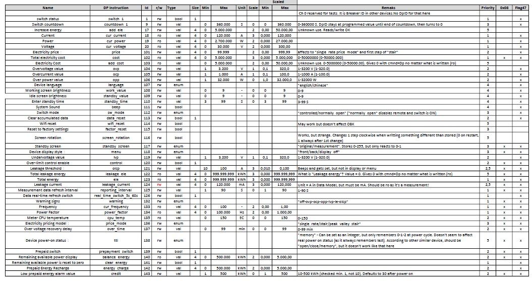

    Now, let's continue with the DpIDs identification. Following my tutorial, this is the result of "Query Things Data Model", once formatted and translated:
    That means a total of 44 DpID's!! Let's put them in a more legible format:
    Table of device parameters with description and specification.
    (also attached as pdf)
    After doing this with the original FW, we can now proceed to make a backup of it (attached) and then flash OBK. I tried first without isolating CB2S TX1 and RX1 signals from the main PCB, but got errors. I managed to isolate them without removing the module (just cleaning the solder bridge) and kept soldered Vcc and GND (CEN signal was already isolated). I have to say I had some problems trying to flash with bk7231flasher_1.3.3 (freezing at a certain point), so I finally did it with 1.1.6.
    With so many DpIDs, this is still "work in progress". I've found some of them don't seem to work. Others, supposedly read-write, behave as read-only, etc. But the autoexec.bat at this moment is the following:

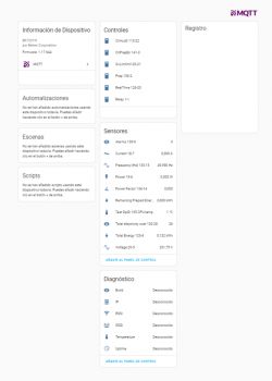

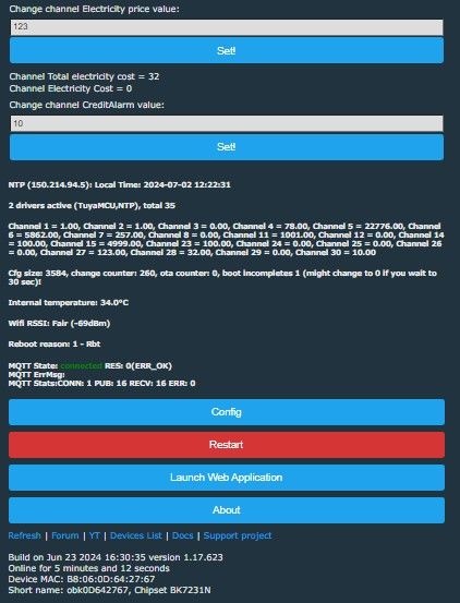

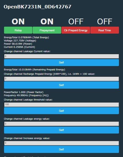

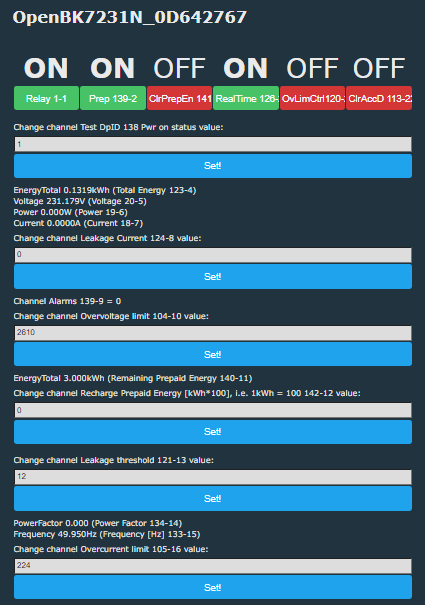

    These are screenshots of OBK's main screen and Home Assistant page for this device:
    Screenshot of the OpenBK7231N interface showing various indicators and control buttons. Screenshot of control panel showing configuration and parameters of a device using TuyaMCU. Screenshot of the user interface of an energy monitoring system.
    Everything seems to work fine (except for "strange" DpIDs) and I am able to properly command the relay, read network parameters, program values, etc.
    And this is all for now. As there aren't enough channels to map all 44 DpIDs, I've been using channel 30 to test other DpIDs but still have to decide which of them will be chosen for the final mapping (as I said before, some of them don't work and others don't seem to have a real function). I'll keep you informed of the results!https://www.elektroda.com/rtvforum/posting.php?mode=editpost&p=21142057#

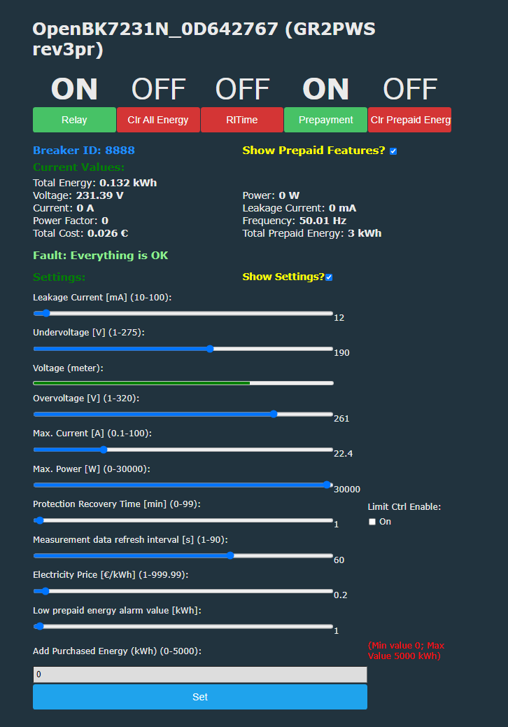

    EDIT (18/07/24): I´ve been making some progress with the device, and I think I'm almost at the point of considering the work finished ("almost" because you can always find something to add/improve when dealing with this things...). So, the changes are:
    1.- (almost) definitive autoexec.bat:
    Code: Javascript
    Also attached as GR2PWS_autoexec.bat_p.txt. I would recommend clearing all comments when copying to little FS to save space there.
    This is the aspect of OBK's main page:
    Screenshot of the OpenBK7231N interface for a device with BK7231N chipset Screenshot of a smart device user interface with channels and measurement values..
    (the labels in these screenshots do not correspond with the autoexec, as it's a debug version that includes channel numbers and DpIDs to facilitate debugging)

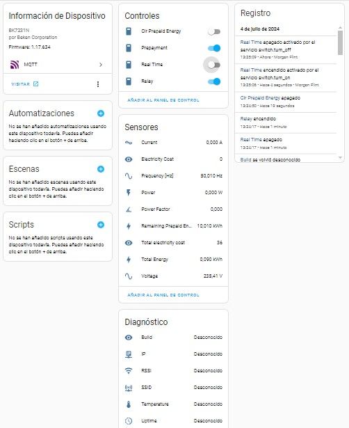

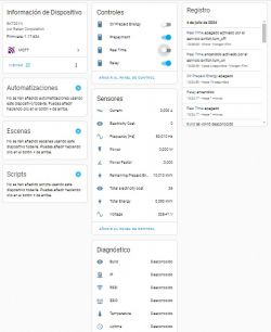

    And from Home Assistant's device page:
    Device information panel for BK7231N with various data sections.

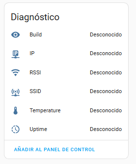

    BTW, @p.kaczmarek2 , in this page all the diagnostics sensors appear like "unknown", while in OBK's main page they have values. What could be the cause?
    Also, I see there's no channel type for currency... Do you think it would be interesting to add a "generic currency" channel type? (I understand adding it for all the main currencies would mean too many types).

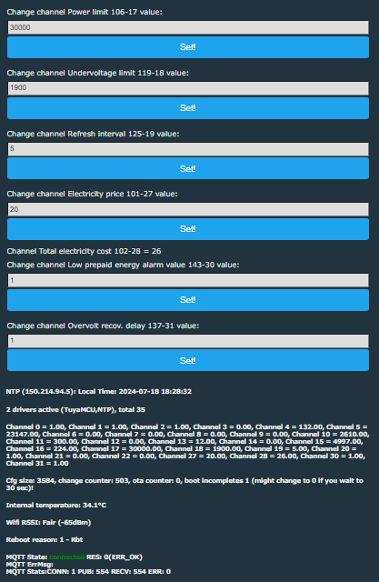

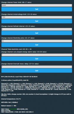

    2.- Custom web page, modified from @Angel0fDeath versions for the other devices cited before, attached as GR2PWS_rev3pr.html.txt. Heavily commented, so the original author can check/validate the mods, if he wants. I'd also clear all comments if loading it to little FS on the device, to avoid space problems.
    Here is the screenshot of this custom web page:
    OpenBK7231N user interface with device settings and data.
    One comment about this: The fault treatment in this device (DpID 132) is completely different than from the other two devices cited at the beginning, as in this one type is "enum", and in those it was "bitmap". The consequences are that in the other ones, several faults (overcurrent and overvoltage, for example) could be signaled at once, while in this device only one at a time, in the order of priority overvoltage-overcurrent-overpower-undervoltage-low prepaid energy-leakage" (if we have overcurrent and overvoltage, for example, it will show overvoltage and, once this disappears, then it'd show overcurrent, if still persisting).

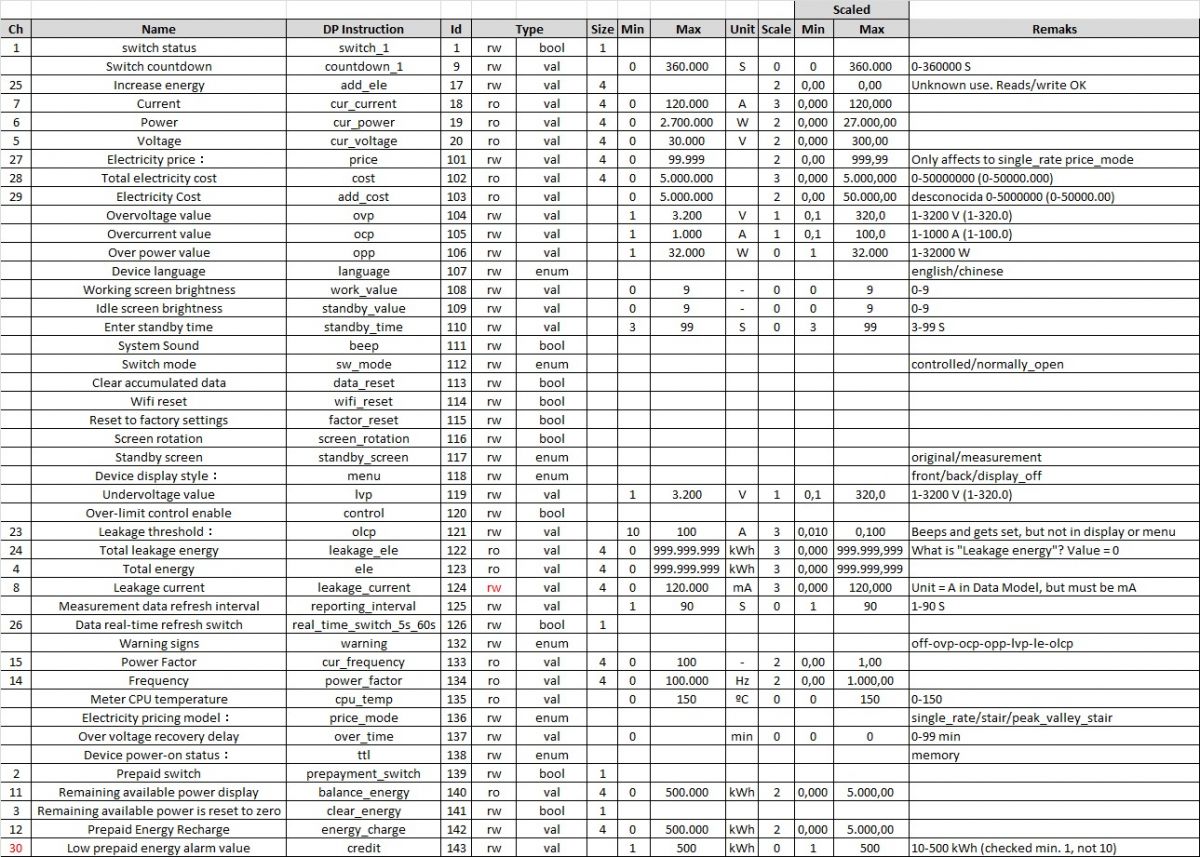

    3.- I've also updated the table of DpIDs with more info:
    Device parameter table with DpID identifiers and technical details.
    Also attached as .pdf (deleted previous one). If someone would like to have the original spreadsheet (.xlsx), just ask.
    I´ve left a good amount of DpIDs out from the .bat (and .HTML), as there are not enough channels in OBK to accommodate all of them, nor they're really needed for normal remote operation. Also, although the necessary hardware is not implemented, for now, I've left the DpI'd related to the leakage current, as I've seen in the PCB that there's space left for the associated components, and I may give a try to install them and check if the TuyaMCU's firmware is prepared to read leakage current. To use the device as is, comment out or delete these lines in the .bat and .html.

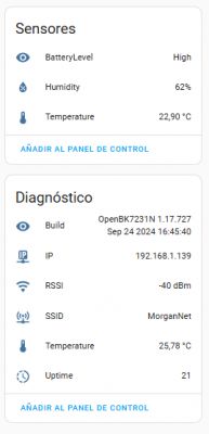

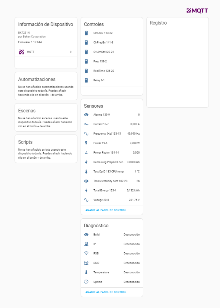

  • CPU temperature mapped; RSSI and device info still unknown
    #6 21286695
    sawadee2u
    >>21269095
    Ok, have my head on straight now, mostly...
    Have programmed four units and all report the following in home assistant:
    sensor.obk_87fb00029_current
    sensor.obk_87fb00029_voltage
    sensor.obk_87fb00029_power
    sensor.obk_87fb00029_total_energy
    sensor.obk_87fb00029_frequency_hz
    sensor.obk_87fb00029_power_factor
    sensor.obk_87fb00029_temperature (32.59 in "C" - would like this in "F") (***) see below
    sensor.obk_87fb00029_remaining_prepaid_energy
    sensor.obk_87fb00029_total_electricity_cost
    sensor.obk_87fb00029_alarms (0 currently)
    The following are listed in Home Assistant but reporting UNKNOWN:
    sensor.obk_87fb00029_build
    sensor.obk_87fb00029_ip
    sensor.obk_87fb00029_rssi
    sensor.obk_87fb00029_ssid
    sensor.obk_87fb00029_uptime
    CPU Temperature was not reporting at all so I followed your format in the Autoexec.bat and got it reporting:
    // Total cpu Temperature - id 135 "ele" -> Ch 23 (ro)
    linkTuyaMCUOutputToChannel 135 val 23
    setChannelType 23 Temperature_div100
    setChannelLabel 23 "CPU Temperature"
    Would like to see RSSI and the other payloads working but just don't know enough to do so.
    RSSI, IP, SSID and others are reported as UNKNOWN on a new unit prior to entering the autoexec.bat. While the data that is reported after the autoexec.bat is entered do not show at all prior to doing so. So assume they require a different method that I don't understand.
    So that is as far as I have been able to progress to date. If you could point me to anything I have missed, I would appreciate it.
    Thanks

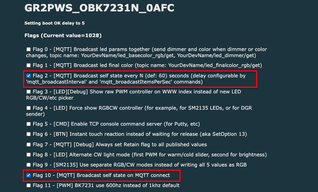

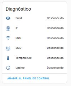

  • Internal sensors missing from OBK sensor page
    #7 21286845
    morgan_flint
    Posts: 251
    Rate: 63

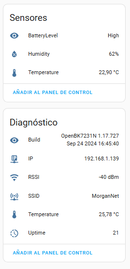

    I'm having the same problem with OBK "internal" sensors (see the first attached image), although the values show up on OBK's main web page (second image). This also happens to me with some other devices, but it works well on another one. Maybe @p.kaczmarek2 can tell us what we're doing wrong.
    Screenshot showing a device diagnostic panel with values labeled as Desconocido. Display showing information about internal temperature sensors, Wi-Fi signal strength, and reboot reason.
    This is a device where that's working well:
    Screenshot showing device sensor and diagnostic information with data on battery level, humidity, temperature, and Wi-Fi network.

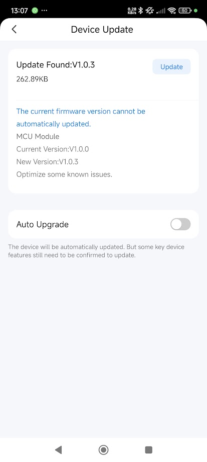

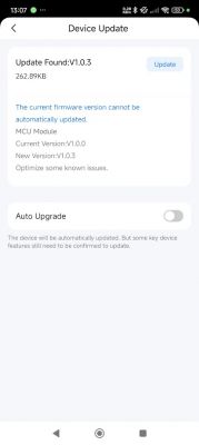

    here's the MCU binary downloaded when accepting the 1.0.3 update offered by the Tuya app for this device
    Device software update screen with information about the new version 1.0.3.
    • Atorch_GR2P-WS_MCU_1.0.3.bin (262.89 KB) You must be logged in to download this attachment.

    >>21295352
    Thanks!
    How can you install it in the MCU if you have flashed OBK?
  • #10 21295750
    Posts: 5195
    Help: 446
    Rate: 913
    That I do not know. Not yet anyway.

    >>21296793 Thanks for adding it, I don't have very clear the procedure to do that
    >>21295750 I Imagine I can flash the Tuya FW back from the backup, update the MCU FW from there and then go back to OBK, but it'd be good to have a simpler way, preferably OTA
  • #13 21302093
    Posts: 5195
    Help: 446
    Rate: 913
    indeed. who knows if the changes in these MCU updates warrant the effort though.

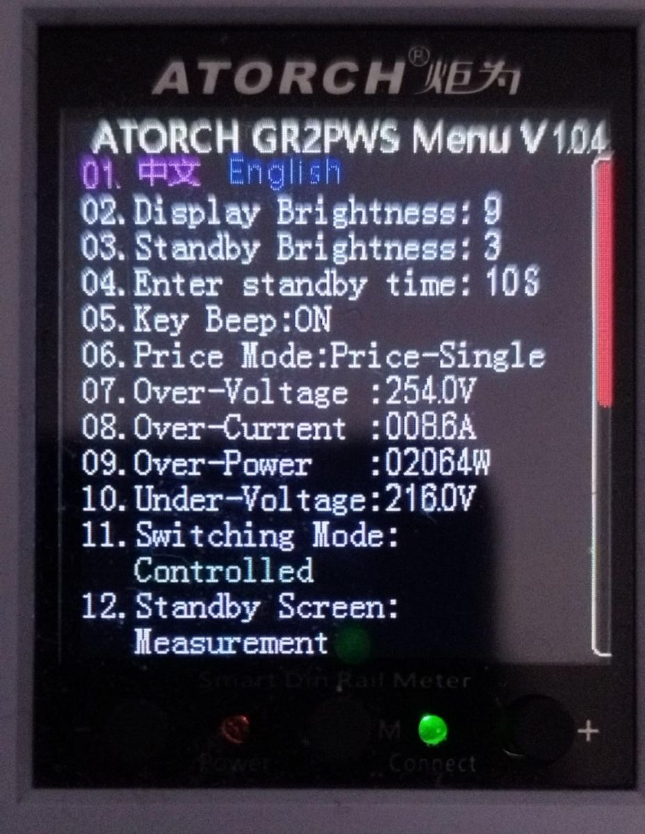

    BTW, I just checked in mine and FW version seems to be 1.0.4:
    Display of the ATORCH GR2PWS device with version 1.0.4 settings menu.
  • OBK flash works with MCU firmware 1.0.4
    #15 21373484
    agaletski
    Hi.
    I have two of those devices. I'm happy to find this discussion and people were able to reflash and manage this device directly from HA.
    I want to reflash my device too and have question about MCU FW 1.0.4 I saw my device was also updated to 1.0.4 from Tuya. Is it causes any issues working with OBK flashed module? Is it possible to reflash MCU back to 1.0.3? How to do this ?
    Answer to my question above -^. )
    Flashed my device (MCU FW 1.0.4) with latest OpenBK7231N 1.17.822, and configured (using provided autoexec.bat, without comments) as described above.
    Everything works better than expected. ) Someone asked about buttons and screen function after reflash.
    It does work without changes as it is managed by tuya MCU which remains unchanged.
    Only communication module is reflashed to OBK firmware.
    Thank you guys!
    This is my second device which have been cut from tuya cloud.
  • Enable OBK diagnostic MQTT state reports
    #16 21375420
    agaletski
    I have found how to activate the Diagnostic data (actual RSSI, IP, SSID and others ) are reported to HA via MOTT topics. (mentioned in earlier messages)
    We can just enable those states report in Flags section of OBK config web page.
    "flags 0 " directive in autoexec.bat clears all flags on boot, so I believe it is better to remove it.
    Screenshot of settings showing MQTT flags in the GR2PWS_OBK7231N_0AFC device configuration.

  • Modified autoexec.bat with SSDP and timer support
    #21 21451899
    misharexsezan
    Hello everyone, this is a modified autoexec.bat file with SSDP and Timer added. If anyone needs explanation, let me know. I'll attach comments
    clearIO
    flags 0
    SetFlag 43 1
    SetFlag 46 1
    SetFlag 39 0
    SetFlag 25 1
    startDriver TuyaMCU
    tuyaMcu_defWiFiState 4
    startDriver NTP
    ntp_setServer 150.214.94.5
    ntp_timeZoneOfs 6
    startDriver SSDP
    startDriver Wemo
    setChannelType 1 toggle
    setChannelLabel 1 "Relay"
    linkTuyaMCUOutputToChannel 139 bool 2
    setChannelType 2 toggle
    setChannelLabel 2 "Prepayment"
    linkTuyaMCUOutputToChannel 126 bool 3
    setChannelType 3 toggle
    setChannelLabel 3 "Real Time"
    linkTuyaMCUOutputToChannel 120 bool 4
    setChannelType 4 Toggle
    setChannelLabel 4 "Over-limit ctrl"
    linkTuyaMCUOutputToChannel 20 val 5
    setChannelType 5 Voltage_div100
    linkTuyaMCUOutputToChannel 18 val 6
    setChannelType 6 Current_div1000
    linkTuyaMCUOutputToChannel 19 val 7
    setChannelType 7 Power_div100
    linkTuyaMCUOutputToChannel 134 val 8
    setChannelType 8 PowerFactor_div100
    linkTuyaMCUOutputToChannel 133 val 9
    setChannelType 9 Frequency_div100
    linkTuyaMCUOutputToChannel 123 val 10
    setChannelType 10 EnergyTotal_kWh_div1000
    linkTuyaMCUOutputToChannel 102 val 11
    setChannelType 11 ReadOnly
    setChannelLabel 11 "Total electricity cost"
    linkTuyaMCUOutputToChannel 140 val 12
    setChannelType 12 EnergyTotal_kWh_div100
    setChannelLabel 12 "Remaining Prepaid Energy"
    linkTuyaMCUOutputToChannel 132 val 13
    setChannelType 13 Readonly
    setChannelLabel 13 "<br><br>Alarms"
    linkTuyaMCUOutputToChannel 104 val 14
    setChannelType 14 TextField
    setChannelLabel 14 "Overvoltage limit"
    linkTuyaMCUOutputToChannel 105 val 15
    setChannelType 15 TextField
    setChannelLabel 15 "Overcurrent limit"
    linkTuyaMCUOutputToChannel 106 val 16
    setChannelType 16 TextField
    setChannelLabel 16 "Power limit"
    linkTuyaMCUOutputToChannel 119 val 17
    setChannelType 17 TextField
    setChannelLabel 17 "Undervoltage limit"
    linkTuyaMCUOutputToChannel 143 val 18
    setChannelType 18 TextField
    setChannelLabel 18 "Low prepaid energy alarm"
    linkTuyaMCUOutputToChannel 137 val 19
    setChannelType 19 TextField
    setChannelLabel 19 "Overvolt recov. delay"
    linkTuyaMCUOutputToChannel 125 val 20
    setChannelType 20 TextField
    setChannelLabel 20 "Refresh interval"
    addRepeatingEvent 5 1 setChannel 20 1
    linkTuyaMCUOutputToChannel 101 val 21
    setChannelType 21 TextField
    setChannelLabel 21 "Electricity price"
    linkTuyaMCUOutputToChannel 142 val 22
    setChannelType 22 TextField
    setChannelLabel 22 "Recharge Prepaid Energy[kWh*100],1kWh=100"
    startDriver httpButtons
    linkTuyaMCUOutputToChannel 141 bool 23
    setButtonEnabled 0 1
    setButtonLabel 0 "Clr Prepaid Energy"
    setButtonCommand 0 "setChannel 23 1"
    linkTuyaMCUOutputToChannel 113 bool 24
    setButtonEnabled 1 1
    setButtonLabel 1 "Clear acc. data"
    setButtonCommand 1 "setChannel 24 1"
    setChannelLabel 32  "<b style='color:orange'>Time left</b>"
    setChannelType 32 TimerSeconds
    addChangeHandler Channel1 == 0 setChannel 32 0
    setButtonEnabled 2 1
    setButtonLabel 2 "Timer 1H"
    setButtonCommand 2 "setChannel 32 3600"
    setButtonEnabled 3 1
    setButtonLabel 3 "Timer 30M"
    setButtonCommand 3 "setChannel 32 1800"
    setButtonColor 3 "green"
    setButtonEnabled 4 1
    setButtonLabel 4 "Timer 30S"
    setButtonCommand 4 "setChannel 32 30"
    setButtonColor 4 "green"
    setButtonEnabled 5 1
    setButtonLabel 5 "Timer +30S"
    setButtonCommand 5 "addChannel 32 30"
    setButtonColor 5 "#f89705"
    setButtonEnabled 6 1
    setButtonLabel 6 "Stop Timer"
    setButtonCommand 6 "setChannel 32 0"
    setButtonColor 6 "red"
    setChannelLabel 33  "<b style='color:orange'>Set timer[s]</b>"
    setChannelType 33 TextField
    addEventHandler OnChannelChange 33 if $CH32!=$CH33 then setChannel 32 $CH33
    addEventHandler OnChannelChange 32 if $CH32!=$CH33 then setChannel 33 $CH32
    alias addTimer backlog POWER ON;addRepeatingEventID 1 -1 9 addChannel 32 -1 0 999999;setChannel 34 1
    addChangeHandler Channel32 == 0 if $CH34==1 then backlog POWER OFF;cancelRepeatingEvent 9;setChannel 34 0
    addChangeHandler Channel32 > 0 if $CH34==0 then addTimer
    addRepeatingEvent 6 1 tuyaMcu_sendQueryState
    loglevel 0

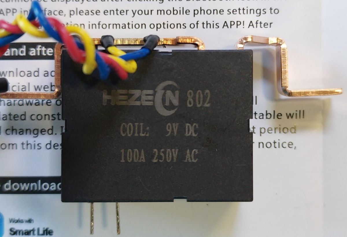

    Adding pictures of the internals of the relay:
    Electromagnet with visible copper coil on a blue background.
    Interior of an electrical switch with visible metal components on a blue surface.
    Close-up of a solenoid coil with copper wire in a plastic casing.
    These pictures are for user @rufus4, who is asking about this kind of relay in another thread but as the images belong to the device of this thread, I think it's better to post them here.
    EDIT: the red, blue, and green braided cables at the top of the relay are connected to the current measuring shunt (yellow and blue), and to the input voltage (red), as the shunt is integrated on one of the relay's terminals. You can see it better in the 9th photo of the first post of this thread.
    EDIT2: Adding the datasheet for the relay's driver IC, already linked in the first post, but Google-translated into English:
    • 2011252110_Shanghai-Mingda-Microelectronics-MD7620A_C920529 (Eng).pdf (887.34 KB) You must be logged in to download this attachment.
  • Suspected GR2PWSL hardware differences and MCU update issue
    #23 21563984
    morgan_flint
    Posts: 251
    Rate: 63
    >>21424743
    Hello again to all.
    I recently purchased another GR2PWS, and I've found that it has newer versions for both the main module and the MCU, as well as the previous one (which I had flashed with OBK).
    So, I decided to reflash the first one with the backup I had saved before flashing OBK to see if I could update its MCU firmware with the newer version from the Tuya App.
    But, to my surprise, when I get to the corresponding screen in the App, it shows "No updates available"...
    The next screenshots belong to that screen for the older and newer ones:
    A screenshot from an IoT device management app showing no firmware updates available for the main and MCU modules. App screen showing no updates available for the device, with Main Module v3.1.17 and MCU v1.0.6 versions.
    @divadiow or @crg1darkspr1te:
    Do you know if there's a way to force the update from the Tuya App, or another method to do it?
    I also see in your post and repository that there's already a 1.0.9 version for AT4P, very similar to GR2WS. I imagine newer GR2P should come with this one (or a newer one)
    With that in mind, and also wanting to inspect the HW differences with GR2PWS, I have ordered (and am waiting for its arrival) a GR2PWSL (with external leakage current transformer). In the advertisement, some pictures of the device's screen are different from my devices, or even don't exist in them, but are similar to those in AT4P advertisements. So I'm also curious to check the FW version in this new acquisition. In one of the ad's screenshots it says "BengFang Sys Settings 2.0.1":

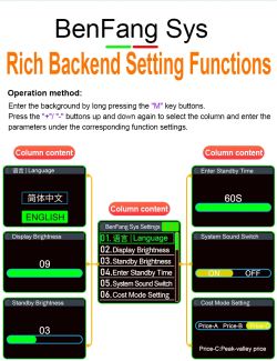

    BenFang Sys system settings screen with setting descriptions and example menu screens in English and Chinese.

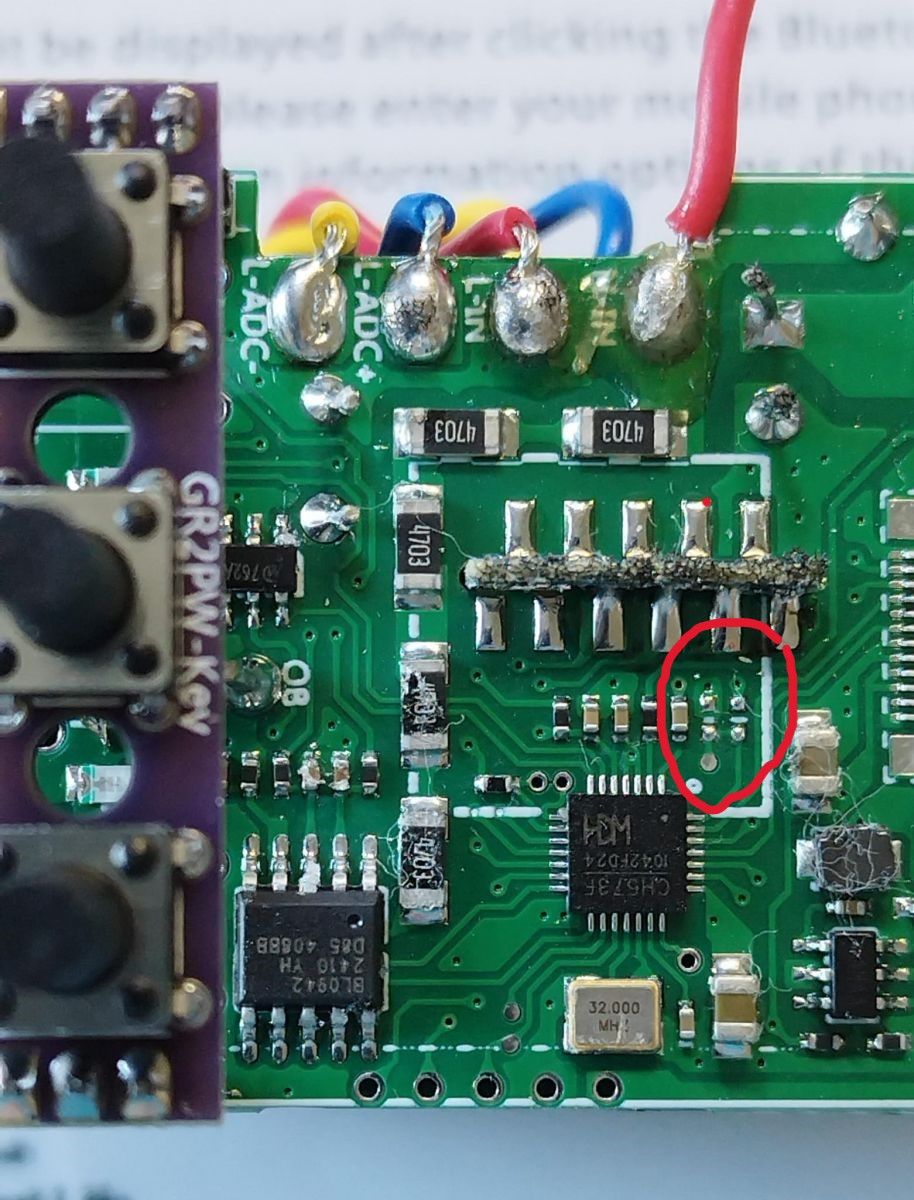

    EDIT: Regarding the differences between GR2PWS and GR2PWSL, I suspect they are limited to the missing components shown in the following photos:
    Close-up of a GR2PWS circuit board with missing components highlighted, visible buttons, and wire labels.
    Close-up of a GR2PW circuit board with three red-labeled points marked 1, 2, 3 on the edge.
    The toroidal residual current transformer would be connected to pads 1 and 2. Pad 1 is connected to GND, and the missing component in 3 (probably a shunt resistor) is connected between 1 and 2. The missing components circled in the other photo are probably a capacitor to GND and a resistor between pad 2 and pin 28 of the MCU, which would be configured as an analog input for residual current measurement:
    Hand-drawn simple electrical diagram showing two pads connected via a shunt resistor, capacitor, and resistor to MCU pin 21.
    My doubt is how this arrangement gets rid of the negative half-wave. Maybe there's a diode instead of a capacitor, but I'll check that when my recent purchase arrives and post here
  • Clarifying Tuya OTA update and firmware dump
    #24 21565241
    Posts: 5195
    Help: 446
    Rate: 913
    I have never explored trying. There must be a reason it's not offering an update though? Maybe your new variation has a different schema ID and the different OTA MCU update offering is tied to that.
    If you really wanted to you could work out how to dump the entire flash of the CH573F from the 1.06 device and flash to the other. I wonder. I do have CH573F somewhere.
    Do you have a main fw dump of your newer device?
  • CH573F USB programming pins identified for firmware dump
    #25 21565668
    morgan_flint
    Posts: 251
    Rate: 63
    >>21565241
    I haven't still opened it, but will do and compare hardwares.
    I'll also make a backup of the WiFi module's FW, but I don't know how to dump the flash of the MCU. I have tools for Atmel (USBASP) and STM32 (STLink), and also an EEPROM programmer based upon CH341; I don't kow if any of these is aplicable to CH573 MCU...
    Added after 7 [hours] 15 [minutes]:
    Here are both devices, new and old, side by side; they seem to be exactly the same:
    Two identical electronic modules, one above the other, showing PCBs, buttons, and colored wires.
    I've traced the connections of the 5 pin port at the upper side of the board. From left to right:
    1- Vcc, connected to the input of the 3.3V regulator, which is the output of the PN8016 DC/DC switch mode converter, to get 9V for the relay (as I said in the first post)
    2- GND
    3- CH573F pin 17 (Boot?) Also connected to one of the copper pads that can be seen below it. The other one is connected to pin 16
    4- CH573F pin 13 (UD-)
    5- CH573F pin 12 (UD+)
    According to the schematics in this page, pins 12, 13, 16, and 17 of CH573F are used for USB programming, so I think it would be possible to read the FW using the tools here.
    Finally, I've also made a backup of the CB2S module's FW (attached)
    • readResult_BK7231N_QIO_GR2PWS_2_reset_NoVcc_2025-31-5-19-26-07.bin (2 MB) You must be logged in to download this attachment.

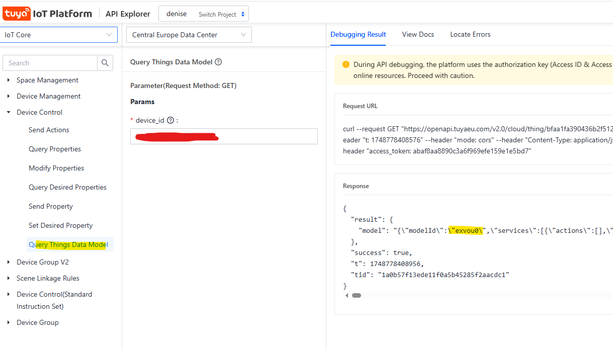

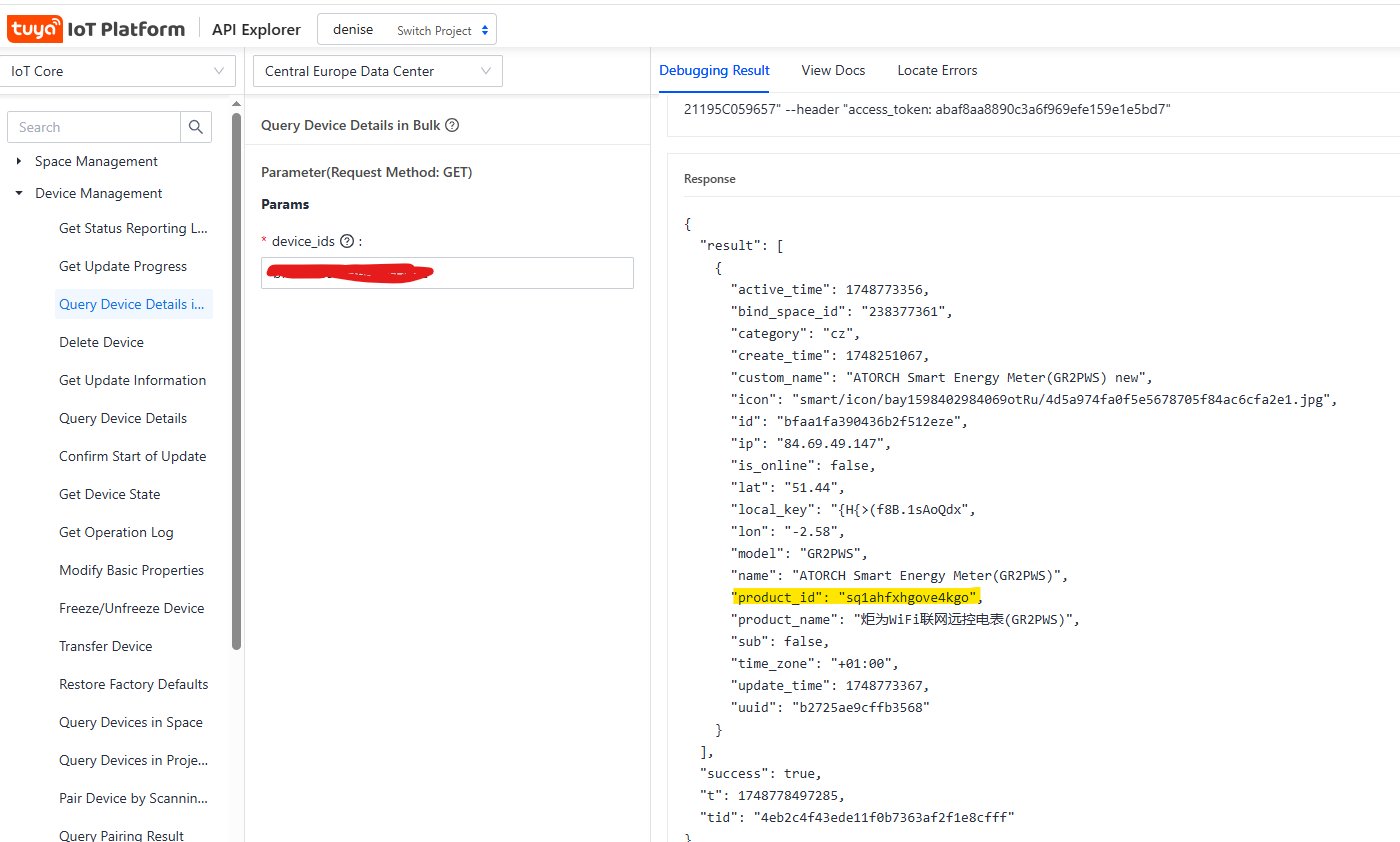

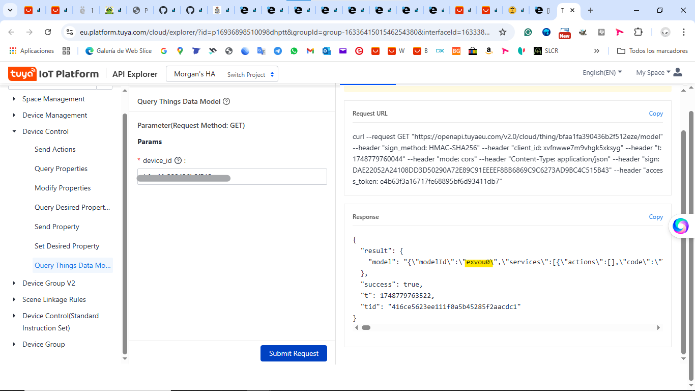

    Help: 446
    Rate: 913

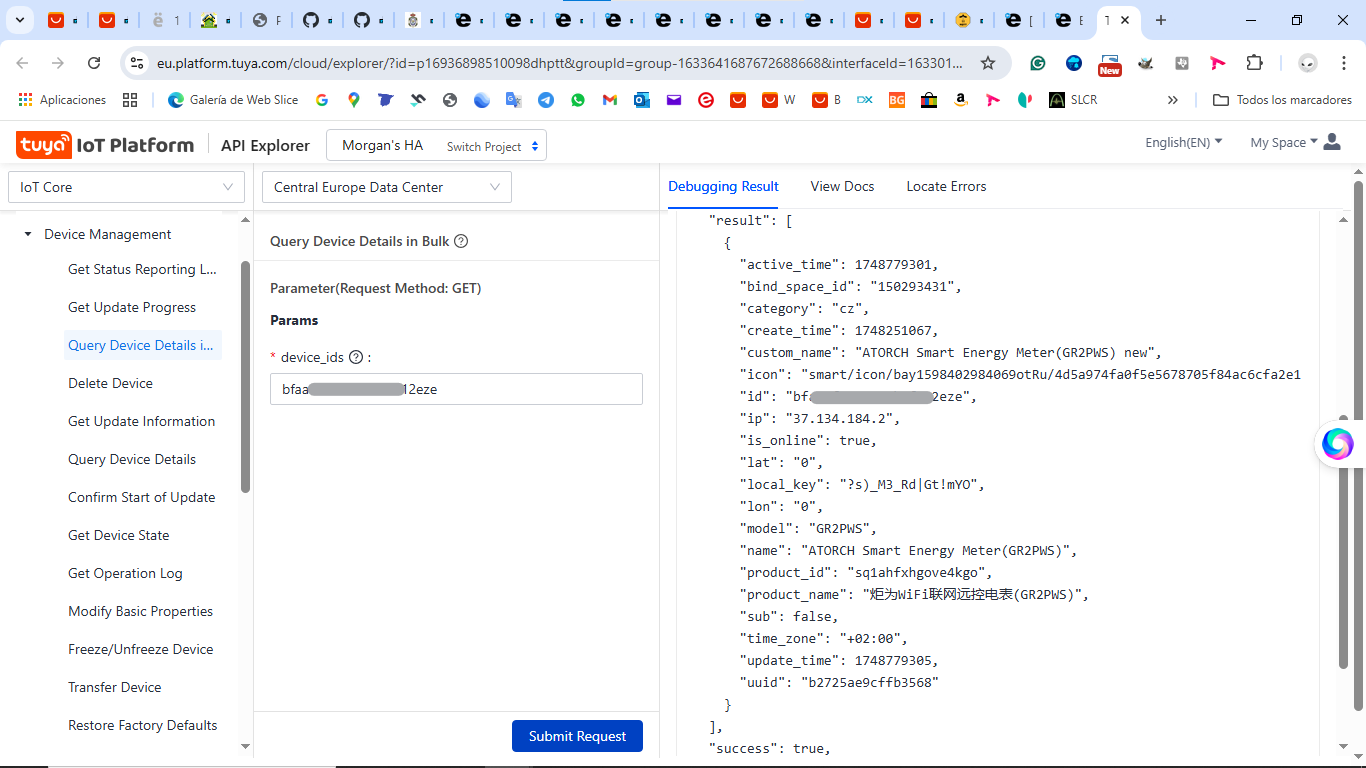

    ah, well if you've already seen it in Tuya dev then the pid will be in there
    Screenshot from Tuya IoT Platform showing device details, with the product_id highlighted in yellow.
    unless it's all changed and it's not done like that with new Tuya
    the device schema can also be looked up here
    Screenshot of Tuya IoT Platform API interface with Query Things Data Model highlighted and response showing modelId field with value exvou0 highlighted.
  • #29 21566612
    morgan_flint
    Posts: 251
    Rate: 63
    >>21566588
    It seems like the same ID:
    Screenshot of the API Explorer in Tuya IoT Platform showing a device query request and detailed JSON result for a smart energy meter.
    Screenshot of Tuya IoT Platform API Explorer panel showing device model query details and JSON response with highlighted model exvou08.
    Do you want me to record the boot logs for anything else?
  • #30 21566618
    Posts: 5195
    Help: 446
    Rate: 913
    ah ok. interesting. dunno then really. maybe something new in the main 3.1.17 fw that means MCU also requires different firmware? I'm going to interrogate my CH573 soon in Atorch S1

How can I make an Atorch GR2P-WS show up correctly in Home Assistant over MQTT, including sensors like current, voltage, power, and total energy?
Configure MQTT in OpenBeken, add the correct TuyaMCU mapping, then start Home Assistant discovery. The working mapping linked DpID 18 to current, 19 to power, 20 to voltage, and 123 to total energy. After reboot, users were told to open the device web UI, create autoexec.bat, paste the mapping, then use the Home Assistant Configuration page and press “Start Home Assistant discovery.” That produced MQTT entities such as current, voltage, power, total energy, frequency, and power factor. [#21264172]
Why do OBK internal diagnostic entities like RSSI, IP, SSID, uptime, and build show as unknown in Home Assistant even when values appear on the OpenBeken web page?
They show as unknown when the relevant OpenBeken state-report flags are not enabled for MQTT reporting. A user later found that RSSI, IP, SSID, and similar diagnostics started reporting after enabling those states in the Flags section. The same post noted that flags 0 in autoexec.bat clears all flags at boot, so removing that line is the safer fix if you want diagnostics in Home Assistant. The web page can still show local values even when MQTT entities remain unknown. [#21375420]
What is the difference between the Atorch GR2PWS and GR2PWSL hardware, especially around leakage current measurement and the external current transformer?
GR2PWSL adds real leakage-current hardware, while the older GR2PWS board leaves that section mostly unpopulated. The GR2PWSL version included an external residual-current transformer with a measured 1:1000 ratio, plus a roughly 510 Ω shunt resistor, a series resistor near 500 Ω, and a capacitor to ground. Earlier GR2PWS boards exposed DpIDs for leakage functions, but the thread marked that hardware as “not implemented.” That means GR2PWSL can report and trip on leakage, while the plain GR2PWS usually cannot without board modification. [#21572984]

What options are there for updating or restoring the Atorch GR2P-WS MCU firmware, including Tuya app OTA, USB flashing, and backup-based recovery?
The practical options are Tuya app OTA when stock firmware still runs, restoring the Wi‑Fi-module backup to rejoin Tuya, or risky MCU-side USB experiments. The thread confirmed a rollback path: flash the saved BK backup, pair with Tuya again, and use the app if an MCU update is offered. Users also shared an MCU OTA binary for version 1.0.3, but later recovery attempts could end in boot loops. A January 2025 report showed MCU firmware 1.0.4 still worked fine with OpenBK7231N 1.17.822, so updating the MCU is not required for normal OpenBeken use. [#21373484]
