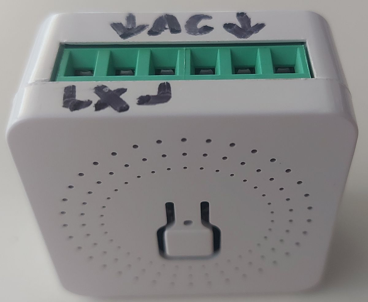

    #36 20986233
    jeffs555
    Just received a RMW002 from AliExpress, and the only thing not exactly clear in this thread was how to open the plastic case. Thought I would post a case photo and suggestion on the easiest way to do it. On the one I received, the only thing holding the case together appears to be the friction fit of a molded plastic pin in each of the four corners. I just used a razor knife wedged into one corner to separate one corner slightly. Then go around to each corner separating more and more until all the pins are free.
    Photo of a plastic RMW002 case from AliExpress, showing its opening process.

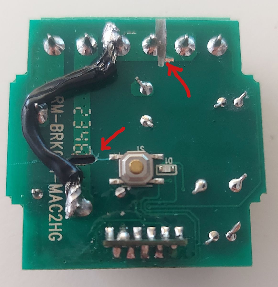

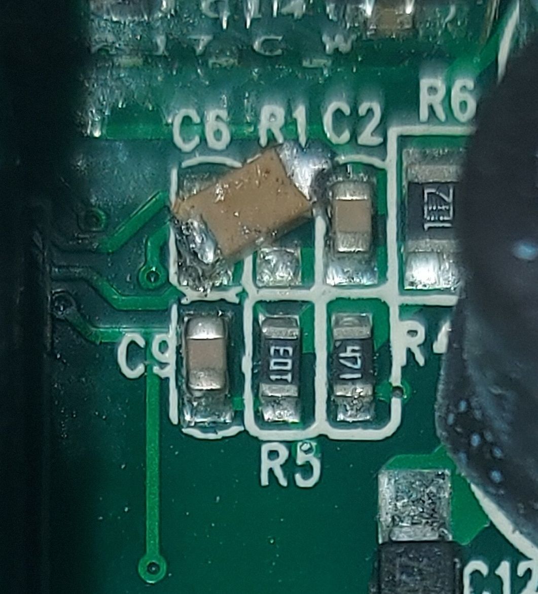

  • 100 nF capacitor fixes random relay activation
    #43 21687041
    visionesglobales
    thanks to this forum and the people who post in it. I could advance with my bl602 thanks to you.
    i only needed one capacitor of 100nf soldered in the way i showed in the picture cos i didnt had the correct size but it works for solving the ramdom relay activation.
    I made some changes for converting the switch in a dry switch for garage door opening (no voltage, only close circuit).
    i had to make a hole where the bottom arrow cos there are conections in both sides of the board.
    and where the top arrow there are only a side of the board connecting the pins so it only need a superficial cut.
    I leave here some photos of my experience.
    PCB section with a manually soldered 100nF capacitor between labeled points C6 and C2
    PCB with soldered wire and red arrows highlighting modifications  Front view of a white device case with green terminals and hand-written AC and Lx labels.
