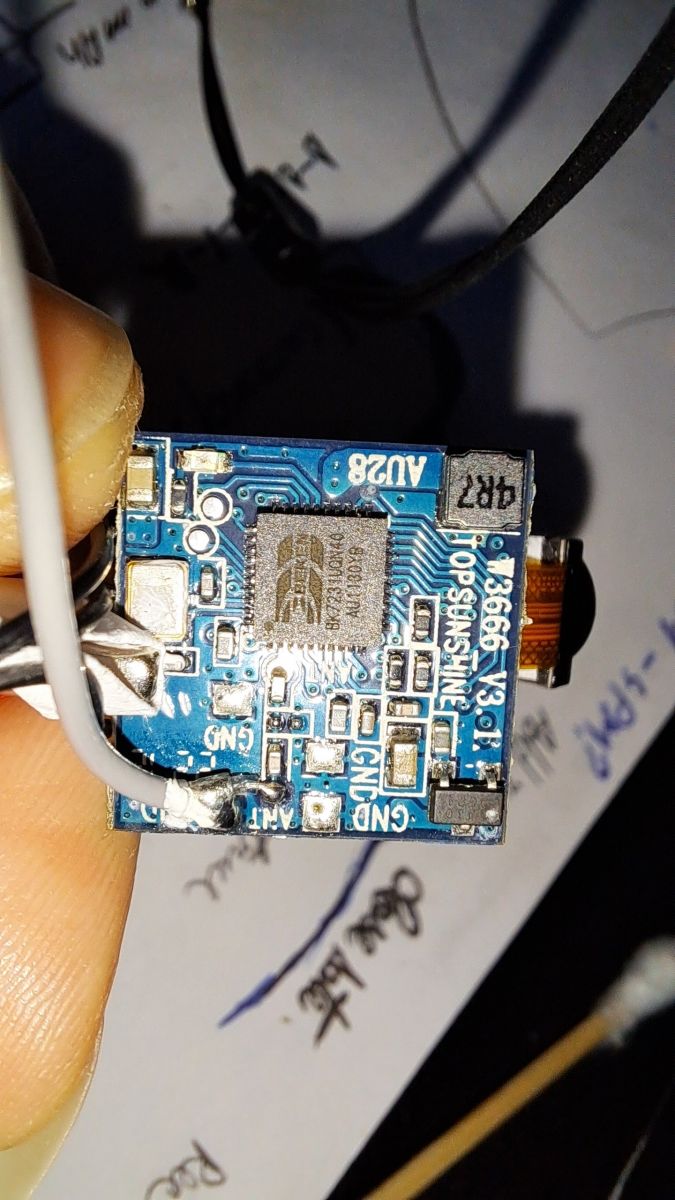

    Hello, I have an RC car with a Beken chip, and I want to extract the firmware using UART.
    I connected with PuTTY, but I'm receiving this message in a loop.
    beken bk7xxx bootloader, Dec 10 2018 17:15:53
    wait uart download timeout: 400
    jump to pc addr: 0x00010000
    I also tried using BK7231Flasher executable, but with no success.

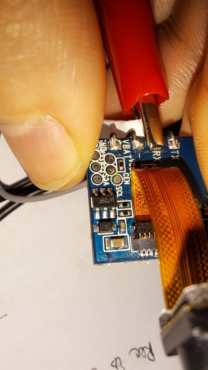

    I'm not sure which one of those pins is the CEN, so I can short it to ground. I tried a few times with a few pins, but no success.
    Do you guys have any idea? Also, I'm not sure if this is a T or N chip 🤔.
    Thanks!
    Circuit board with a Beken chip and connected wires. Circuit board with Beken BK7231 chip. Close-up of a circuit board with connected wires and visible pin labels: UART, CEN, RX, TX.

    Hello, is there really nothing else on the UART?
    Where do you get that message, on TX2, I presume?
    TX1/RX1 is used for flashing, TX2 is used for debug log output.
    Or at least... it's that way in the Tuya products that are using BK7231N or BK7231T.

    I connected to the big TX, RX displayed on the side. I don't know where tx2/rx2 are. As you can see in the pics, the bottom circular pins labels are over one another and I can't understand anything. There is even that CEN label, but don't know which is it.
    When the device is working, there is nothing connected to the RX pin, but it's using the TX pin to send data to the motor controller board.
    And on the UART there is nothing else except those 3 lines. When I'm connected through UART the WiFi access point is not working.

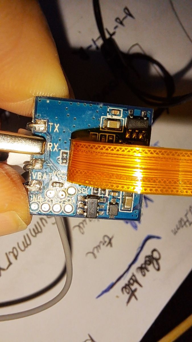

    Added after 51 [minutes]:
    Ok... I think I made some progress...
    Flipped the board upside over and If you can see in the pic where the main beken chip is, there are also 2 round pins.
    If I connect the UART RX to what I assume is TX I get the following data..
