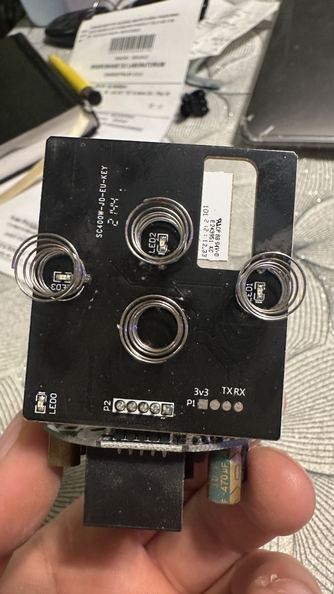

  • BK7231N-based LoraTap SC400W-EU curtain/blinds switch board was opened, identified, and prepared for flashing through the CB3S module.
  • Instead of desoldering the soldered board pins, the board was lifted, RX/TX were connected, power went to the outer pins, and flashing started by shorting GND to CEN.
  • Pin mapping used P6 WifiLED_n;0, P7 Btn;2, P8 LED_n;2, P9 Btn;1, P14 Rel;3, P23 Btn;3, P24 LED;3, and P26 Rel;1.
  • The flashing application could not read settings automatically, so all pins had to be found manually and entered into the configuration JSON.
  • A custom /autoexec.bat restored OPEN/CLOSE/STOP logic, with buttons auto-disabling after 60 seconds, reset lit for 1 second, and RESET toggling the buttons off.

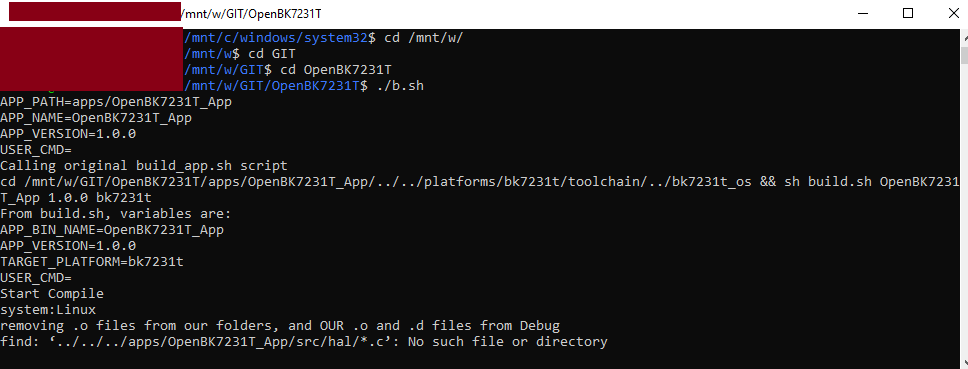

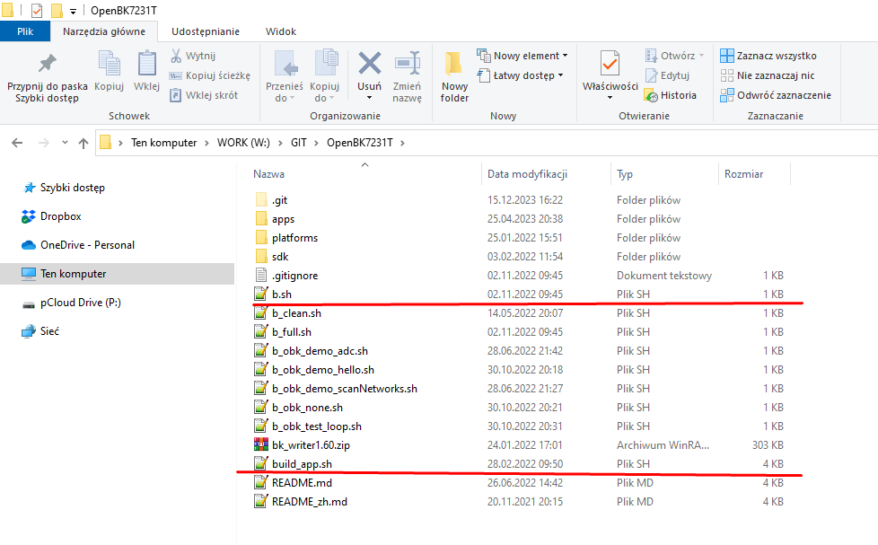

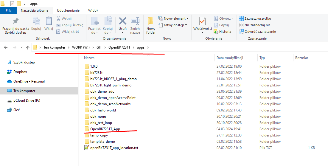

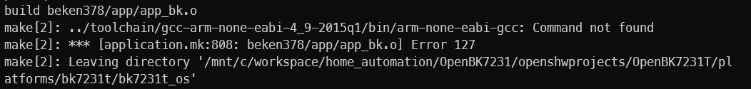

    hezipereg wrote:
    run build in cygwin
    I tried to build using wsl. I get: ./b.sh: 1: ./build_app.sh: not found
    Please double check paths, here is how it looks on my side:
    Screenshot of a folder with various script and document files in Windows File Explorer.
    Screenshot of the apps folder in Windows with highlighted paths to location.
    BTW: On my side build in wsl fails, hmm:
    Screenshot of a terminal showing compilation errors of a script in Linux.
    Linux console showing compilation errors in the OpenBK7231T_App repository.
    I don't know why, we may want to investigate that. I know that it works in cygwin.

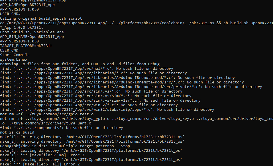

    Any progress with figuring out why it is not working in wsl?
    I also get the following error:
    Screenshot of a compilation error in a Linux terminal.

  • #34 20994640
    hezipereg
    Posts: 19
    OK succeeded to build on wsl.
    The problem was https://askubuntu.com/questions/133389/no-such-file-or-directory-but-the-file-exists
    Bottom line: need to install lib32z1 using
    Code: Bash
    Also needed to install python-is-python3:
    Code: Bash
    Waiting for further guidance.
    BTW, how can I perform incremental build? Running b.sh rebuilds.

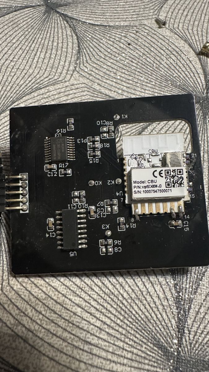

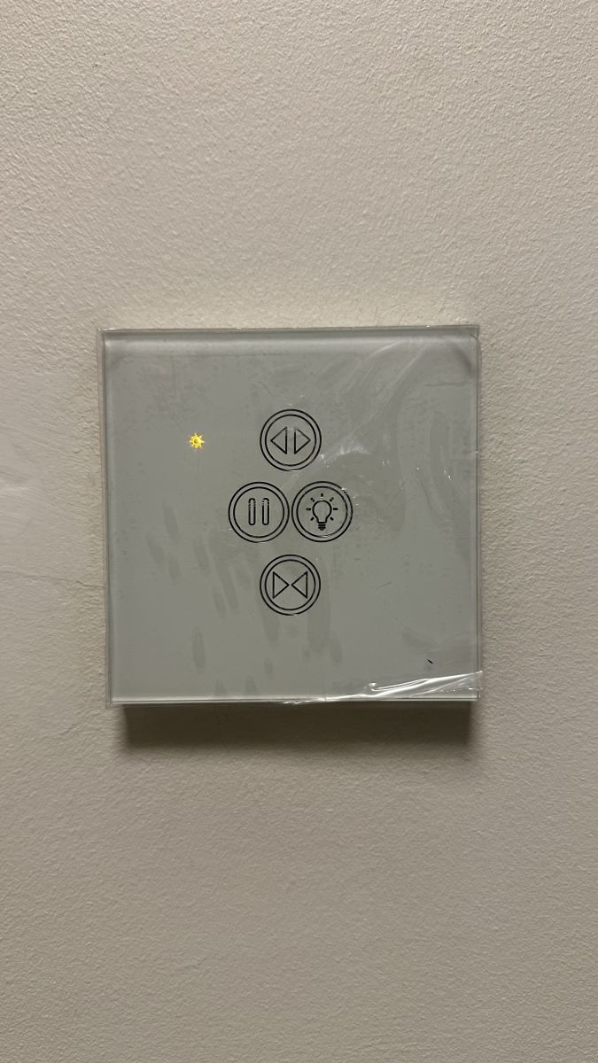

  • #40 21101397
    PSlowik
    Posts: 80
    Hello you.
    Till today I had a controller working about 2 years and suddenly disconnected from the Wifi network. I can not normally add to Tuya :( so I decided if it is possible to do an Open Beken?
    Hover up down pause and light.
    Control panel with four buttons: up, pause, light, down. .
  • #41 21101398
    Posts: 14771
    Rate: 12914
    What WiFi module is inside?
  • #42 21101441
    PSlowik
    Posts: 80
    >>21101398 I haven't had a chance to open it yet. The question is whether it is the software that has crashed somehow? Will an OB help hmmm
  • #43 21101445
    Posts: 14771
    Rate: 12914
    It is hard to assess remotely. It is also possible that a capacitor in the power supply is simply damaged. In that case the Tuya will continue to work after repair. In such a situation, the repair looks like here:
    How do I fix a smart device that chirps, squeaks and makes strange noises? .
  • Bluetooth-only device appears with no name or drawing
    #44 21101451
    PSlowik
    Posts: 80
    Even strangely reports this device after bluetooth probably in the application. No drawing and no name :/
    App interface for adding a new Bluetooth device
    Printed circuit board with electronic components and a module labeled CBU. Electronic module with coils and connectors held in a hand. Image of a round circuit board with visible electronic components and soldering. Image of a round circuit board with visible electronic components and soldering.

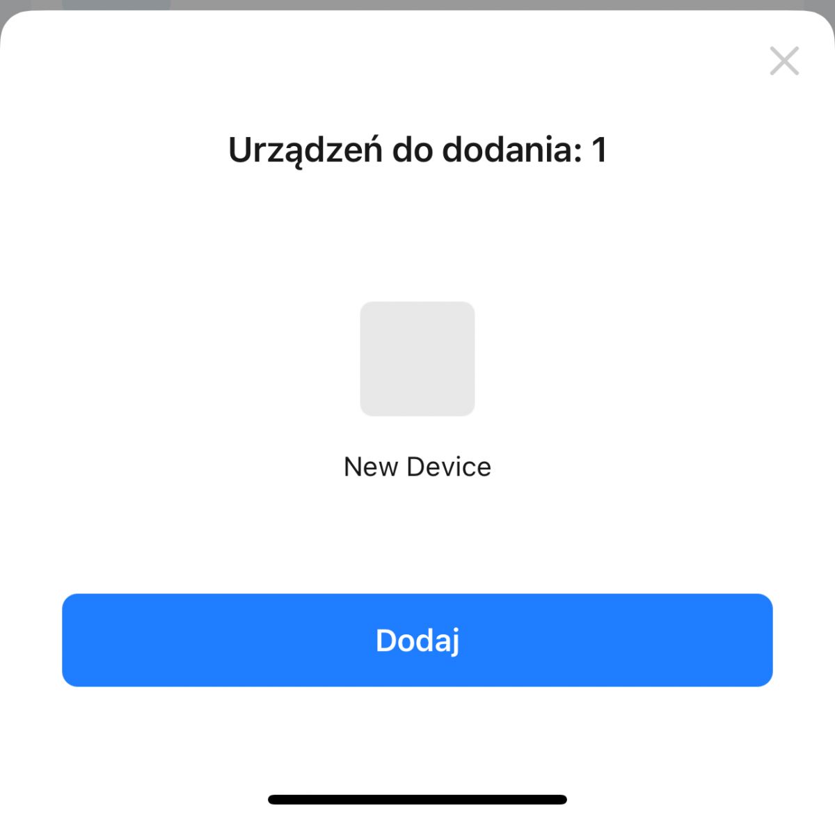

  • #45 21108076
    PSlowik
    Posts: 80
    There is a problem because the device reports as New Device when it should be a Curtain Switch.
    I have checked the capacitors and replaced them without any change.
    I still need to change the software :) .
    Can I ask for help?

    Posts: 14771
    Rate: 12914
    You can upload OpenBeken on it, but that MCU there is on the UART pins? So it's a TuyaMCU device?
  • #47 21109628

Discussion about desoldering, wiring, and flashing a LoraTap SC400W-EU curtain/blind switch based on BK7231N and CB3S. The device was flashed through UART by lifting the PCB and connecting only RX, TX, VCC, and GND, then entering boot mode by shorting CEN to GND. OpenBeken did not auto-detect the GPIO layout, so the pin mapping was identified manually and later refined in GPIO Doctor/GPIO Finder. The thread covers configuring relay, button, LED, WiFiLED, and LED_n roles, including manual LED control, Wi‑Fi status indication, and channel linking. It also explains how to expose a configurable open/close delay as a Home Assistant input by using a text field channel in autoexec.bat and MQTT. The discussion then moves to implementing shutter percentage control, first via scripting concepts and later by designing a dedicated native shutter driver in OpenBeken, including driver table registration, build setup on Windows/WSL/Cygwin, and testing on BK7231 firmware. Later posts mention adapting the solution for similar Loratap curtain switches and a new native shutter driver pull request.
TL;DR: With 8 mapped GPIOs and one simple script, you can flash a BK7231N/CB3S-based LoraTap SC400W-EU without fully desoldering the board; as one expert reply put it, "We have a new working native driver for shutters" if you want a cleaner alternative later. This FAQ helps OpenBeken users wire, flash, script, and tune shutter control. [#21856035]
Why it matters: This thread turns a hard-to-open Tuya curtain switch into a documented OpenBeken workflow, including pin mapping, LED behavior, MQTT control, and the path from script hacks to native shutter support.
Approach What it does Main advantage Main limit
autoexec.bat script Recreates Open/Stop/Close logic and timers Works now on SC400W-EU Percentage control is manual to design
GPIO remapping Changes LED behavior and adds LED toggle control Fast hardware-aware customization Cannot create colors the PCB cannot drive
Native shutter driver Adds dedicated shutter logic Better fit for 0–100% control Arrived later and needs testing per device
Key insight: Start with the proven SC400W-EU pin template and autoexec.bat, then move to the native shutter driver only if you need cleaner percentage-based control. The hardware wiring, especially LED and UART layout, decides what is possible. [#20795168]
  • The working SC400W-EU OpenBeken template maps 8 pins: P6, P7, P8, P9, P14, P23, P24, and P26 for WiFi LED, buttons, LEDs, and relays. [#20795168]
  • The original script improved factory-like timing by changing auto-off from 120 s to 60 s and the reset indicator from 2 s to 1 s. [#20795168]
  • A later Home Assistant-friendly version exposes channel 4 as "Open/Close Duration" with a default of 30 s instead of the earlier 60 s example. [#20988845]
  • One user reported the LoraTap unit cost about $17 from the brand store on AliExpress, showing this is a low-cost shutter platform. [#20796938]
  • WSL builds succeeded after installing lib32z1 and python-is-python3; Cygwin also worked, while WSL initially failed for another participant. [#20994640]
How do I open and flash a LoraTap SC400W-EU with a BK7231N/CB3S module when the board pins are soldered and hard to desolder?
Open it by lifting the board instead of fully removing the soldered pin header. Then solder only RX and TX directly to the CB3S pads, and feed power to the two extreme board pins where GND is on the left, the same side as the OPEN button. To enter flashing mode, short GND to CEN. This avoids desoldering the whole switch assembly and was reported to work on the SC400W-EU with a BK7231N-based CB3S module. [#20795168]
Which RX, TX, VCC, GND, and CEN connections are needed to put the CB3S module on a LoraTap SC400W-EU into flashing mode?
You need RX and TX on the CB3S module pads, VCC and GND on the two extreme board pins, and a temporary short from GND to CEN to enter flashing mode. The thread states GND is on the left side, matching the OPEN button side. The author powered the board from those outer pins and did not rely on automatic pin detection in the flashing app. That manual wiring was enough to flash the device successfully. [#20795168]

What causes OpenBK7231T_App builds to fail under WSL, and how do lib32z1, python-is-python3, line endings, Cygwin, and Docker compare as build options?
WSL failed for two concrete reasons in the thread: missing lib32z1 and missing python-is-python3. One user also hit /bin/sh^M: no such file or directory, which points to Windows CRLF line endings. After installing both packages, the WSL build succeeded. Another participant reported WSL still failed on their side and recommended Cygwin as the proven option, while also noting an alternative Docker build system existed in the repository. This makes Cygwin the known-good path and WSL workable after fixes. [#20994640]
