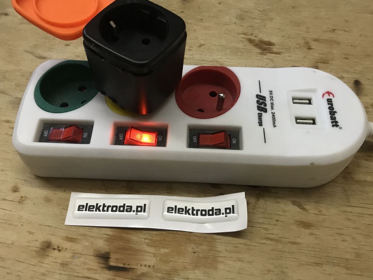

    alias plug_on backlog setChannel 1 1
    waitFor NTPState 1
    if $hour>=14&&$hour<21 then plug_on
    again:
    if $CH2!=0 then do_tick
    delay_s 1
    goto again
    Tested on BK7231 device:
    Eurobatt power strip with connected adapter and activated switch.
