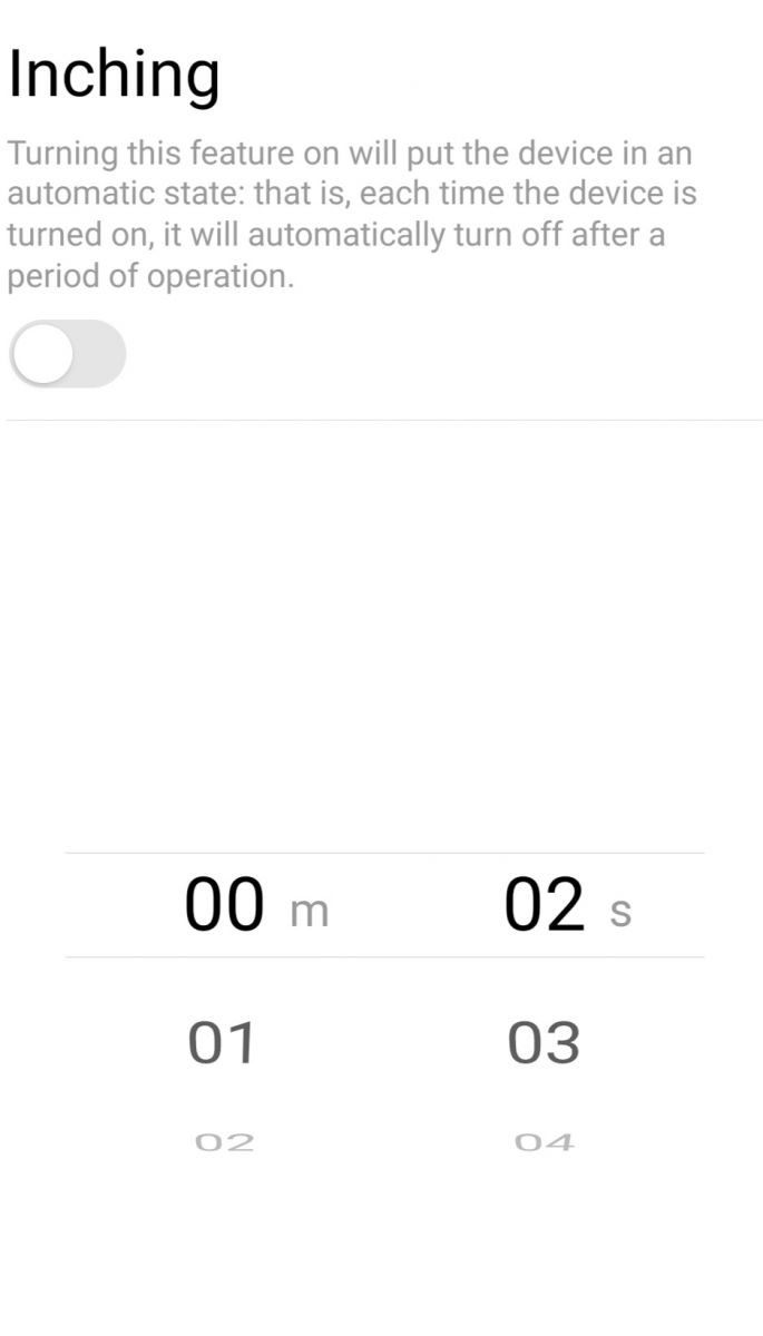

  • Requesting OpenBeken auto-off timer after 20 minutes
    #9 20797236
    ciknururko
    Posts: 44
    Screenshot showing the Inching feature settings, allowing automatic device shutdown.
    Like shown in the screenshot. I have another WiFi plug (same model) which I haven't flashed with OpenBeken yet. So there is an option for inching as described in the screenshot. Can the same functionality be achieved with OpenBeken?
    Kindly guide.
    Added after 1 [hours] 27 [minutes]:
    >>20796861
    Please guide how to auto turn off the switch after N number of minutes.
    Eg if I turn on the switch, then it should automatically turn off after 20 minutes.
    How to do this via openbeken??
    Kindly guide

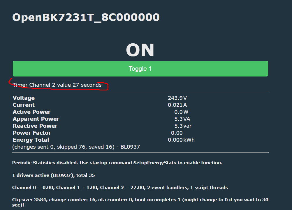

  • Countdown timer script for OpenBeken relay control
    #14 20797440
    Posts: 14756
    Rate: 12883
    You must have a configuration error. Maybe wrong startup value. It worked for me.
    Still, here is a script that tries to remember the countdown value between reboots and displays timer on gui:
    Screenshot of the OpenBK7231T interface showing relay status and a timer countdown set to 27 seconds.
    // display seconds timer
    setChannelType 2 TimerSeconds
    // set start values as "remember in flash"
    SetStartValue 1 -1
    SetStartValue 2 -1
    // channel 2 is timer
    // channel 1 is relay
    // here is countdown value in seconds - 30
    alias turn_off_after_time backlog setChannel 2 30
    alias on_turned_off setChannel 2 0
    alias turn_off_relay setChannel 1 0
    alias do_check if $CH2==0 then turn_off_relay
    alias do_tick backlog addChannel 2 -1; do_check
    // this will run the turn off command every time that CH1 becomes 1
    addChangeHandler Channel1 == 1 turn_off_after_time
    // this will run the turn off command every time that CH1 becomes 0
    addChangeHandler Channel1 == 0 on_turned_off
    again:
    if $CH2!=0 then do_tick
    delay_s 1
    goto again
    It uses channel 1 as a relay and channel 2 as a timer variable

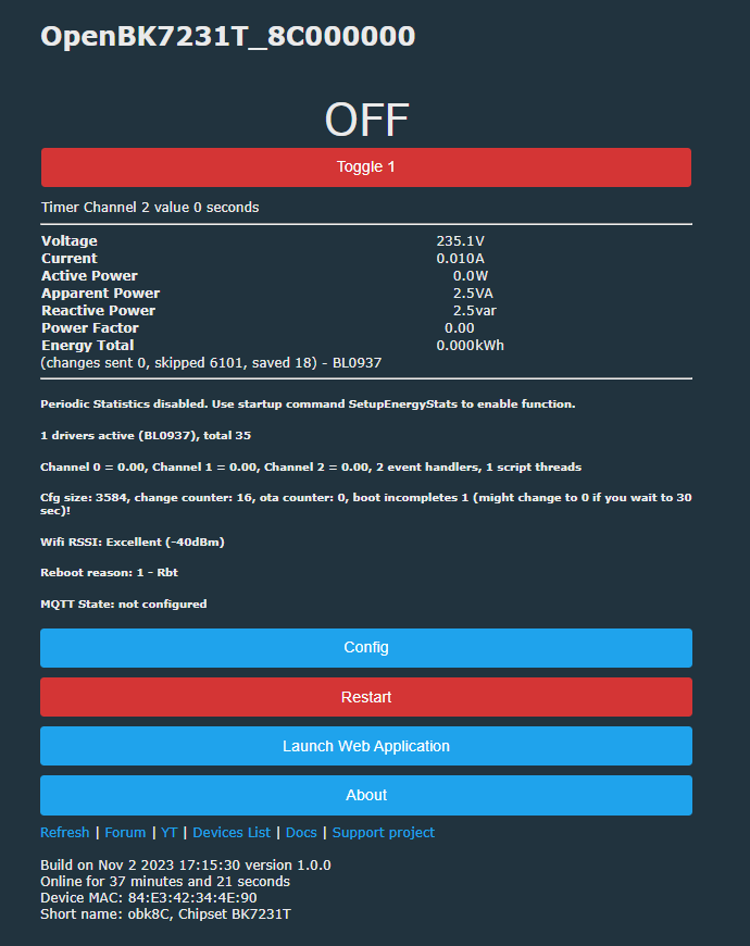

    If your switch is still not remembering the last state, then you have to show me your full device configuration, screenshots from the pages, from startup, etc, from pins, and your current script.
    I have a LSPA-like socket at hand and it remembers the relay state:
    Screenshot of the OpenBK7231T device control panel displaying OFF status.
  • Questions about switching firmware and backing up settings
    #17 20797512
    ciknururko
    Posts: 44
    I have reset the switch, now it's remembering the last state.
    The next time, if it does not remember the last state, I will give you the screenshots you asked for.

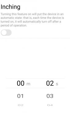

  • Request for GUI text field to set inching time
    #27 20801662
    ciknururko
    Posts: 44
    Need a little guidance,
    This is the script that you posted
    // This aliased command will turn off relay on CH1 after 10 seconds
    // addRepeatingEvent [IntervalSeconds][RepeatsOr-1][CommandToRun]
    alias turn_off_after_time addRepeatingEvent 10 1 setChannel 1 0
    Instead of hardcoding the time e.g. 10 seconds in the auto exec.bat file, can we have a TEXTFIELD on the main GUI page to enter the time in seconds and have a button like SET to save the entered time for inching.
    Something like in the screenshot.
    Screenshot showing a text field with the value 0 and a button labeled Set.
    If the value in the TEXTFIELD is zero, then inching is disabled and the plug will turn off when the user turns it off manually. If there is a value in the TEXTFIELD, then the plug will turn off after that many seconds which is entered in the TEXTFIELD.
    This will help many users like me.
    Kindly help.
